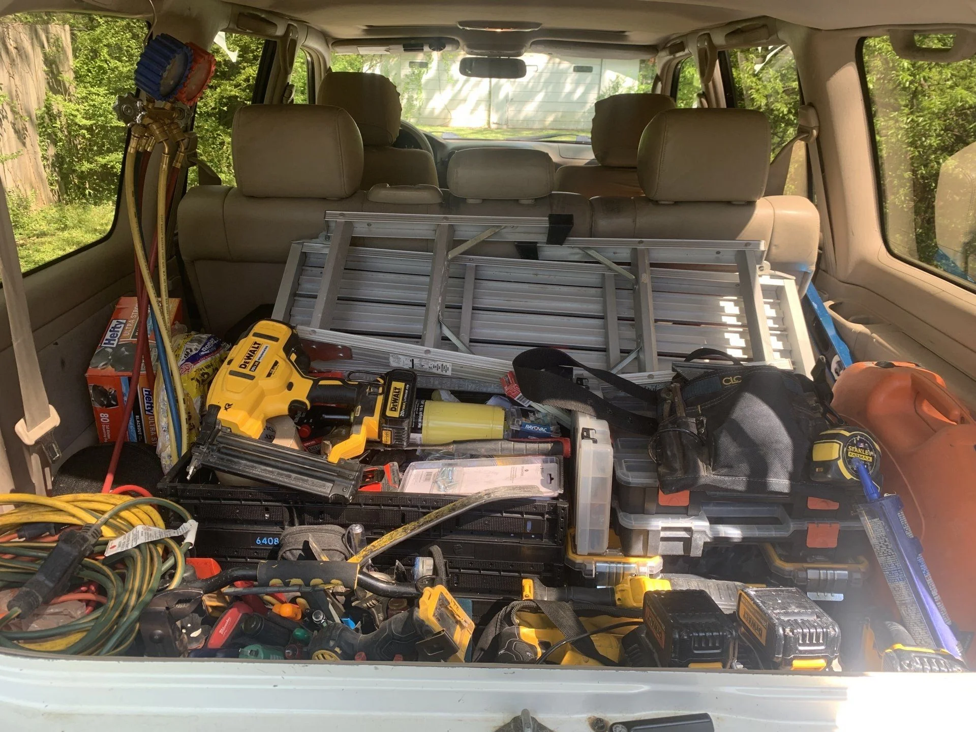

@suprarx7nut also it helps to mention this is my work vehicle and I usually have about 300-500lbs of Construction tools in the back at all times unless using it for a vacation trip lol 😂

With that load out and this being a work vehicle, forget air bags, IMO. If you're constantly carrying 500+ lbs and you tow sometimes, throw in some non-AHC 100 series springs and have someone competent with AHC (not an easy thing to find, annoyingly) to swap out the springs and check neutral pressures (simple task involving a cable and laptop with techstream, takes 5 minutes).
King springs and air bags would probably be fine, but I'd go a step further and get LX450 springs or non-AHC 100 series LC springs. Either should be very inexpensive if you can find them used.

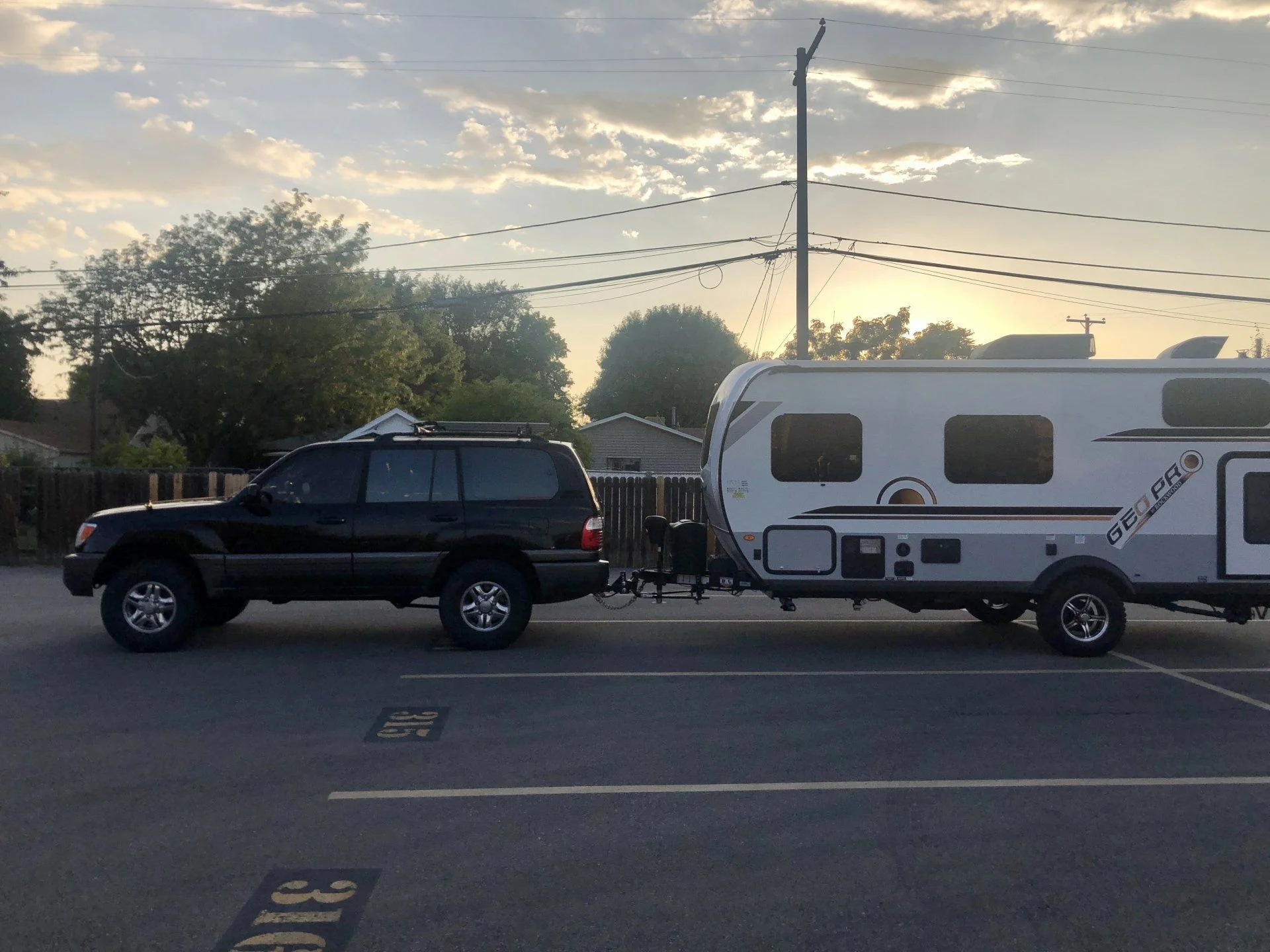

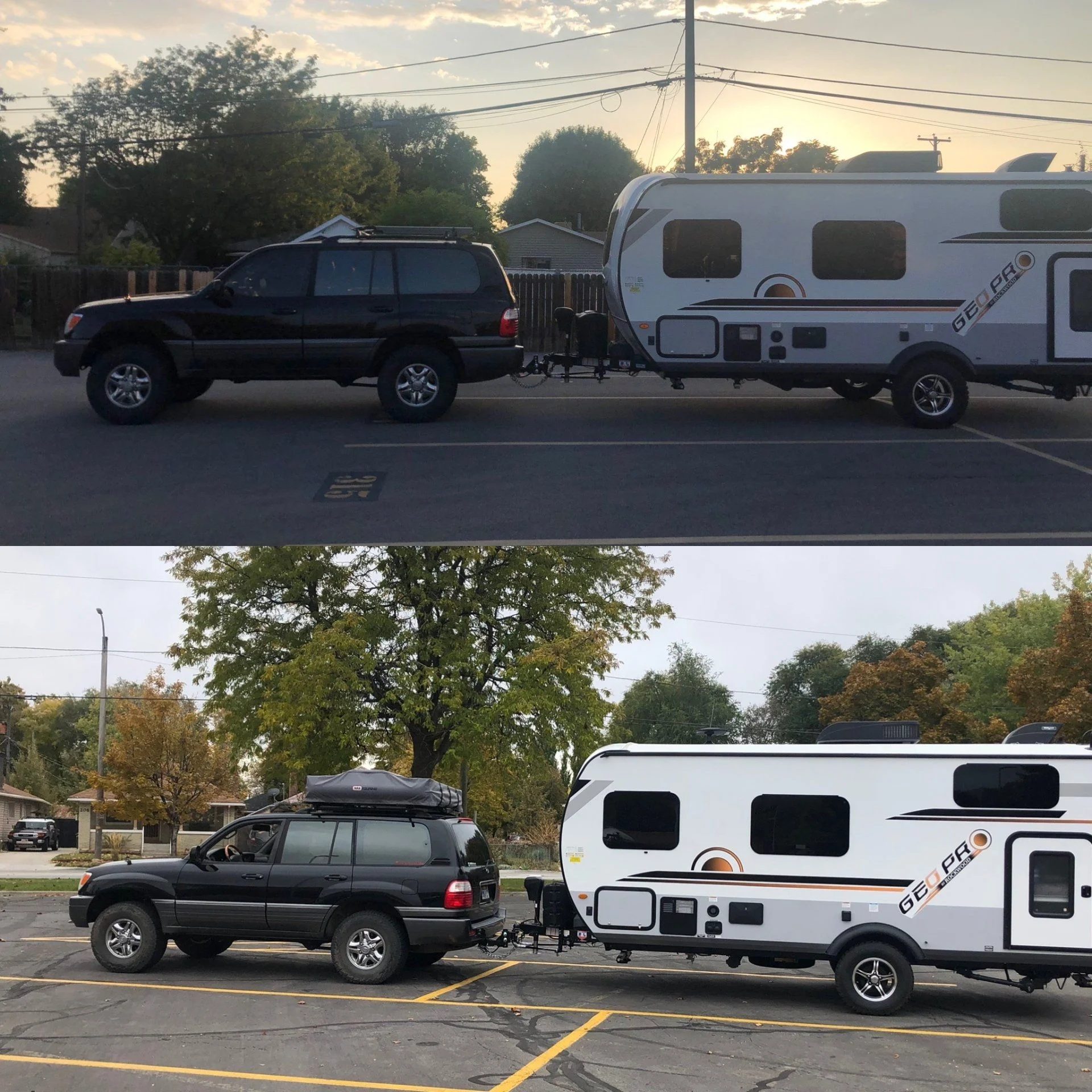

Hard to see a huge difference with the addition of the airbags. However, not the position of the hitch. I had to lower it to make things level again. Full water and two dogs in the back and things are still level. 15psi in the bags. I ran my air line to the receiver hitch and just fill it with a bike pump. Best $150 spent. Very easy install.
