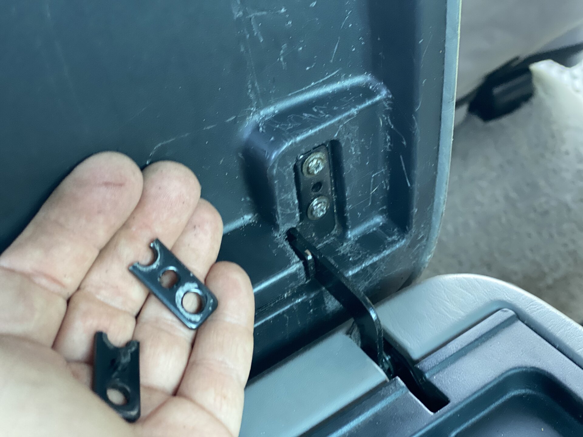

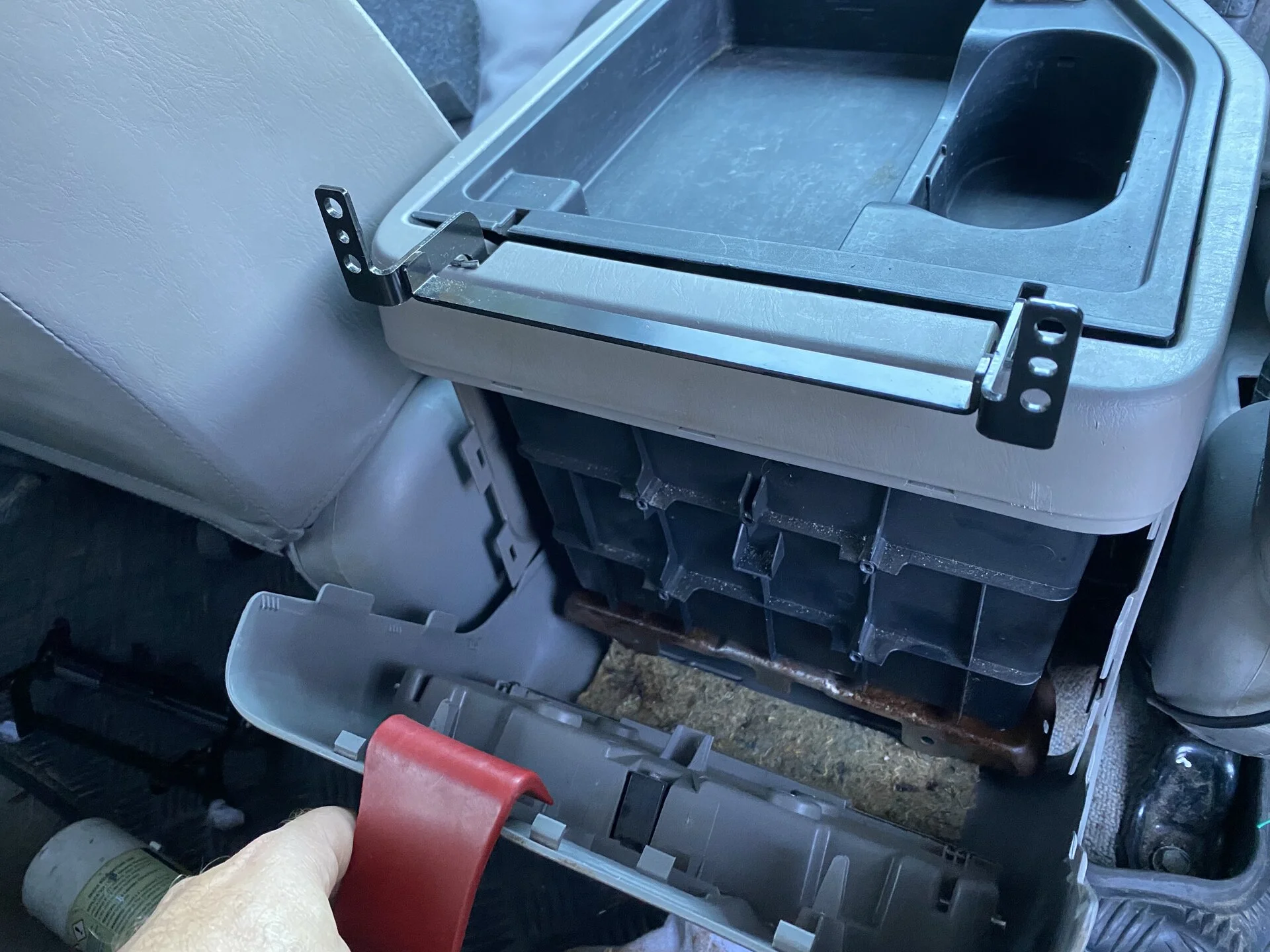

I finally got a hinge and did mine… both arms of the hinge that screw into the lid snapped off.
This is how if anyone needs a description.

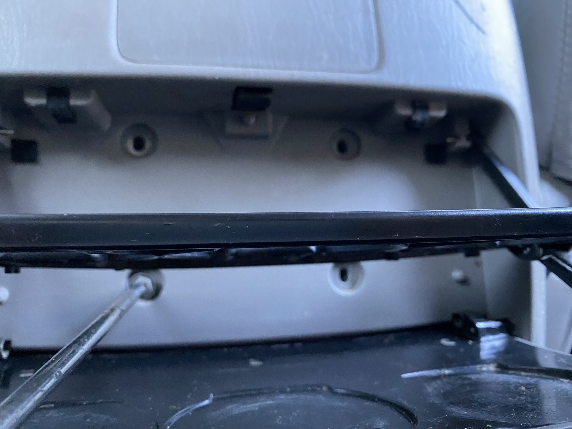

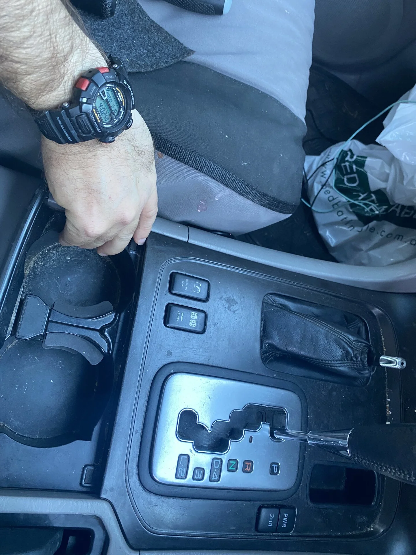

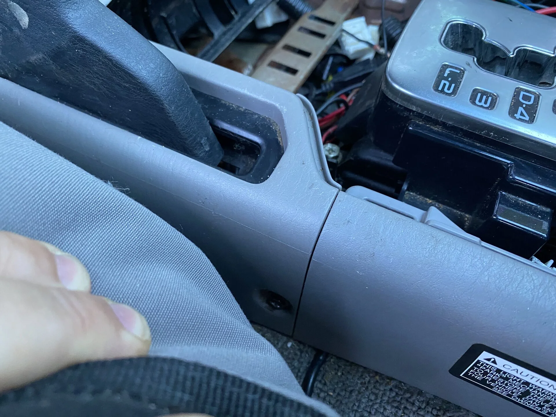

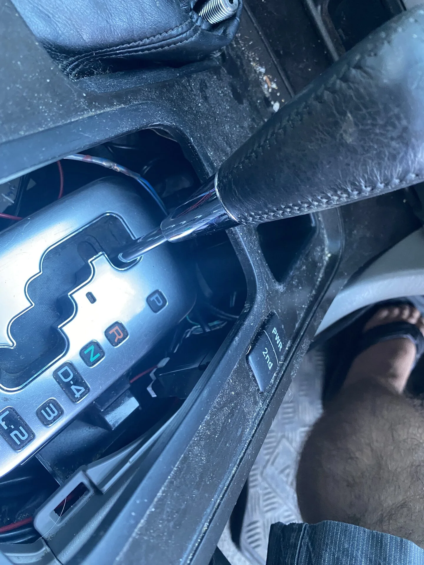

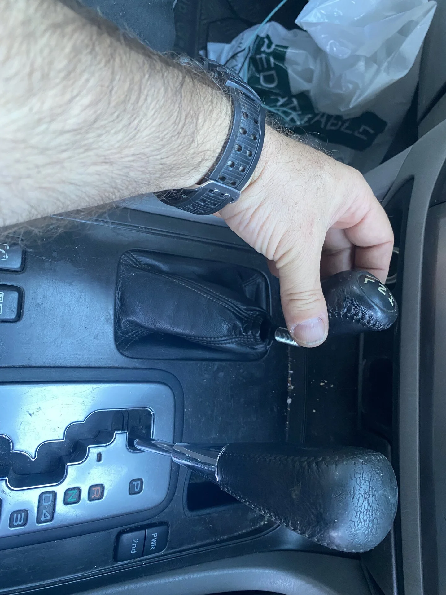

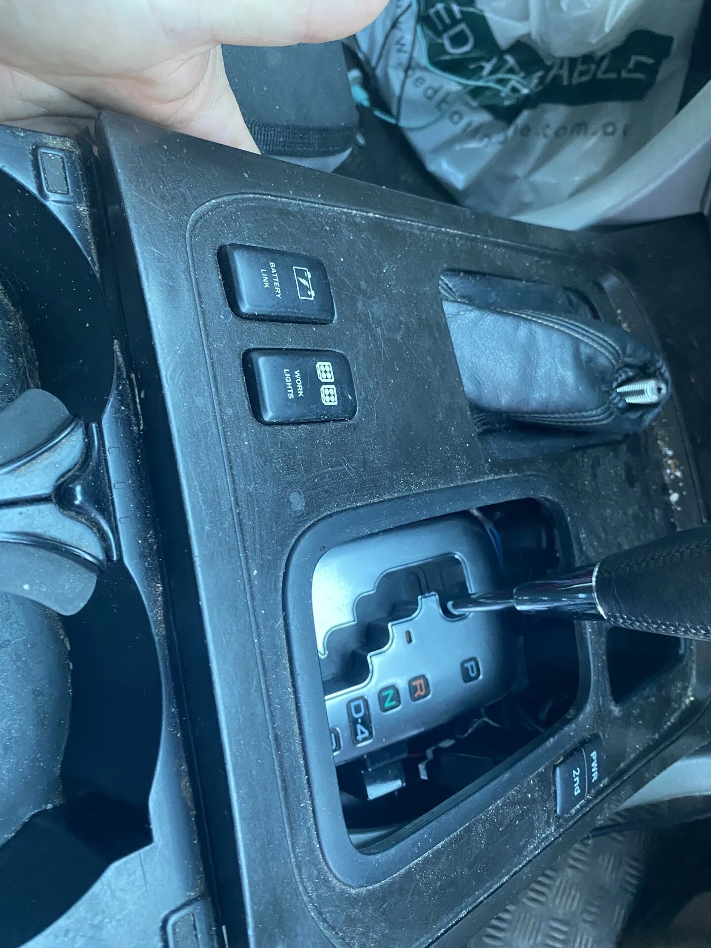

1. Remove knob of high range/low range shifter and pry up centre panel trim starting at the cup holders (pull up on the sides at the same time.
Be careful to disconnect cables from back of all switches before pulling away.

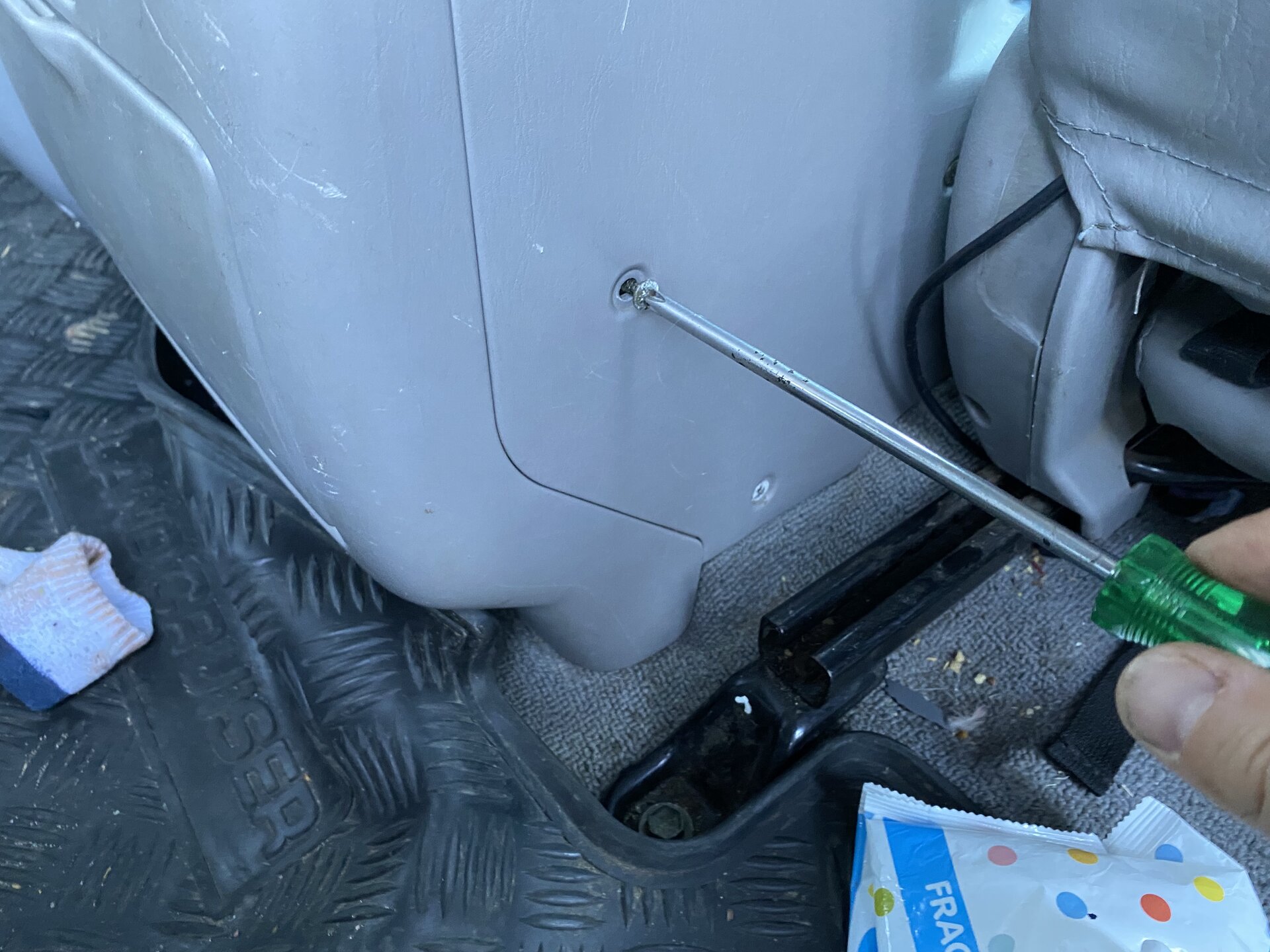

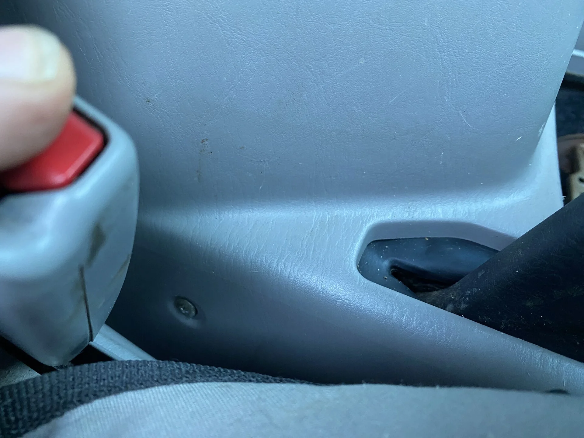

2. Down each side of the centre console there are 4 screws that can be accessed by sliding the front seats back and forth. You may need to press down on the seat cushion as well.

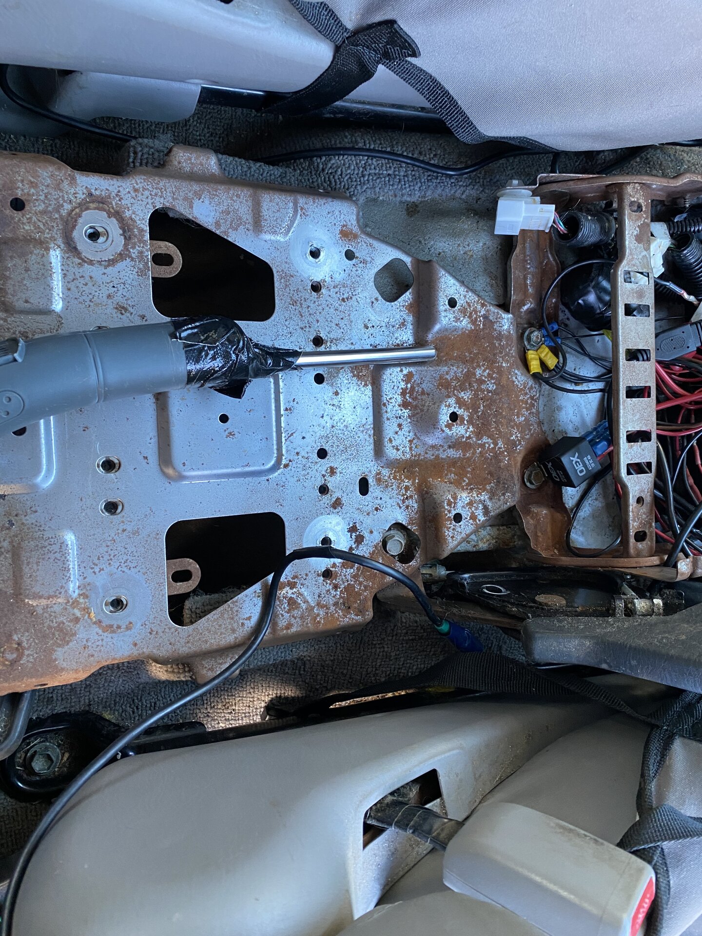

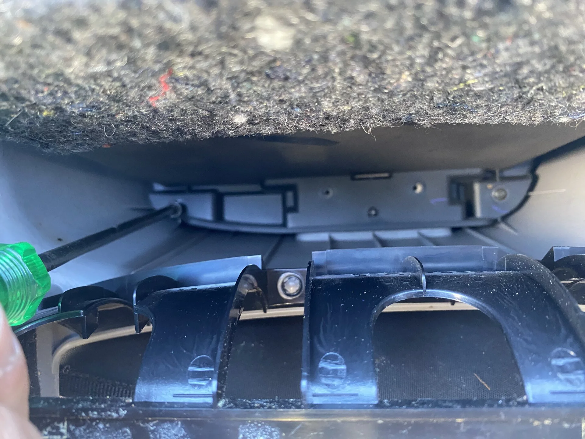

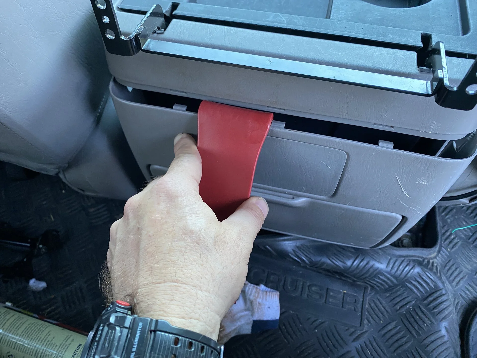

3. At the rear of the centre console, lower the rear cabin cup holders to access 4 screws.
Remove and pry the back off.

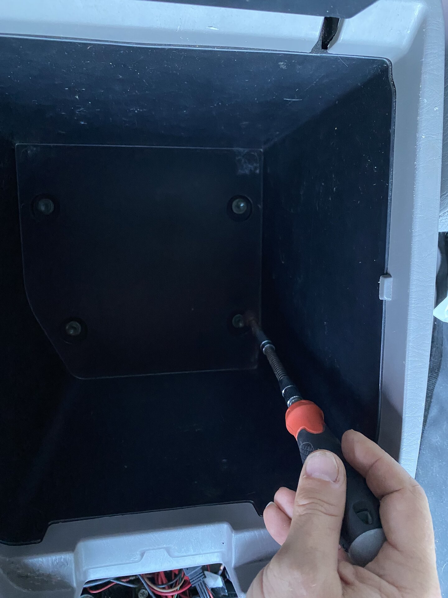

4. Inside the centre console at the very bottom are 4x 10mm bolts holding it down. Remove and you will be able to lift the console out as you pull if rearwards.

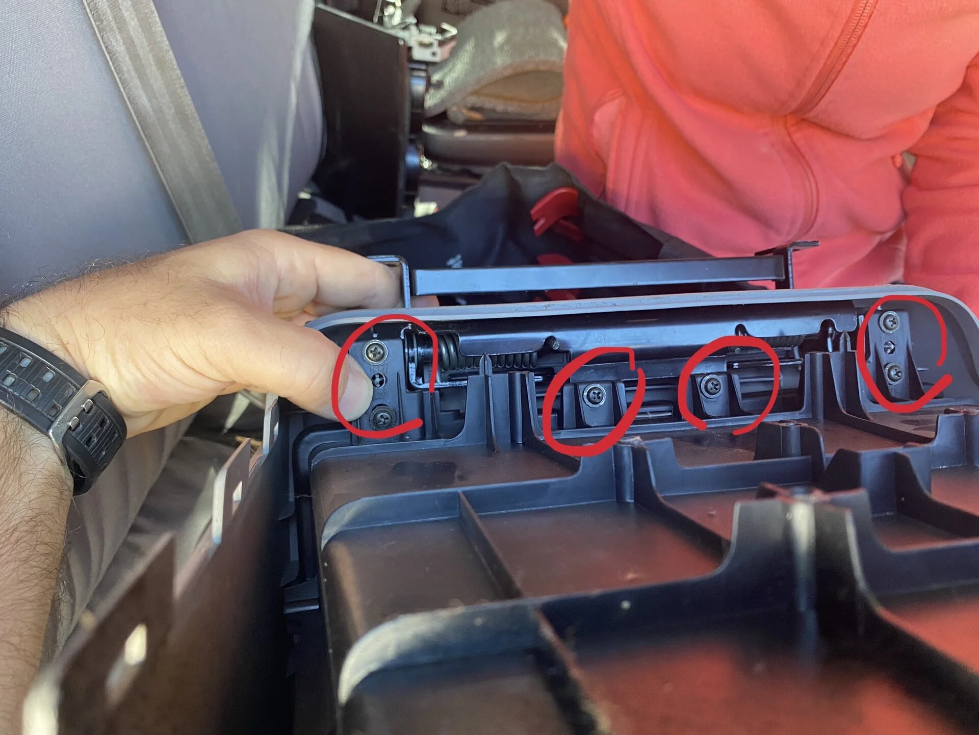

5. Take the lid off the console by removing 4 screws under the secondary lid, and then the hinge come out by removing 6 other screws. It’s pretty obvious once you have the console out.
This has happened to my HDJ100R and I would recommend that after replacing the hinge you put large washers on the 2 screws as the point that has broken in the picture is exactly where mine broke and appears to be a weak point in the design. A couple of beefy washers would reduce the flex and thus metal fatigue at the weak points.
