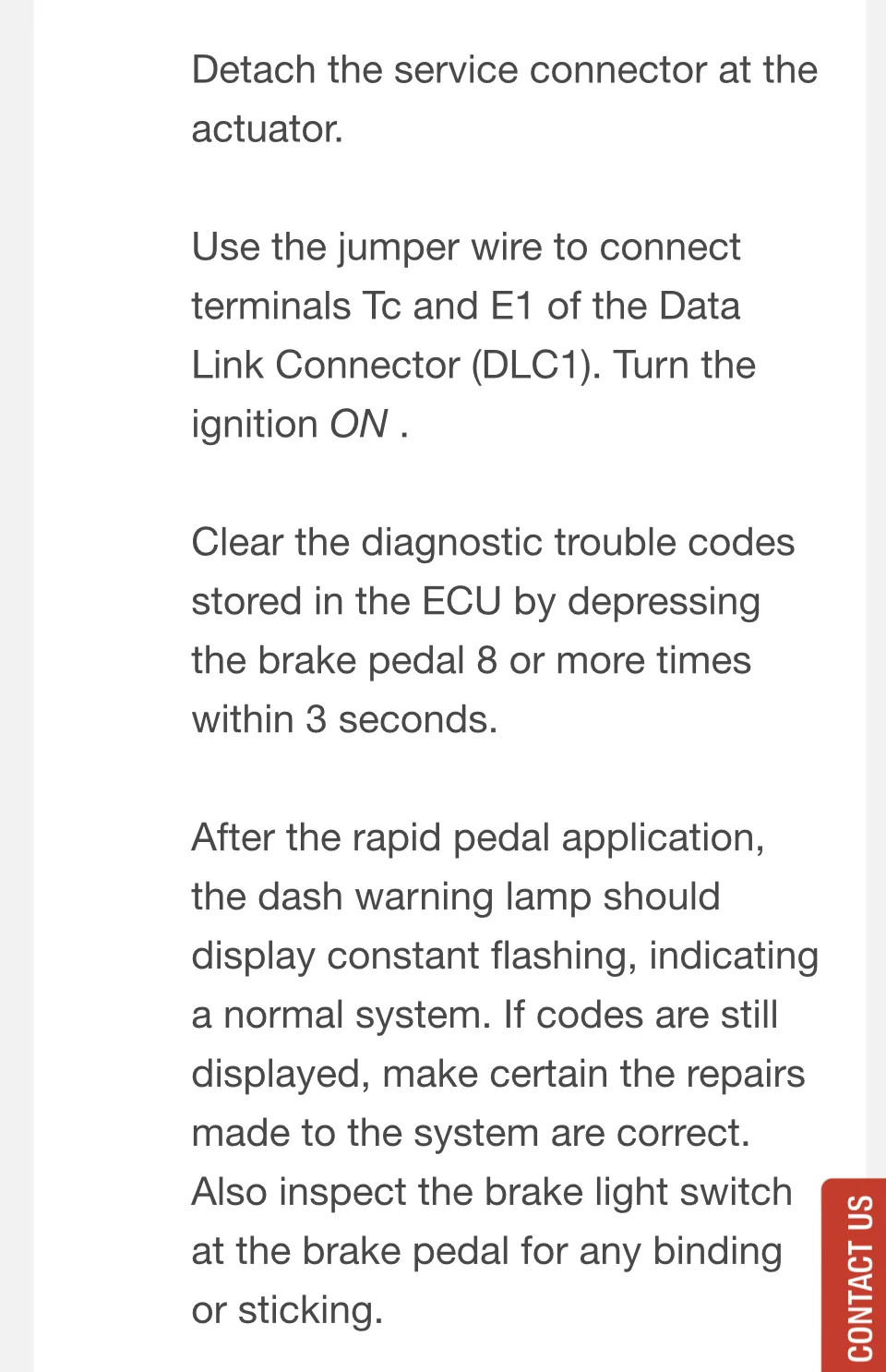

Saw this on Autozone website repair guide. Did u try unplugging sensor at the actuator to clear codes?
