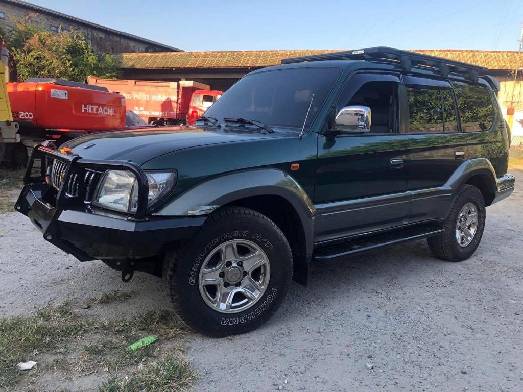

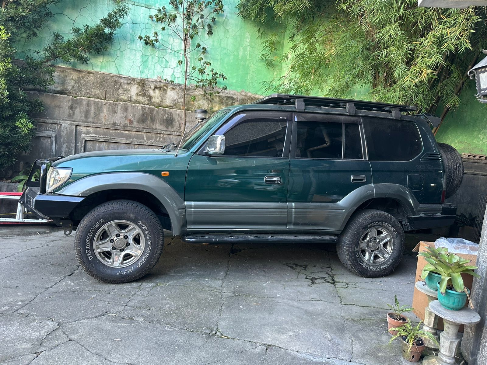

Starting a thread for my VZJ95 prado. This is overseas as I build it to get ready to ship here
1997 Prado VZJ95

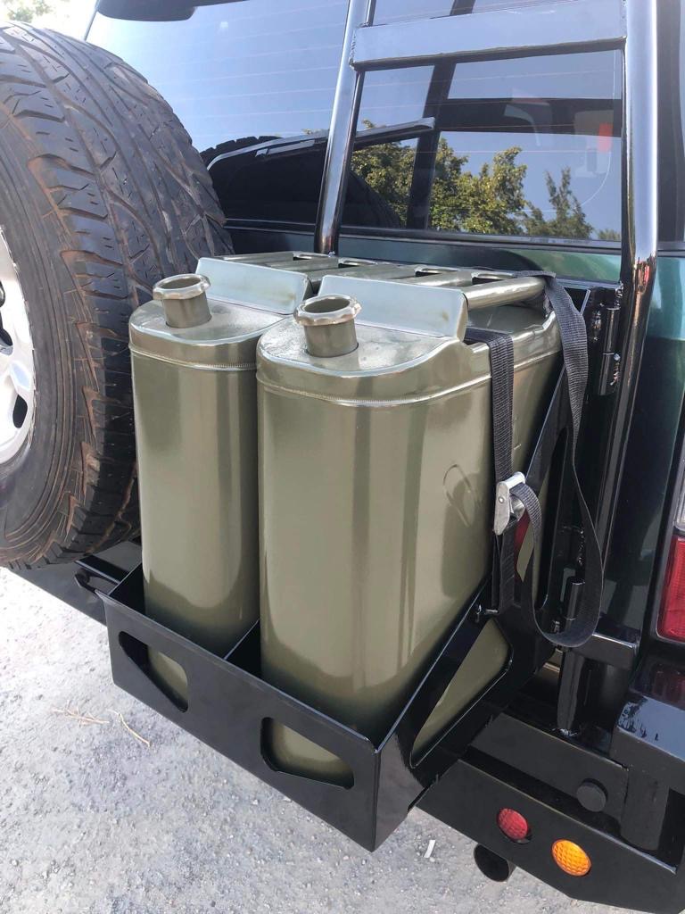

-OEM dual tanks
-Custom front bumper
-Custom rear bumper
-Custom sliders

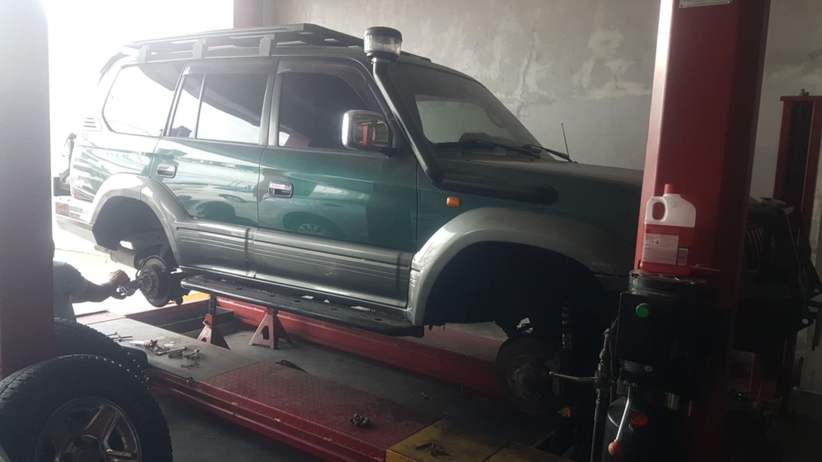

-SRQ fabrications full 2.5” lift kit (Bilstein 51xx series with OME coils)
Future plans:
-Uz swap (wishful thinking)
-crawlbox from 95-04 tacoma
-solid axle swap (maybe)
-Mickey Thompson classic iii wheels or 80 series landcruiser wheels on 33s

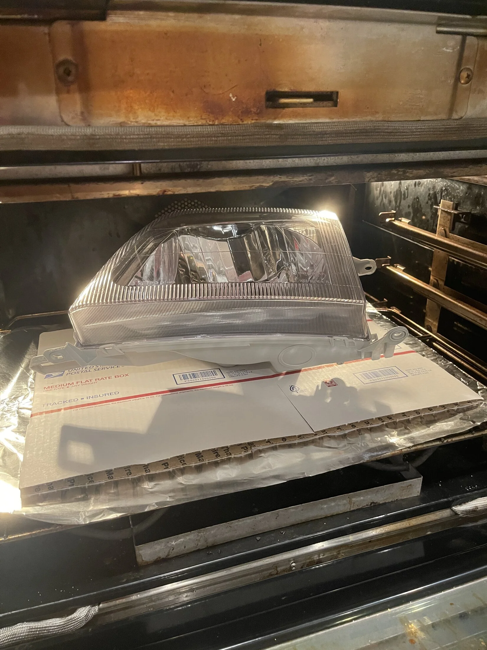

AC compressor fixed…now its running again. Thinking of doing an overhaul of the motor

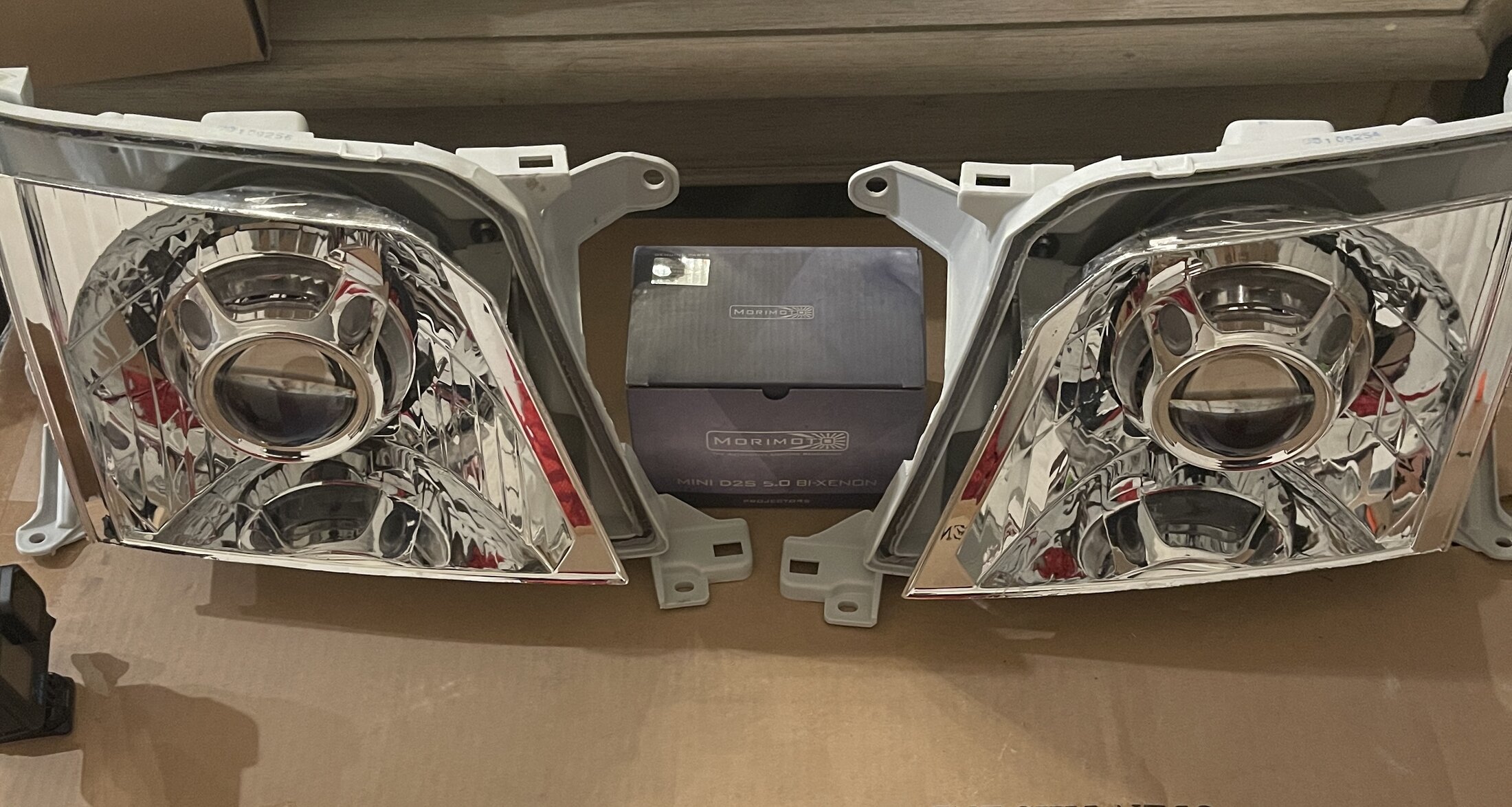

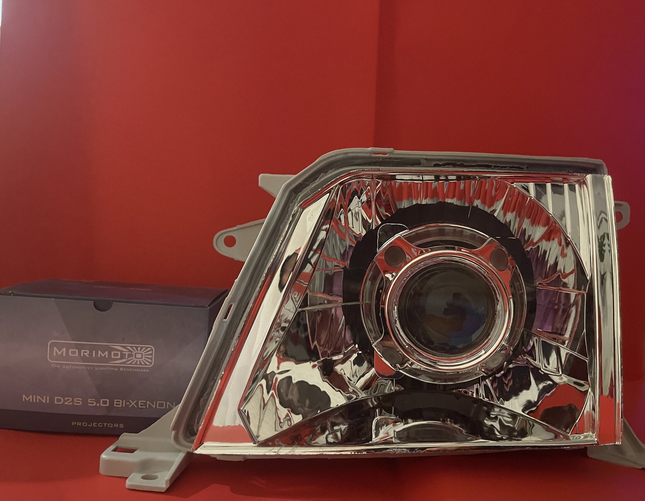

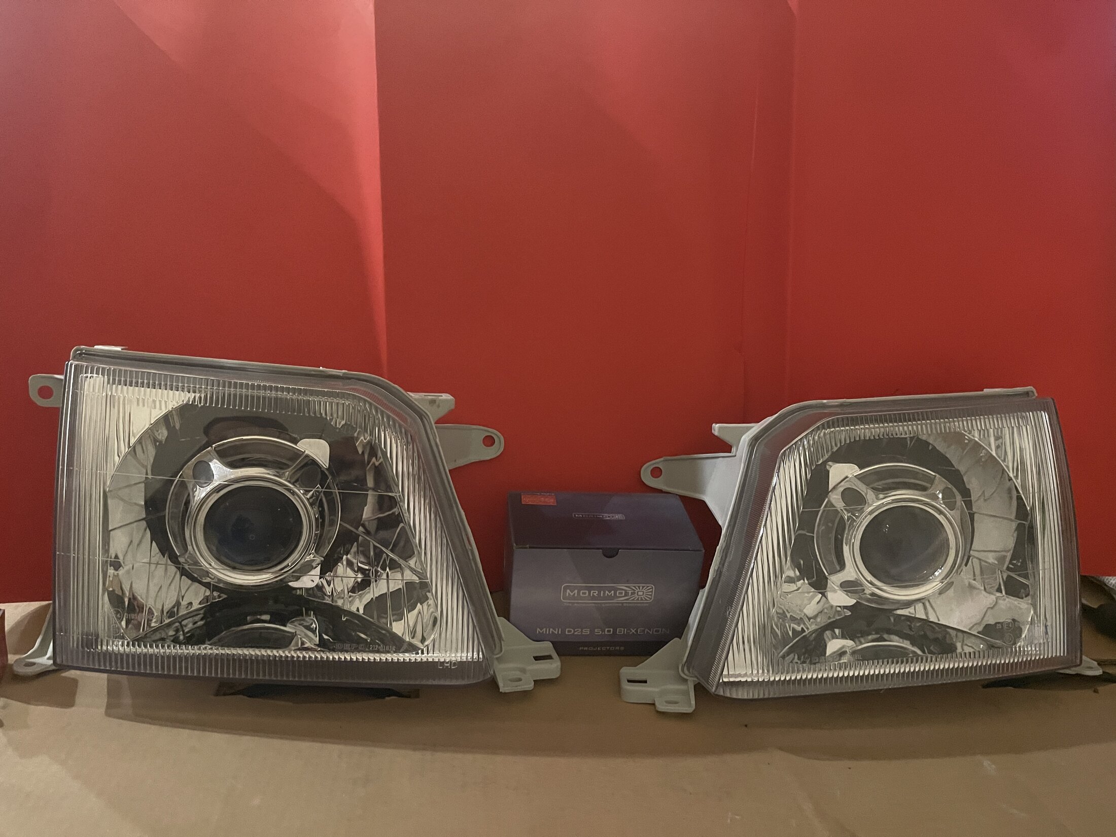

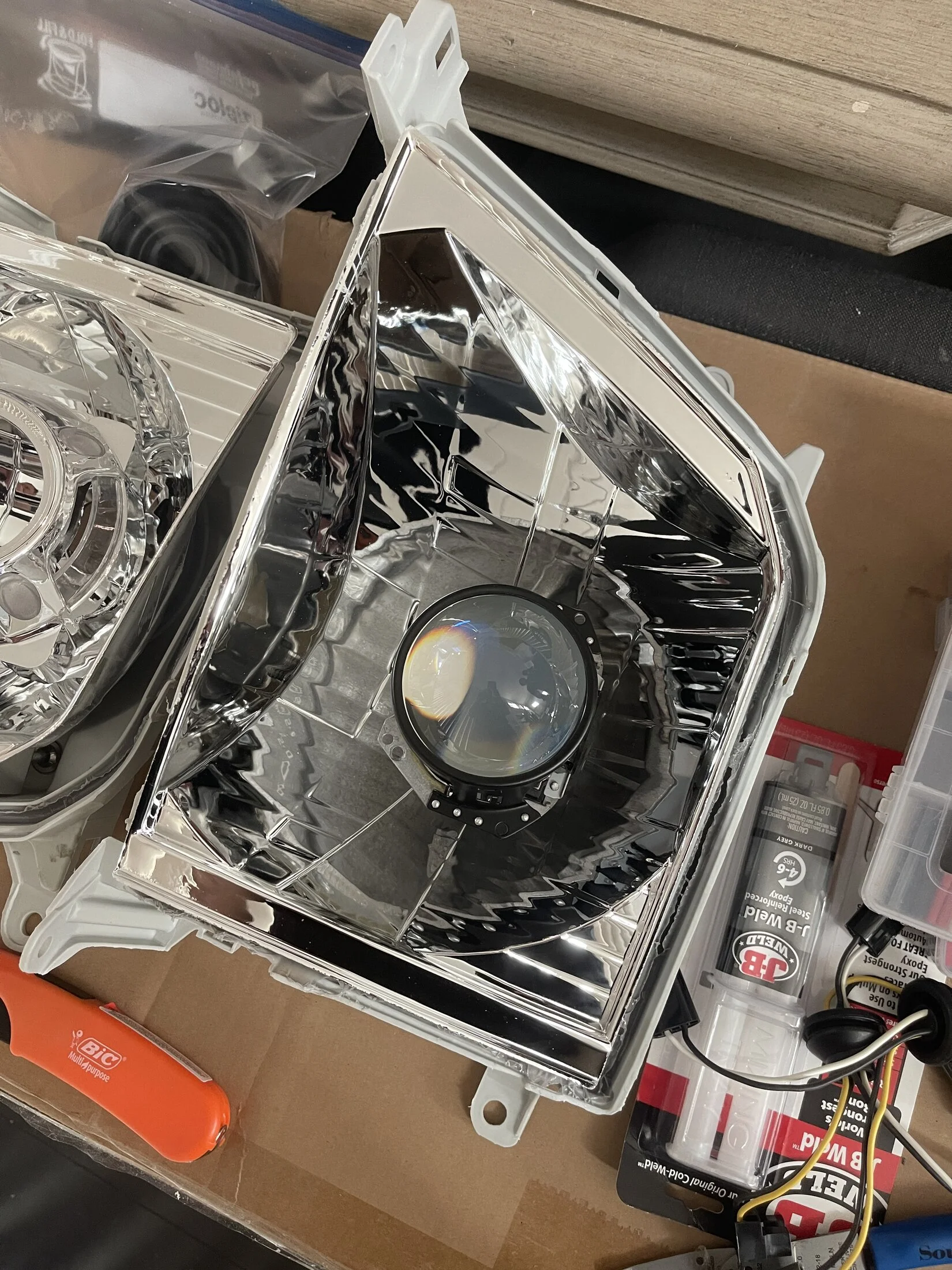

Working on the headlights tonight…waiting on my D2S projectors to arrive!

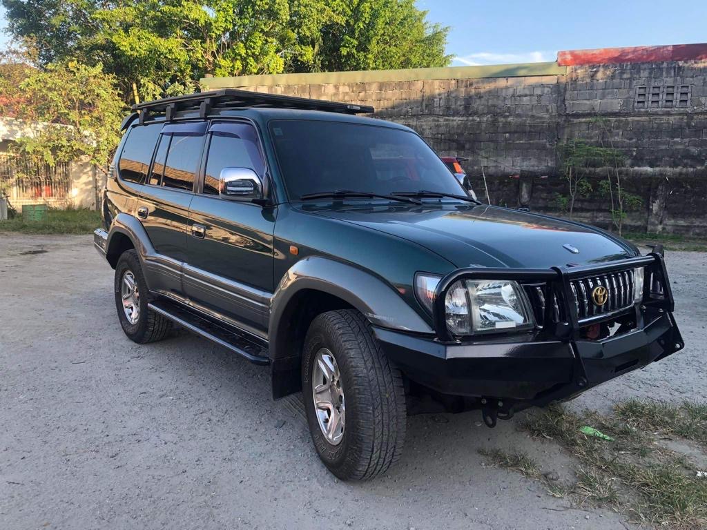

I didn't think JDM 95s came with dual tanks - did someone do the dual tank upgrade?
@Finn1997
Yea…the previous owner added that chrome…chrome was very popular in the philippines in the 2000s sadly…Vin and chassis code places it as a UAE model
It’s not a JDM unit! Mine is from UAE!
Ah sorry, I was reading the wrong guy's signature line.
I was once looking at an ex-Saudi Arabian VZJ95 for sale in the UK which I think had twin tanks. I love how the round clock gets switched for the sub-tank fuel gauge.
Good luck with the build.
Couple hours later…my instagram page will have the full how to…same username as I have here :)

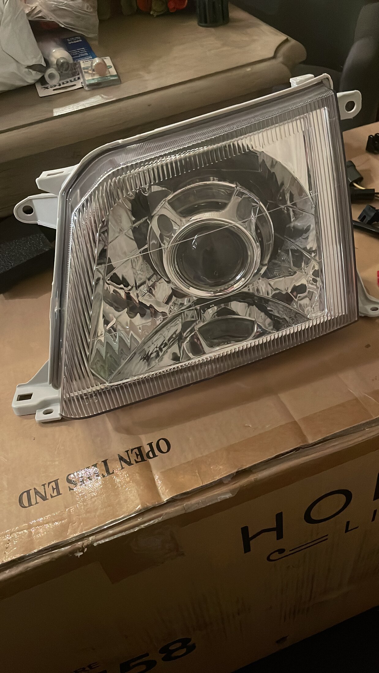

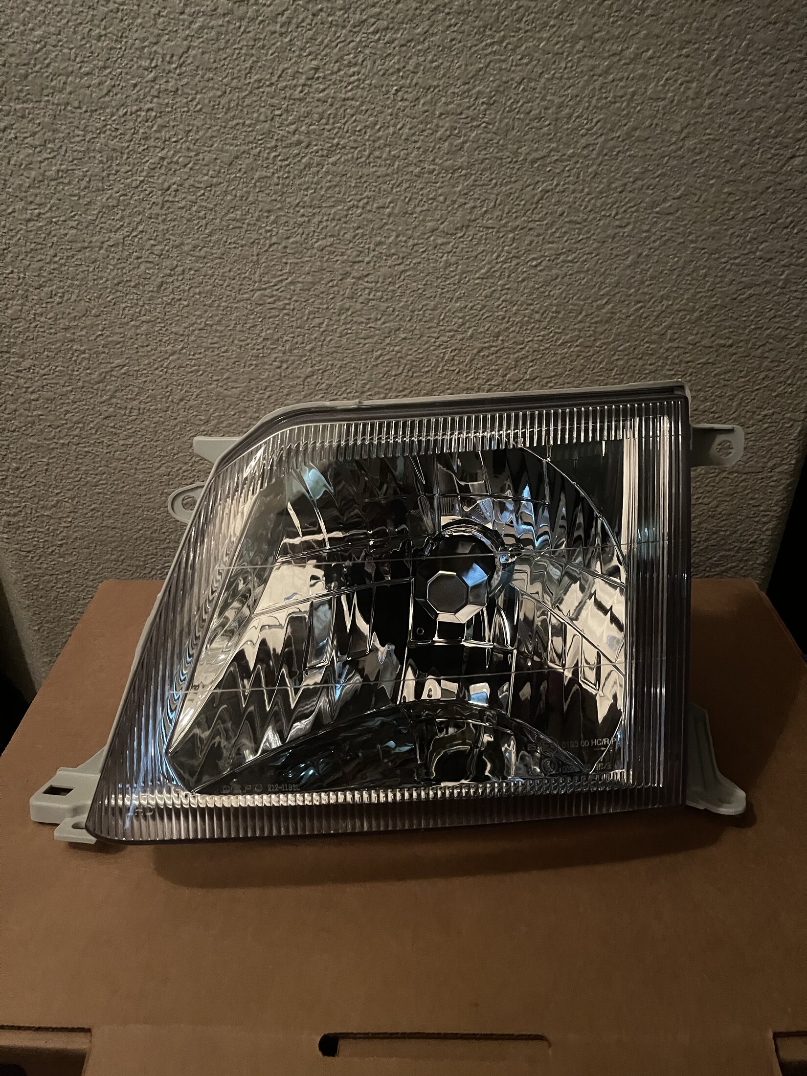

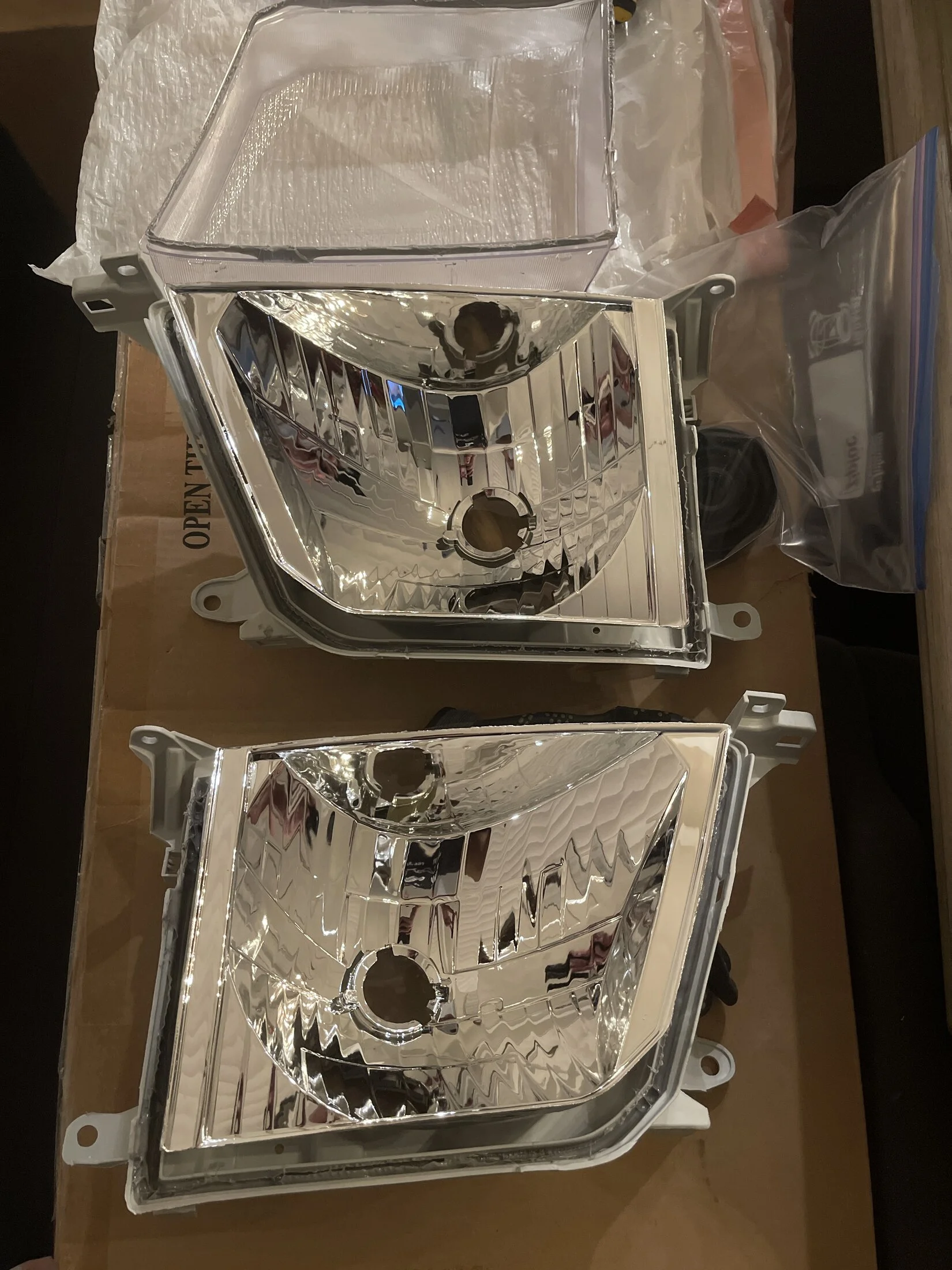

I have a soft spot for the glow of the H4? halogen headlights. Can I replace the bulb inside the stock headlight or do you have to buy new glass H4?
Bulb should be replaceable! Do you have cracked lenses?

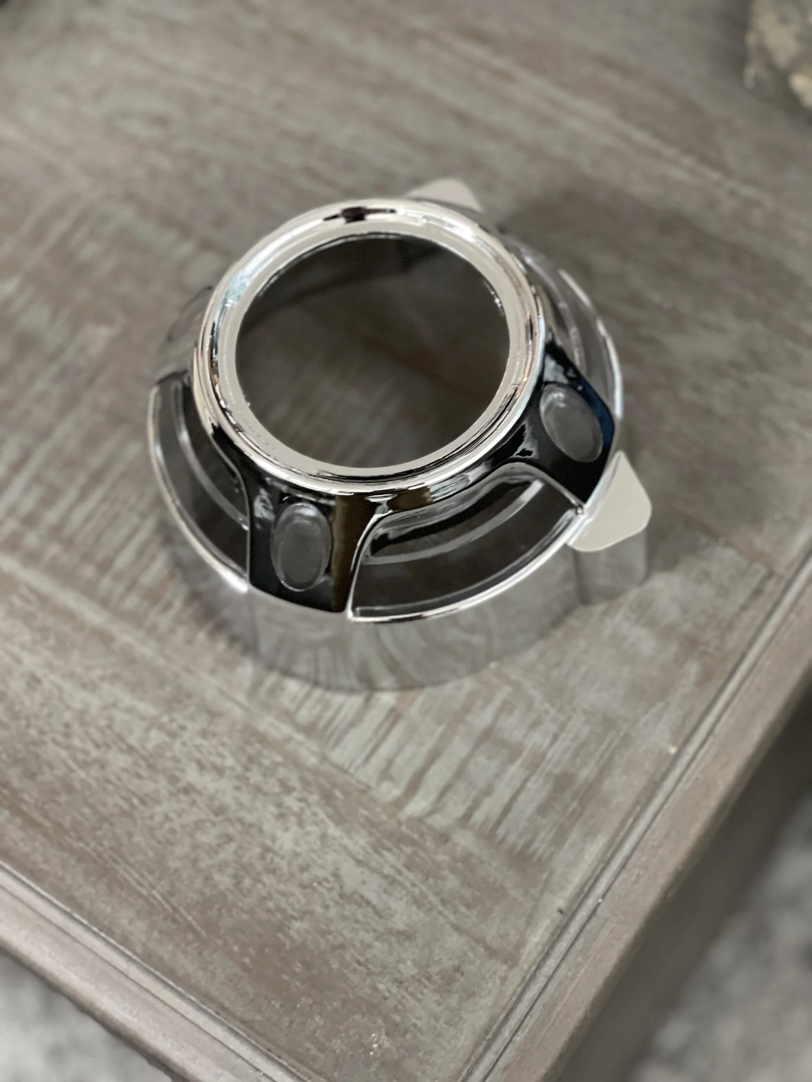

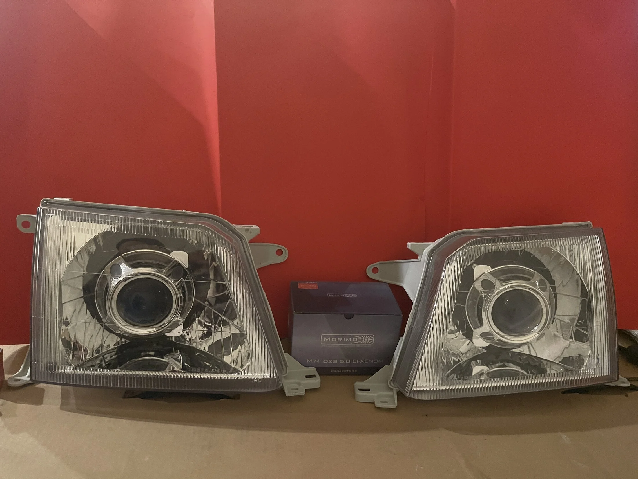

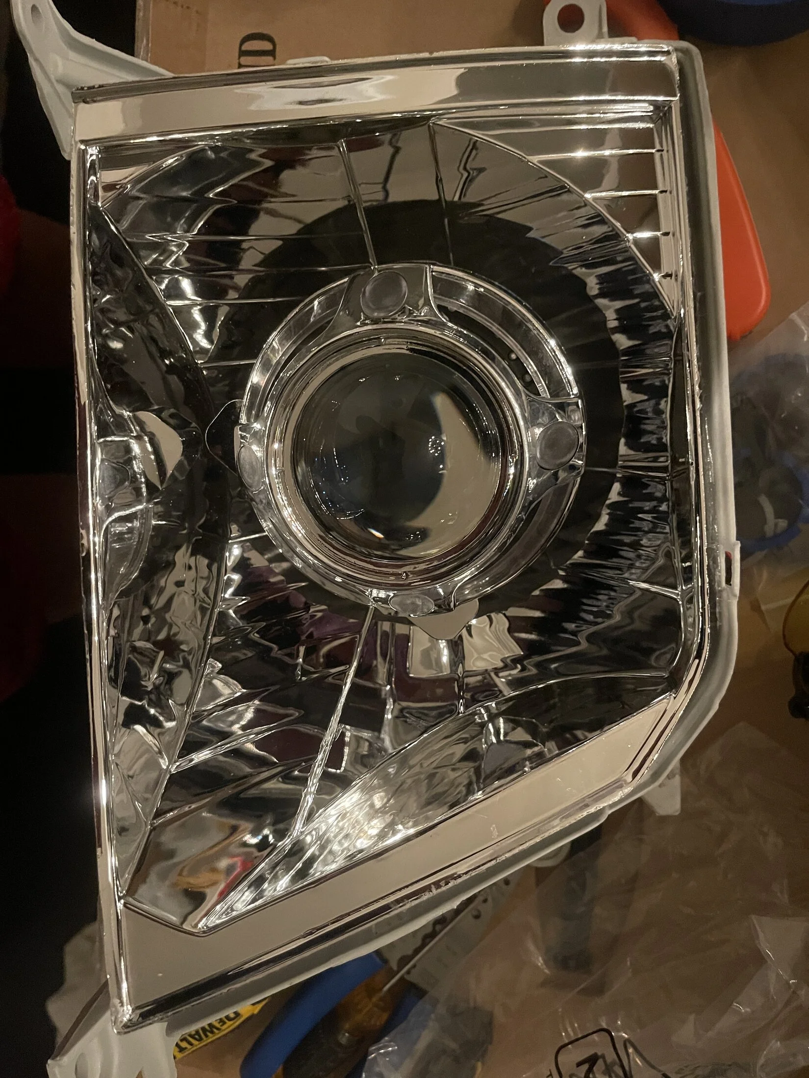

All done!!! Because the weather in asia is humid I opted not to wire in the bixenon part…I run it in every retrofit but because I can’t overnight these parts, I will wire some aux fogs as the hi-beams so I am relying on no mechanical parts to get the hi-beam on. Maybe I am overthinking but…it is the decision for the time being
