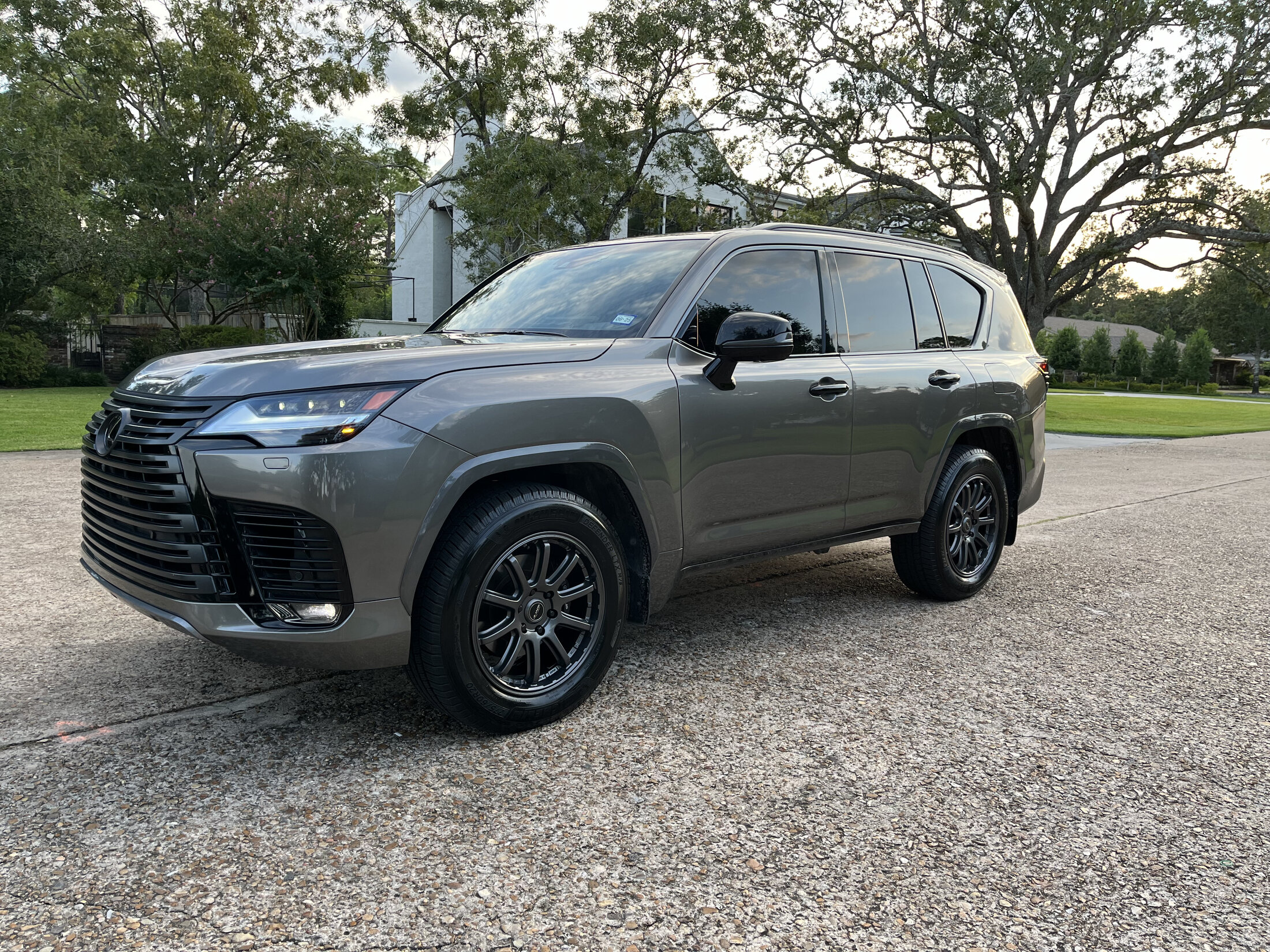

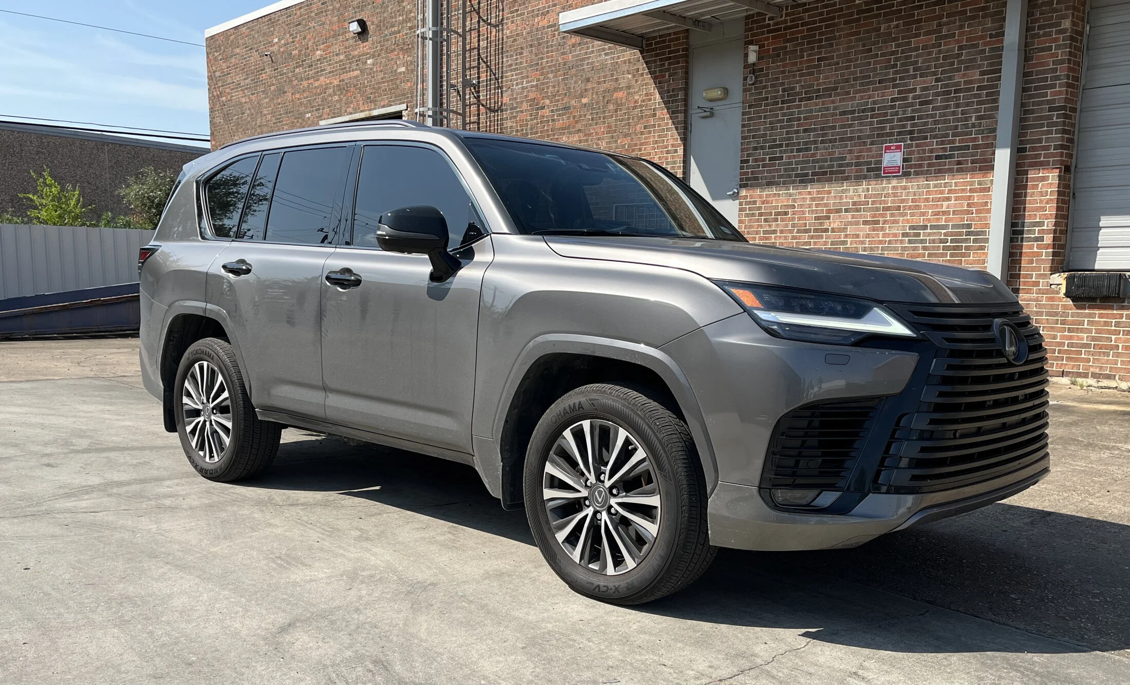

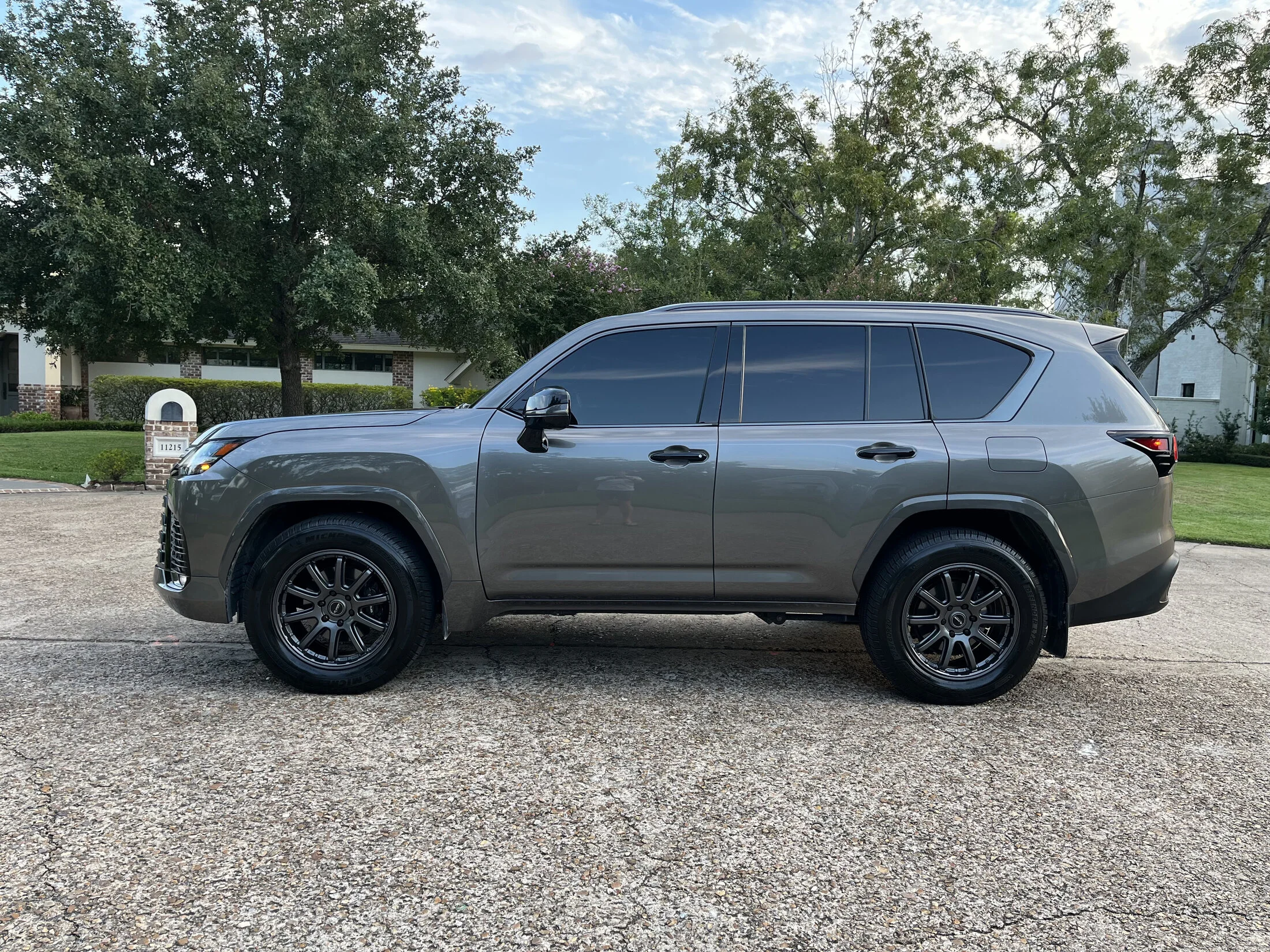

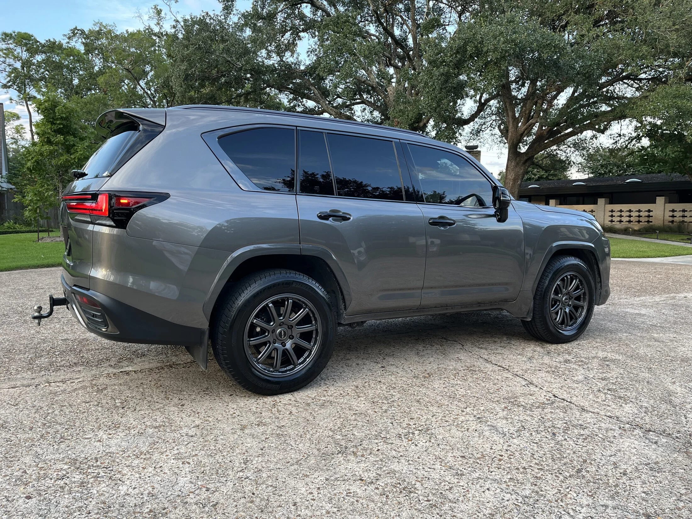

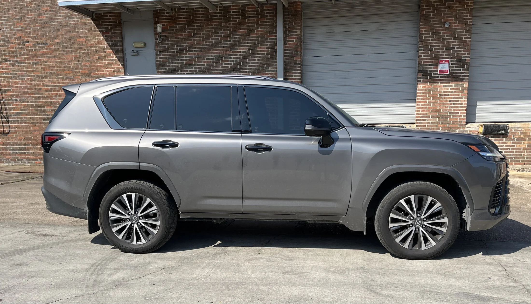

I wanted to get rid of some of the nose down look of the LX600, but most of the shops I spoke with wanted to gut the AVS on the Premium model and replace with standard springs and struts. I was not convinced that removal of the AVS would not light up the dash, and I think the AVS works well and wanted to keep the system. I ran across a shop that installed a 3" spacer lift from Wescott Designs, using a 200 Series kit, so I decided to roll the dice. I ordered two Toyota 200 series LC strut spacers 43136-60020, and @duggy Duggy's Garage performed the install and perfectly dialed in the alignment. Measured from the center of the wheel hub to the top of the wheel well, the front of the vehicle went up an inch: from 19" to 20". Subtle, but happy with the outcome. A few weeks earlier I had purchased a set of used Jaos wheels and tires from @ElvezTX , a super cool dude, and those went on after a wash down. With any luck my teenage daughters will quit making fun of the car....

I wanted to get rid of some of the nose down look of the LX600, but most of the shops I spoke with wanted to gut the AVS on the Premium model and replace with standard springs and struts. I was not convinced that removal of the AVS would not light up the dash, and I think the AVS works well and wanted to keep the system. I ran across a shop that installed a 3" spacer lift from Wescott Designs, using a 200 Series kit, so I decided to roll the dice. I ordered two Toyota 200 series LC strut spacers 43136-60020, and @duggy Duggy's Garage performed the install and perfectly dialed in the alignment. Measured from the center of the wheel hub to the top of the wheel well, the front of the vehicle went up an inch: from 19" to 20". Subtle, but happy with the outcome. A few weeks earlier I had purchased a set of used Jaos wheels and tires from @ElvezTX , a super cool dude, and those went on after a wash down. With any luck my teenage daughters will quit making fun of the car....View attachment 3727249View attachment 3727250View attachment 3727251View attachment 3727252View attachment 3727253
I think it sits perfect! Are those 275/60/20?
