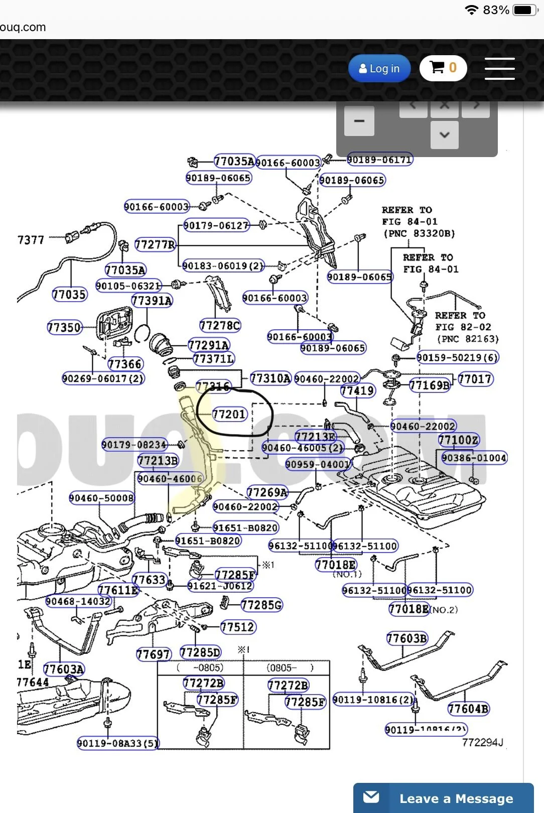

Any pics or tips to install the factory fuel filler neck? I have a FSM coming this week, but started and didn’t expect this replacement to be complicated. There must be some trick I’m missing to get the neck in place between the body and frame. Removed the breather box but still doesn’t seem to want to fit through and into place.
Part# 77201-60C40
