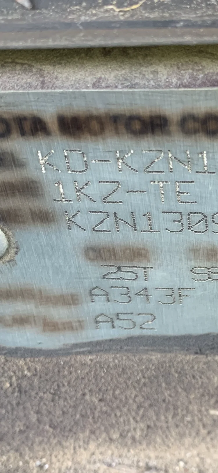

Has anyone done a 1kz-te swap in a 1st gen 4Runner? I have a complete 94 surf with bad frame and body so I’d like to swap the motor and trans into my 87 4Runner, the only issue that I’m worried about is the wiring, thanks in advance
You sure it is a 1kz-te and not a 1kz-t? Does it have the e-throttle etc? I'm sure it is possible but the wiring is going to stress you tf out if it has the e-throttle and the million sensors.
If it is a mechanical pump 1kz-t, with the cable throttle, i would say it is certainly more attainable
