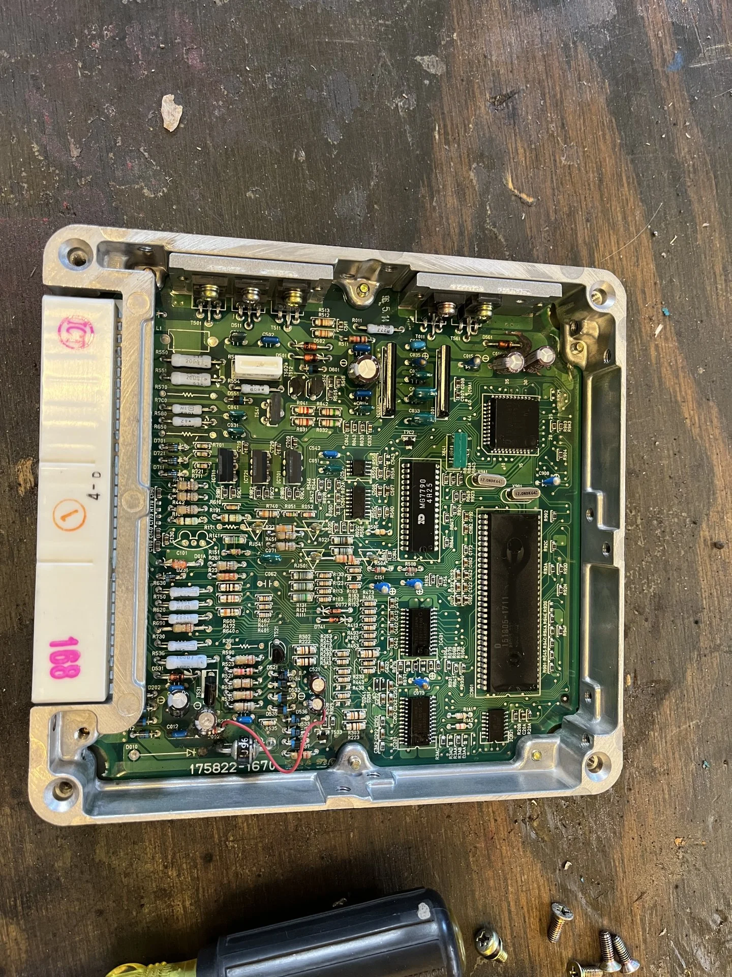

When I pulled the ECU the first time, there was a wire soldered onto the top side of the board. I thought it looked funny, but there wasn't really any indication that it had been tampered with or that the unit had been removed from the vehicle previously. I couldn't find a picture of the ECU from a 90 series with an A/T, so I shrugged and went on. Here's the pic from earlier in the thread, for reference... you can see the red wire in the bottom left hand corner.

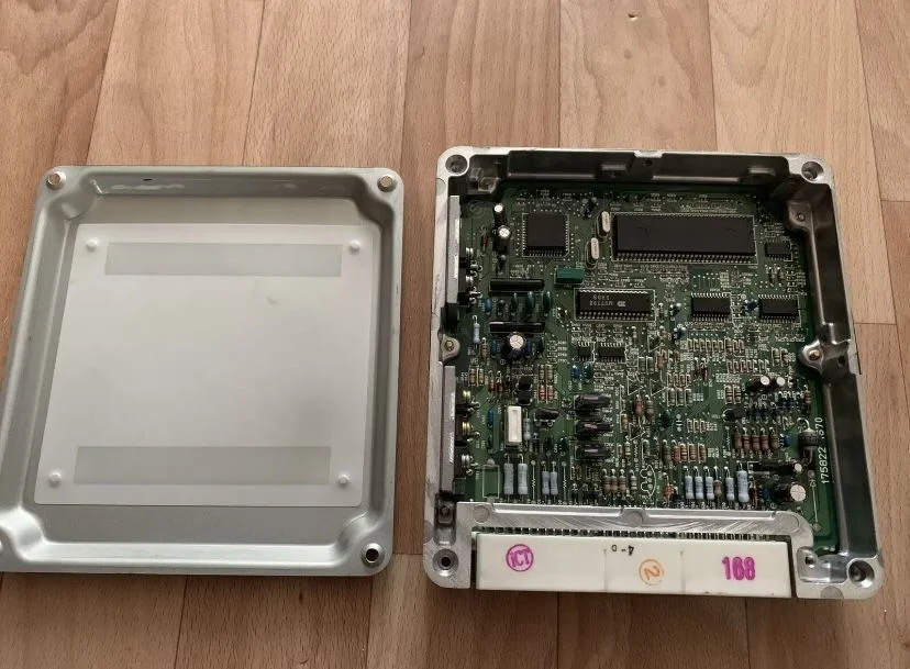

Well, lo and behold last night some guy in Latvia had 2 1KZ-TE ECUs for a 90 series A/T up on eBay, complete with pictures. Here's the picture from his listing...
The numbers on the circuit board match, but there's no wire between those two diodes. Needless to say, I ordered one of the used ECUs the guy has post-haste.
Still not sure what conclusions to draw here. This must be the reason the truck was sent to auction in the first place, and I'm re-tracing some Japanese mechanic's steps in diagnosing the intermittent fuel starvation issue. I'm guessing someone jumpered between the two diodes to bypass part of the ECU board, and maybe made similar modifications to the FSV? If this was a gas engine, I'd be concluding that there was an issue somewhere in the closed-loop fueling that's not happening in open-loop mode. When the engine is cold, or when it's in park or neutral, I'm assuming it's in open-loop fueling and giving the engine a pre-calculated amount of fuel. Once it's good and hot it seems to switch to another mode that struggles to give the engine enough fuel? But for a gas engine, the "loop" is completed with O2 sensor data, which this motor doesn't have. So basically I'm lost.
But I do know the resistance reading on the new FSV is correct, and that red wire, whatever it's for, is not supposed to be on the ECU. Used ECU is on order.
