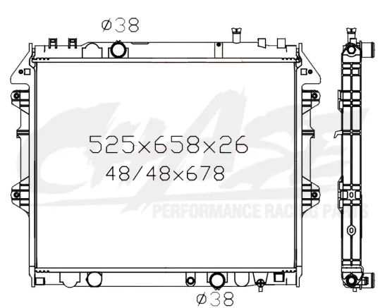

Radiators are specific to vehicles more than to engines so a '1KD radiator' could be many things.
Given that the radiator will not come from a 70 Series, the answer to your question will almost certainly be no (without modifications).
Hey all, will a 1kd radiator fit into a 70 series Prado? Thanks a lot
KUN (Hilux) radiator
