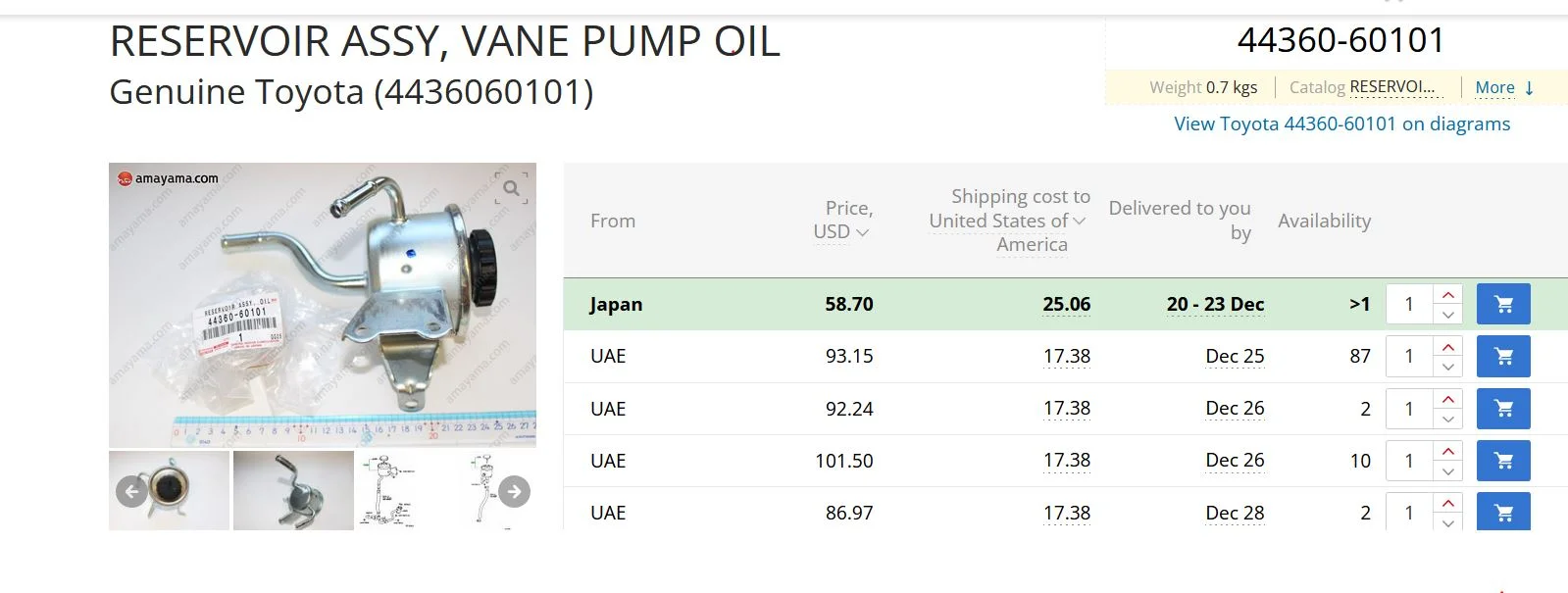

It's a common problem that these leak between the container and the lid where they are pressed together.
I do keep them in stock locally.
