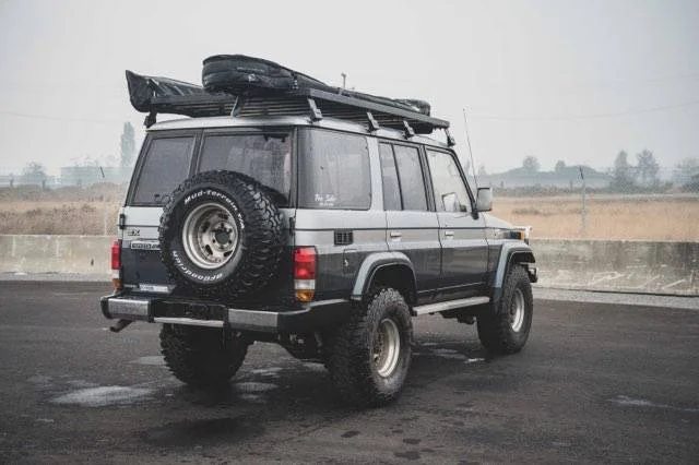

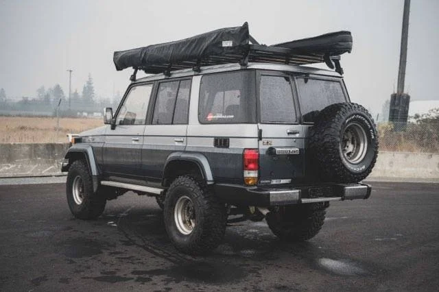

Hey so I am new to diesel cruisers, but I have the bug bad, am looking to purchase one. I flew from Denver to Washington to look at a rig and ultimately had to say no, the issue was an oil leak, it seems to be seeping where the bellhousing bolts to the block. On the top of the engine where the top of the bellhousing is bolted to the block it also seemed to have a little oil weeping out.
I took brake cleaner and cleaned the bottom of the engine, went for a 10 minute test drive, and upon returning a noticeable amount of oil had gathered in that spot.
Is this indicative of a head issue that runs down the back of the engine?
Or something else? The owner replaced the rear main seal when he replaced the clutch 1000 miles ago.
Any help is appreciated, I'm not out of the running on this rig, but I did not feel comfortable driving it 1300 miles home without knowing what it could be.

Well that's the conundrum, 1991 hzj77.
Body was in fantastic shape.
Interior was worn but OK.
300k kms.
Owner put new dobinsons springs and shocks.
Full front axle rebuild, birfs and brakes.
Timing belt
Tensioner
Pulley
Turbo
Manifold
Catchcan
Air filter
Straight pipe exhasut
Heavy duty Clutch
Pressure plate
Throw out bearing
Pilot bearing
Steering rod ends
Knuckle and trunion bearings felts
Front rotors and pads
Dobinsons 2.5" Leaf springs and shocks
Manual hub conversion
35" kanati Mud hogs
Front runner rack
Big country 4x4 awning
Auber EGT gauge
Factory Toyota 24v winch, factory Toyota bumper.
He's around $30k
