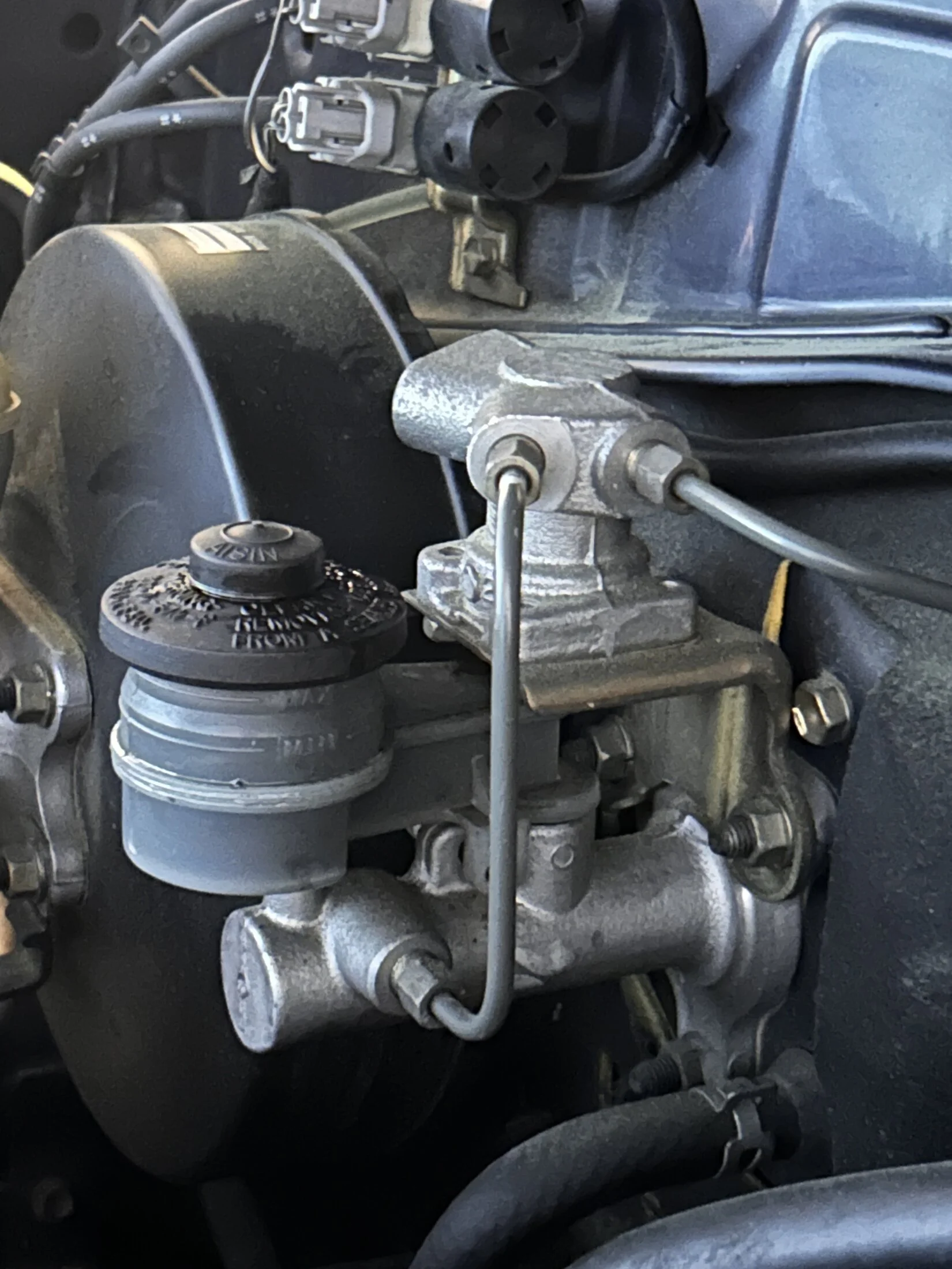

Hi folks, I have a leaking clutch slave and want to replace both slave and master. Looking at Partsouq and not really sure what to get. Is there a kit? Looking for some part numbers to search... Also for the 1HZ, where is the best place to get the drive belts?

Give us more information. What year truck? What market? Boosted or non-boosted clutch? What tranmission: H55F or R151F?
Drive belts available from any Toyota dealer: 90916-02452 (2 belt set) and the AC belt will be dependent on year.
My bad, here are the specs: 1995 HZJ73, RHD-JDM, H55F. I also found on the side it says AISIN 3/4
Found the parts:
3147060161CYLINDER ASSY, CLUTCH RELEASE (PartSouq)Toyota52.43$
3140160060CYLINDER ASSY, CLUTCH MASTER (PartSouq)Toyota103.03$
9933211260BELT, V (COOLER COMPRESSOR TO CRANKSHAFT PULLEY) (Amayama)Toyota15.02$
9091602452BELT, V(FOR FAN & ALTERNATOR) (PartSouq)Toyota36.07$
