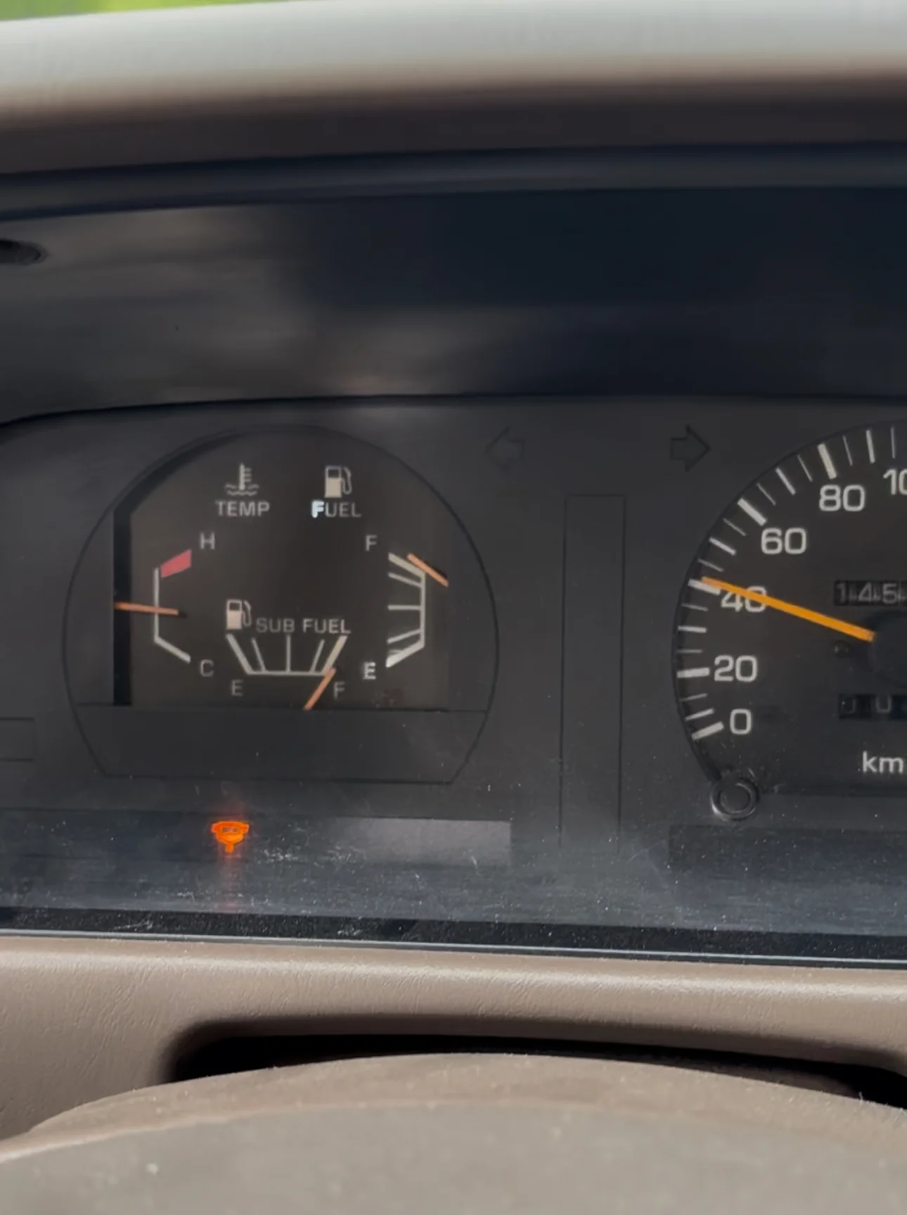

Just curious if anyone has any intel on the dash light signal that not only lights up a sumbol very close to a ‘cup drip’ like signal on the dash, but also has a high piercing ring/signal?
It’s still ringing in my ears after a 10 min ride back home… lol

This indicator lights up when too much water accumulates in the fuel filter.
This came after a full tank? You need to drain the water from the fuel filter maybe even replace fuel filter if you are already there. I hear it can also happen from a clogged fuel tank breather
FWIW one option once the water is drained out (Ryco water separating fuel filter)
