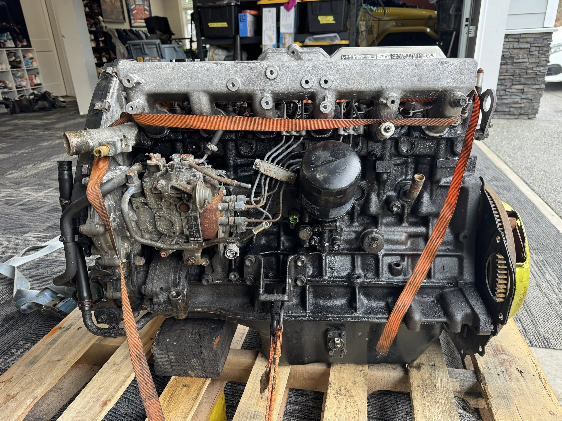

Hey all, results came back from the machine shop, and the Troopy needs a new head. Anyone have one laying around that’s already been tested? Figured I’d check before going to shell out for one at the dealer.

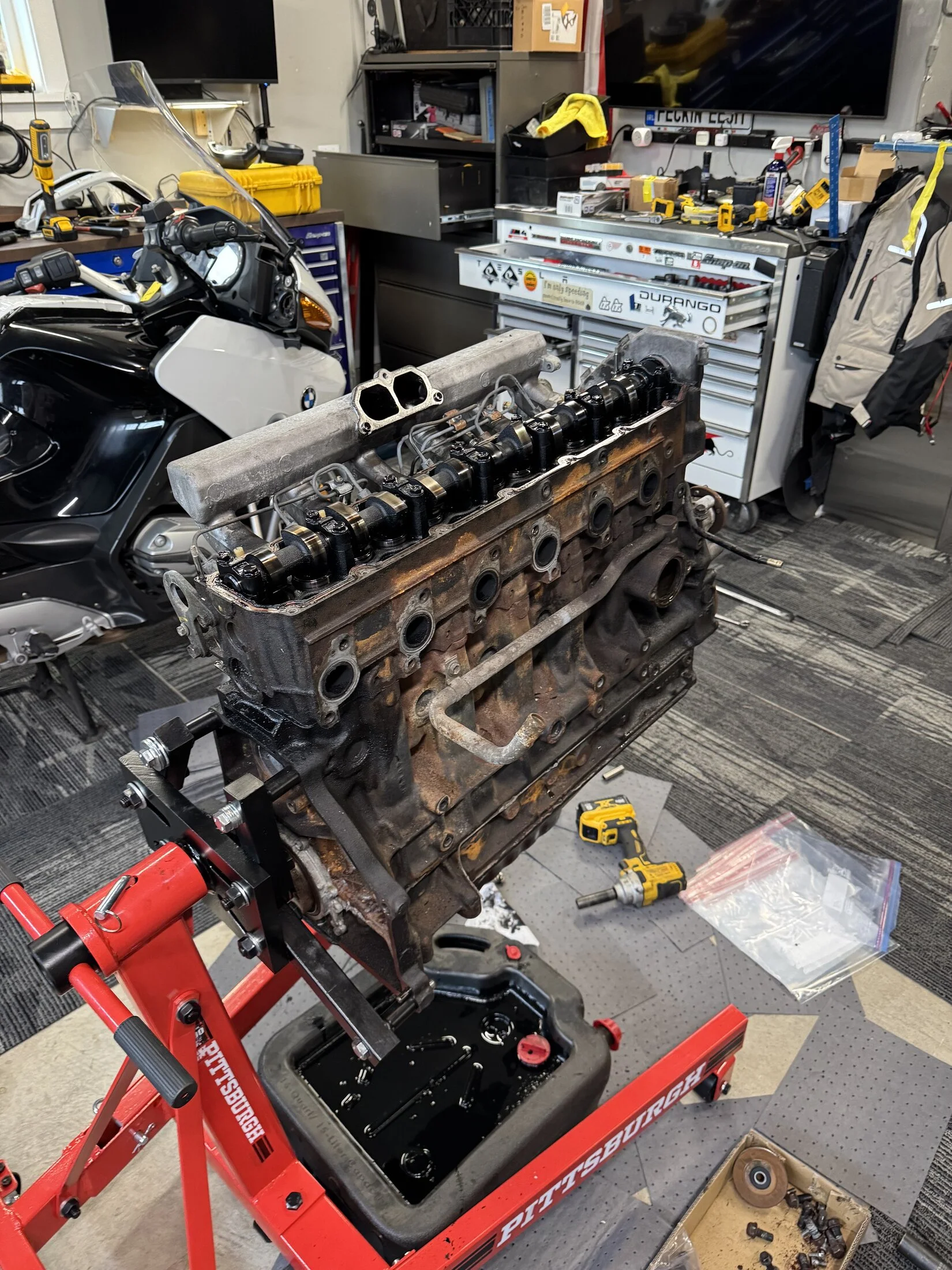

So far:
.5 over pistongs/rings
New bottom bearings and cam bearings
Crank polish
New head
Complete engine gasket set
Oem water pump/timing belt
Oem clutch kit
Injectors being rebuilt
Oem rad/hoses
Oem thermostat
Glow plugs
Motor mounts
Any other recommendations while this thing is apart?
