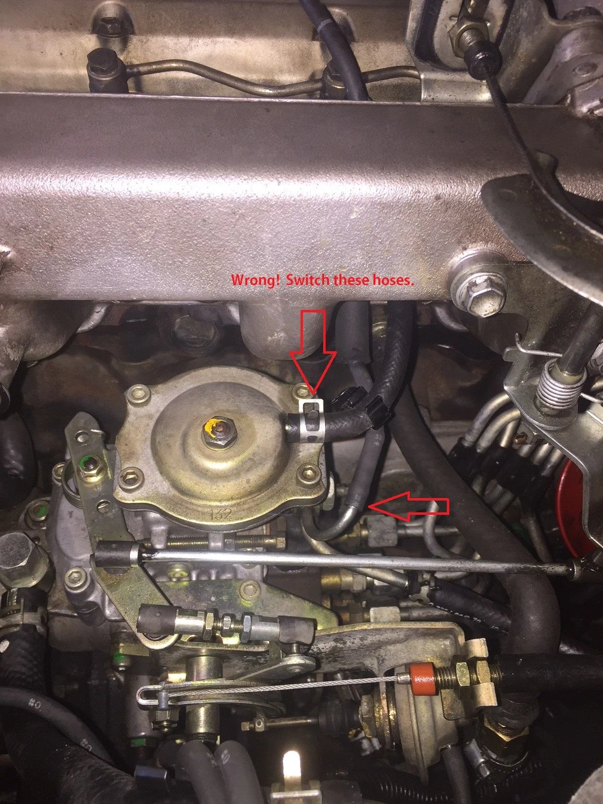

Ok guys, good news. It's all fixed! Turns out when you switch the boost vacuum hose with a fuel return hose, problems arise. The small hose goes on top of the pump diaphram, the larger hose with the clamp goes on the fuel return outlet off the pump. This is probably a mistake due to working on the truck until 330am one night.
Anyways, we swapped those hoses then tackled the locked engine. Pulled the glowplugs, turned the engine over by hand and fuel gushed, and I mean GUSHED out of 3 cylinders in their own time. Put the plugs back in, aligned the pump and away we went. Checked all the lines and injector nuts too, everything was A-OK.

Good news. Ive never heard of that happening before. So basically your fuel return was pumping diesel in via the inlet manifold?

Yep, @roscoFJ73 I'm pretty sure that's what was happening. Flooding all the cylinders via the intake inlet because I had the fuel return line pumping fuel through there. Where, normally, that hose pulls boost pressure and pushes on the diaphragm to add more fuel in the pump. Correct me if I'm wrong.
There is a lot of fuel coming out of the fuel return. The feed pump draws in far more than the engine needs and uses the excess to cool the pump which is returned to the tank.
