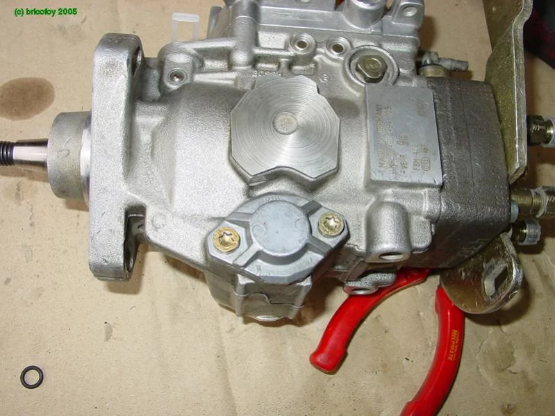

You could build your own, but it is actually cheap to buy. It is a very common part in most diesel pumps, including Bosch and Zexel, most diesel shop carry it. Search the threads for ACSD . I attached a pic for you (was posted by a fellow member, credit to him), which you can print and take it with you to the diesel shop so they know what you are talking about. I also attached a second pic showing a similar plate installed in what apperas to be a VW Bosch pump just to show they are interchangeable.
You will need an O-Ring, Two Allen (or Torx) bolts and the plate itself. I found a shop here which could source the parts for 23 C$. I had them fit them too because it was too bloody cold to do it in my unheated garage..

pretty easy job to remove the acsd and fit the plate. several people (myself included) have done it with good results.
