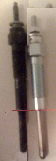

I've played around with the image you posted before and aligned the two plugs according to how they'll sit in an engine with the red line marking where each will seat in the cylinder head:
Big differences!
Most alarming to me is the difference in where the thread lies.
:beer:
edit: I should say "should seat" rather than "will seat" because the plug dimensions are so different that one may not seat at all in the way it is supposed to (IMO).
I would install the old plugs, mark the threads (or note how many threads are showing) once completely threaded in and then do the same for the replacements. Then remove them and compare the difference.
I assure you there is no interference with mine and they appear to be identical.
