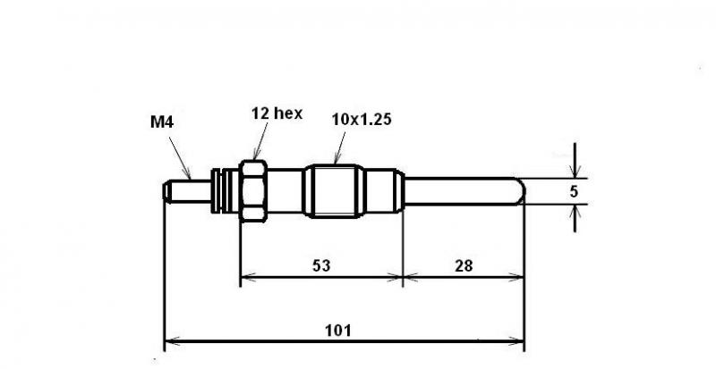

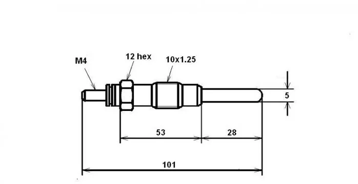

I don't know enough about this engine to say which plug is correct for it (and you can research the matter as well as I can).
But those two plugs don't look to me to be equivalant to one another. In other words - I suspect they're meant for different engines.
No matter what brand of plug I buy, the dimensions should conform almost exactly to a standard.
I found this stored on my computer so I think it is the dimension standard for my particular plugs:
So I think you should double-check you've got the correct plugs there before fitting them.
:beer:
