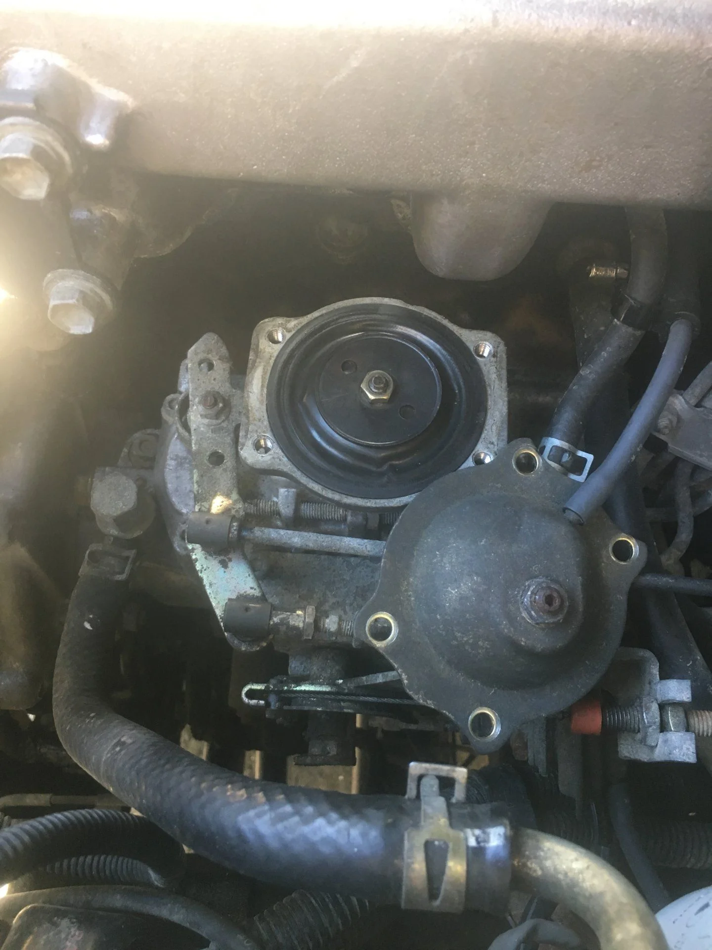

I was trying to reduce the smoke at idle so I took the top off the boost compensator to see where the off boost screw was at on the circular ramp. I also did one full revolution 360. of the diaphragm just to feel the tension and gauge where its at. I did not pull it up more than a mm or 2
I put it all back together and now I have the same idle but absolutely no throttle response, nothing, the truck is idling but moving the throttle does nothing.

thanks guys, my main concern is that when I pulled or twisted the fuel pin could I have dislodged the guide pin? because there was no sign of a guide pin stopping the fuel pin going in again.

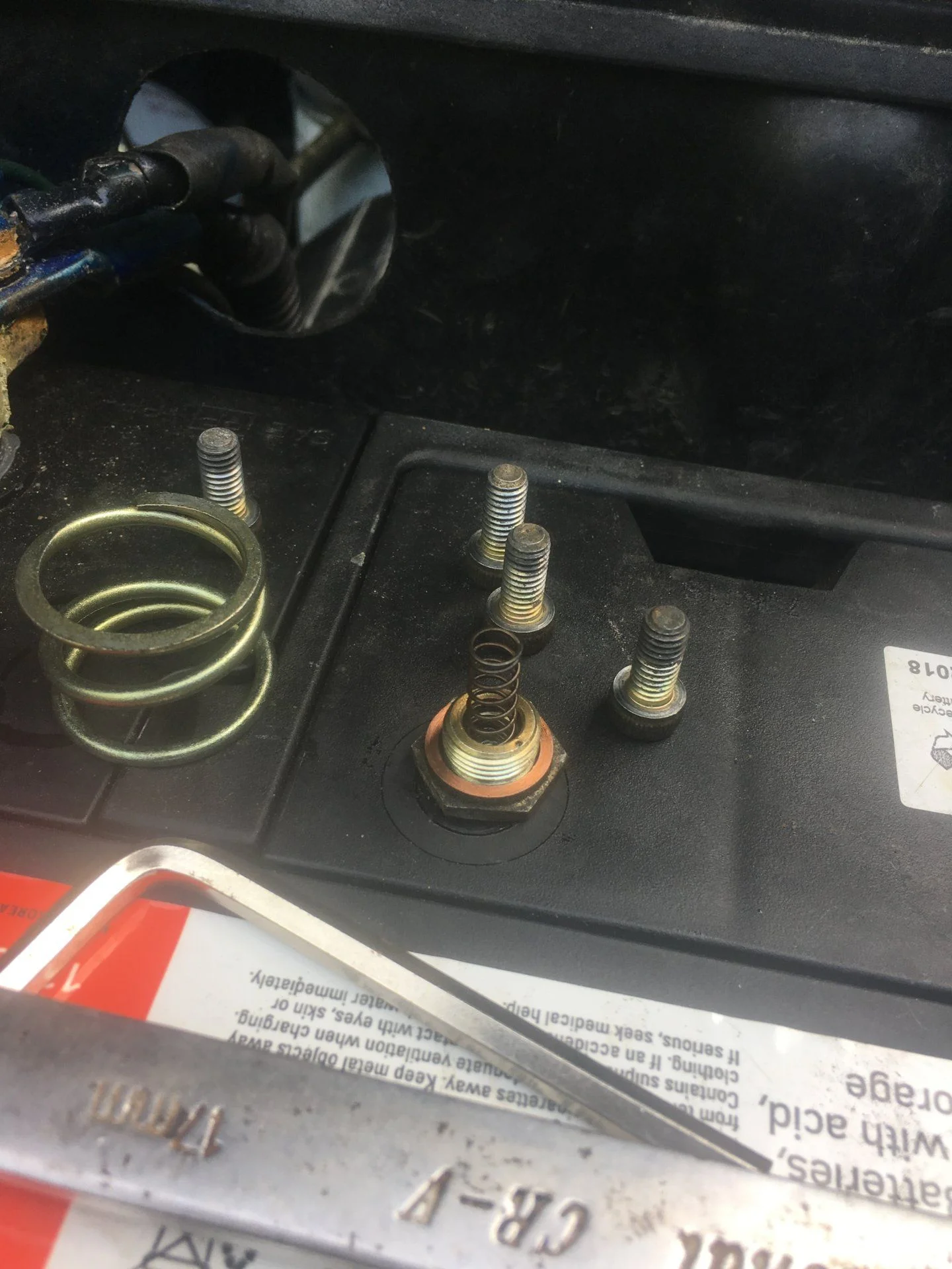

following this I undid the 17mm bolt that holds the guide pin, the bolt had a spring behind it but no sign of a guide pin...
worried I need to get it to a diesel mechanic...
all the mechanical linkage is correct afaik, it's a jdm model also if that matters

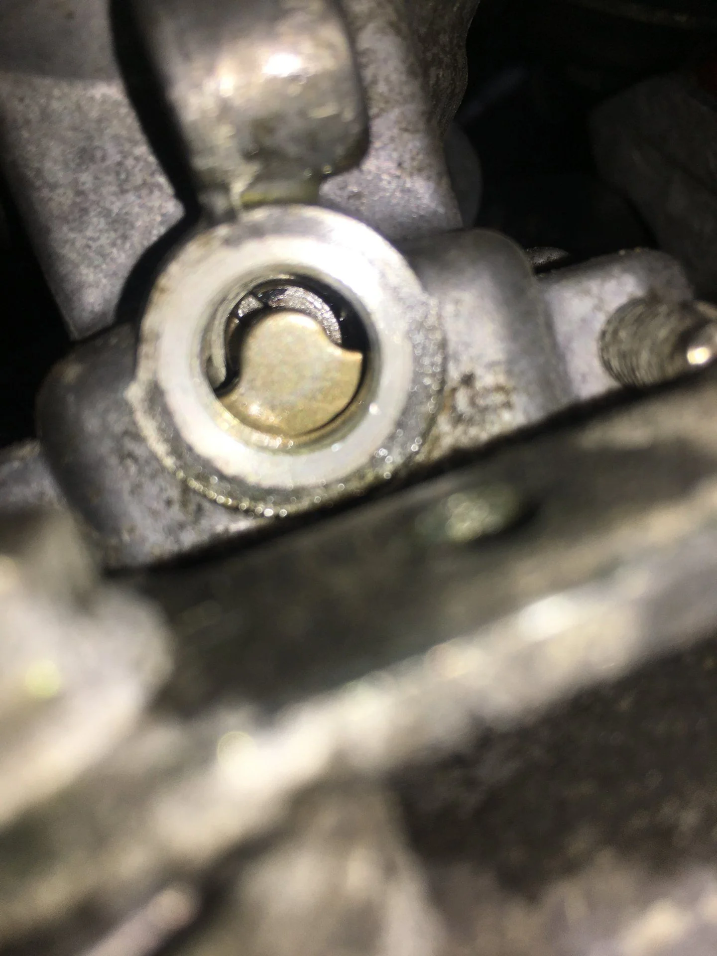

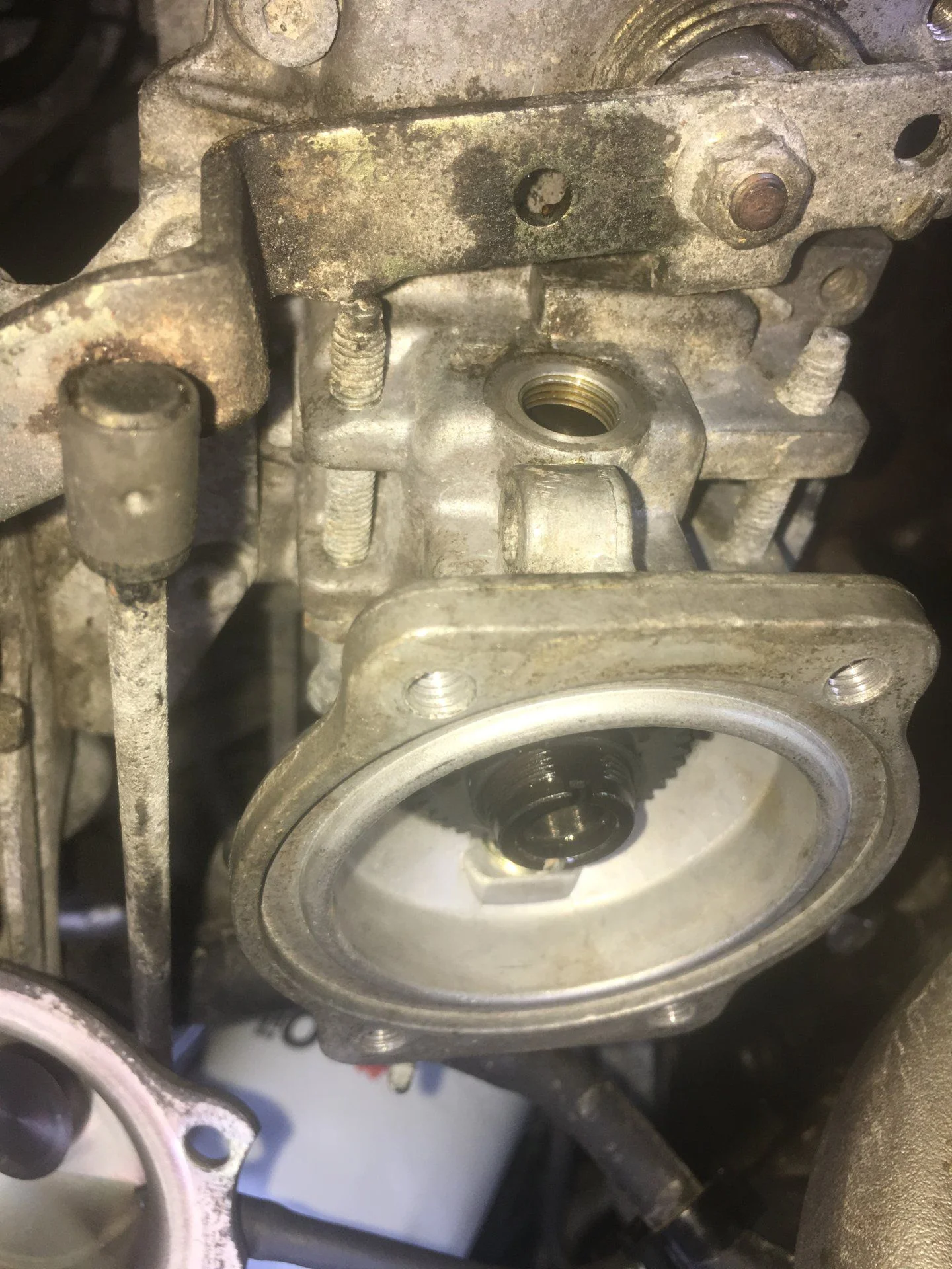

Can you see the guide pin? I had issues with my 1HZ pump when I turbo'd it and added the boost compensator housing. I had to remove the full load screw and reinstalled the compensator housing. I think the linkage inside was restricted somehow when I first installed the boost comp housing.
You should be able to see the guide pin if you look down into the sleeve where the aneroid / boost compensator pin goes.
With the 17mm plug and spring out, you should be able to gently push the guide pin out of the way to reinstall boost compensator pin.
The pin can't fall into the pump, but it could possibly fall out when the 17mm plug was removed (but unlikely).

This is what Im thinking, it fell forward into the cavity below where the diaphram sits.
Thanks heaps.

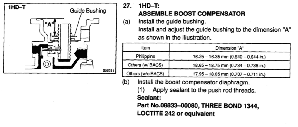

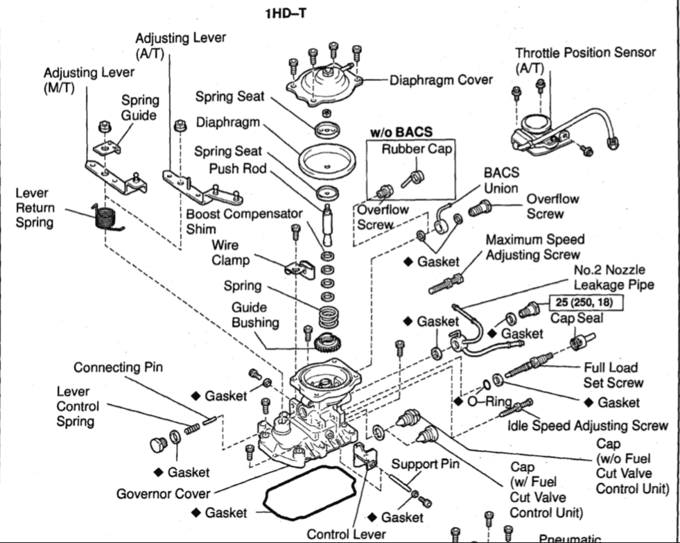

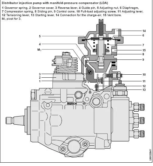

My current thinking was along the same lines, I had a really good look in the cavity after removing the boost compensator pin, fished around with tweezers but no luck finding the pin, I am 100% confident it didn't come out when I removed the 17mm nut, not convinced from the photos and diagrams attached that its possible for the pin to fall out.
The other thing I am trying to clarify is according to the LCOOL instructions you can feel the tension change as you rotate the diaphragm and pin assembly, I can still feel this change, is that tension against the guide pin?
Also the boost compensator obviously affects the throttle response and tune however at low RPM there is no boost yet there is still throttle response. Like davegonz said he added a compensator to the 1HZ pump. is my fiddling with the compensator actually the cause of these problems or is it just coincidental that something else in the pump went wrong. I would expect the tune to go to s*** but not to loose any throttle response.

the 2nd diagram doesn't clarify but the "lever control spring" and "connecting pin" look like they go in together, but I think the "control lever" actually separates those two parts.
yes, you are correct. The control lever separates the spring and the guide pin. This means the guide pin can't fall out of the housing, and it should be too long to fall into the boost compensator housing.
The LCCOL instructions i think are a bit confusing. Also written a long time ago now and a bit generic. These pumps are better understood by more people now. There's good info in the "official 1HD-T pump tuning thread" if you have time to read it. Start from about page 40
the control lever acts on the governor spring and lever inside the main body of the pump. If you remove the top of the pump (boost compensator housing) as @davegonz suggests, you need to be careful not to stretch, or dislodge the governor springs

Davegonz thanks heaps, I am interested in how the governor works differently on NA and turbo pumps, the governor seems key to all of this which if connected to the compensator would directly affect rev limits, this would mean that the the compensator would be a key component of the issues I am having.
for example if the governor spring broke or jammed could that be holding the revs at idle?

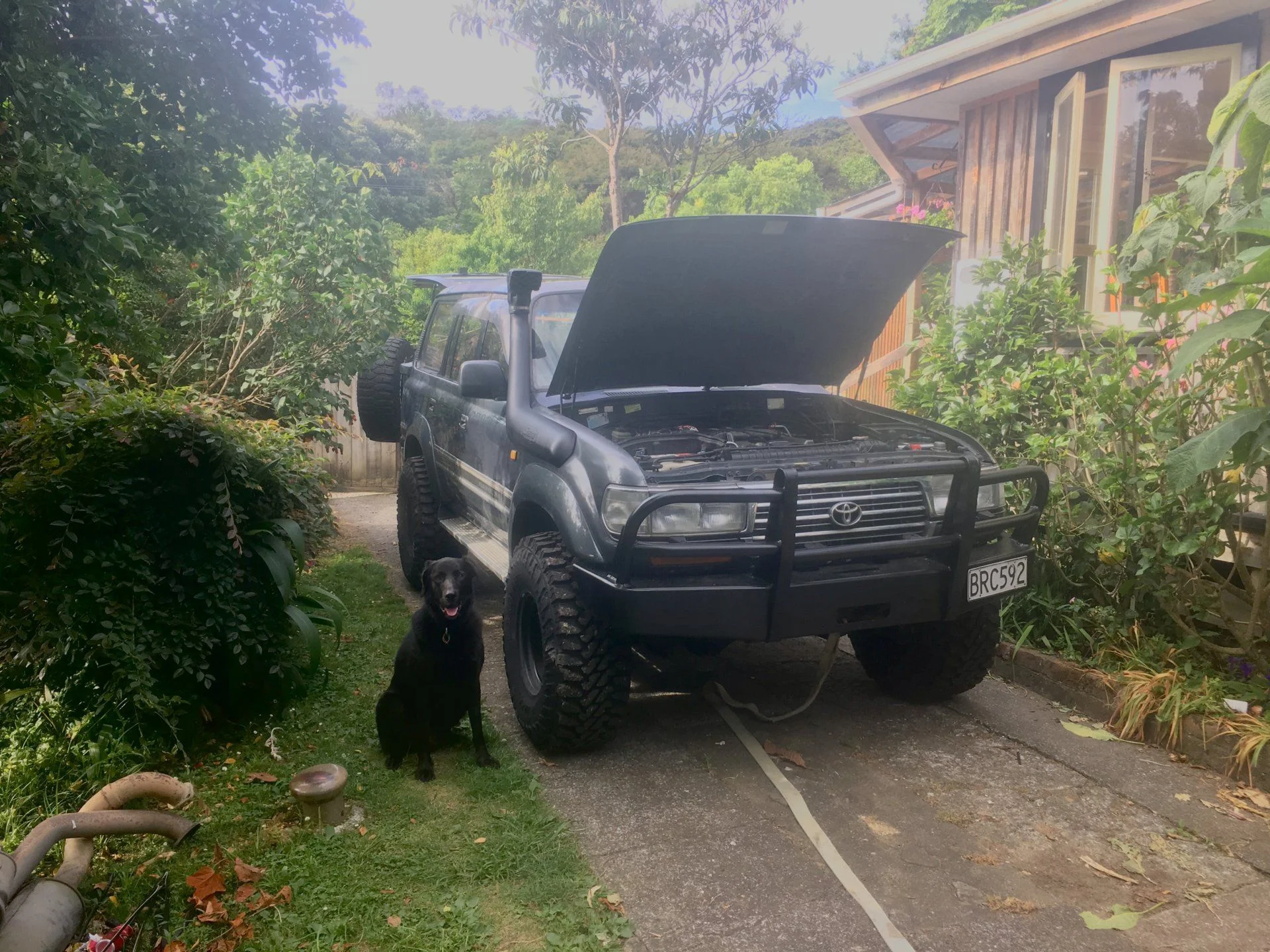

just for context, this is what we are working on and this driveway lined with rose bushes is the closest thing I have to a garage.

The boost compensator works with the governor lever. It limits how far the governor can move when off boost, and allows the governor lever to travel further toward maximum fuel as boost builds.
