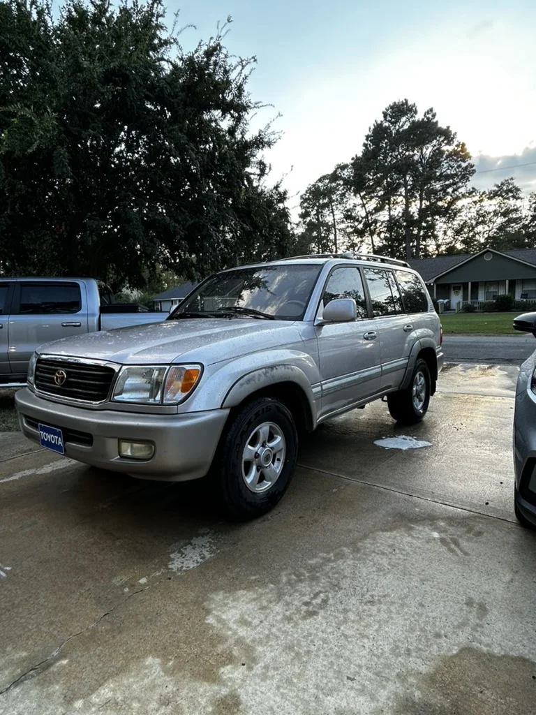

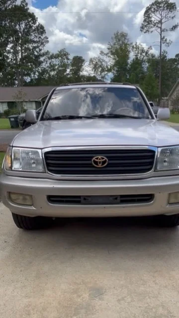

What's up fellow Land Cruiser enthusiasts. New to the site but have been browsing constantly since I purchased my (new to me) 1999 100 series Land Cruiser.
Alittle about the vehicle:
1999 Land Cruiser - Paid 6500$ USD. Champagne color. Southern vehicle with no rust. 300k miles, 4wd, automatic 4 speed, heated leather seats, locking differentials, optional 3rd row - the whole package. Found on FB marketplace in my local area and was used as a family hauler for all of its life. Never been off road or abused from seller history.
Alittle rough around the edges on exterior cosmetically - has some dings, minor scratches on bumpers, trim panels and fenders worn, paint clear coat is patchy, weather stripping is decaying around windows, roof rack paint is stripped, and rims are sub optimal in appearance BUT it certainly still has some life left in it with alittle TLC.
Interior wise is about the same - interior trim panels are worn around shifter/window controls and its dated (but i mean the car is 26 years old so who cares, its a Land Cruiser), carpet could use a good scrubbing but otherwise holding up well. Leather is damn near perfect and I'm amazed at the condition that the seats are in. All electronics work and everything is original. Heated seats work, antenna still goes up, rear vent windows operational, and AC/heat blows the doors off so I mean what more could a guy want?? From a functional standpoint everything is operational.
Underneath the hood (4.7 L V8) everything checks out but I have limited experience in anything engine related so hopefully this site will aid in any future issues that occur (fingers crossed they dont but who knows). Checked for any signs of oil leaks etc before purchase (and still havent noticed any) but didnt spot any so hopefully it holds up. Timing chain replaced at 285k, oil changed every 5k according to seller. Shifts well and is an easy riding piece of machinery - really amazed at how well built these vehicles are.
As far as I can tell the car still has original OEM for everything - zero upgrades - straight up kid hauler and grocery getter. Even has the old sticky juice on the seats to prove it.
Initial plan is just give the thing an overhaul of proventative mainetence so any suggestions on that would be much appreciated. So far I've gathered the heater T's, timing chain, and braking system are major potential issues that should be addressed up front. Anything else? fluid flush, suspension replacement - shoot me some advice on these issues please. Going to use this as my daily cruiser for work, hunting, and really whatever - I just enjoy being in the damn thing. My wife doesnt understand but I told her all that she needed to know is that this thing is cool and its the pinnacle of reliable engineering.
So far I've given it a much needed bath on the extrior and interior but it could definitely used a more intense detail. Removed running boards recently and slapped on a toyota front tag my dad had laying around. Tires are a must very soon so thats probably the next upgrade. +/- about upgrading original stereo and have been browsing possible OME 2 inch lift later on.
I've always been a LC fan and never thought I'd own one but the stars have aligned and I want to think I got a decent deal on a rig that has alot of potential. So far this thing has provided alot of enjoyment despite it having some minor issues - which makes it all the more fun cause I'm basically working with a blank canvas for the most part.
With that being said, glad to be here and am optimistic for what the future holds!
Thank you guys in advance for any advice or suggestions. This community has already revealed an insane amount of knowledge.
