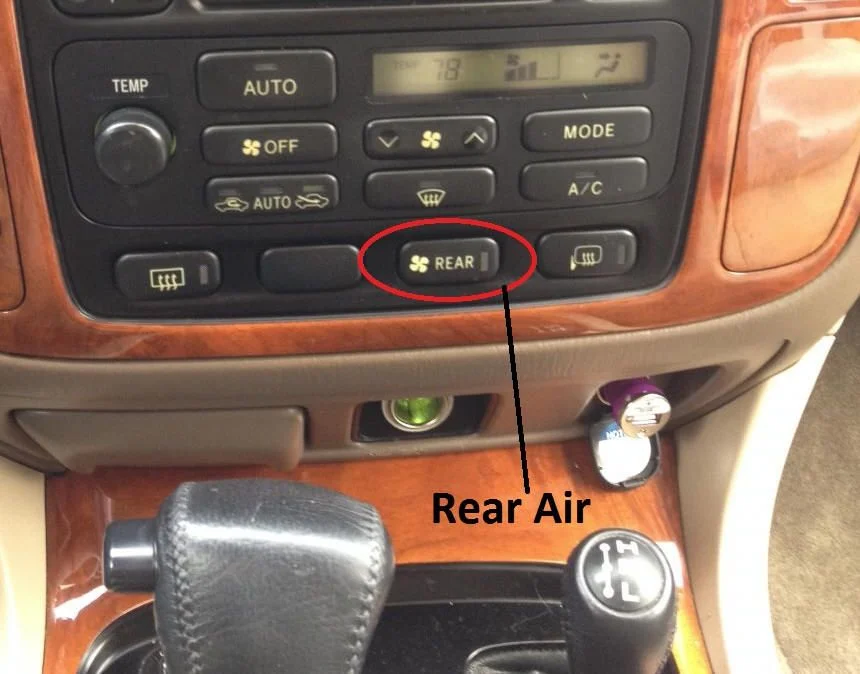

Do you have the Rear A/C button on the center dash area (see pic below):

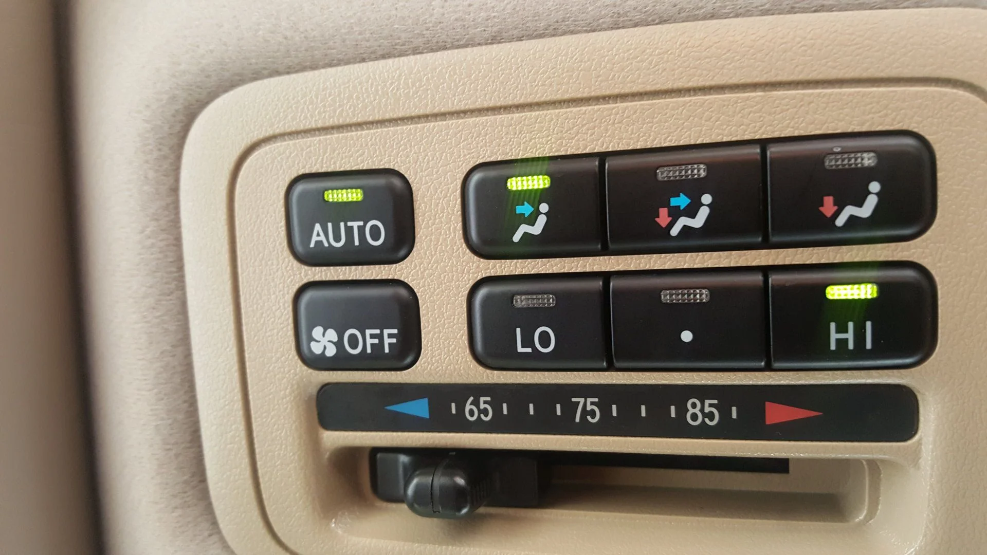

And IF so....do you also have 'controls' in the rear drivers side head liner area:
People in rusty climates often have the rear lines Rust out and opt to have them capped off rather than replace them.
I do have the button but no rear controls. The truck was in the North so I am dealing with the rust quickly. In fact next to the base line maintenance - it's the main thing I'm tackling. I've coated the undercarriage with lubricant and making my way around the trucks underbelly. The rust has been mostly confined to the wheel wheels. All that being said, it's not the worst undercarriage I've seen - all in all pretty solid. The frame is good and the tubs are good. I WILL TAKE YOUR ADVICE AND INSPECT THE BREAK LINES NEXT. Once completed I'll coat everything I can reach! Oh and yes it is a 1998 Lexus LX 470.
