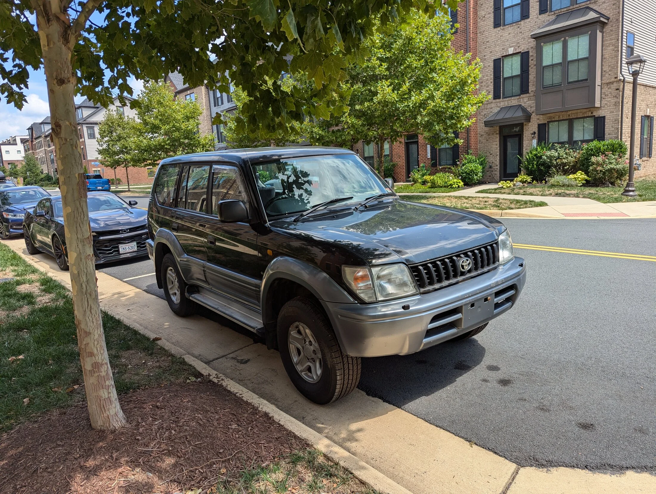

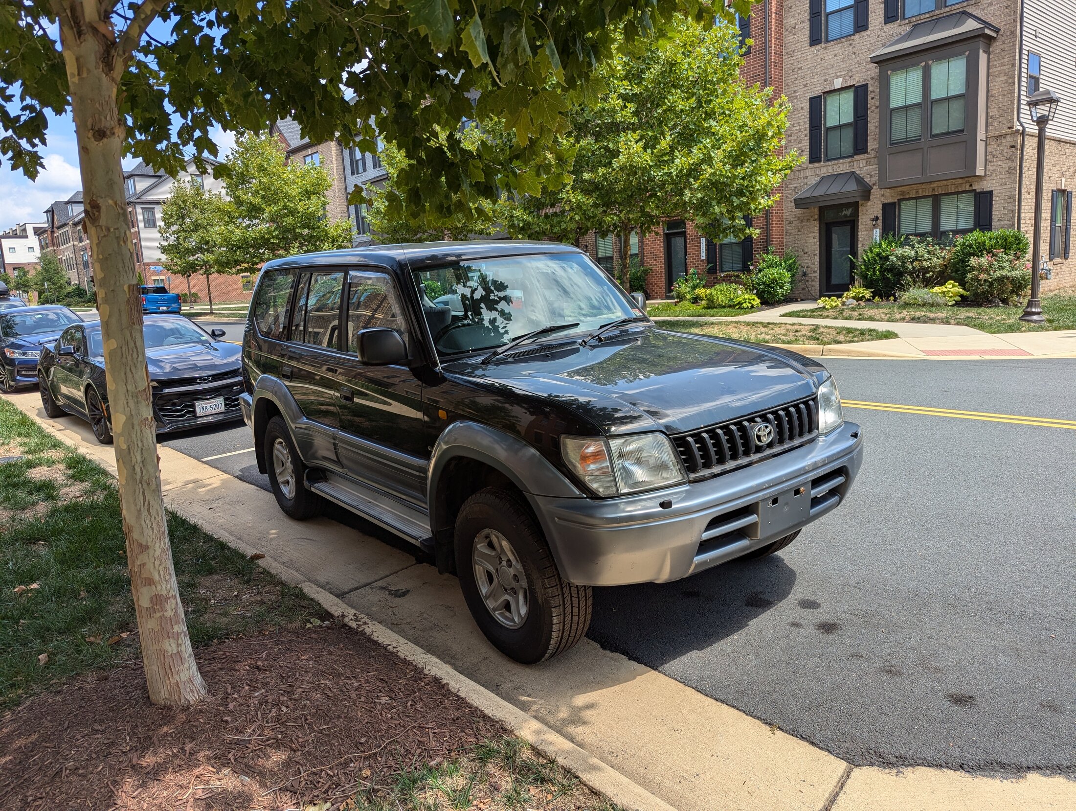

Last year, my Colorado stopped running. Batteries were draining. Lots of issues. Since then, a lot of diagnostics have been performed, but it's still not running. Meaning, it turns over, but doesn't start. The following work has been done:
  1. battery cables have been replaced/fixed
  2. All fuses and relays reviewed, replaced as needed
  3. fuel solenoid has been removed, cleaned, and is now functioning properly
  4. attempt flashing transponder ecu modules and keys
  5. ECU rebuilt
Currently, batteries are holding the charge better, and it is turning over, but still won't start. No fuel getting to injectors. The ECU is throwing a 99 code, which according to my mechanic means that the ECU is bad (just rebuilt) or there's something wrong with the transponder. Still looking for someone locally (Virginia USA - in the Washington DC metro area) to look at this, but no luck so far. Most of the troubleshooting has been done by my mechanic, but he's at a loss. It's under the shade tree looking for help. I can elaborate, but thought I'd start with this.
Thanks, Chris
