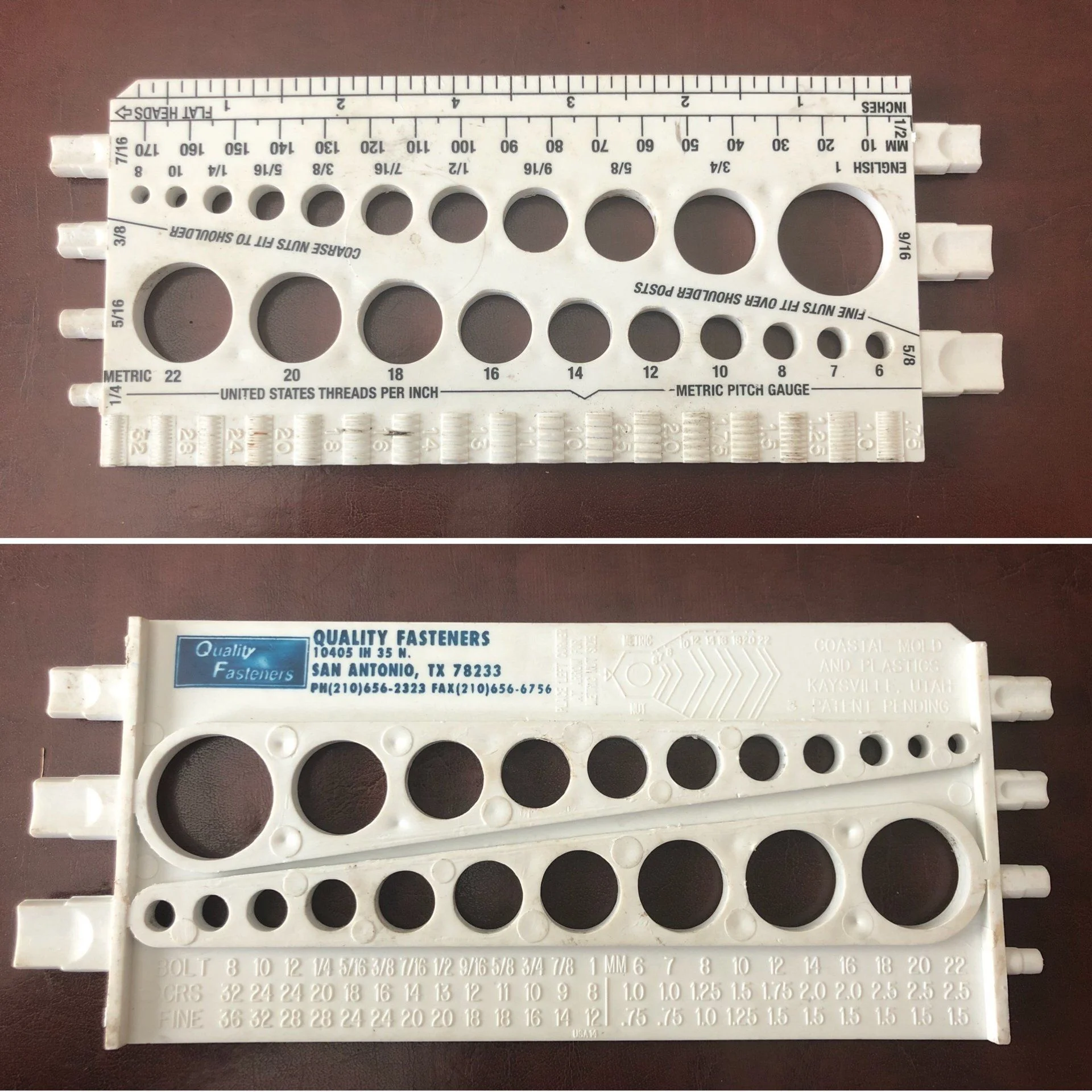

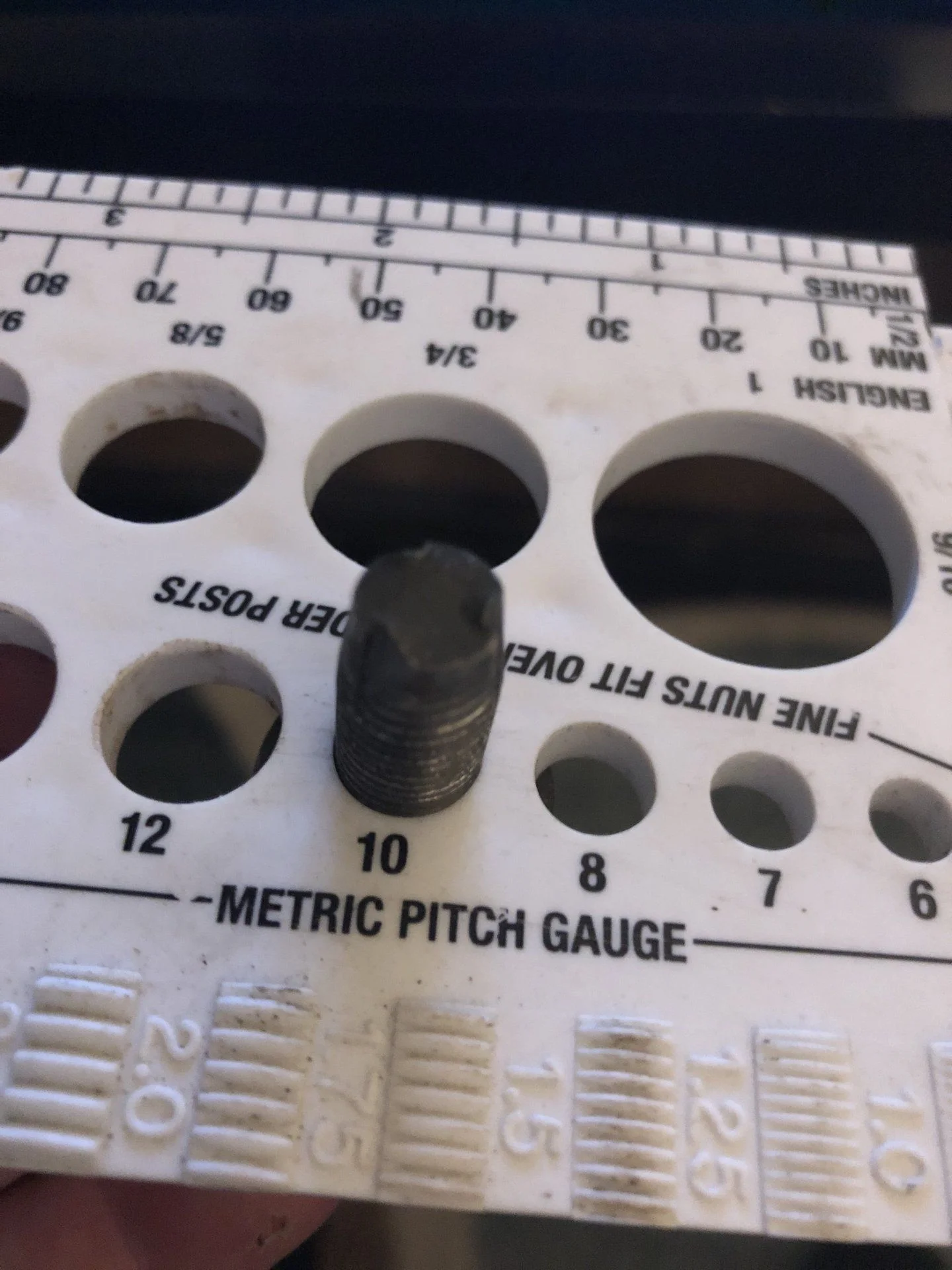

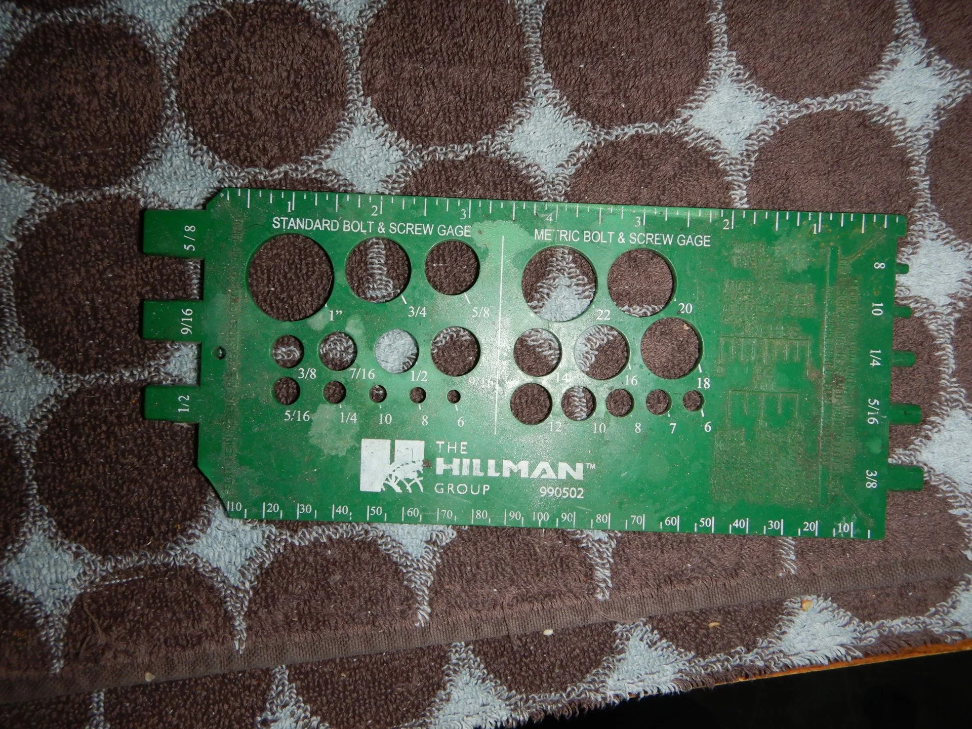

It’s not really unique, just an ordinary nut and bolt gauge you can pickup at most hardware stores. I use mine all the time. I think I got it for free at Fastener store.
I don’t really use it for nuts because there’s just way more bolts on a Cruiser.
Anyway, just take your bolt and slide it into the hole that fits best and then check the thread pitch by laying it across the pitch gauge. Couldn’t be easier.
Here’s an amazon link, but I think you can get these cheaper (or free) locally.
Stainlesstown Nut Bolt Thread Gauge (Blue) https://www.amazon.com/dp/B00XUUGKTC/ref=cm_sw_r_cp_api_4CH1AbFXDAMSR
