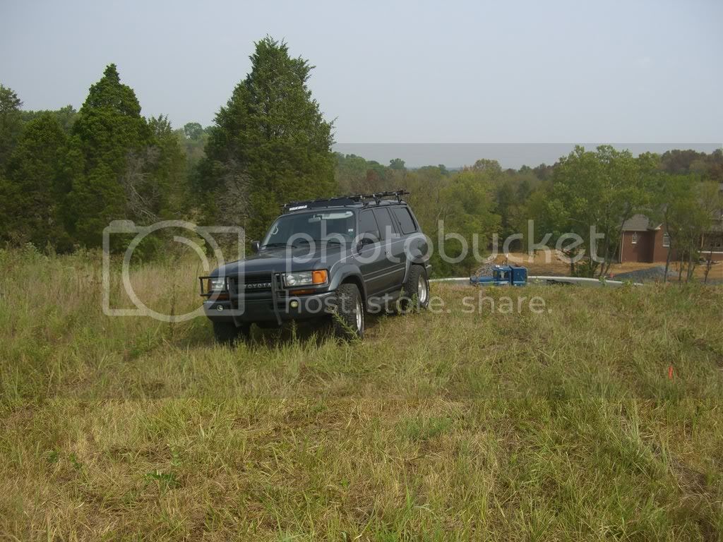

The 3FE is really a tough old bird. no electronics in the tranny's to worry about. If you don't mind a little slowness, your bying a street legal TRACTOR. She'll LOVE you long time!
A pic to get the 3FE power flowing...
