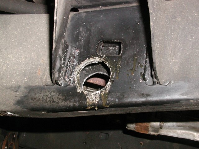

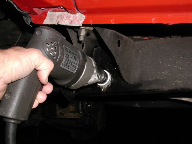

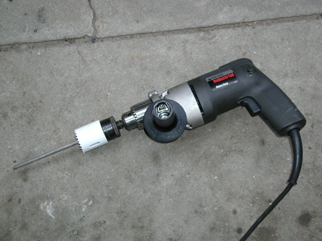

I drilled my holes with a hole saw. I started with a long 1/4" drill bit that I carefully lined up to keep it straight across to the opposite side. Once I had the 1/4" pilot hole drilled, I stuck a long piece of 1/4" rod in the hole saw, and very slowly started cutting away. Lots of cutting fluid, slow speed, hold on tight to the drill (get a real drill, not a cordless one), be patient, it worked great. Very nice neat hole in the frame.
Unfortunately I can't remember the size of the hole saw I used, but you can just match up to the OD of the tube you have, you want it just a little big bigger.
I should add that I have a 1" body lift, that gave me clearer access to fit the drill in.
