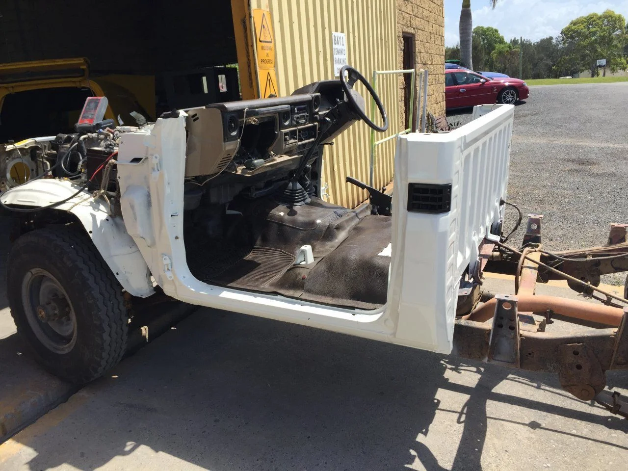

How's your ute going is the paint finished
The panels are done in 058 white to match the pick up tub and the cabin was in the painting bay on Thursday so it should be done by now. I might go up today and snap a few pics while its completely stripped down.
Looking good mate
