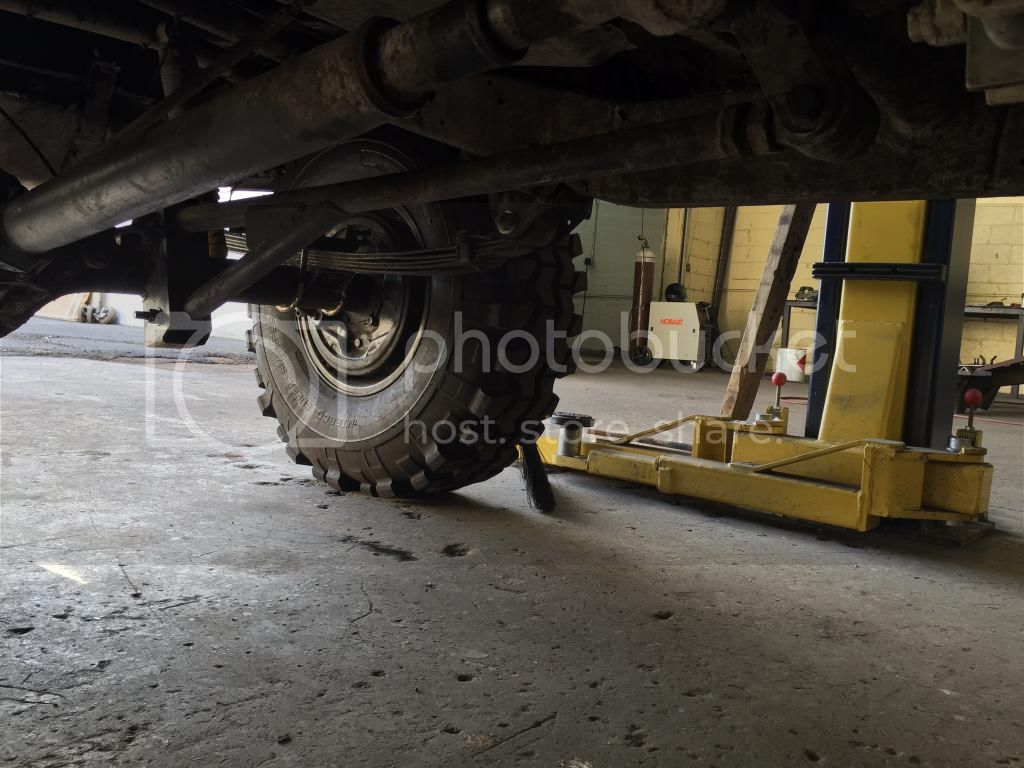

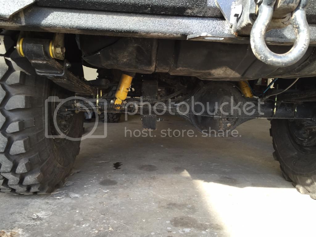

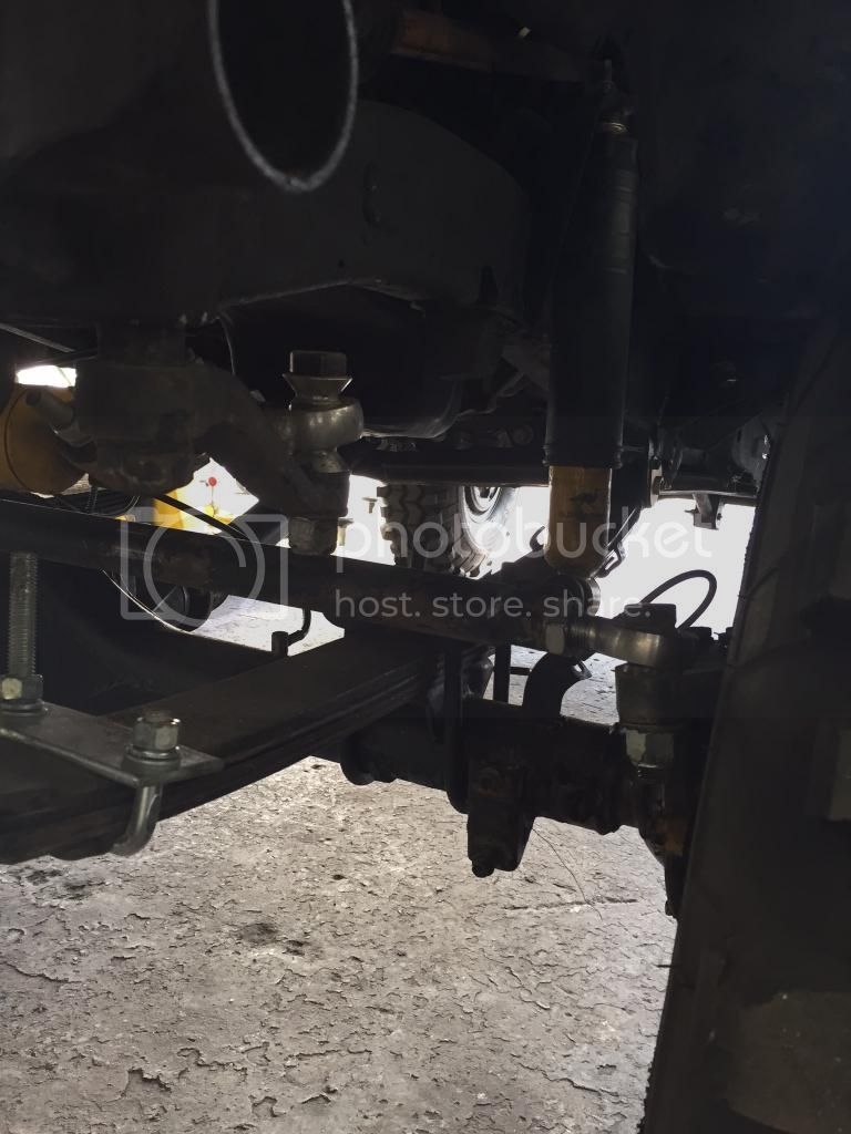

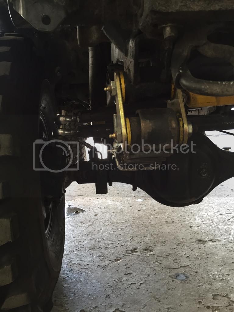

We have been pretty busy at the shop and i didn't have the time to post some of the new mods done to the BJ73, we change the suspension and put the spring over the axles to get more travel, upgrade the stock steering links for a heavy duty high steering and also installed a rear traction bar, the suspension is not fully done yet, this was done quick to get the BJ ready for a wheeling trip.

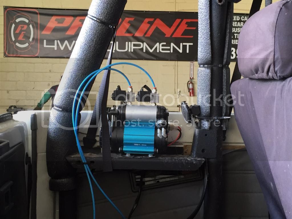

At the same time we installed front and rear ARB lockers and mounted the air compressor to the roll cage

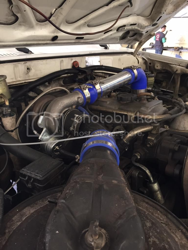

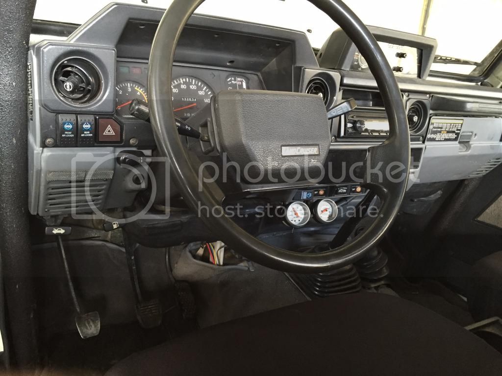

And to get a little more power from the engine we installed a turbo kit from Jefferson State Machining with the Boost Gauge and Pyrometer from Autometer
