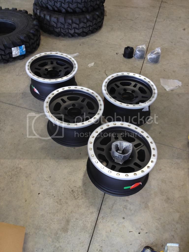

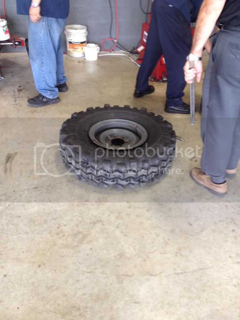

After we finish with the paint it was time to mount the new wheels. That took some work since the original wheels that came with the Bj73 were steel split wheel, not everyone wants or know how to dismount the tires from this. So it took more than 4 trips to different tires shop to get it done, also the big swampers didn't help.
Now time for the new wheels
