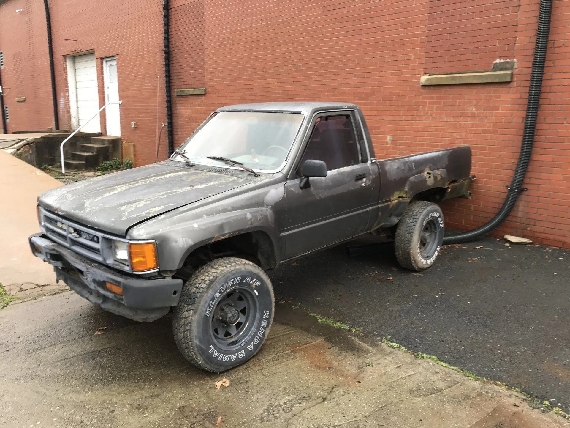

I would creep on on the parts replacement before you start spending a lot of money on stuff that you may not need. (and then there is the stuff that your REALLY need) I would go through the brakes and then just drive it for a while so see what works and what doesn't. My '88 had 280k miles, but many of the parts had been replaced over the years. It drove fine until it didn't. Turns out the fuel pump died so I searched and found a Denzo replacement. That was all well and good until I realized that the rubber line that goes from the tank to the frame is NO LONGER AVAILABLE! What do I do now? I ended up going to the local race shop and converted it to AN fittings and had to mail order metric AN conversion adaptors $$$. The point is that some of the parts that we take for granted cannot be bought for any money anywhere, i.e. clutch slave cylinder rubber lines. The biggest thing that has helped me on my truck, and I HIGHLY recommend is find a cheap doner truck that you can rob parts off of. It will save you a ton of money. I salvaged countless small parts from the $800 truck and then sold it for what I paid for it.

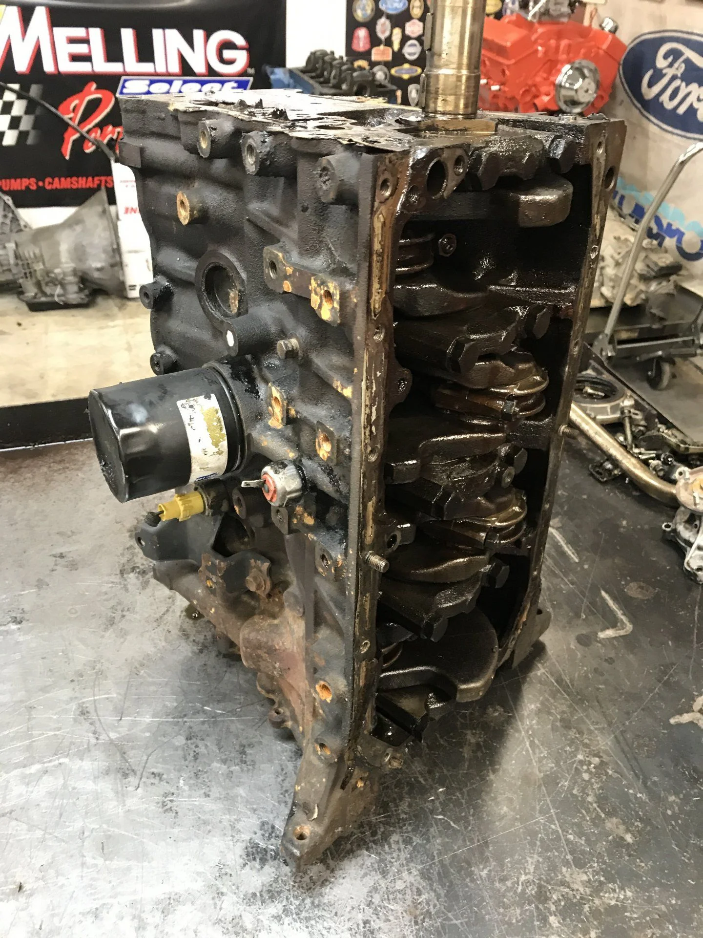

That motor that Rosa and I pulled out of the '87 ended up being the only usable block that I had for rebuilding the 22RE motor. The block surface in the '88 was about as flat
as a waffle.
