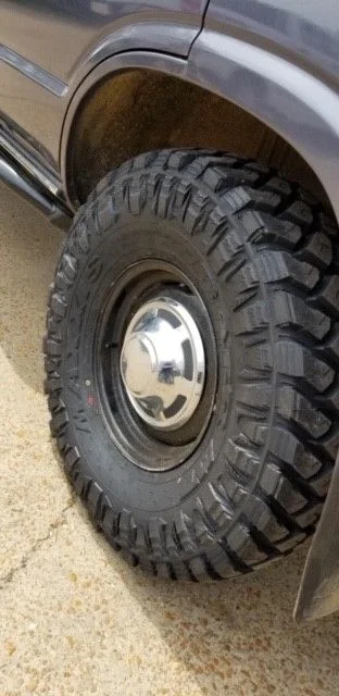

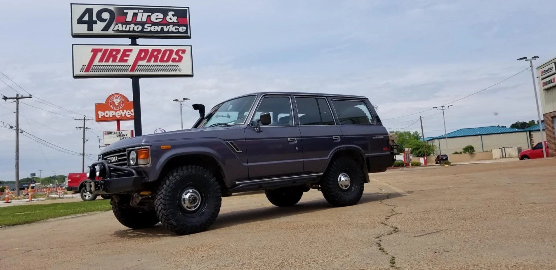

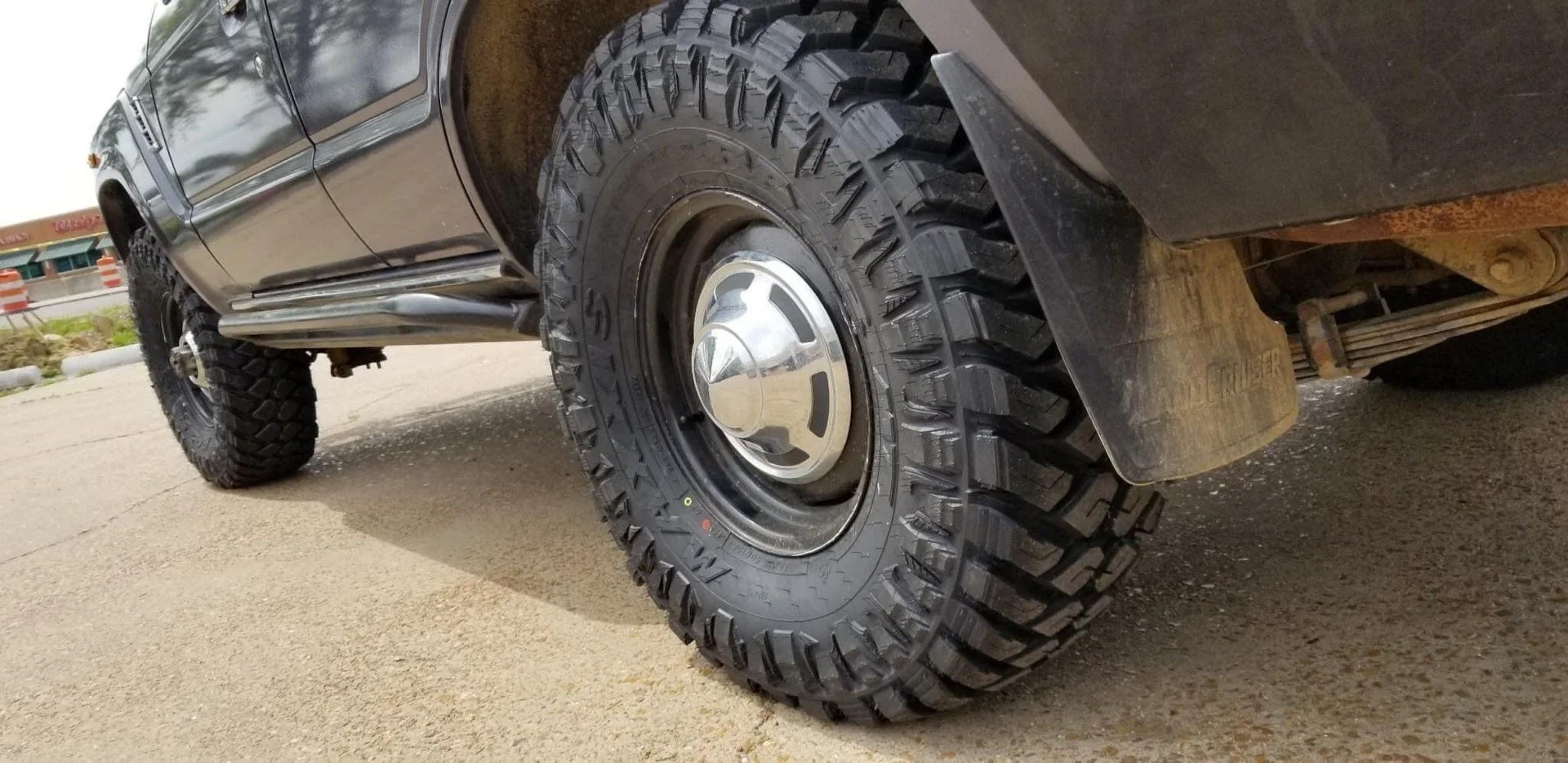

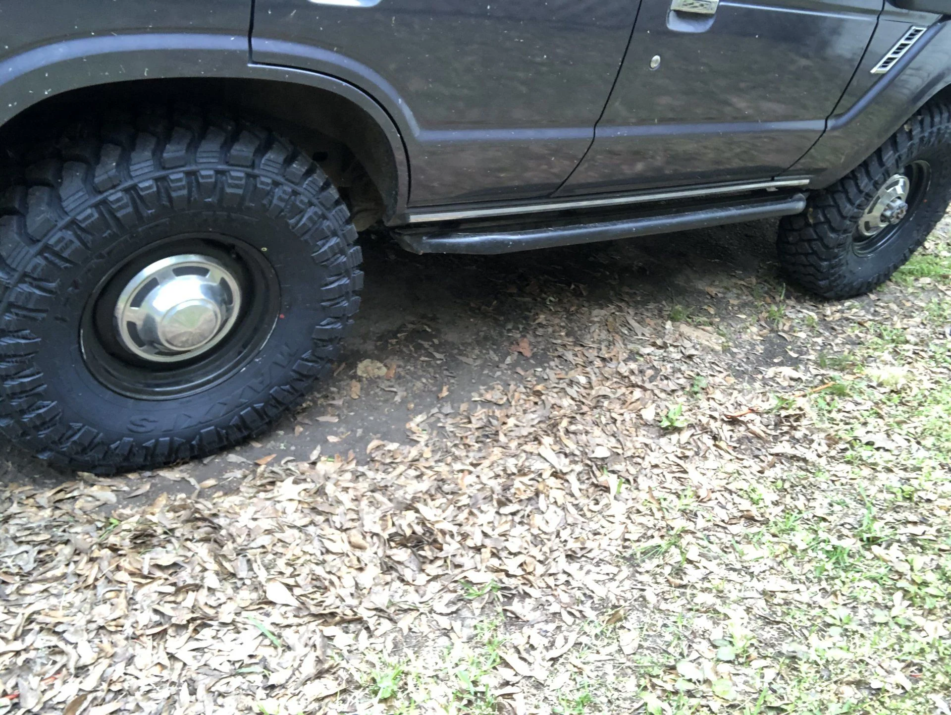

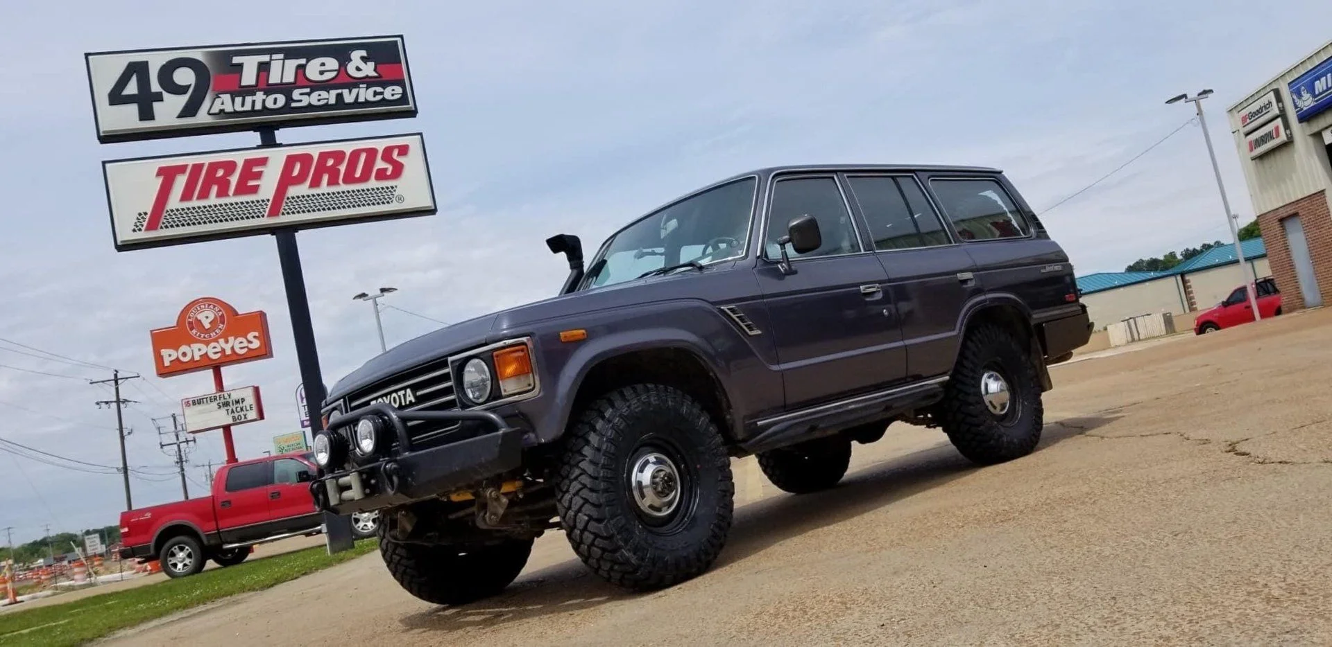

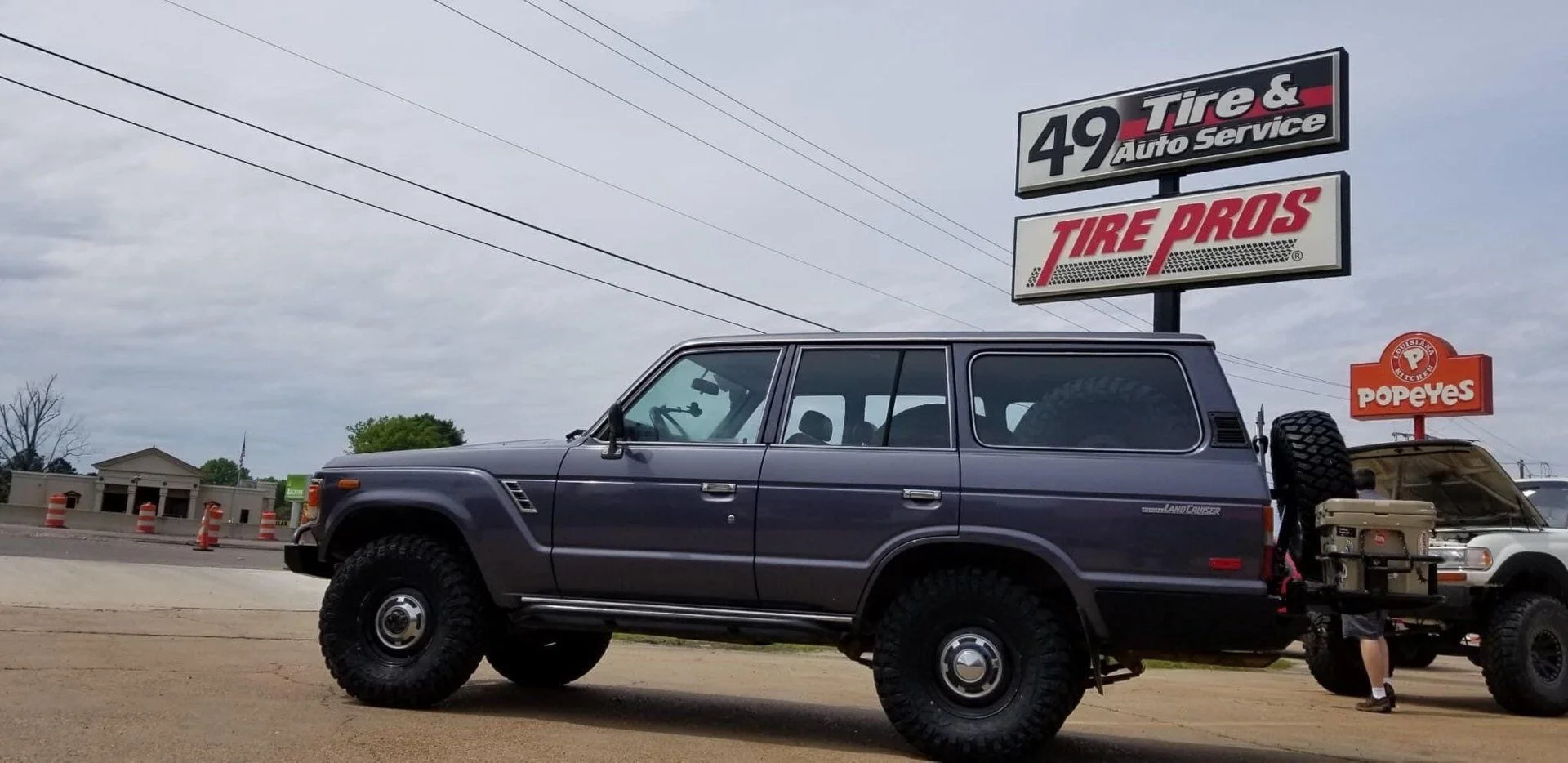

60 got some new meat today. Maxxis Razor MTs 33x10.5s.
Km3s are just too small. At best a 31” tire and @wngrog has been running these on his pig with great success. Figured I’d give them a try and my 45 needed the km3s sooo...
Wanted to make sure I get the proper shots on here. Thanks for the tires @wct49 and 49 Tires!!
You will really like the Razr's. I just put a set on my 60 a couple months ago. They do hum pretty good around 5mph, but they are smooth at speed.
Good to hear! It worked for me as my 45 needed a set and I was always mad at the KM3s for being a 31" tire at best.

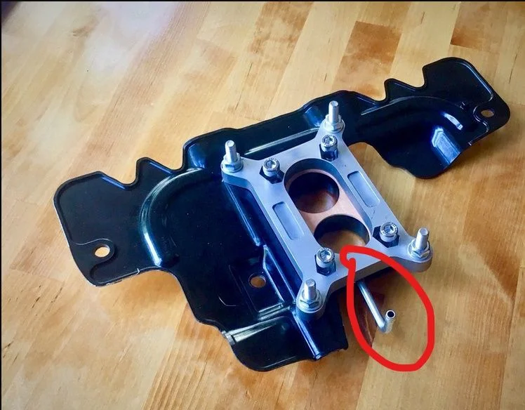

I'm working on this conversion myself and I was wondering if someone could tell me what the tube circled in red is? What does it do, when I was pulling my carb off it was hooked up to a hose that wasn't connected to anything.
That metal hose is a vacuum source that originally feeds a valve for evap iirc. I mean it connects to a valve which connects to the evap canister and it’s where fumes from the evap are drawn into the intake.
a lot of folks are cutting and capping that port.

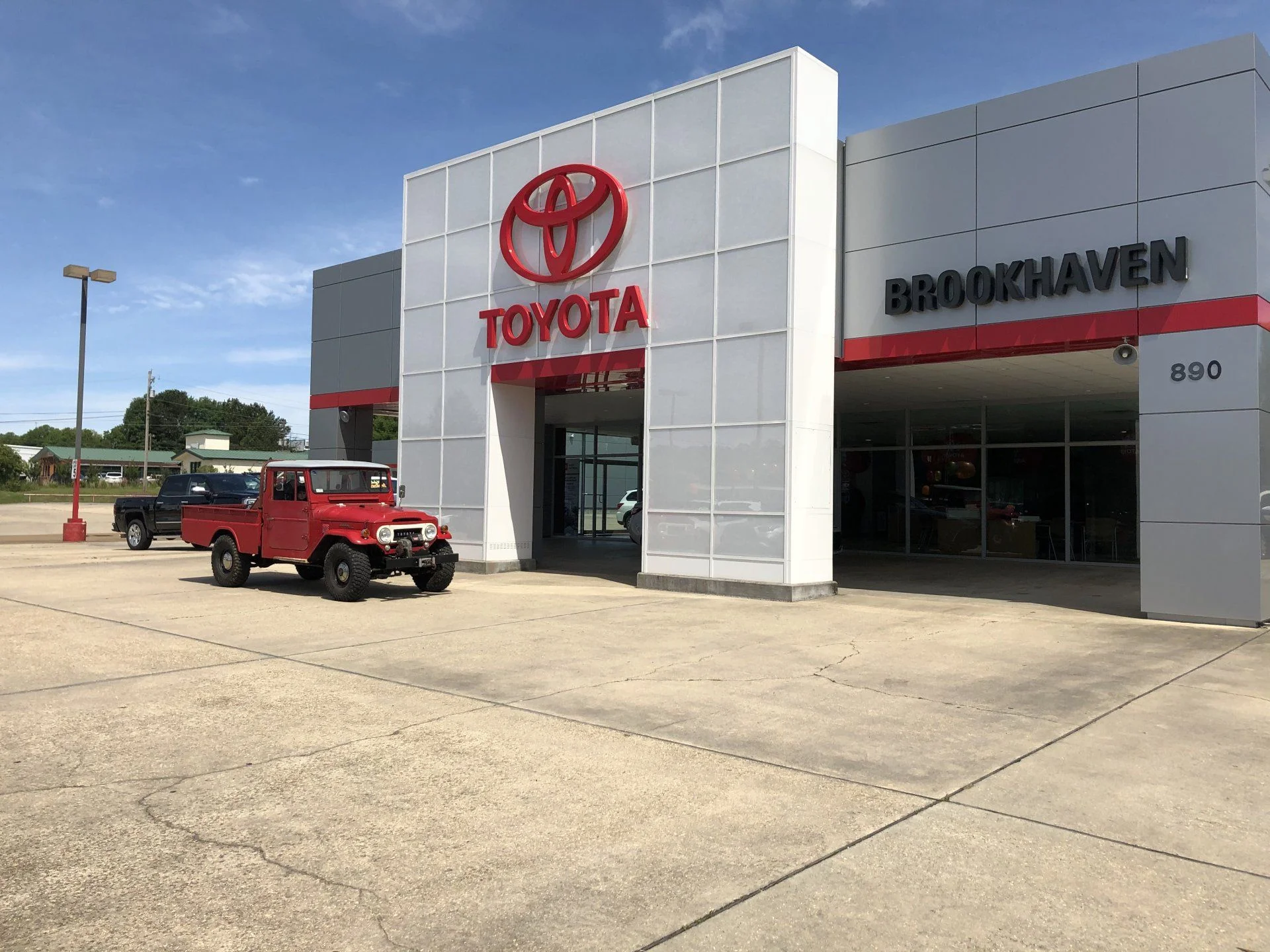

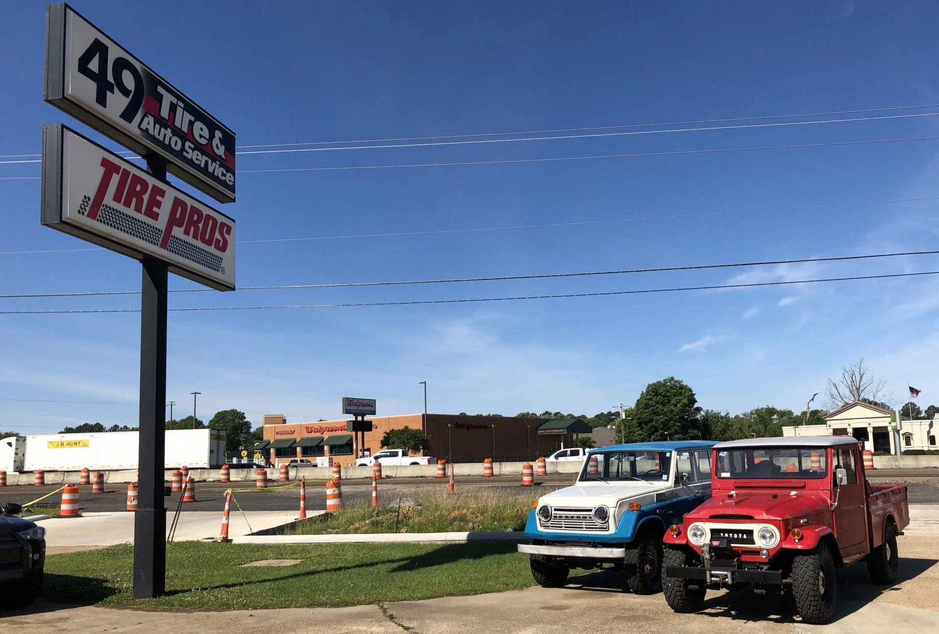

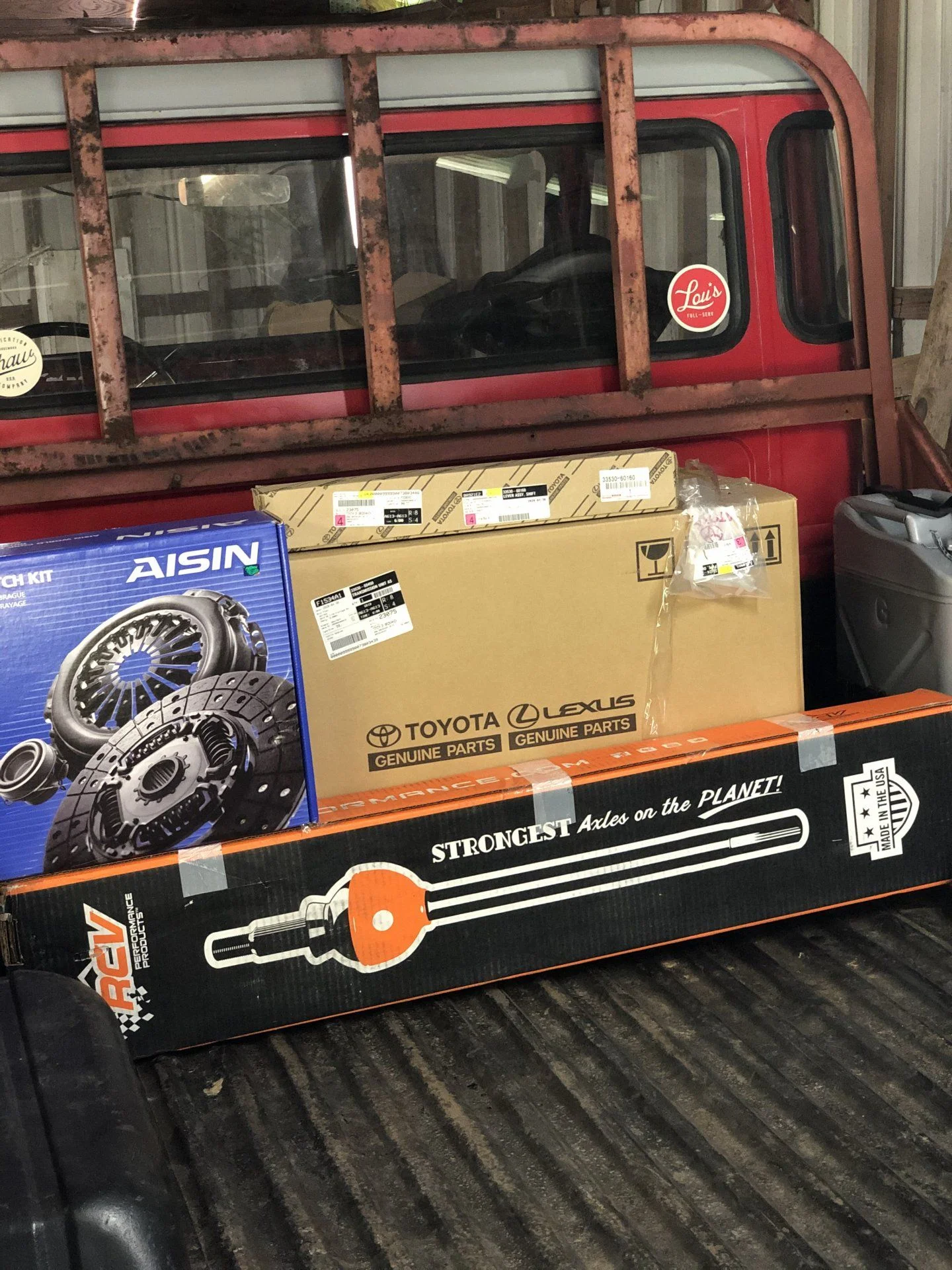

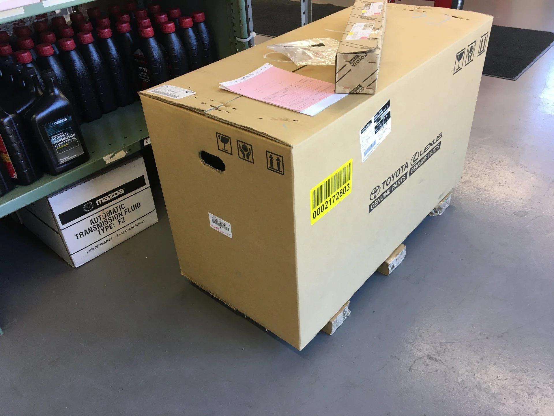

All parts have been purchased for the h55 swap. Waiting on @maxbob002 to build out my front third and my rebuild kits are in route from @orangefj45 ! I stretched the legs on the 45 today picking up a set of rcvs from @wct49 And the h55 from Toyota of Brookhaven. @s0me0ldt0ys ordered for me. Fun times ahead.
