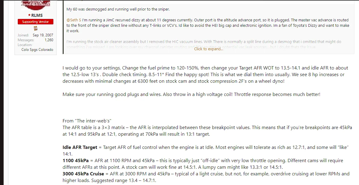

I did recently tweak my AFR settings per a Red Line Cruiser recommend and I am please. Target AFR at Idle I bumped to 12.7, Target AFR at Cruise to 14.3, Target AFR at WOT to 13.8 and the Fuel prime to 130%. Motor seems to be pretty happy here and it could be a placebo effect, but it feels to have a bit more pep.
100% best thing I've done to my 60! It only runs better and better. I would do this before you spend money on any other mod for a 60 or really any carb motor these days.
How did you do this tweak?

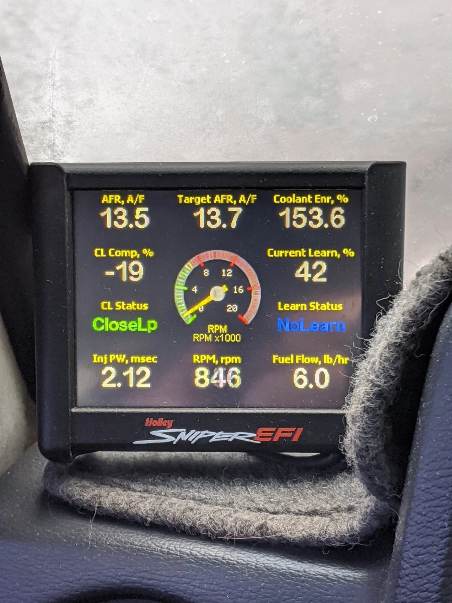

My idle at 13.5-14.2 AFR is high then??I'm under 1000 RPMs at idle...not sure if to drop the ARF I'd have to drop the RPMs ...yes/no? 900RPM seems about as low as I wish to go
May target idle is 750 and that is where mine sits all day in neutral. The air fuel ration (AFR) tweak is under the basic setup for fuel. When red line published it there was a spread. I will go find the screen shots somewhere. Also, there is no right or wrong as the Holley is a learning system so there is no need to tweak any of this as it does it on its own. I only did it to see as Red Line stated they feel they see a 8HP increase (their words not mine) when they do some fuel tuning. As I get more time on this setup I will update.

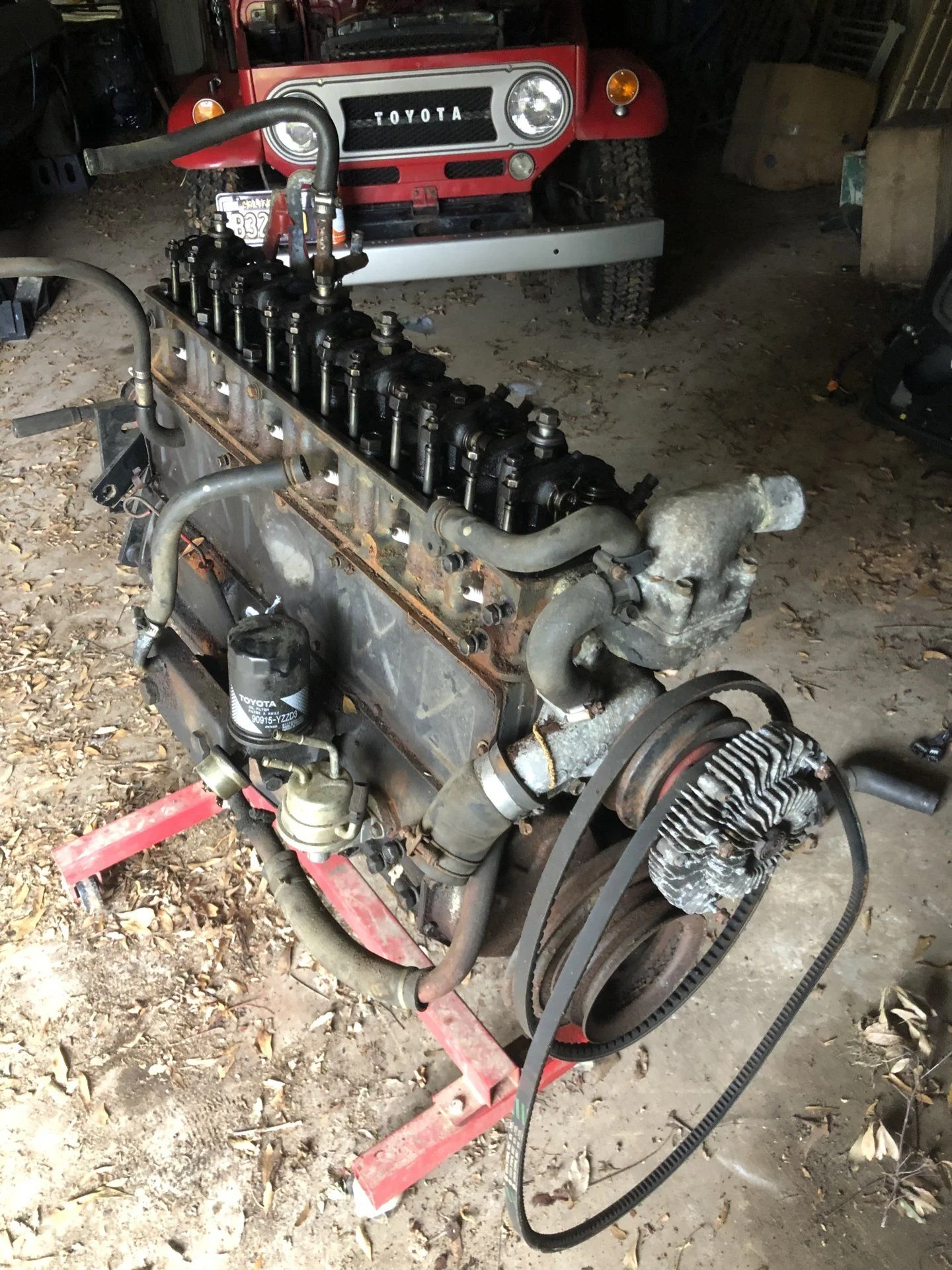

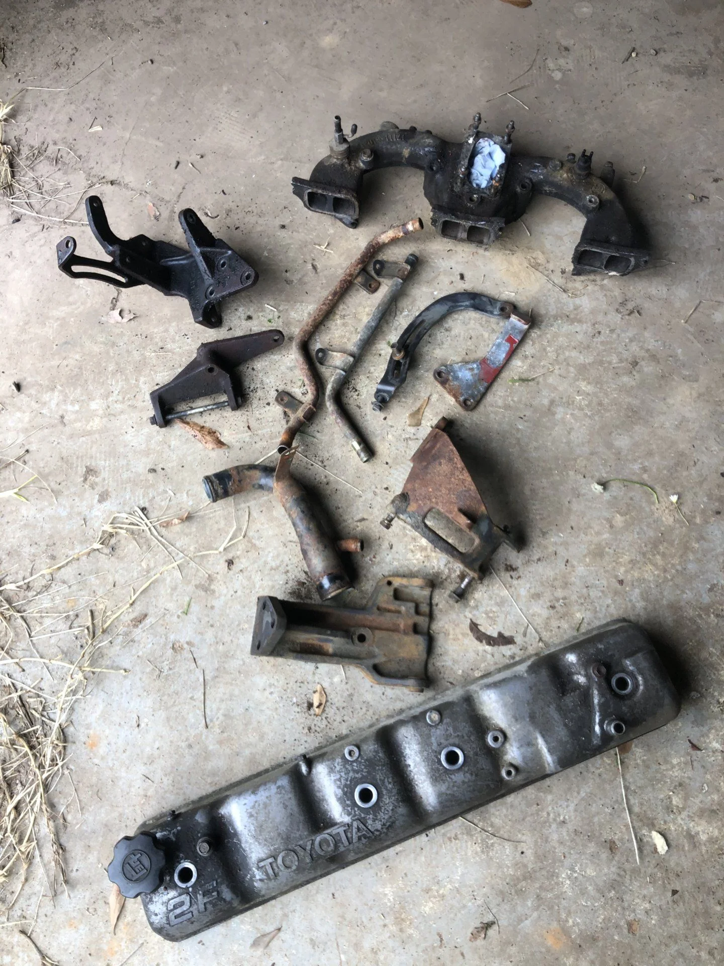

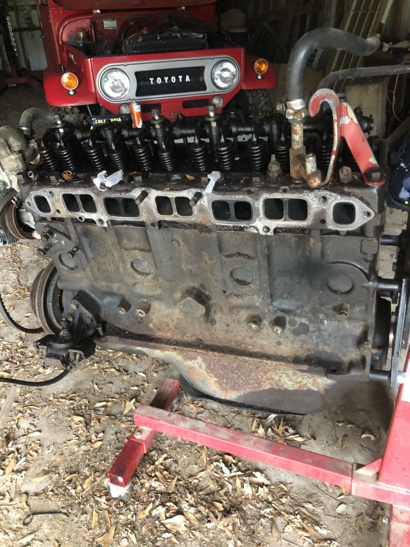

The h55 is coming in March so until then no big projects. I did strip my spare 2f of all the brackets and anything that can be powder coated. So I can clean up my 60s engine bay.
