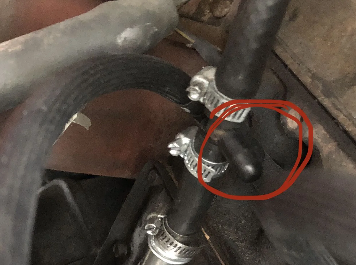

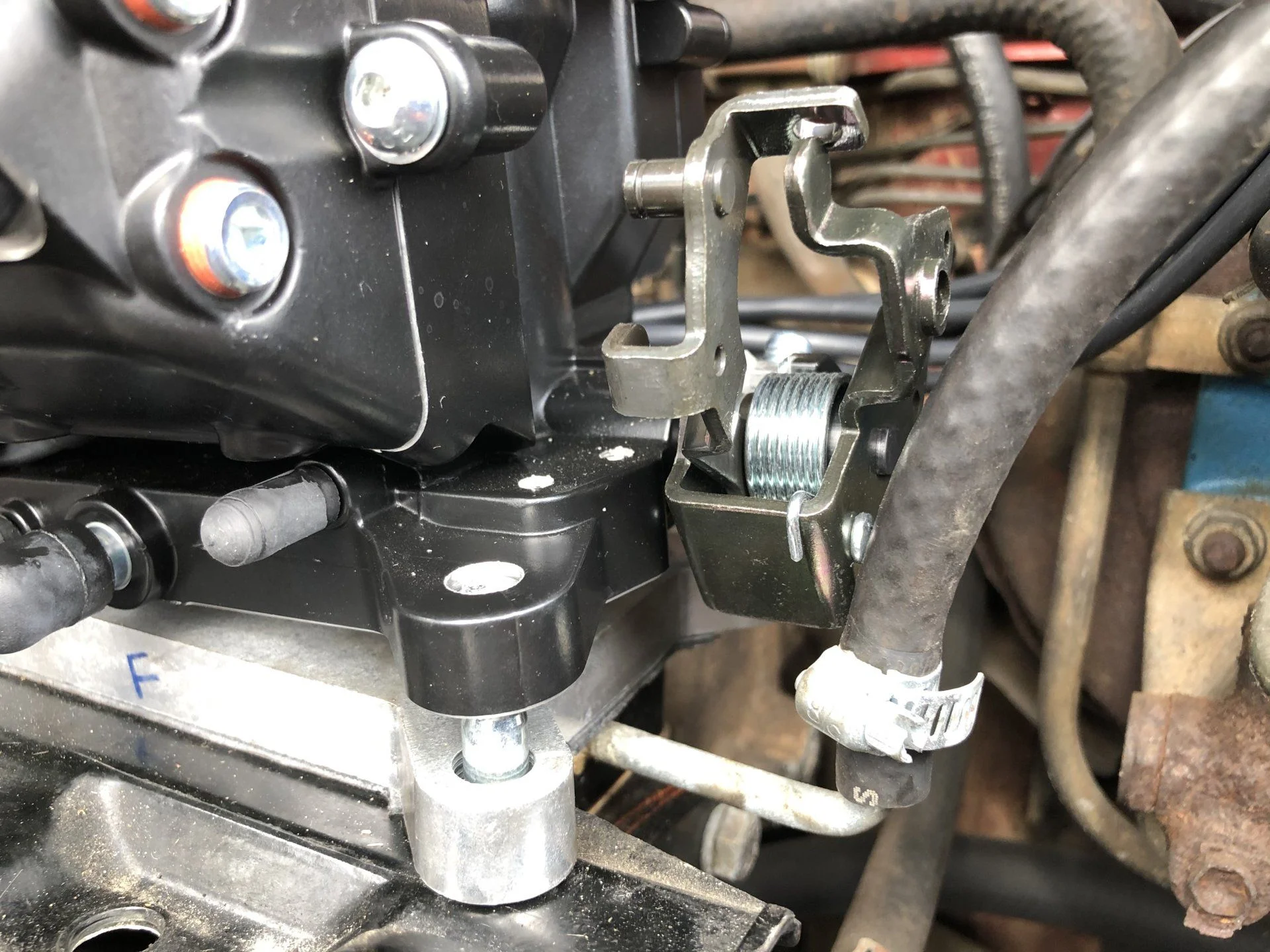

I’m a few days into my Sniper install and wanted to share a little issue I ran into today. I’m curious how others are dealing with this as well? On the carb insulator the pipe for the purge on the charcoal canister seems to be in the way of the throttle linkage for the Sniper. I either need to cut it and cap it or re-bend it another way.
Anyone else run into this?
I think I have some pics of how mine is ran in this thread. However, i am not running the insulator. I would suggest using some standard vac line as your line looks massive and there is no need for the clamp. @FJ60Cam uses the insulator often on his builds and may have a better idea.
You can cut it short and either cap or fill with epoxy.
There is a similar sized manifold vacuum port on the Sniper you can use if you are reconnecting the charcoal canister.
Thanks for the advice! Cut and capped... Moving along well now! Do you think it’s a bad idea to run the purge From the charcoal canister into the Tee fitting above the PCV valve? I’m not a vacuum specialist but I feel like the path of least resistance would mean there isn’t enough vacuum to activate the PCV valve if I did that. Seems too good to be true.
I'm not an expert either but here is what I did: Attached brake booster to the EGR port on the block off plate on the manifold. Ran PVC to the large vacuum port on sniper (crankcase might leak less oil with negative pressure?) Vacuum advance to ported fitting on the right of the Sniper. Ran Purge to top of air-cleaner. I may tee purge to ported vacuum advance. Thinking I don't want purge at idle, only under advance, but seems to be fine on weak vac on Air-cleaner so far.
Cut and cap that tube.
Run a Delco or Toyota purge valve with a T on the vacuum advance hose. That way you are not sucking raw fumes into the base of the sniper at idle. Only under throttle.
