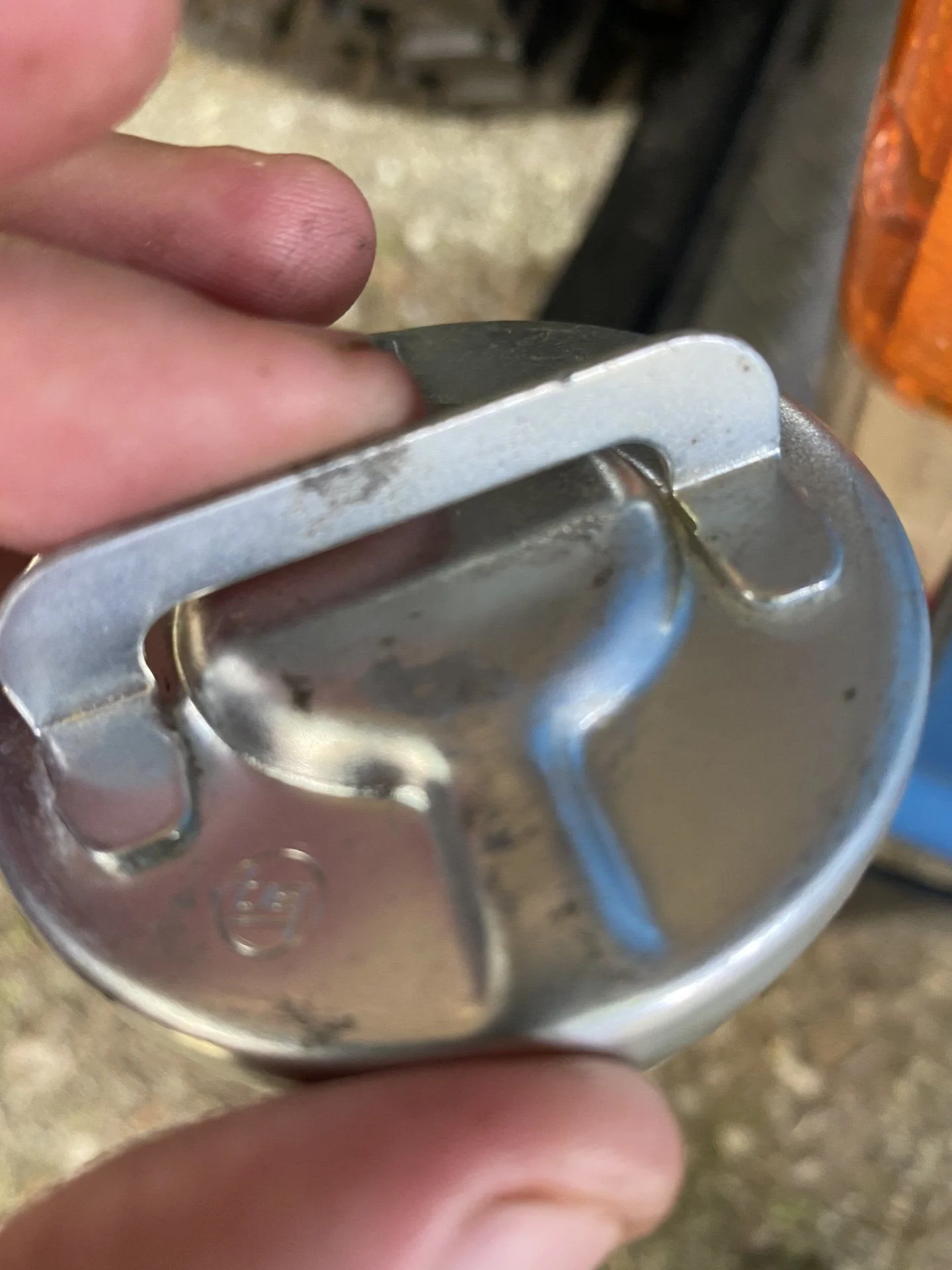

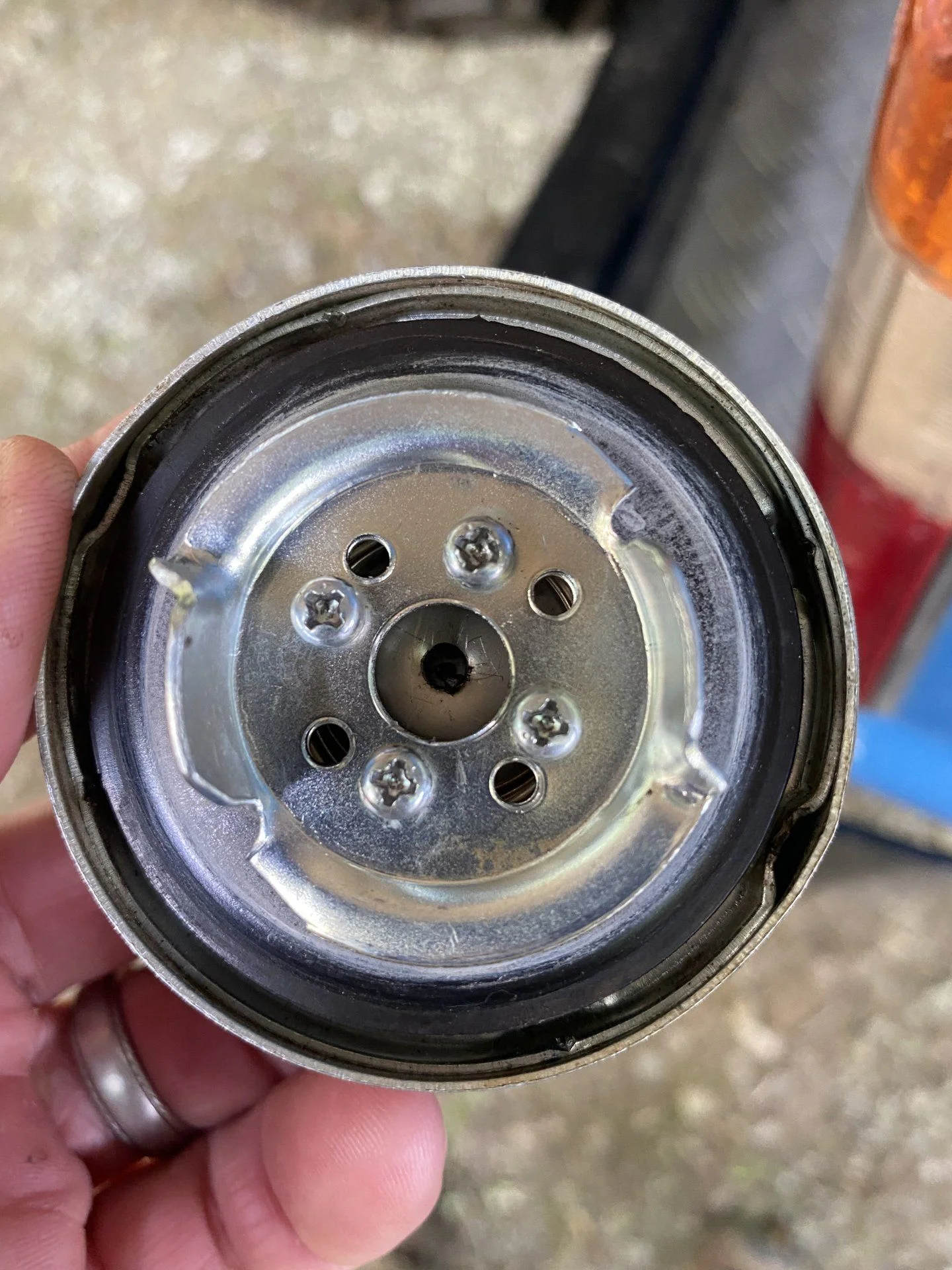

I'm noticing a whooshing when removing gas cap to refill. Is this normal for a fuel injected system pressurizing the fuel tank? Installed a new GM canister installed to eliminate the whooshing back when 2F was fed by a carb. Now the whooshing is back after installing the Sniper?
I recommend drilling a small hole in the gas cap. There is a lot more return going on with these setups. I do it from the inside out to the cavity in the bulged our part of the cap. You can’t see it from the outside.

Great idea to drill a hole in the gas cap. Below is a pic of my canister / check value setup. The check value is held in place by the attached hoses but sits somewhat at an angle versus sitting horizontal. Do these check valves have to be perfectly level to work properly?
Also I recommend using a T off the advance line to run a check valve on the charcoal canister to draw the fumes only on acceleration
right in the middle? Through the outer metal?
