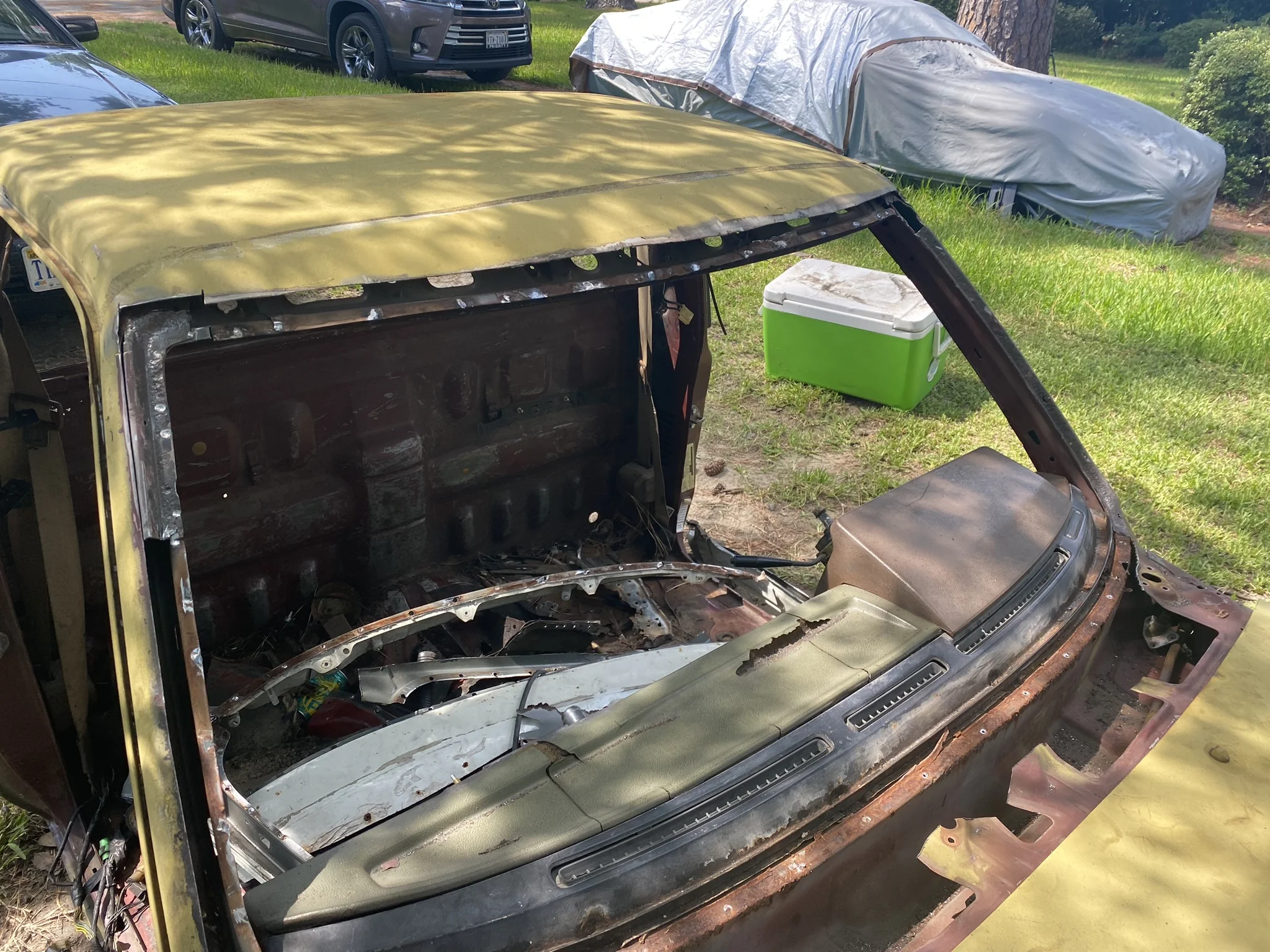

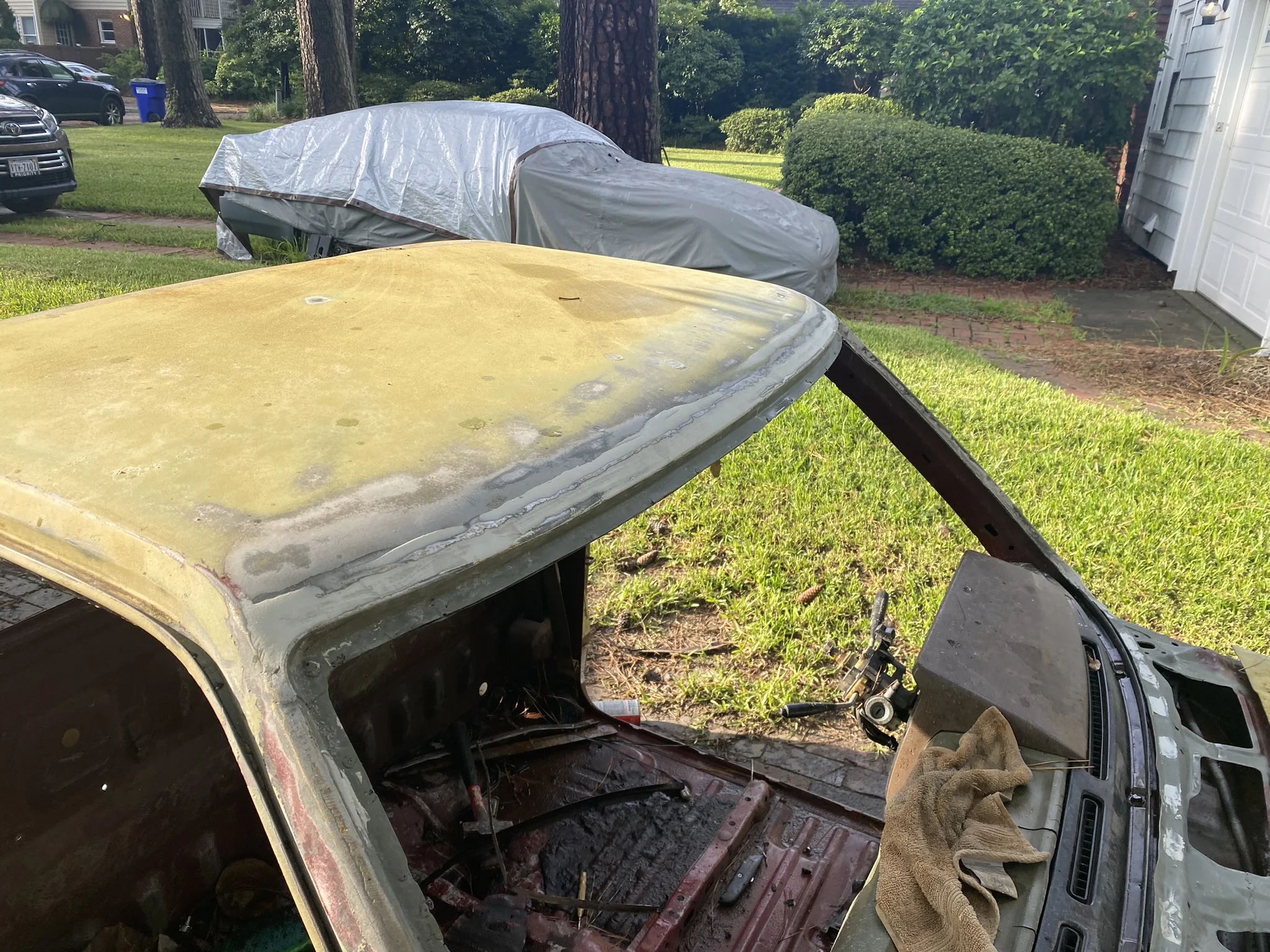

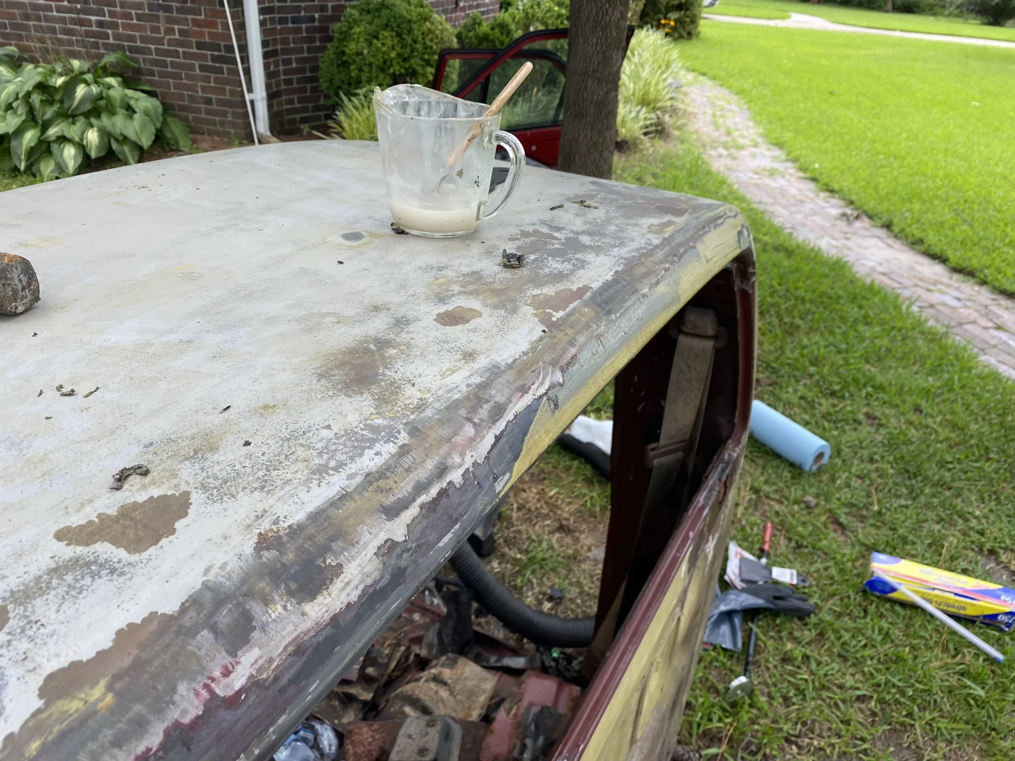

After fixing up the frame and floors I moved on to the windshield frame. I found a cab and chassis pickup at my local pick n pull, so I sawzalled the windshield and frame out of it to cut apart for my truck.
I ended up needing to cut out most of the windshield frame. I was able to do the repair without removing the dash. Which probably wasn't worth it, since it needs a heater core anyway.

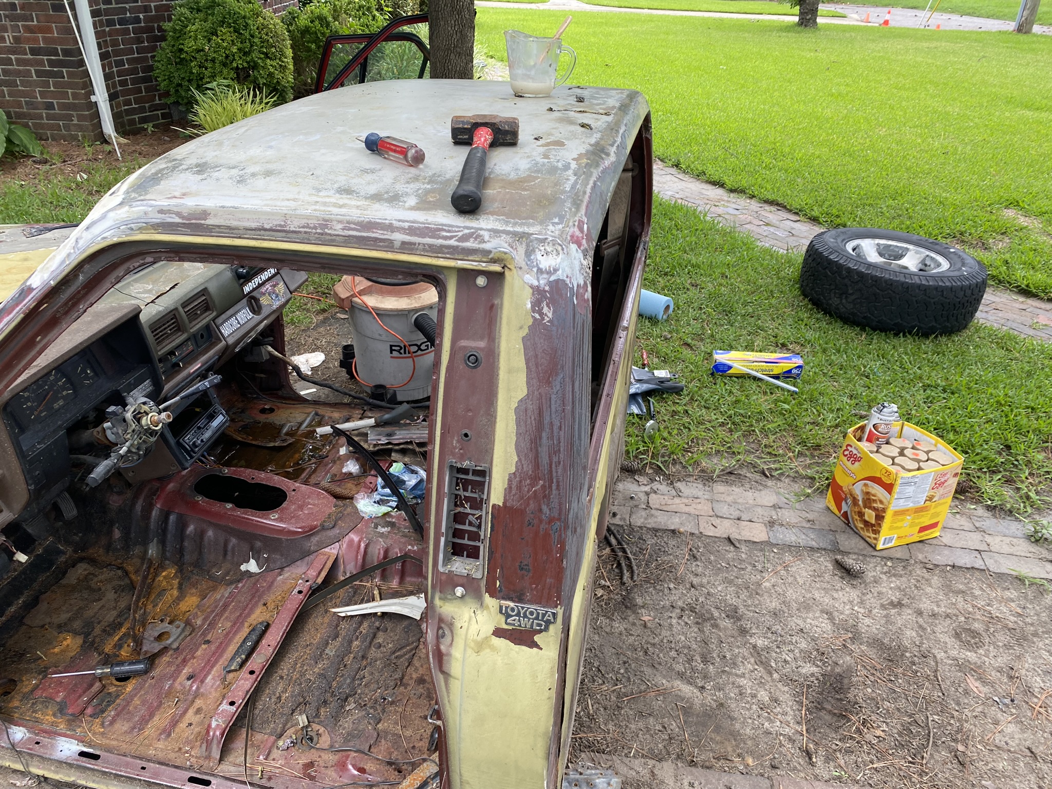

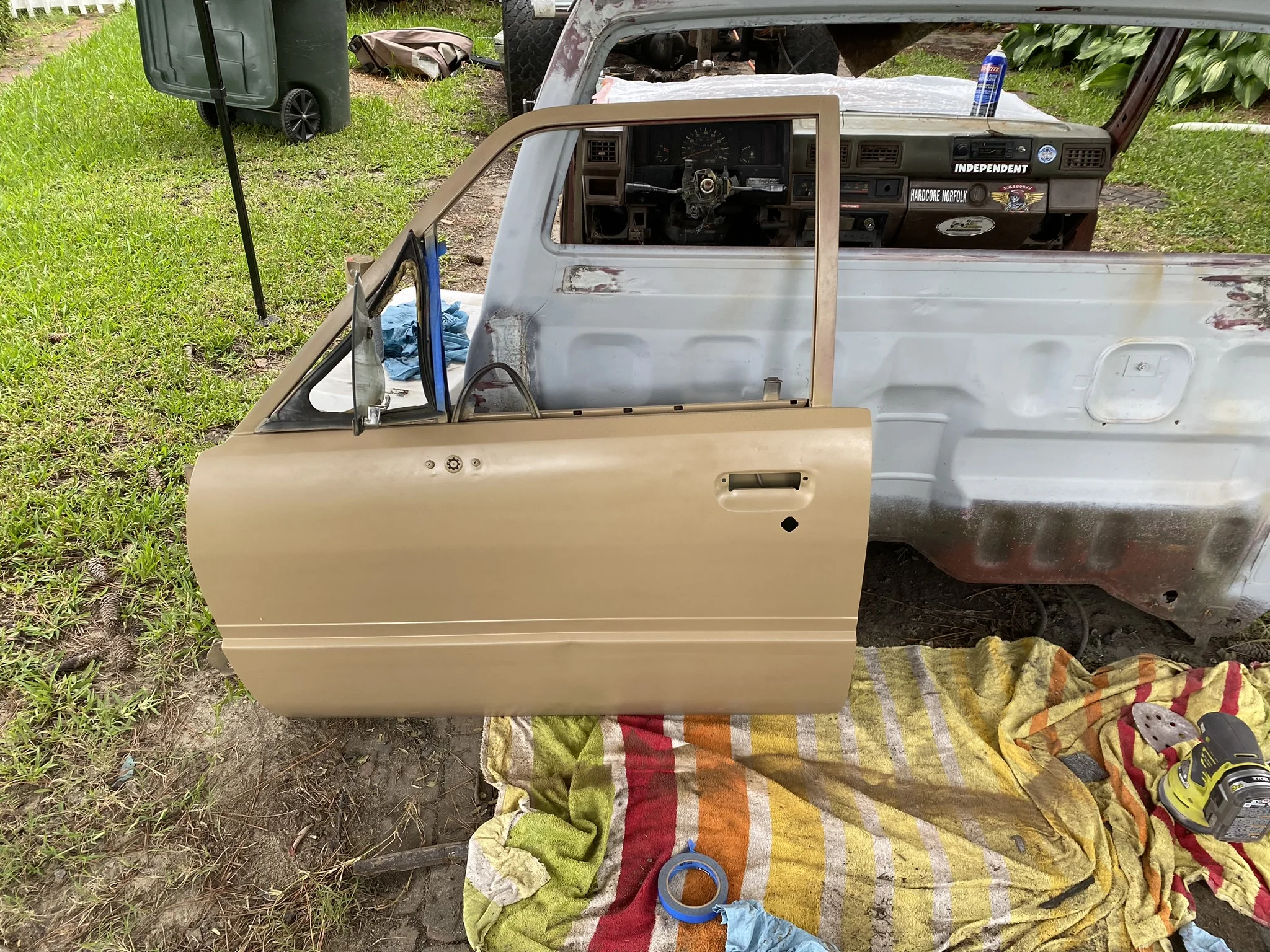

After wrapping up the majority of the rust repair I started stripping the green paint, and multiple rattle can paint jobs, off of the truck. I ended up using Aircraft stripper, none of the "environmentally Friendly" paint strippers would touch that green paint. I have no clue what kind of paint it was, but it was thick and really tough.
I really like the original 3B2 Red Wine paint. I believe it was a 1984 only color.
I also had 20 or so cans of tan spray paint I bought a few years ago. I bought them to paint the Isuzu Trooper I had. I never got around to it, so Tan it is! (for now)

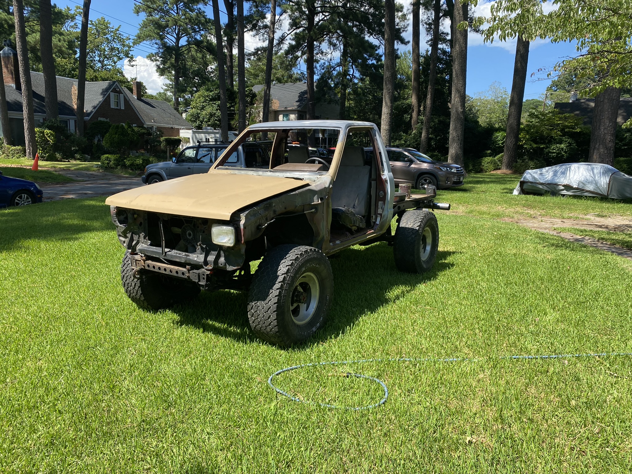

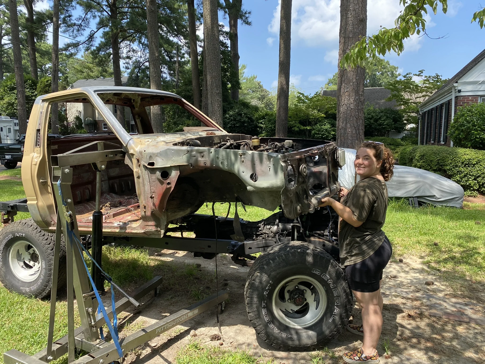

After painting the frame and most of the cab (at least primer) I placed the now rust free cab back on the mostly rust free frame. With some beautiful help.
We ended up using an engine lift with a block of wood secured through the shifter hole in the floor. Worked out GREAT would highly recommend. Just be careful of the dash.
I used the Enegergy Suspension poy bushing kit that came with all suspension bushings and all cab mount bushing. I had no issues with them.

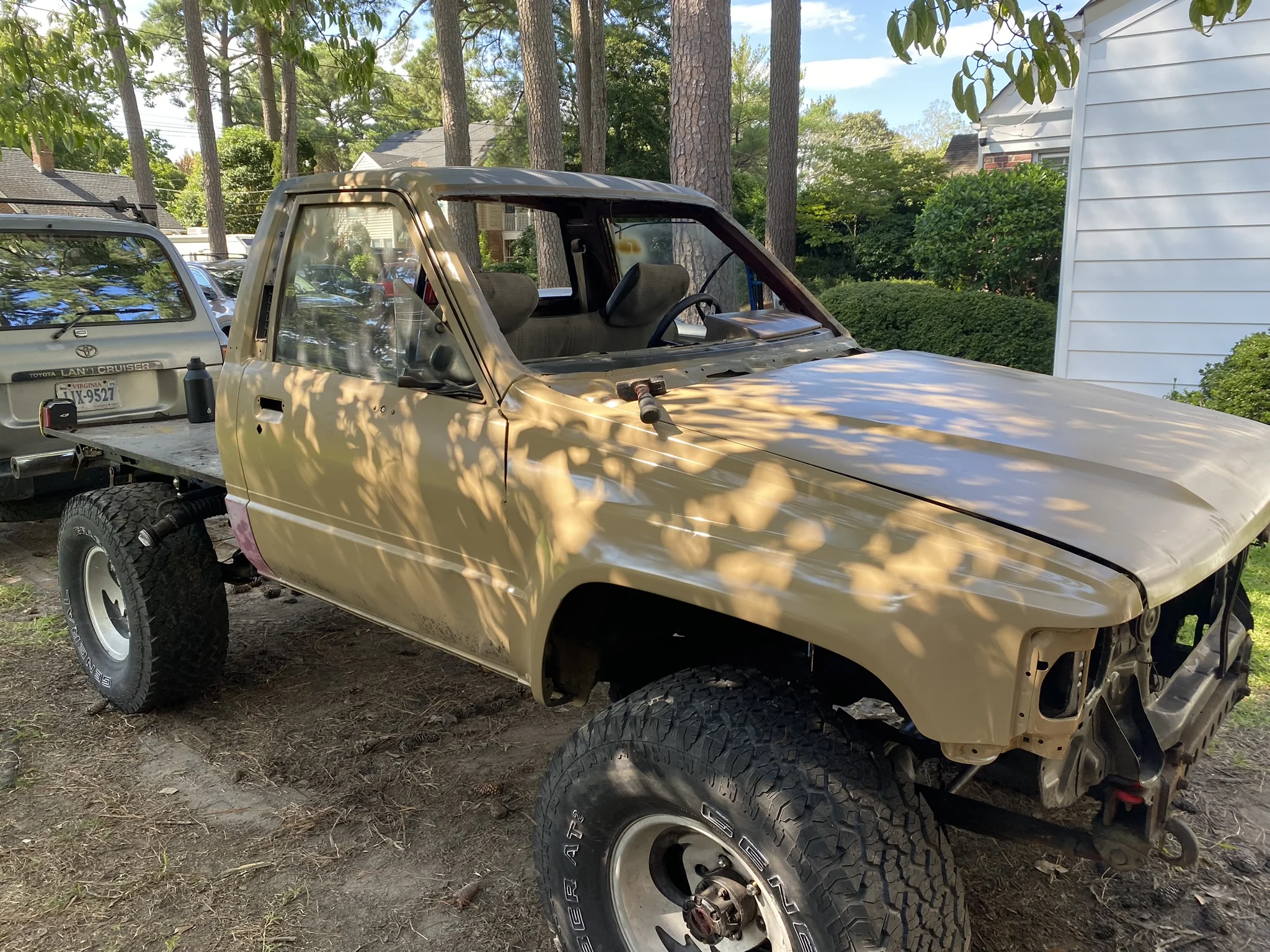

After putting the cab back on the chasis, I started finishing up the body work and getting this thing driveable. I still haven't really driven the truck at this point, so I am itching to get it driving.
I still had the windshield from the junkyard truck that donated its windshield frame so I was able to reuse that glass since I could not find one locally. I don't have any pics of install, I can say, I wish I had one of the big suction cups the professional glass installers use.

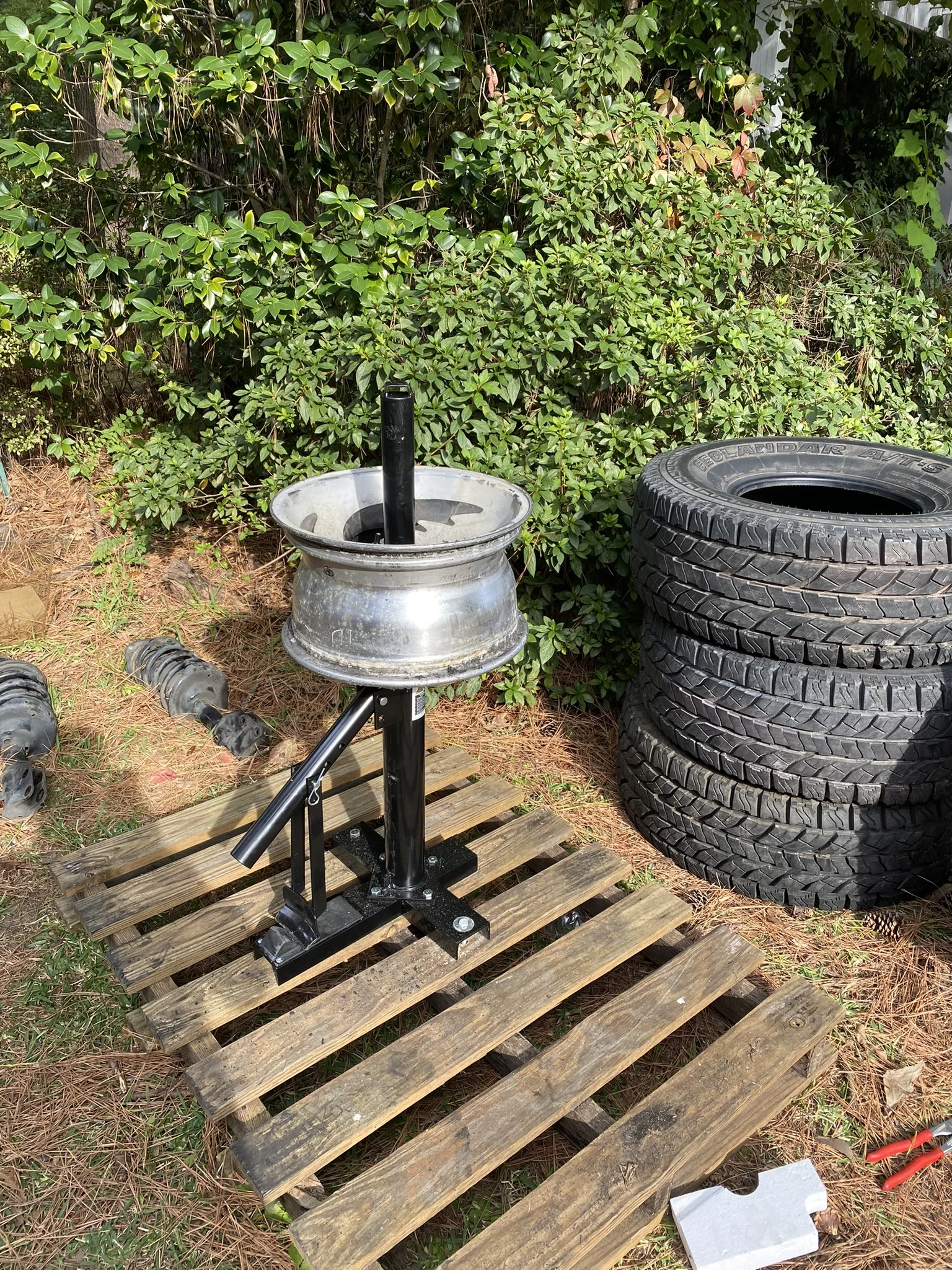

I also grabbed a cheap used set of 33's from Facebook market place. One of the old tires had some serious wear.

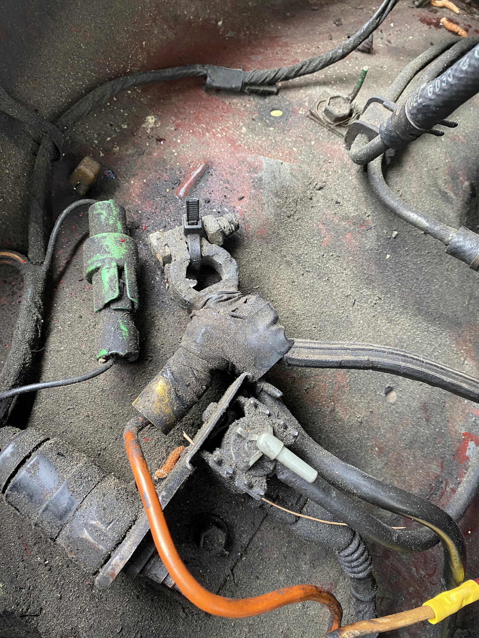

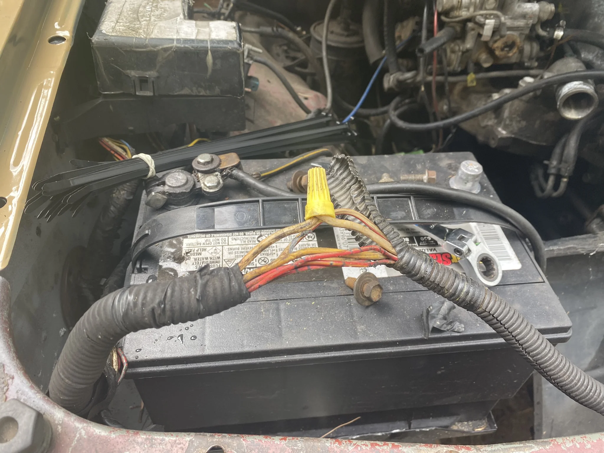

I also spent a lot of time removing wire nuts and extra wiring from the engine harness. A chevy 1-wire alternator was swapped in at some point. The dash light was never connected, causing constant Brake and Charge lights on the dash. I also bought a trail-gear chevy alt bracket. Someone had used the factory toyota alternator mount and a home made adjuster.

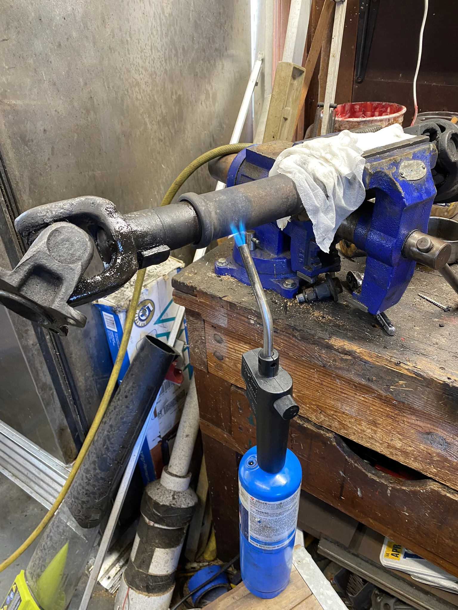

I had replaced the front leaf spring bushings when I had the front axle removed for resealing. When I attempted to install the front drive shaft I was unable to move the splines on the drive shaft. At ALL. I am assuming the front add-a-leafs were so stiff that the suspension never really articulated and allowed the driveshaft to rust.
After a lot of heating and beating, and cutting the dust shield off. I was able to get the halves apart, clean and grease the splines and reinstall. I used a dust boot for a JK wrangler to seal off the splines, since I cut the dust shield off.

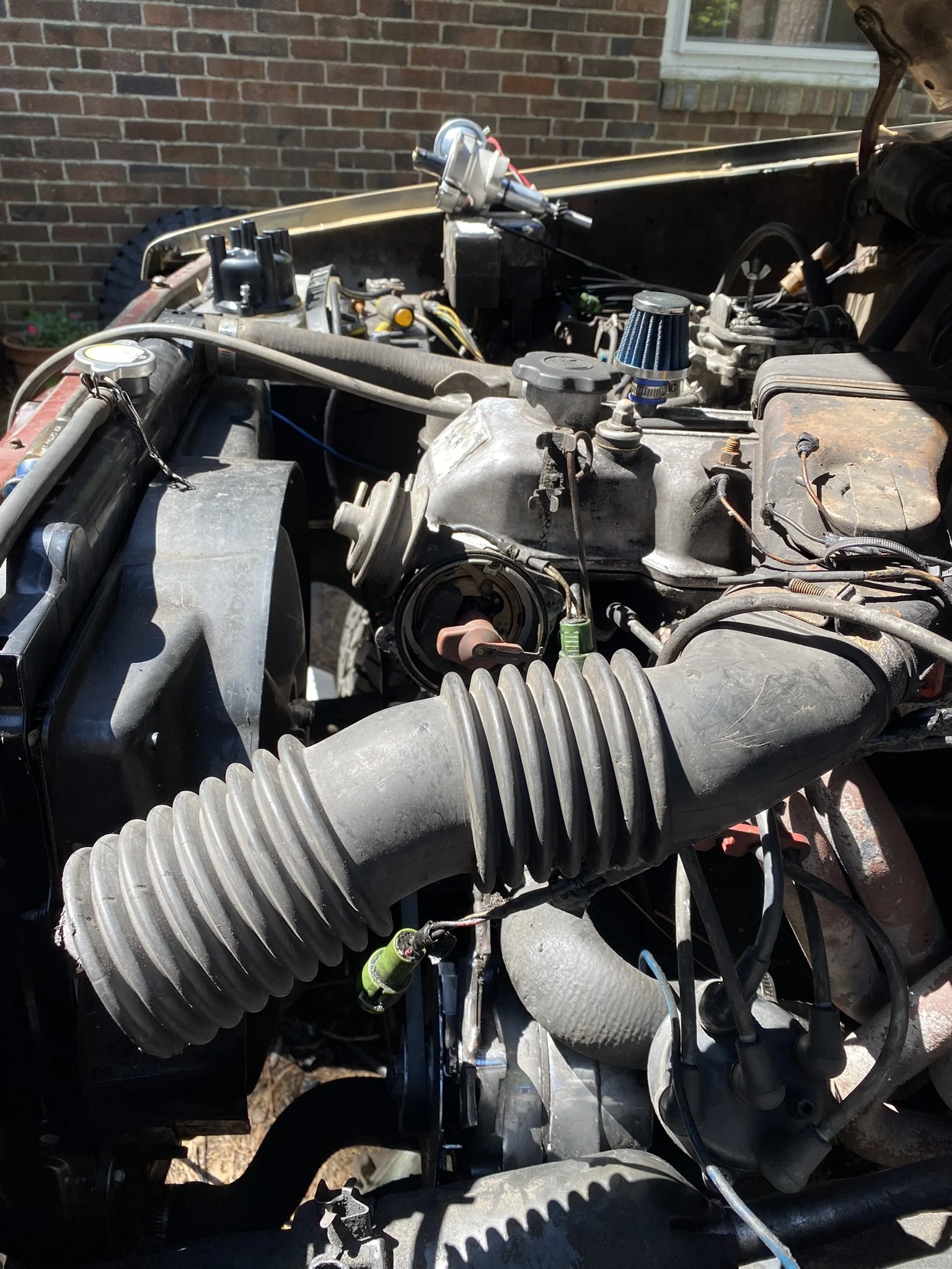

After getting back from our OBX trip I started to focus on reliability issues with the truck. I rebuilt the carb for the 22r and began working on fixing the many oil leaks. I also had a vibration I was trying to track down, which ended up being a pinion bearing eating itself alive. I sourced a used 4.10 v6 3rd member from my local pick n pull to remedy that issue. pic from my pick-n-pull.
