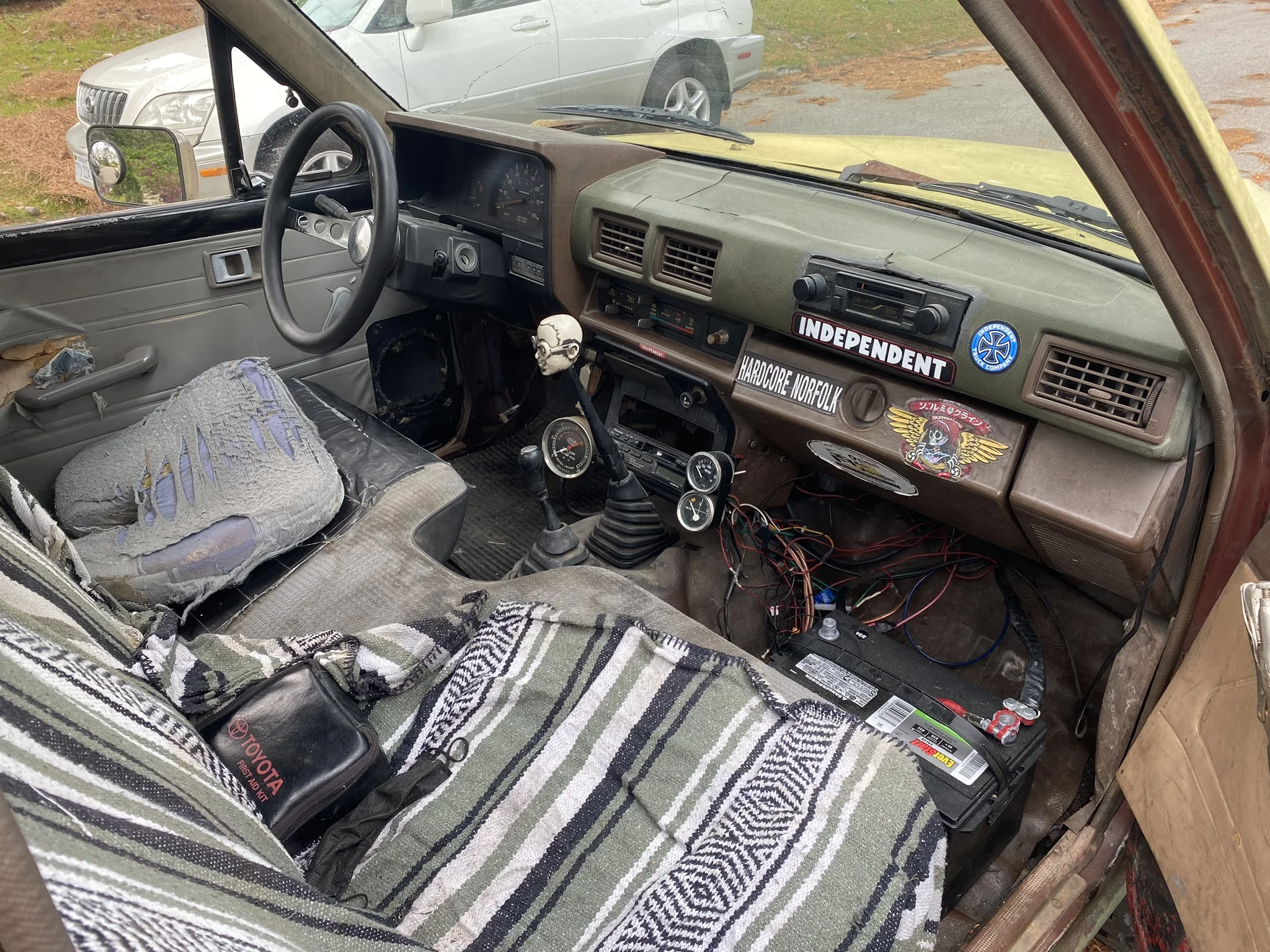

At this point I hadn't driven the truck almost at all. I drove it around the parking lot of the pervious owners job for a grand total of maybe an 1/8 mile. I took it over to my Dad's place (less than 5 min) and quickly came up with a laundry list of issues to fix. Some of the more obvious issues being the 13" steering wheel with no power steering, no turn signals, and the battery as my passenger. I got it in the driveway and started looking it over.
The wiring was BAD. the more you look, the worse it gets.
I started with the battery situation. Moving the battery to the factory location was not going to be simple.

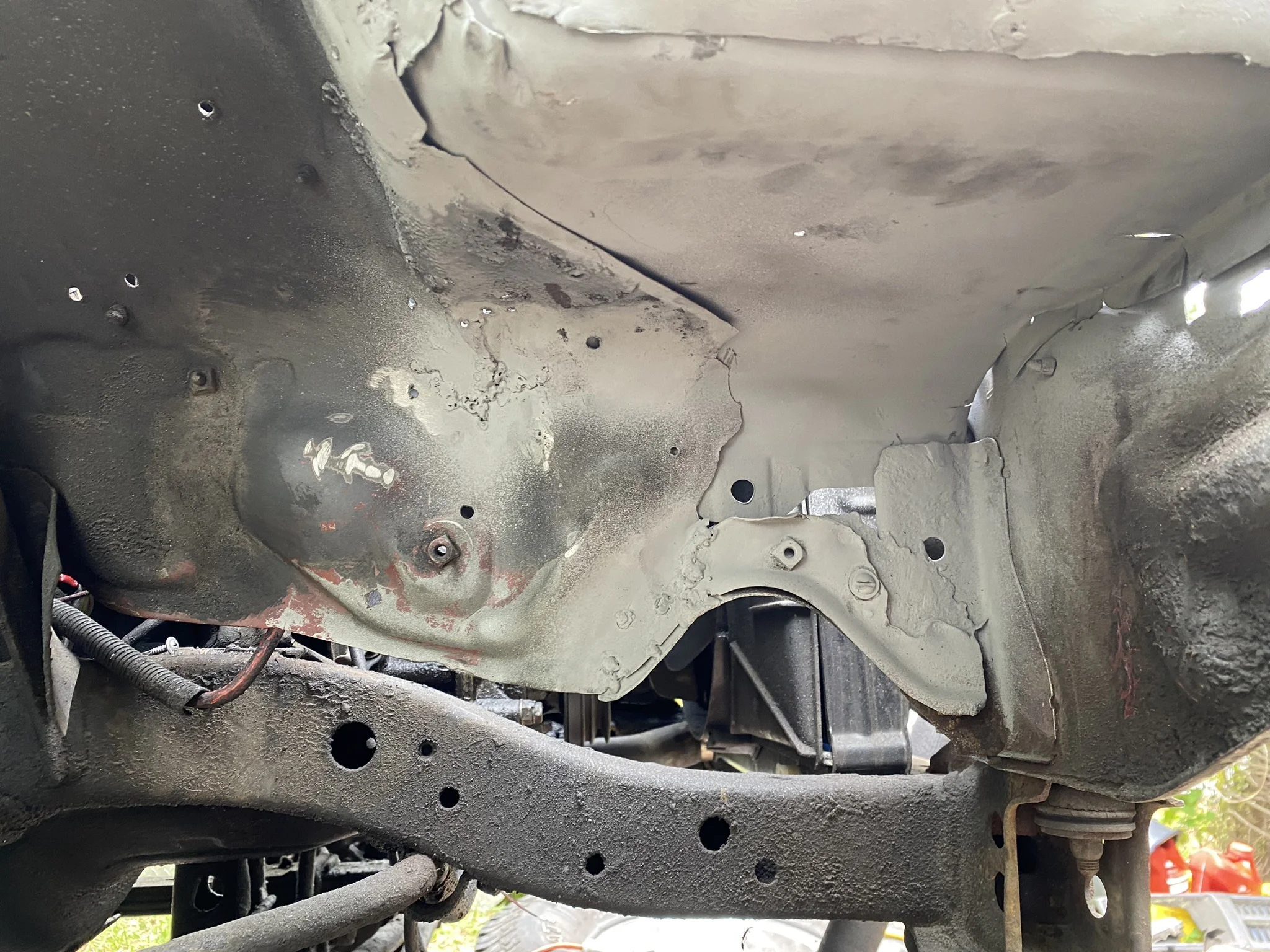

The battery tray was long gone. and had completely tore the inner fender.

I shoved the inner fender back into place the best I could and where the metal was thick enough I welded the inner fender back together. I still had a huge hole where the battery tray used to be.

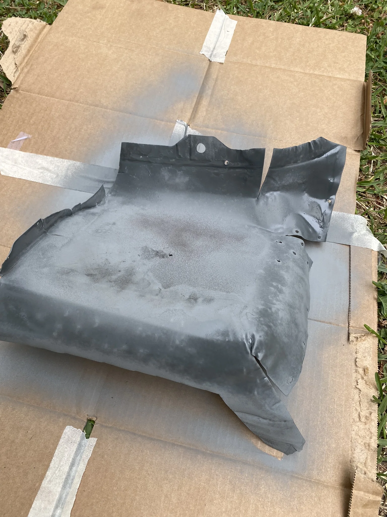

I used one of the front fenders to make a sheet metal battery tray. Its by no means perfect, but it will work until I find a good donor to cut and transplant the whole area...... that will probably never happen though. 😂

I got the "Battery Tray" in place and self-tapped into place for hammering and massaging. Once everything was coated in weld-through primer I started tacking it into place.
I ordered a cheap metal battery tray from amazon to use and got it welded into place.

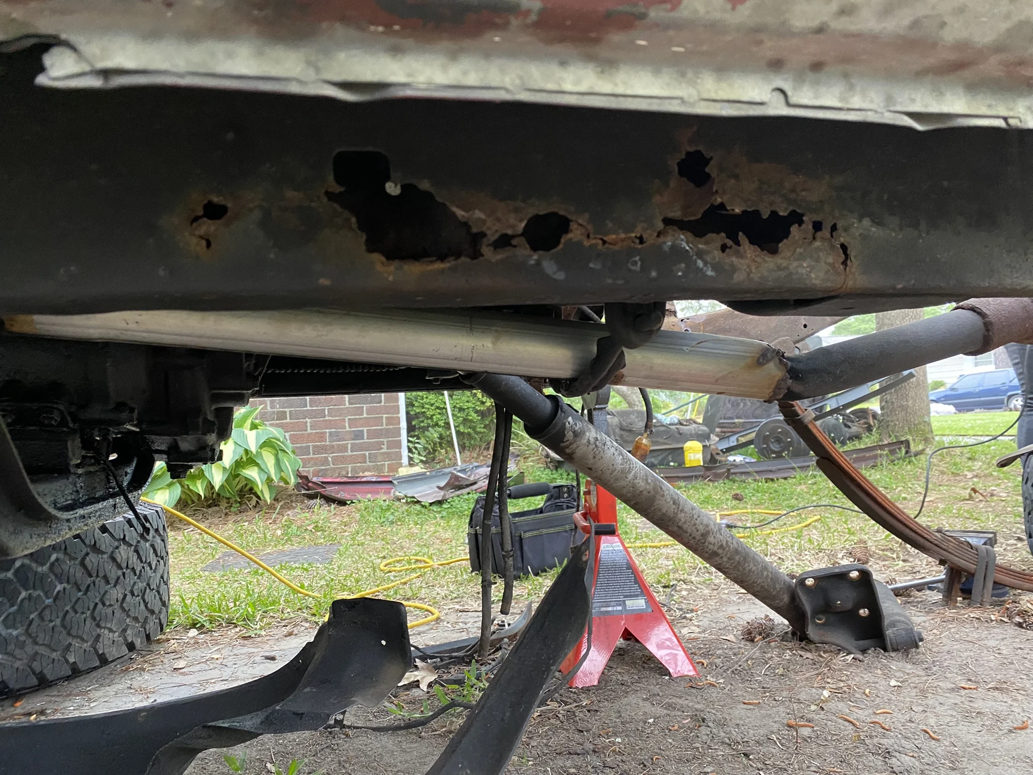

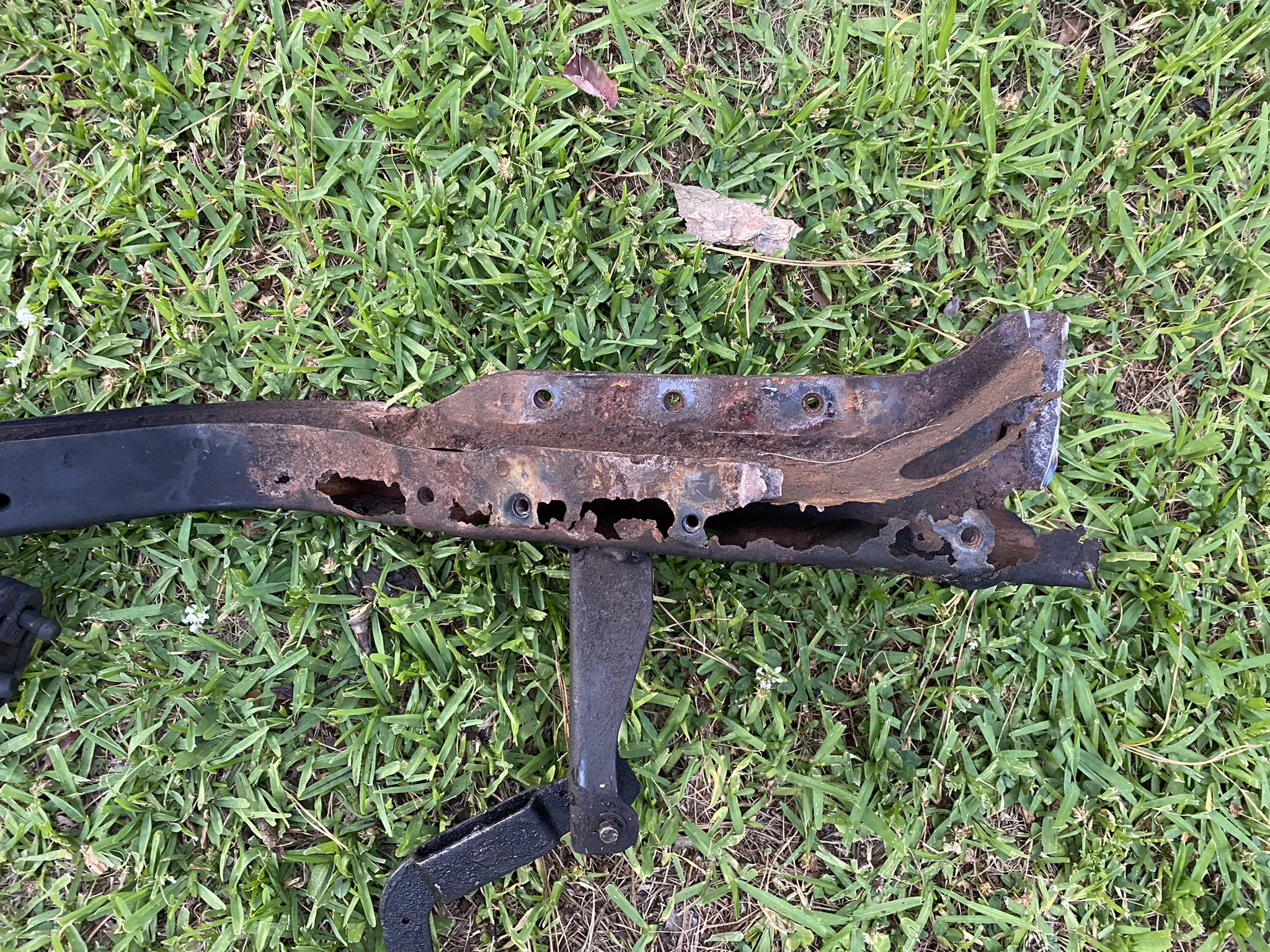

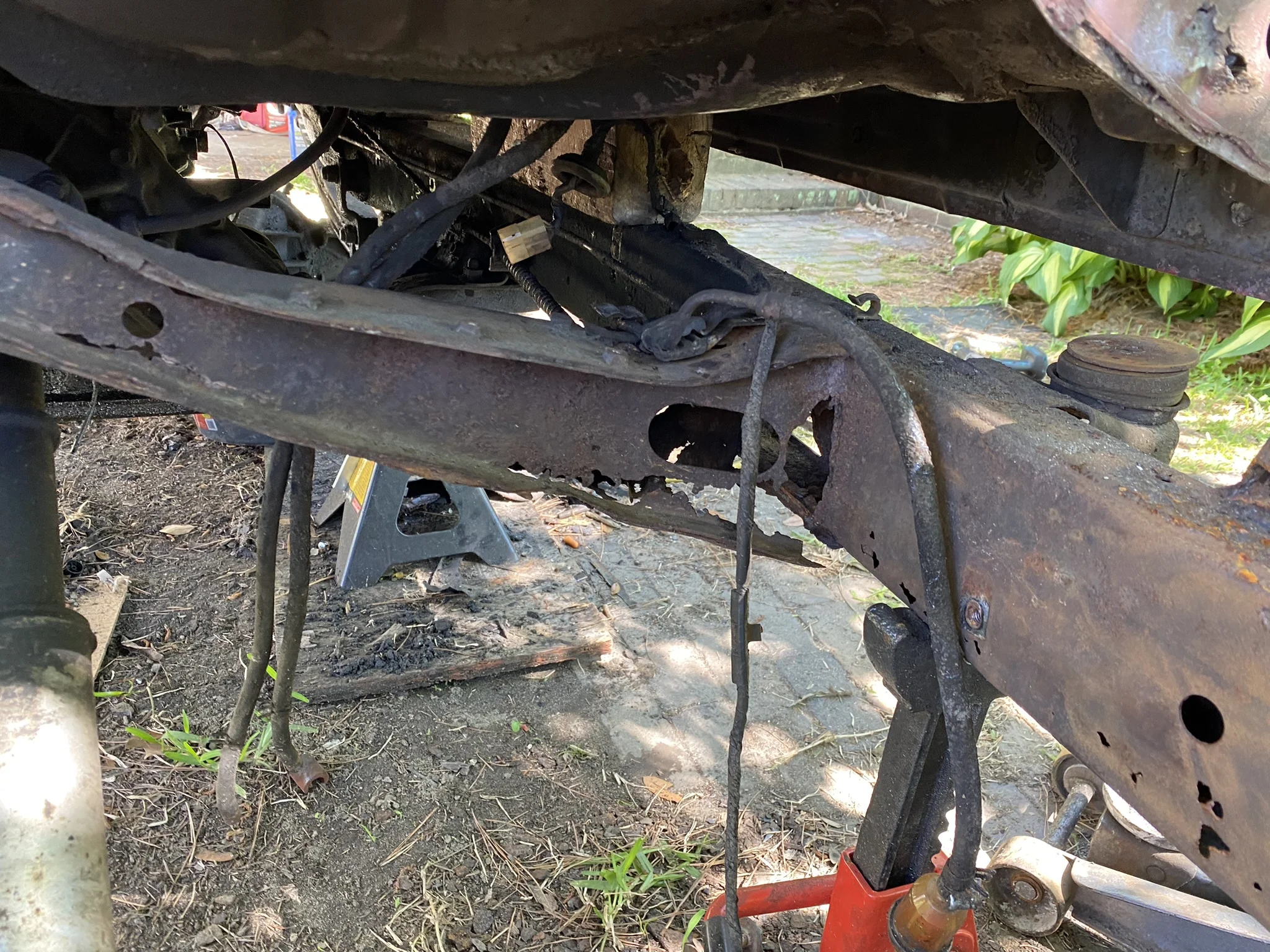

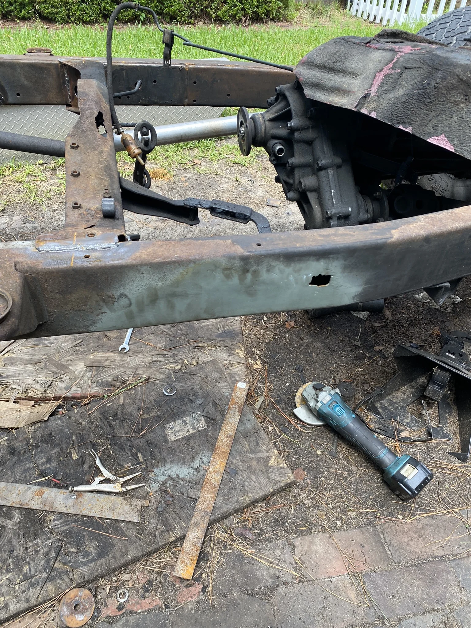

The frame needed more help for sure. I am trying to keep this thread in some kind of chronological order, despite doing all this work at once. I had a few areas of frame that needed repair under each side of the cab had rust spots and just behind the cab as well.

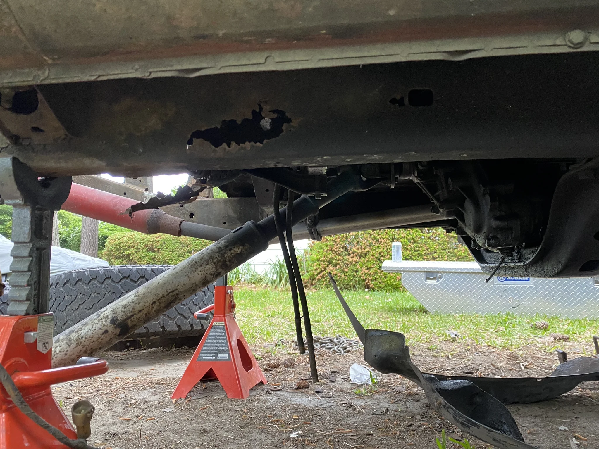

After finding the gas tank crossmember in really rough shape, I decided to pull the cab off the frame to be able to fix the frame and floors more easily.

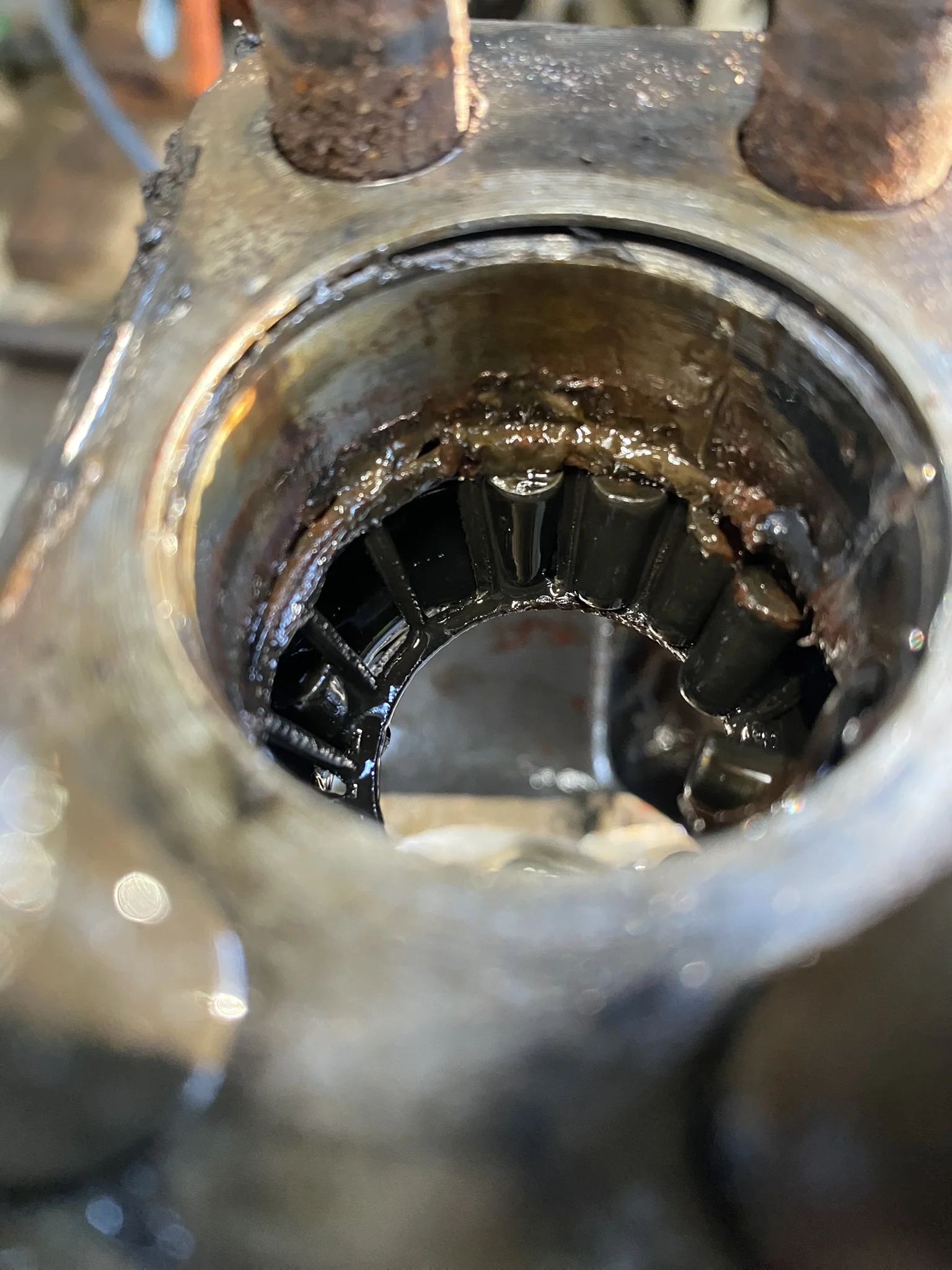

This meant finishing the front axle rebuild, in order to be able to roll the chassis out from under the truck cab. I don't have a lift so I figured it would be the easiest way to separate the two.

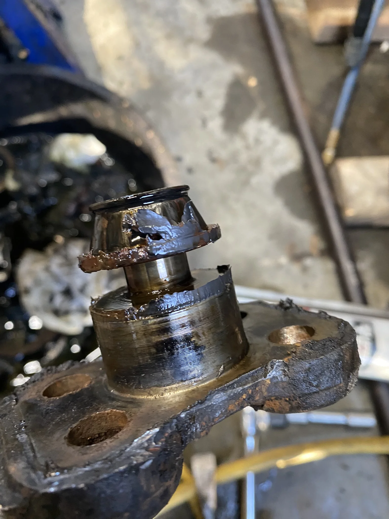

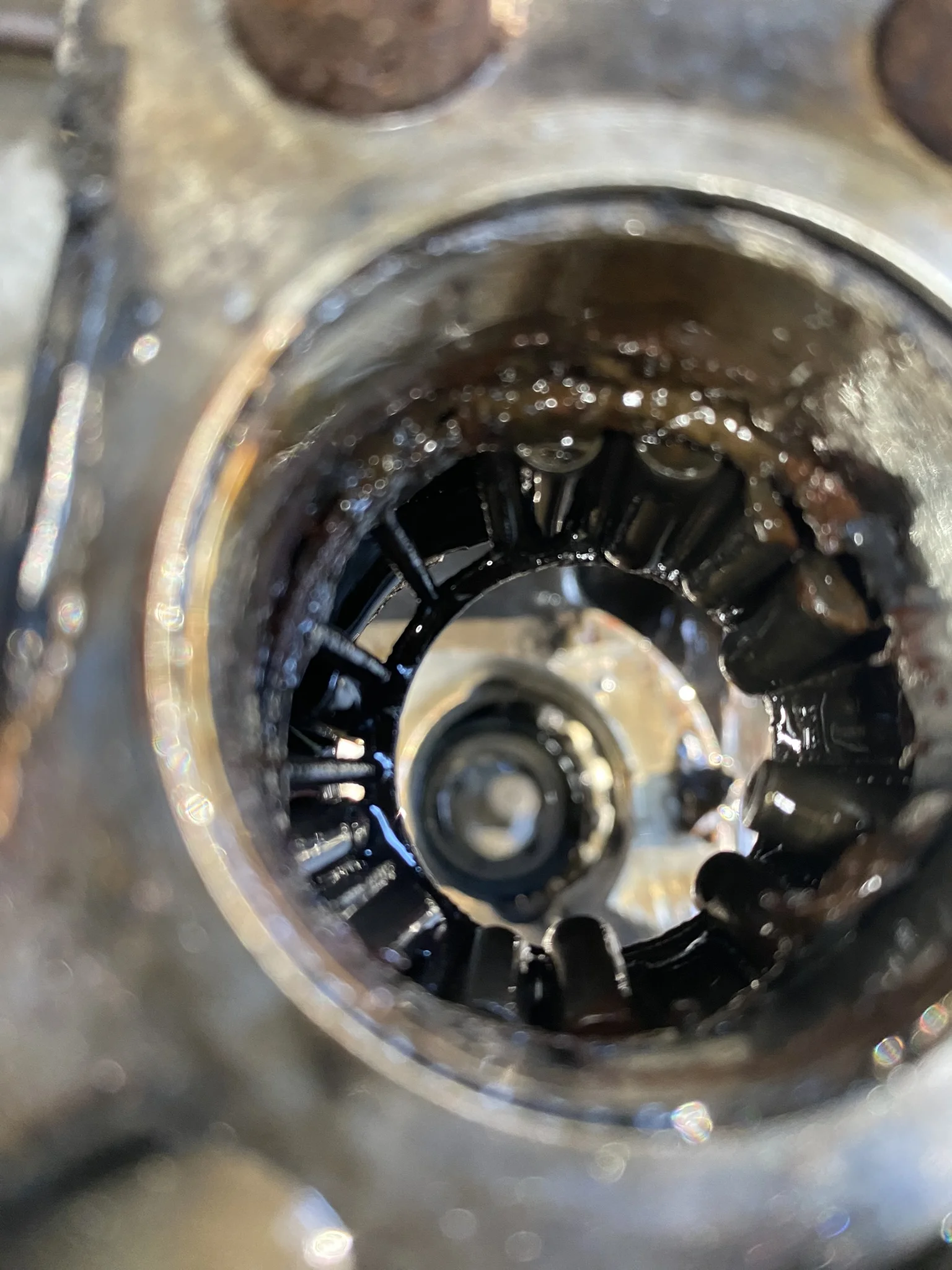

The front axle rebuild went as expected. Most of the time was spend cleaning the axle when it was removed. Everything on this entire truck was CAKED with dirt/oil/grease. Its surprising it ever got this rusty in the first place.

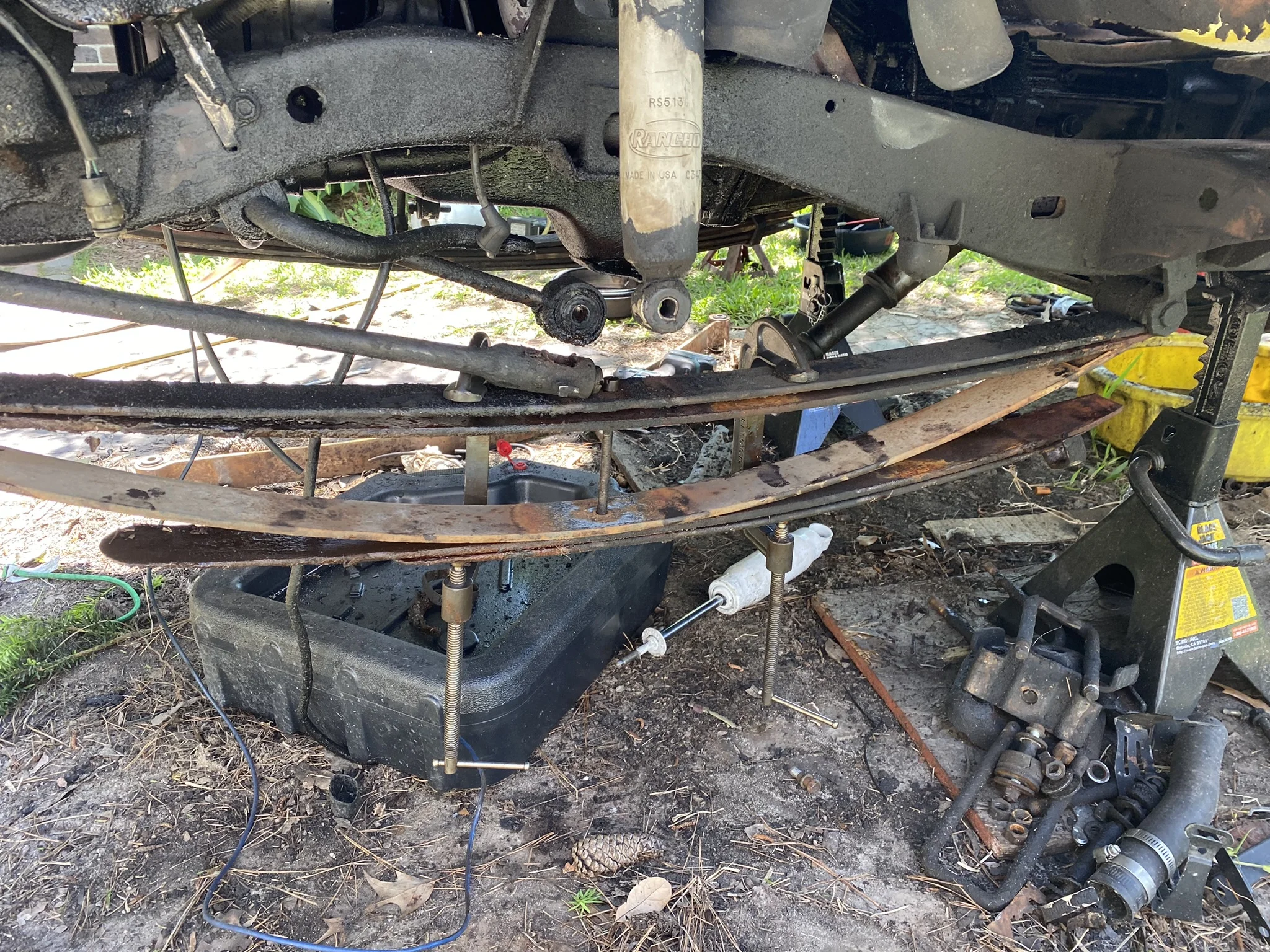

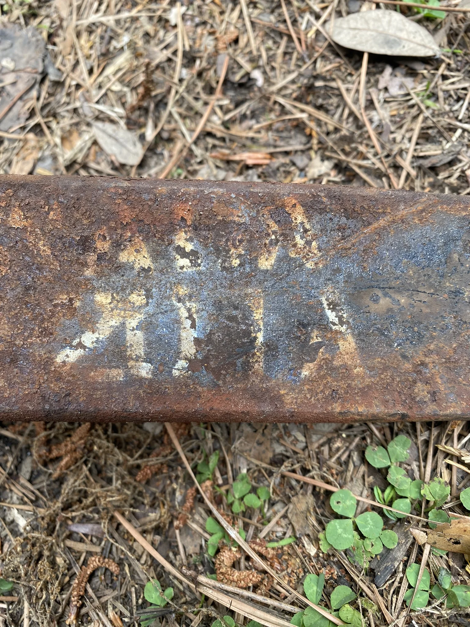

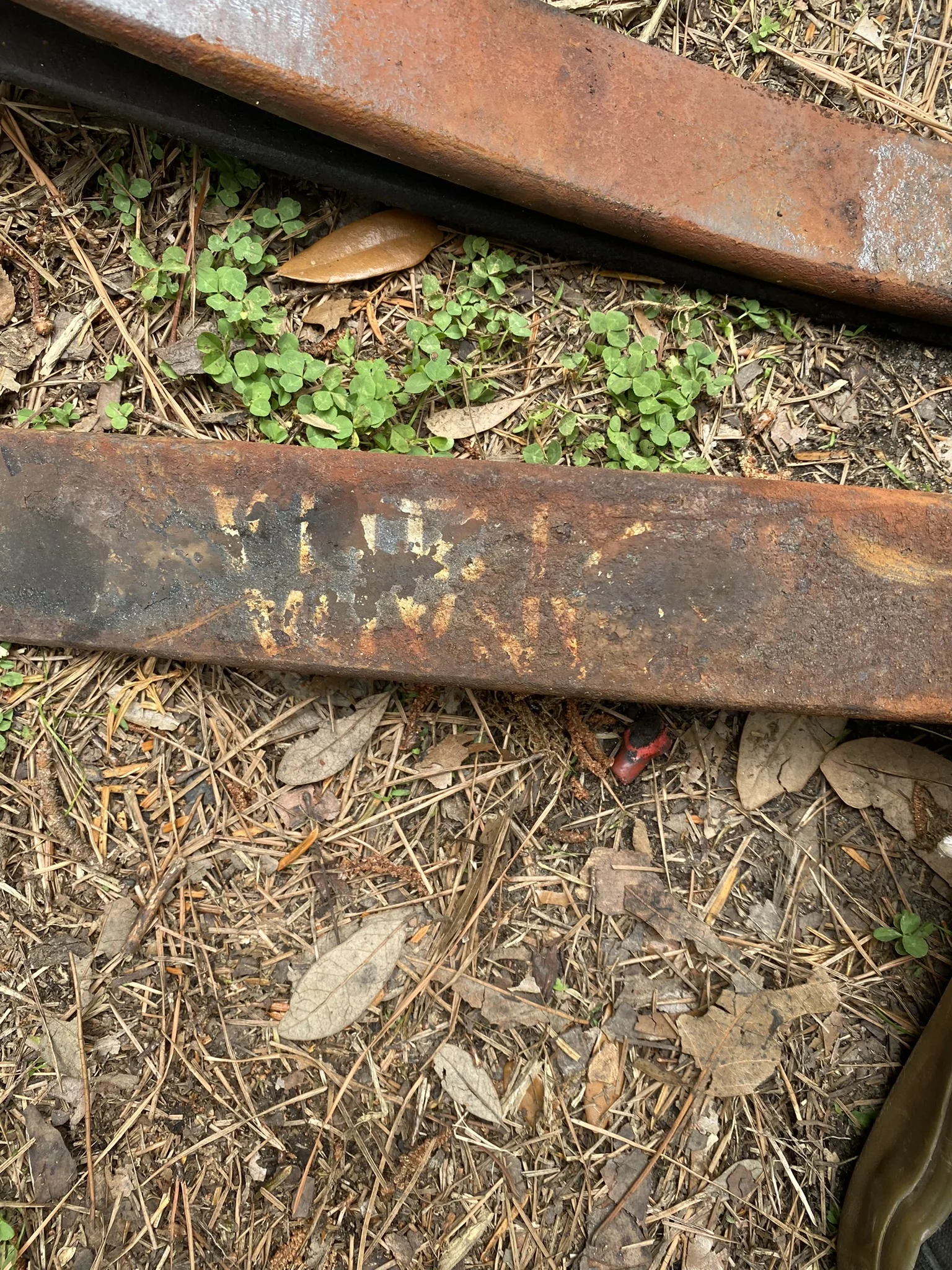

I used the opportunity of having the front axle out to replace the god awful add a leaf that was currently installed. One was missing from the drivers side front corner, I am assuming it broke at some point and was removed. If anyone knows what brand these are I am curious to know. The front AAL was over 1/2" thick and the rear was close to 3/4". Plainly put, there was no suspension travel almost at all. My dad confirms they had been installed the entire time he owned the truck. I installed a spring from a spring pack I got out of a junkyard s-10 blazer.

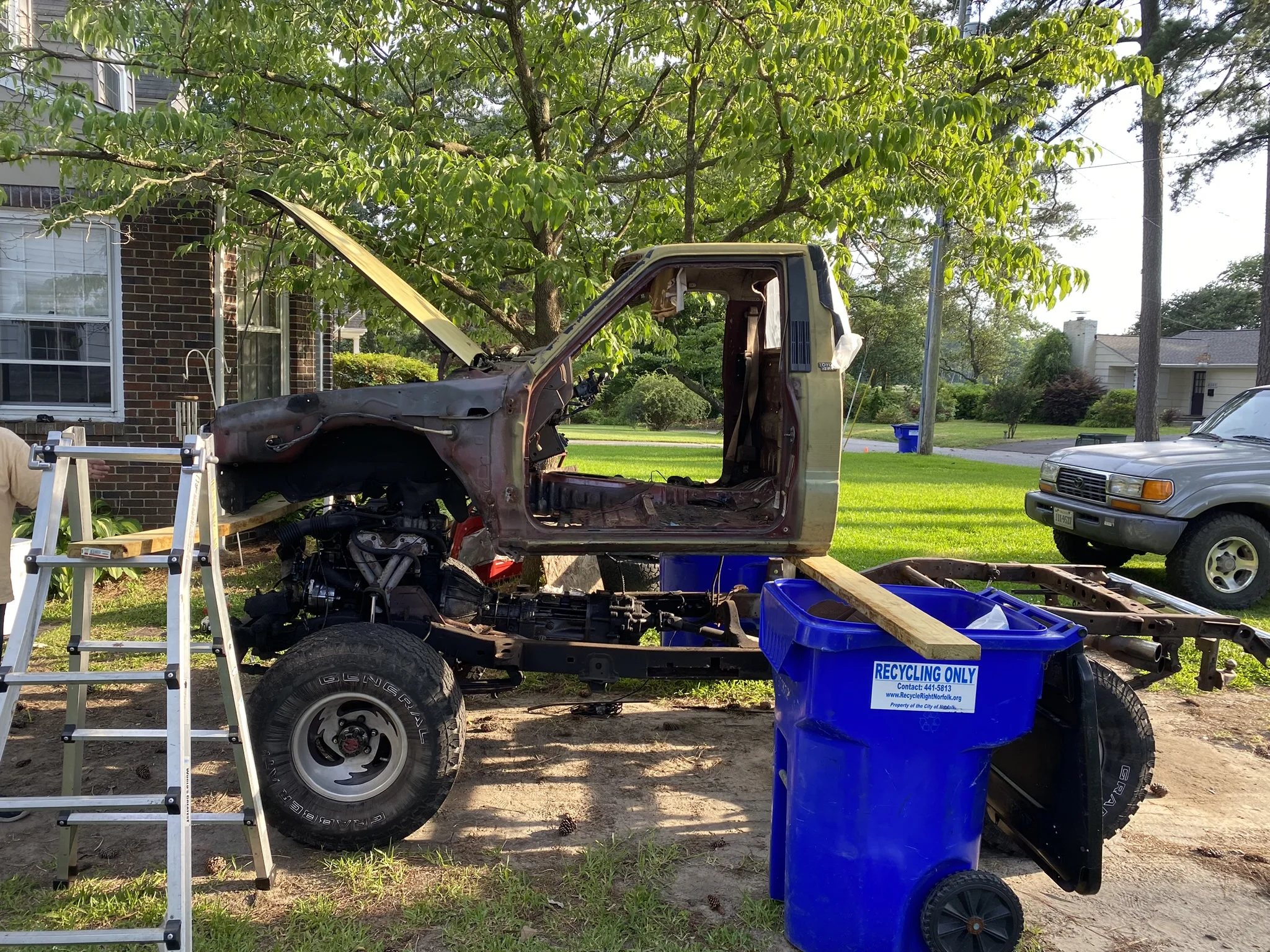

At this point I was neck deep in frame repair, floor and body repair and was contemplating how I was going to replace the metal around the windshield with the truck still on the body. I decided it was time to dig deeper than I wanted to and remove the body. I had never removed the body off of anything. I had taken beds off of pickups, but this was new territory for me. My dad and I got creative. We had jacks, jack stands and a Harbor Freight engine lift to work with.... I reinstalled the axles and started removing the cab.
We could lift the front or the back of the cab, but not the whole thing at once, too heavy and awkward for two (smaller) guys. we ended up working the body up steps at a time. we used a couple of ladders, boards and our municipal trash cans in order to lift the cab up. We rolled the chassis out from underneath and slowly worked the cab back on the ground.

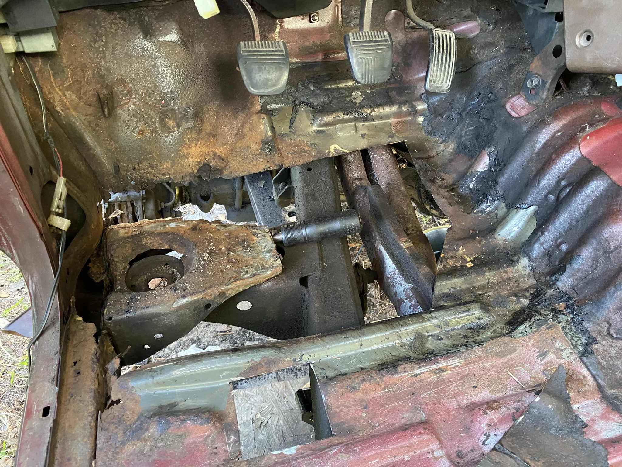

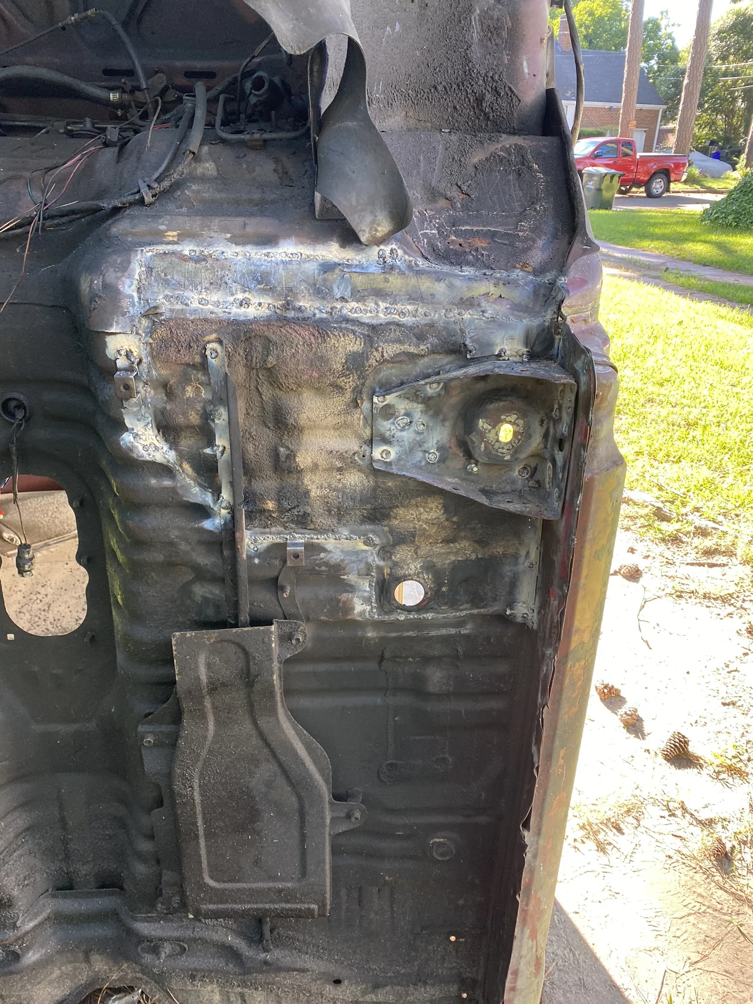

Now I can actually see the floor/body mounts I am trying to repair.

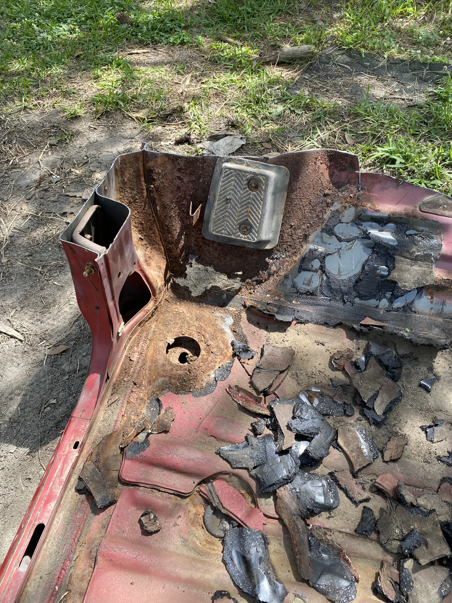

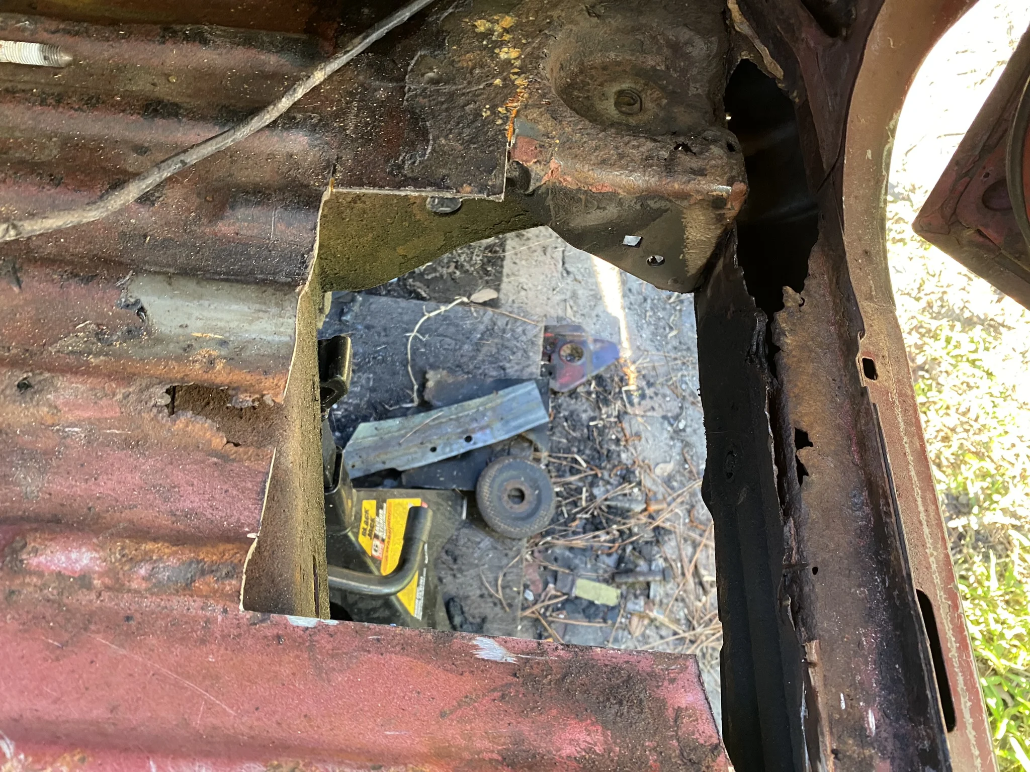

The drivers floor was worse than the passenger side, Both needed rocker work and the body mount replaced. neither side was attached to its frame mount anymore.
I was able to find a decent set of floor boards locally, from an 87 I think.
After drilling out the spot welds, for days, everything welded in great.
Please excuse my flux-core mess, a half-hour with a grinder made it look way better.

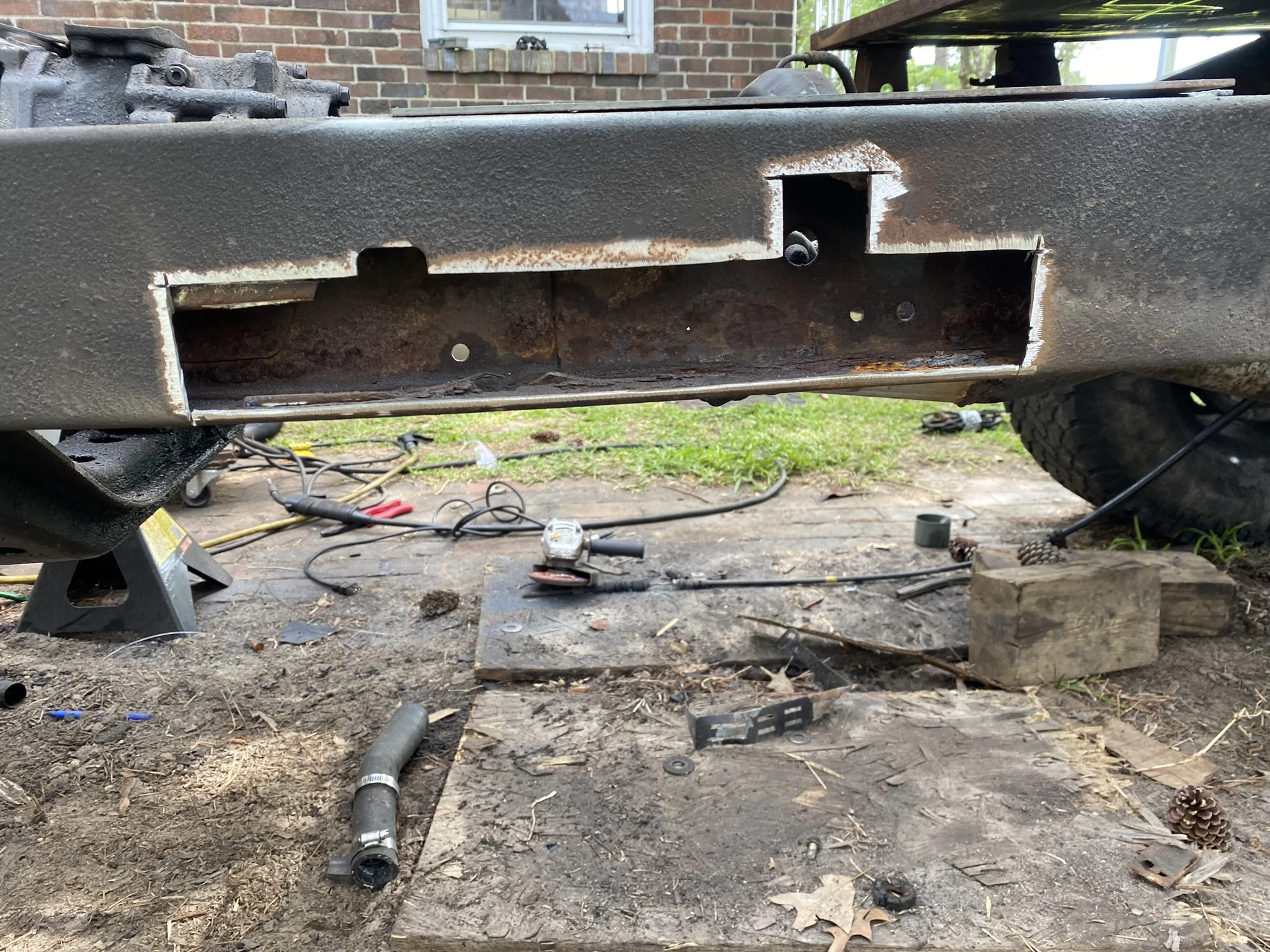

I then set my mind to the many (mostly smaller) frame repairs. I had a couple holes under each cab door and where the frame kicks up behind the cab. I blame my dad for not rinsing out the frame 20 years ago 😂 .
I also plan to treat the inside of the frame. I have had decent luck with eastwood internal frame coating, however I think I may wash the inside of the frame with ospho one or twice to help eliminate some rust before coating. Not sure yet what the plan is.
I smoothed out my welds and primed and painted my patches.
The fuel tank crossmember I scabbed back together and plan on replacing in the future when I can find a good donor.
Its good enough for now however I am not proud of my fix. That will not be shown here. 😂

I think Ospho inside the frame rails is a good idea. Just make sure it's completely flushed out and compatible with whatever you coat the inside with.
