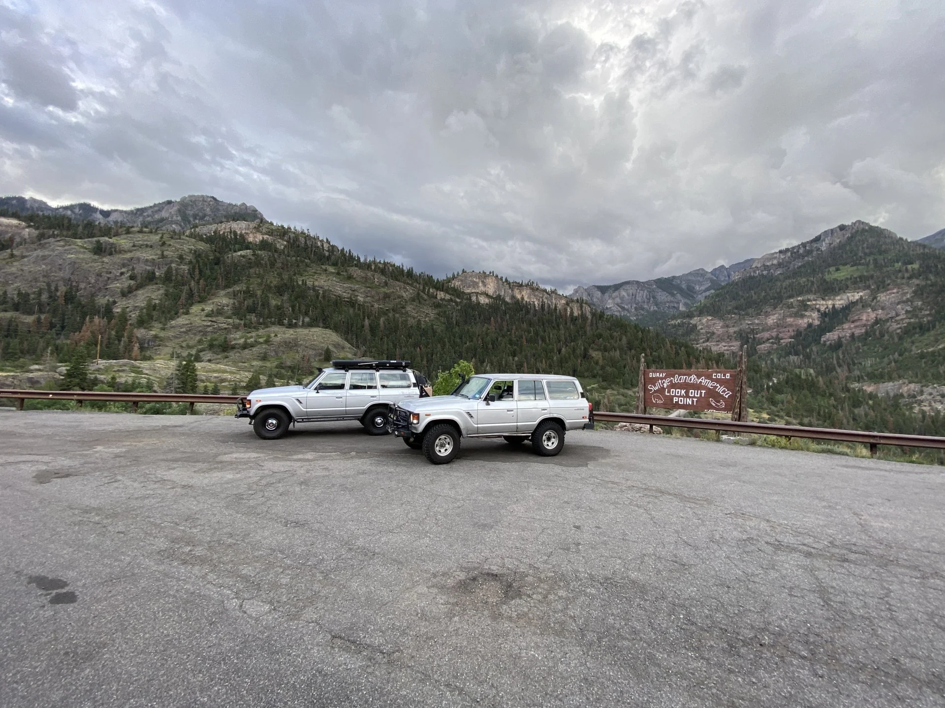

I’ve got 335,000 miles on my 60. Original bottom end 2F, rebuilt head and a desmog. It runs great. I recently drove from Durango to Ouray Colorado and my buddy with a rebuilt 2F drove the same road at the same speed, with the same weight in both of them. Both have a five speed and 3.70 differentials. Mine burns 2 quarts of oil in 6000 miles of oil changes. My truck had a broken exhaust valve on one cylinder and it uses oil on that one cylinder. Otherwise the motor runs great and doesn’t make any weird noises. It gets 12-16 mpg highway depending on how flat it is and which way the wind is blowing.
Both trucks used the exact same amount of fuel. That was mind boggling.
We used the exact same amount of fuel. Nobody pulled away from anyone.
