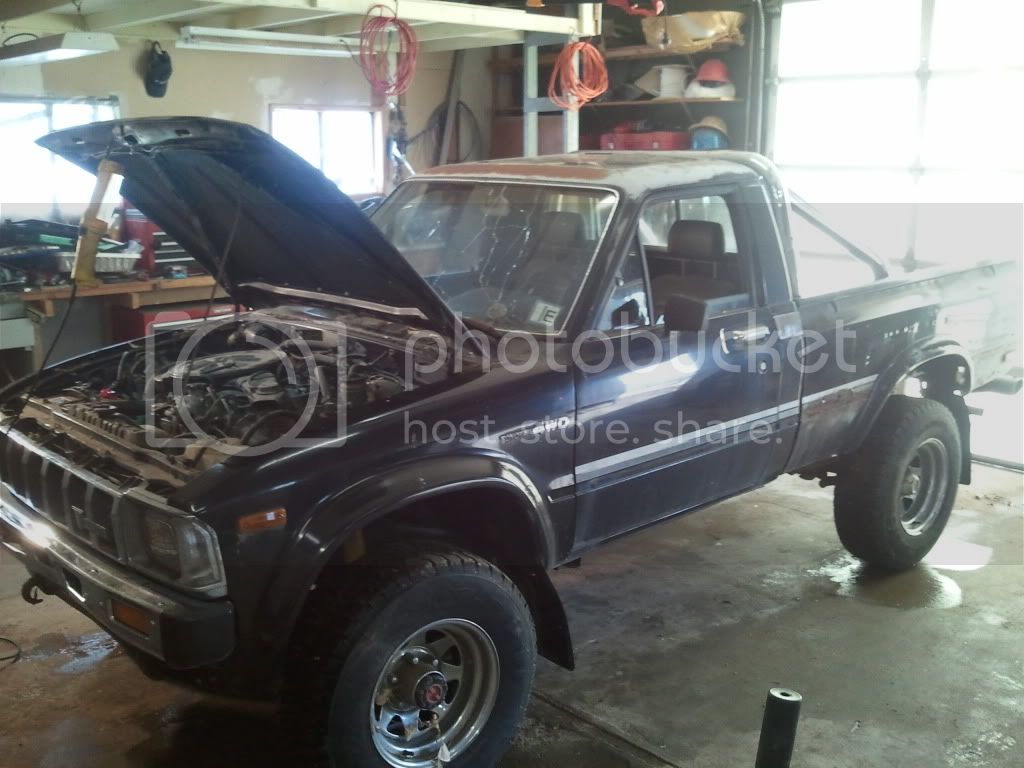

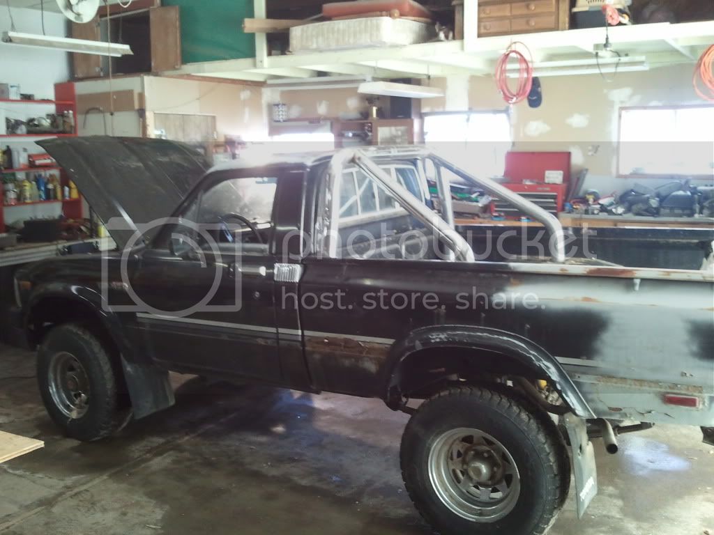

Thanks for all the information!! Helped a lot. So I drove up the other day to check out the truck. Turns out it's an 82 w/150k. But a couple of surprises like a factory sunroof, tach, full gauges and AC. Took me about 30 minutes getting fuel to the carb and adding some coolant, and it fired right up. I guess it had been sitting for about 5-6 years. Went back up today and checked all the fluid levels and drove it around. Everything seems okay..Here is a couple of pics....I need to replace the water pump gasket to get it home..not bad for 400 bucks!
Beautiful!
That's a nice score!
FWIW I have a factory sunroof on The Mule, my '83, and the results are better than AC. Windows, bug-catchers blowing in, and the hot air escaping through the top hatch, the circulation is just unbeatable.
Weather permitting, you may want to open the dash up completely, and recombobble the heater ducting, mine's vibrated loose, and now the heater just blasts warm air from all the gaps and craters in the dash, it's amusing, but unfocused...
Great score man! Welcome to the First Gen club!
