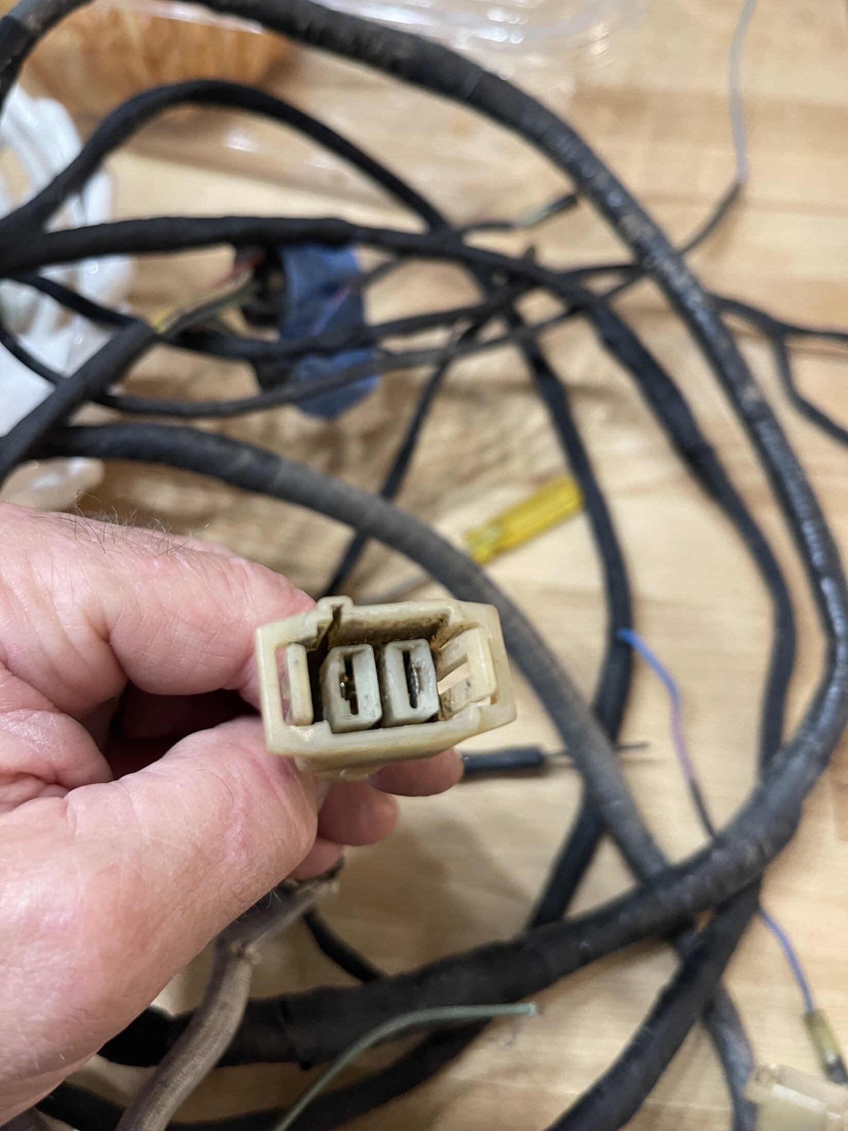

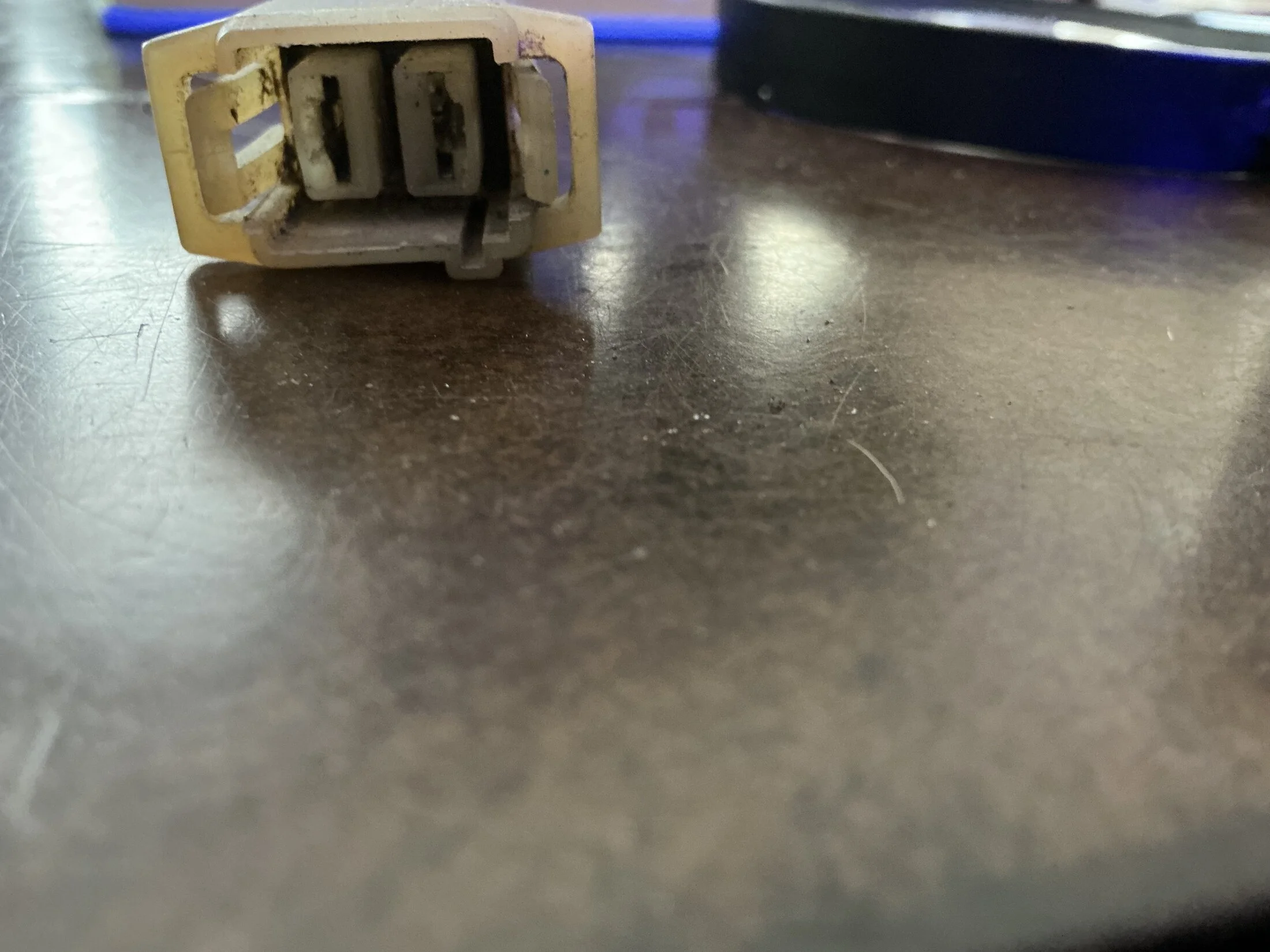

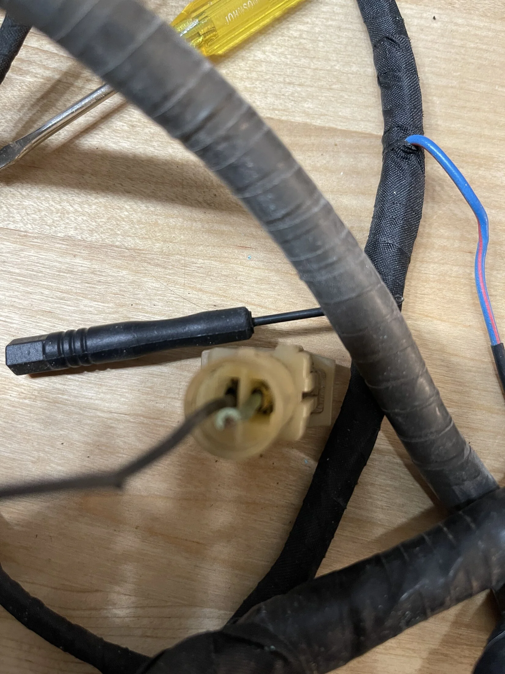

In the last pic there is an indent on the female end. Stick a thin pick or screw driver (watch maker type) with thin shank into indent to push in tab, pull wire from other end while shank is seated.

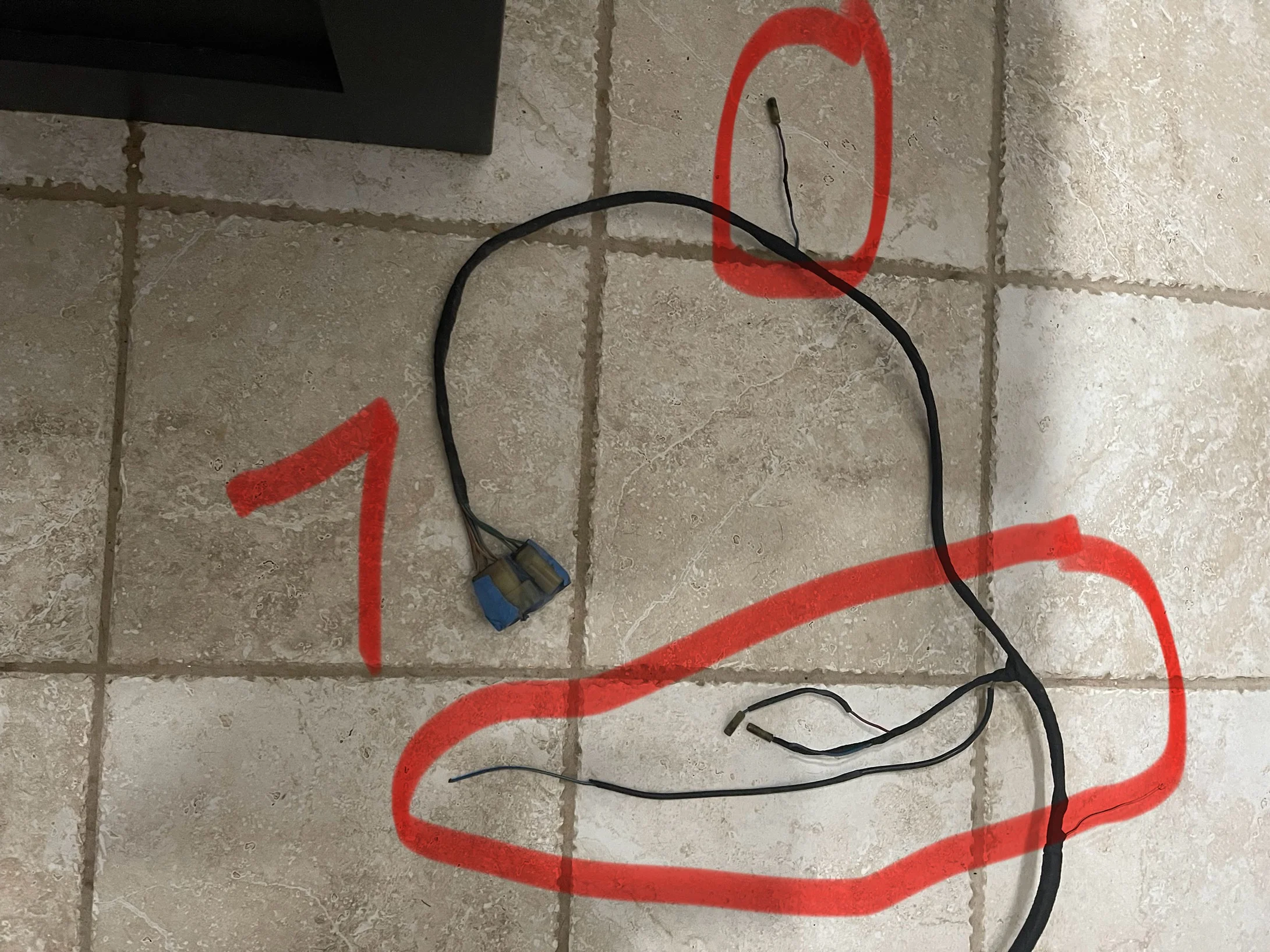

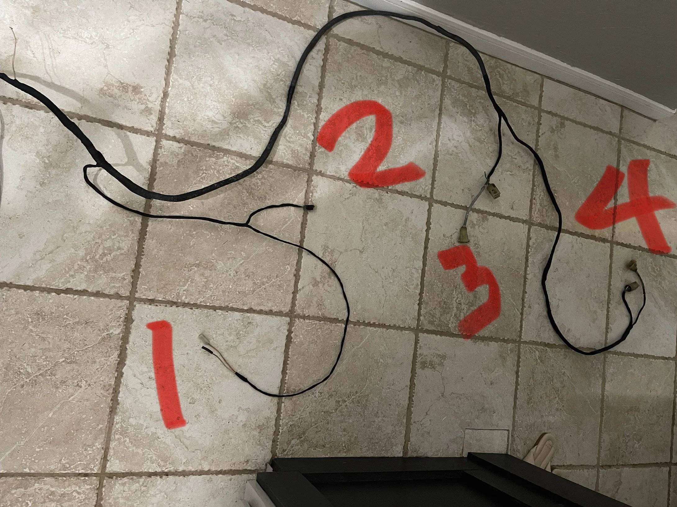

This is the rear harness, 7 is the connectors to the main harness by starter.
What are the 2 other circled areas go to?
I know1 is the gas sending and 3 & 4 are the tail and side markers.
What is 2 go to?
What color are the wires? The only thing that comes to mind is the reverse light.

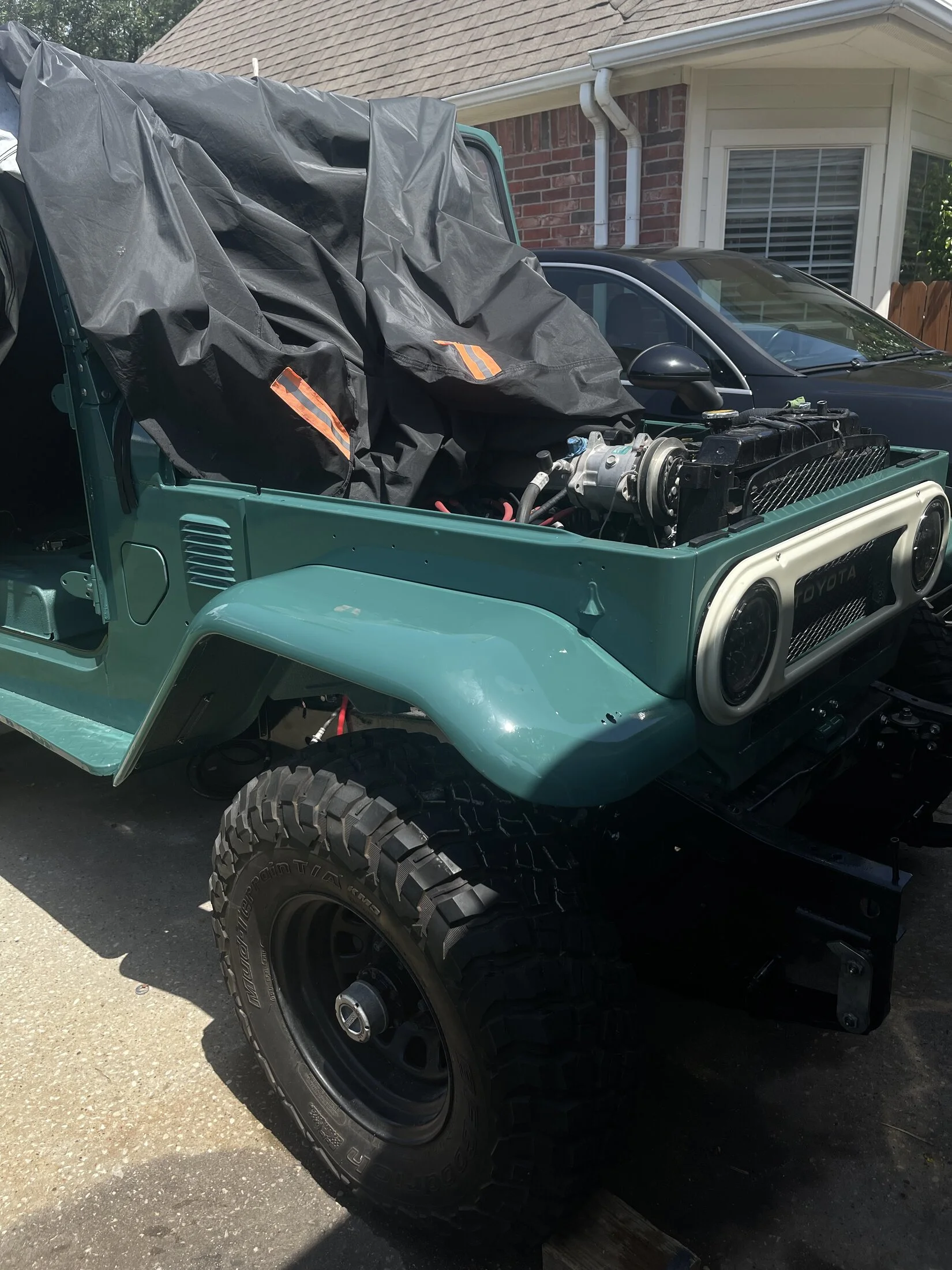

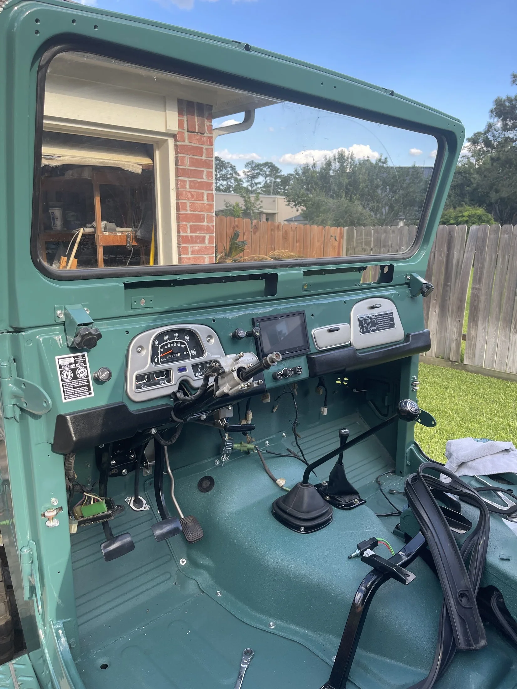

Little more progress. Window installed. Getting the weather strip on was a pain.

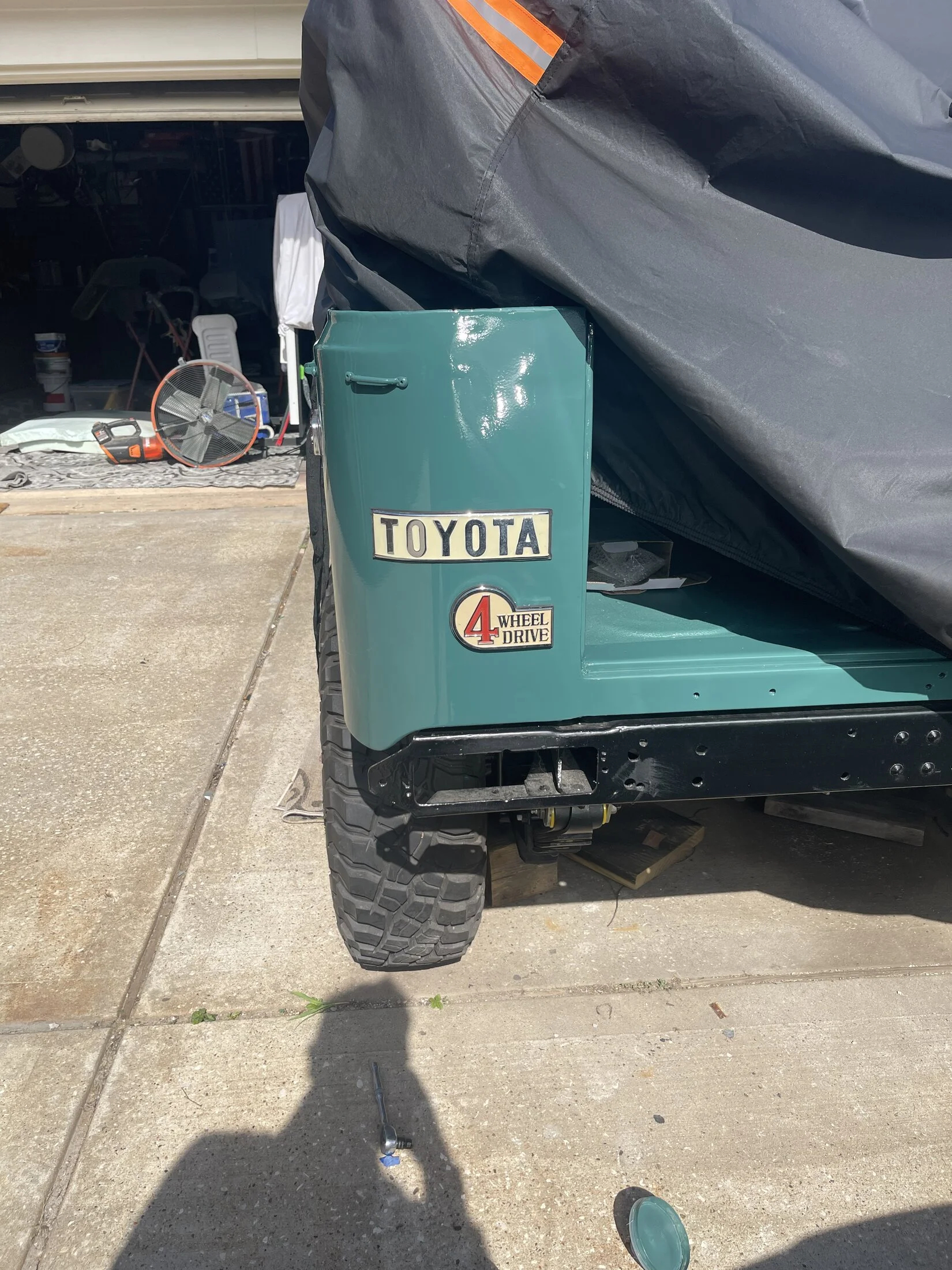

It’s a official Toyota now.. lol

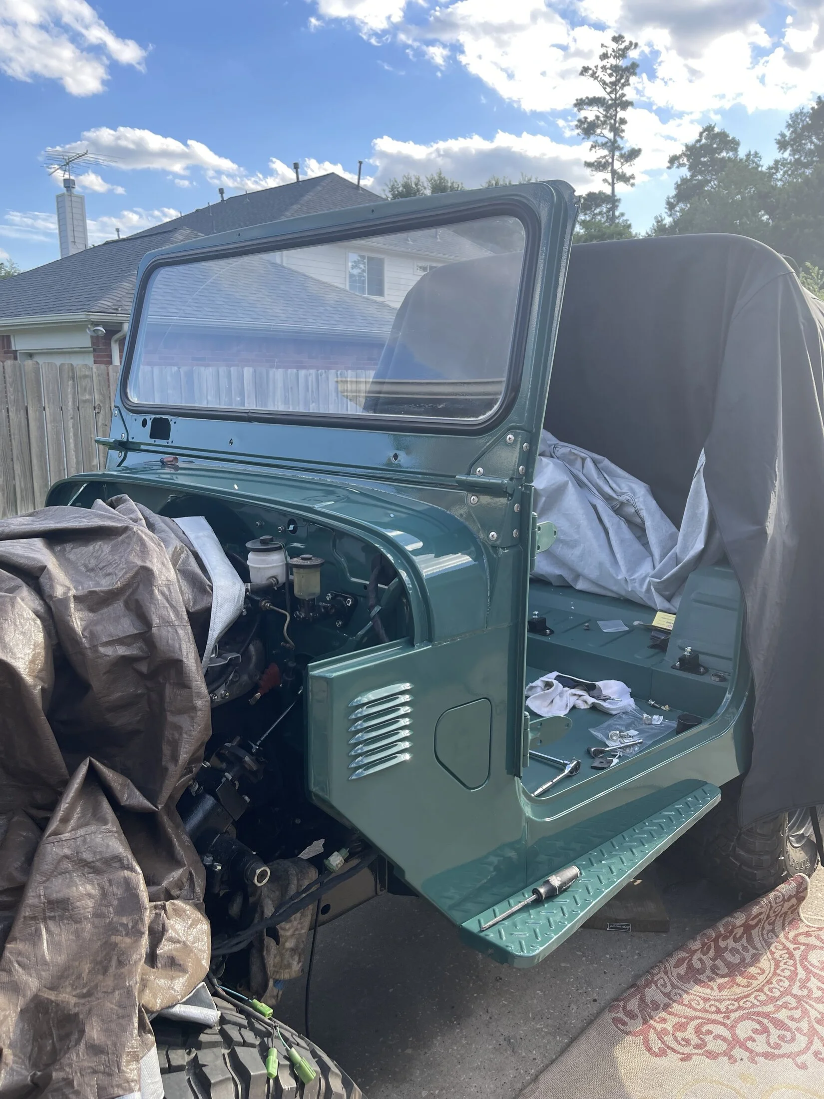

I am a little overwhelmed right now, I have so much to do. 😜
Not to mention all the wiring that still has to be done. EFI, amp, speakers, miscellaneous connections here and there…
Also have to remove the steering box, have to replace seal. Leaking bad. Guess sitting in the heat did a job on it because it didn’t leak before..

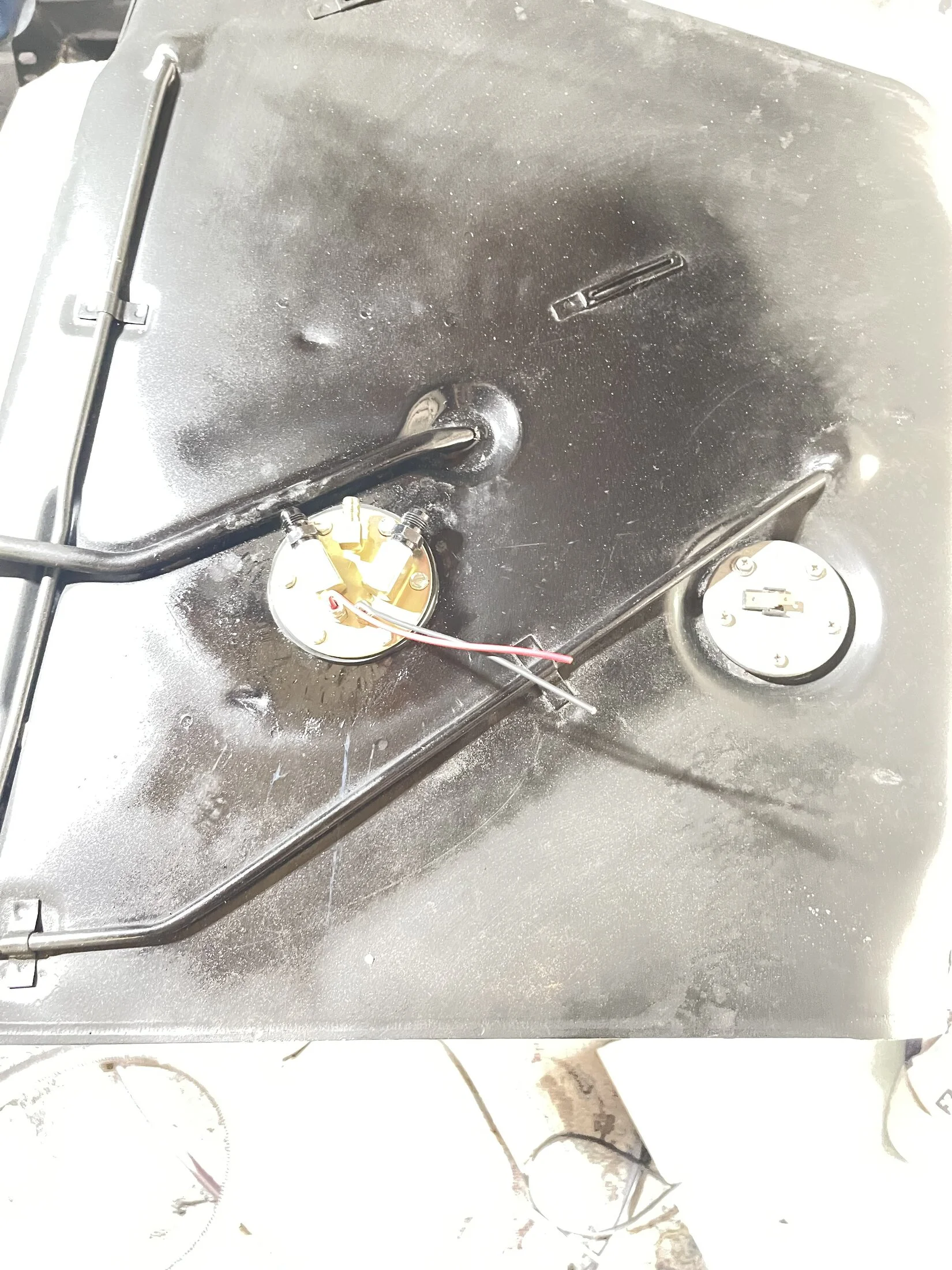

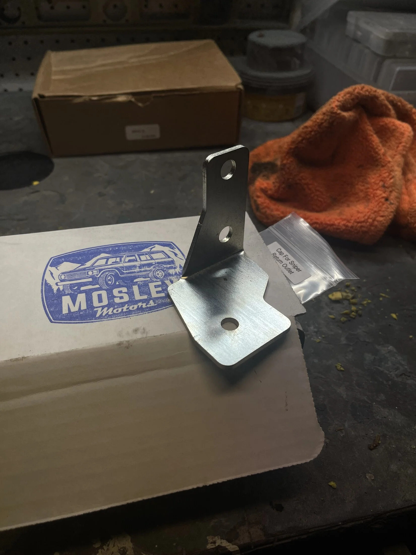

Step one of sniper instal. Had a little snafu with the hole size drilled…too big. Welded back in and re drilled with correct size. 🤬 all good now.
Had to cut the tank cover as well.

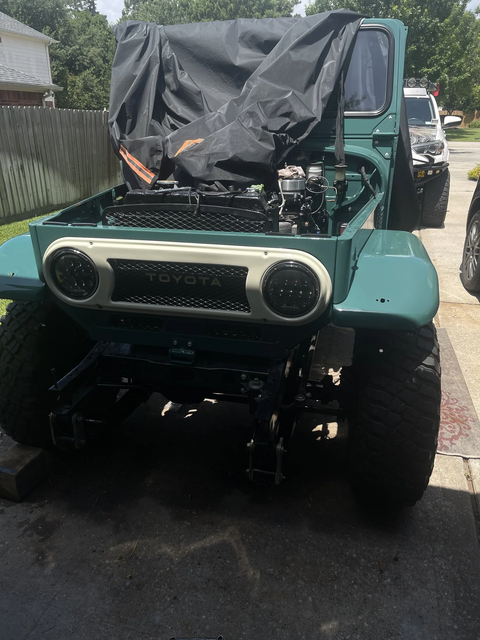

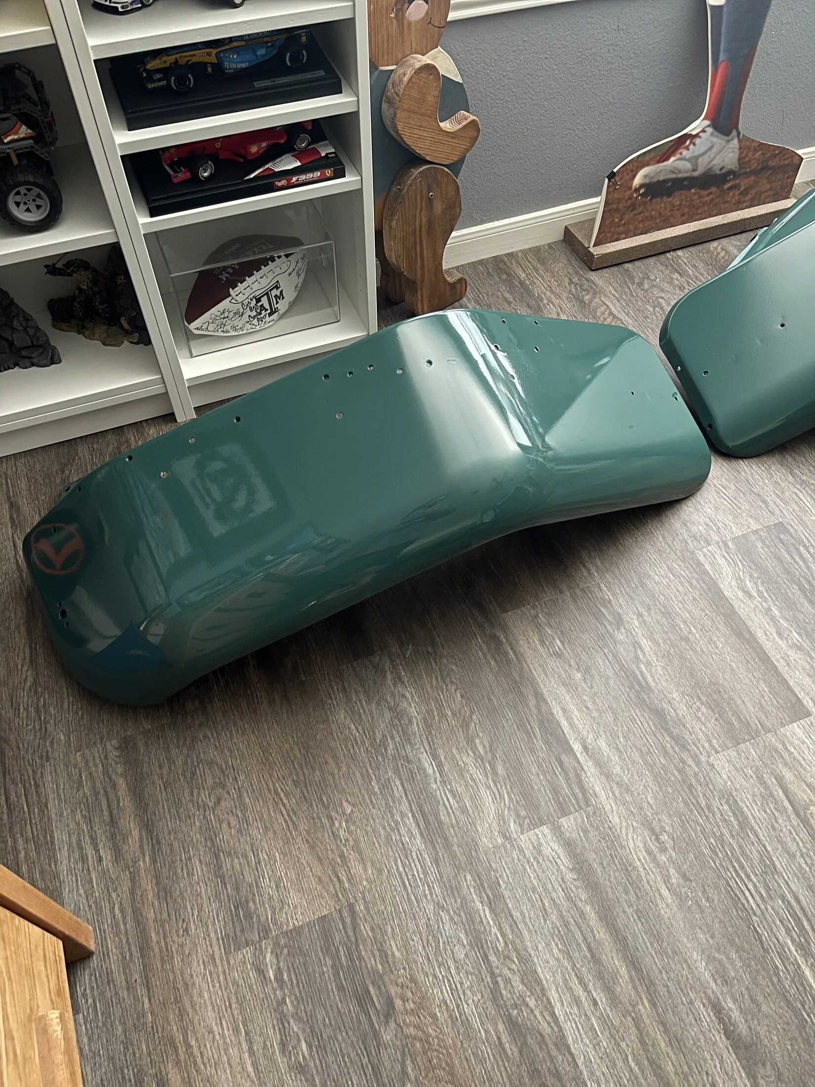

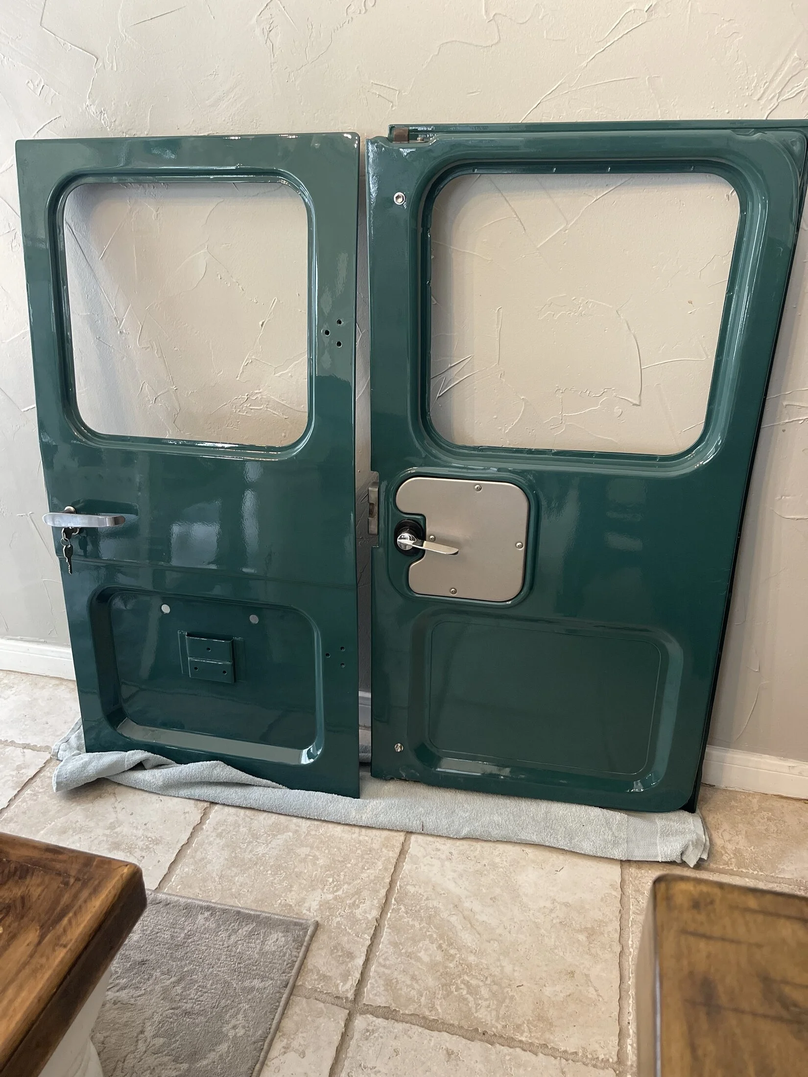

Hoping to get the fenders and ambulance doors painted Friday. Then I can tackle the hood.😜

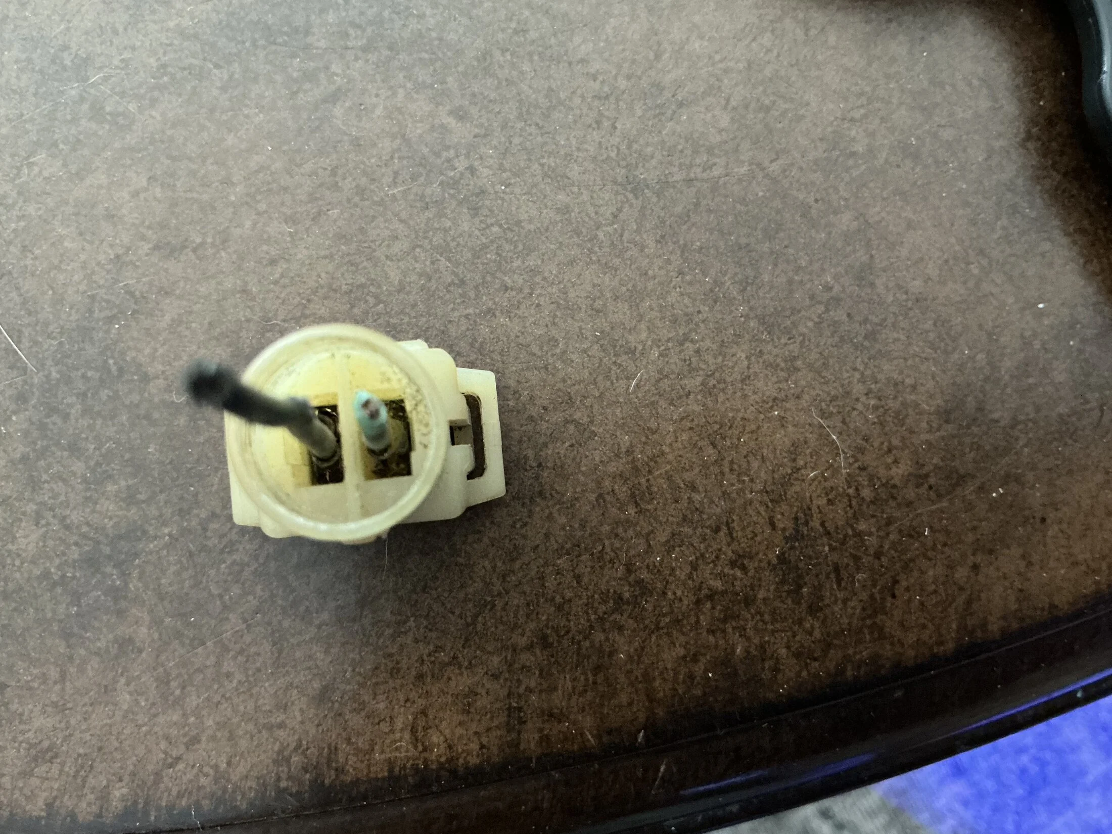

How the heck do you remove the connector on this plug? It is the side marker light plug.
Thanks
Back on this …designed to piss you off is what this is…..I don’t see any tabs to push. Looking down the side wire is, it looks like the plastic housing is smaller than the metal connector. Is there a vid out there somewhere ?? 🤬
