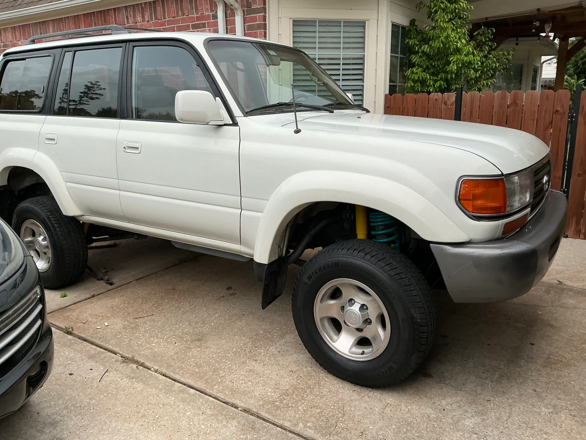

I have been wanting a 80 for a long time! Finally pulled the trigger. Is bone stock Cali truck 1996 with 260k miles. Engine has been rebuilt, so that’s good.🤷‍♂️
Looking for some advice on a starter lift kit. I was looking at the “
4″ Dobinson 80 Series Landcruiser Lift” heavy springs front and back.
Anything that is a must with this? I have a set of 35” Toyo R/T’s on Icons on my 4 runner I plan on putting on this.
Is there any other “must haves”?
More pics to come, and look forward to this build.
Thanks

Lift really depends on your overall plans. I have had my 80 for over 20 years and it has been an evolution. If not planning on a lot of weight (bumpers, sliders, winch, etc), I would avoid heavy springs as the ride will be harsh. I have a 4" lift and really like the height BUT typically going above 3'-3.5" adds another dimension of needs. 4" gets you into the territory of longer front control arms (to recenter axle and adjust caster, most likely a DC front drive shaft once pinion angle is changed with arms), probably will then need a little longer rear lower arms, which will in turn most like require adjustable rear upper arms. Will also want to add longer brake lines. If not dealing with much elevation change while driving, you will probable be OK with stock gearing, although t-case gears or diff gears will help a lot with the drivability on and off road (I vote high and low range T-case gears over diff gears for 35s). If ever going above 35's gearing will probably become a must. I have high/low t case gears from @cruiseroutfit. I ran those with 35s for years and was very happy with the results. When I went to 37s, I added 4.56s in the diffs.
Also need to consider an adjustable front panhard rod to recenter wheels under the truck and the rear panhard bracket from Delta VS is a must do as far as I am concerned. That is another mod that made a tremendous difference.
I would suggest giving a lot of thought to intended use of this 80 (which is stunning btw) and work backwards with the build.

Congrats on the purchase. As for a 4" being a starter lift...that made me chuckle more than it should have.
As I ask most everyone that asks these questions, "what is the use case for this truck?"
You do not need 4" lift to get 35" tires on these. There are a few that actually use there rigs for semi tough trails and are running a 2"- 2.5" lift. I only say this as once you get to the 3" and higher lifts you will need to do more adjustment to the suspension. I assume you may already know this if you are running 35" on a 4runner.

I ran 35s with a 2 inch lift for years with no issues. 4 inches and you’re looking at other handling issues.
Lifts depends on your intended use, the compromises you're willing to make, and the amount you are willing to spend.
Dodinson springs and shocks installed. Front and back sway bar extension. Brake proportion valve extension. Extended brake lines. Caster adjustment brackets for front.
Waiting for wheels to get her tomorrow, then wheels go on. 🥳
