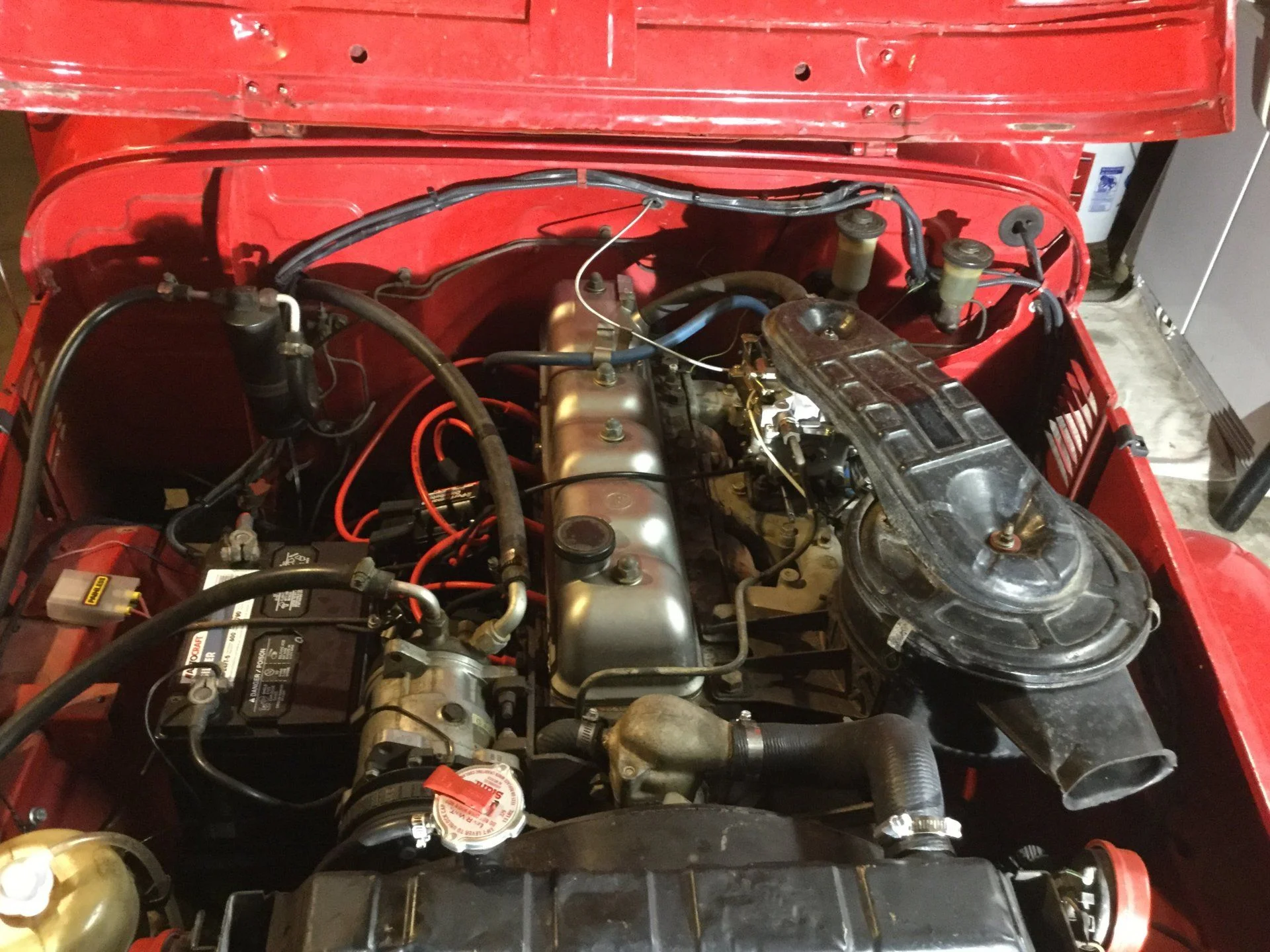

It has a new carb, I put a new HEI distributor on it. Didn’t want to mess with points and crap with my son driving. Needs to be reliable.

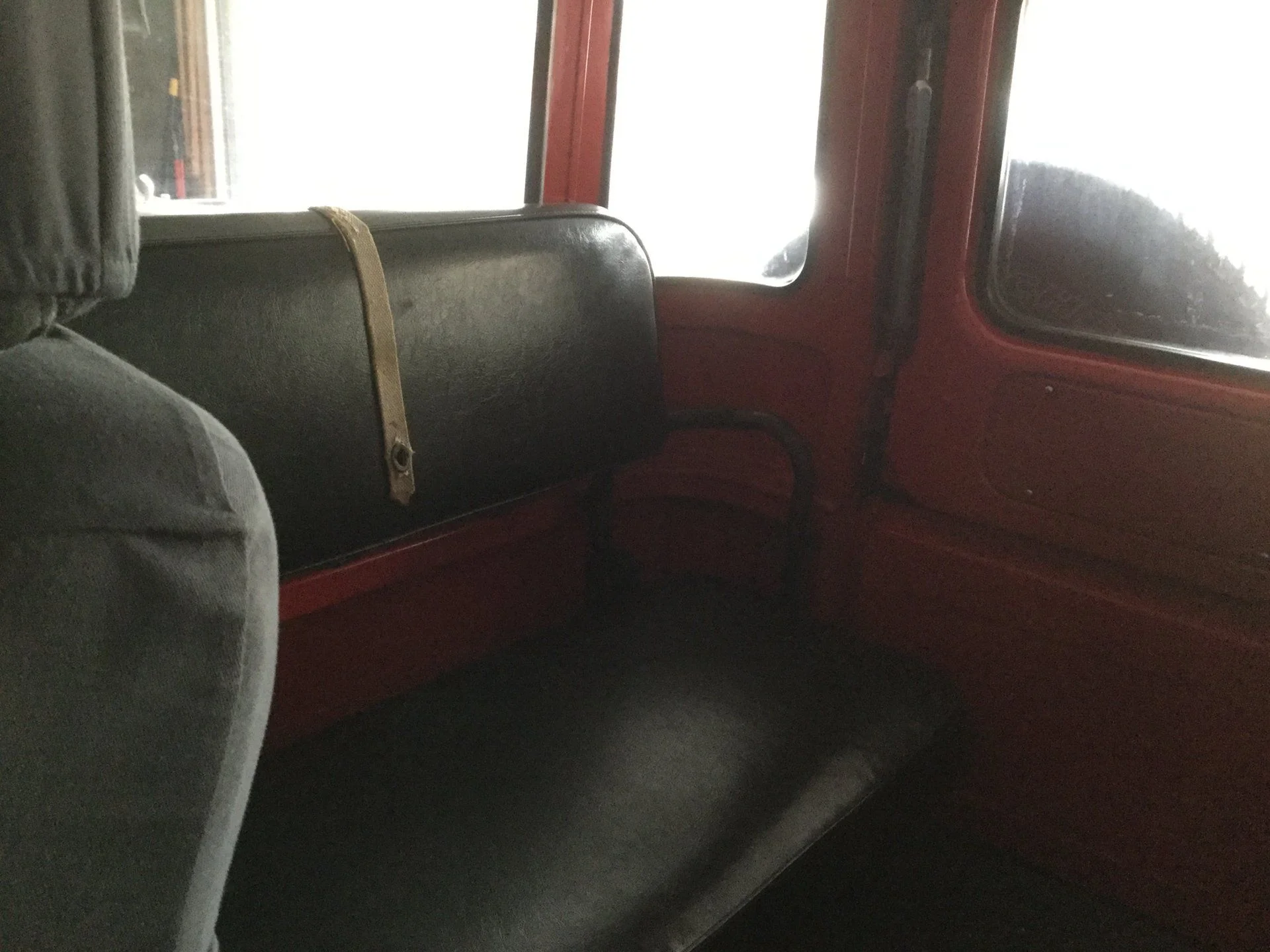

Put original front seats in it.
Looks like it didn’t come with a roll bar, but plan on putting one in. It has the long jump seats, so will have to see how that works.

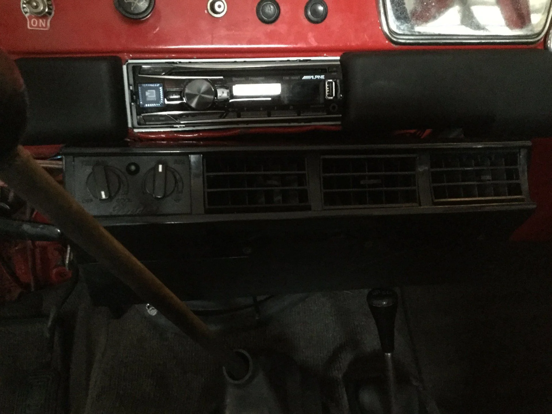

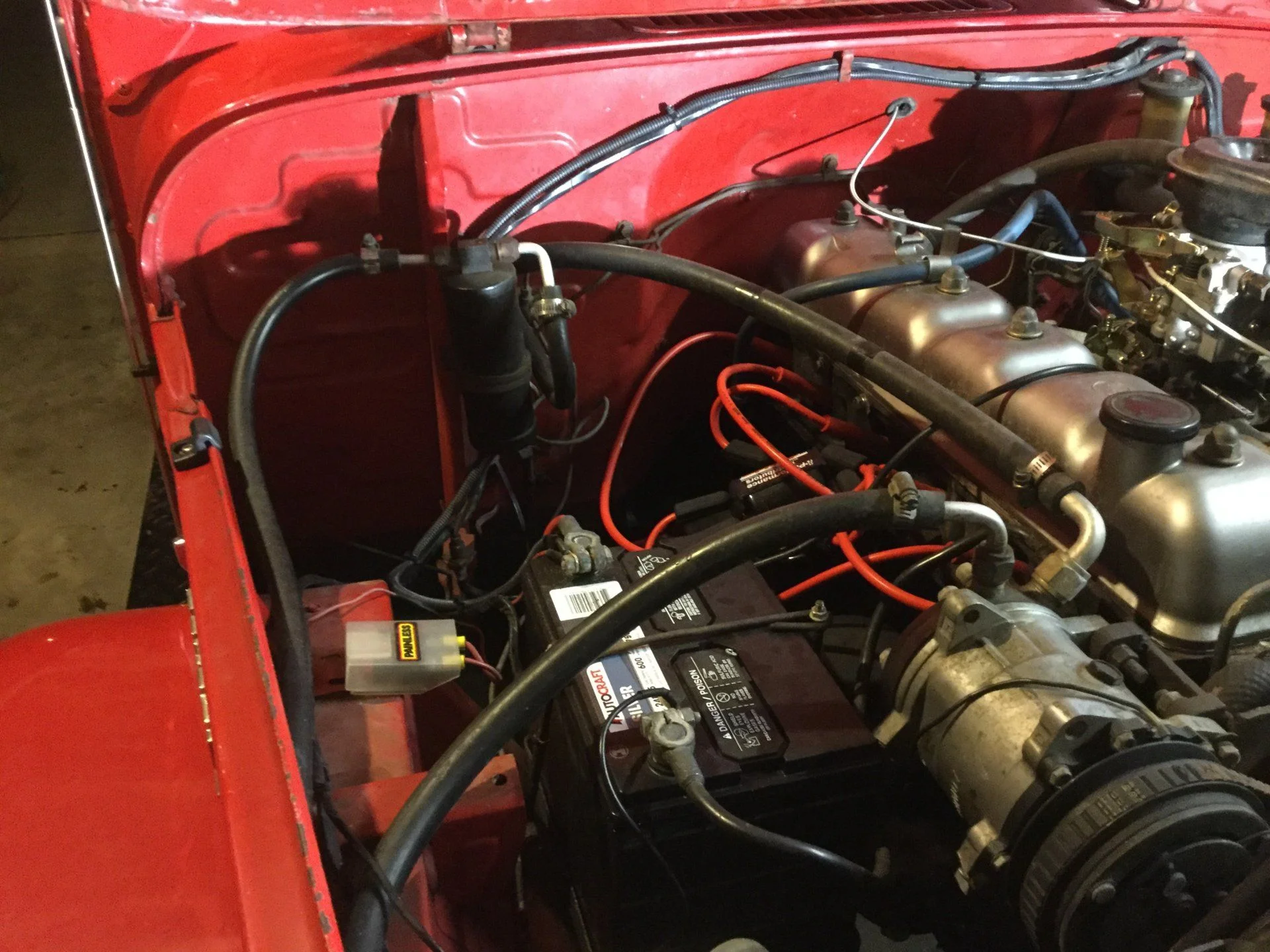

It does not have a heater, but does have AC. Aftermarket I guess. Will post pics to see if anyone knows what brand it is.
Would like to install heater and blower motor. Just not sure if I can. Would have to cut the hole if firewall.

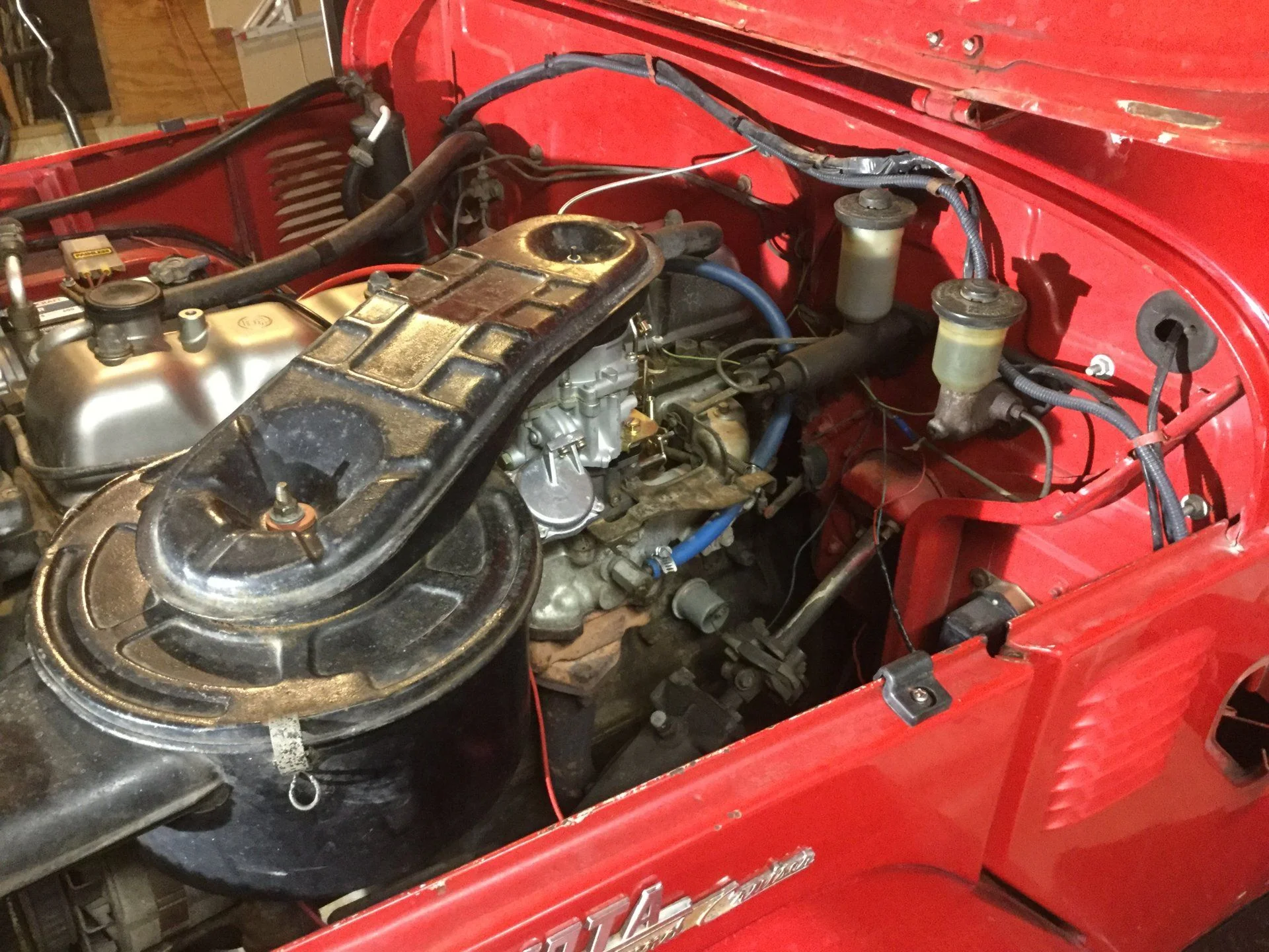

Does not have a brake booster, but I do want to upgrade to that. It has disk in front, drums in back.

AC looks aftermarket to me. Definitely not the same one that came in mine right where the passengers knees should go :rofl:. That's probably all you need in Houston though!
I'm interested in how those jump seats are mounted if you have any more pictures? I also have a 73+ model with no roll cage and I'm trying to figure out how to correctly mount the seats

Inspecting the gas line today, I see that they only have one line active.
The line that is on the side of tank is plugged.
The line on the bottom of the tank runs up to fuel filter in engine bay and to pump, up to carb.
What is the purpose and what does the other line run to?
Bench, really? Could I be able to verify by the original mount locations in floor? Or are they the same for buckets?
more like a 40/60 split bench.
middle and passenger side fixed
drivers side adjustable
other fuel line was a return from the carb

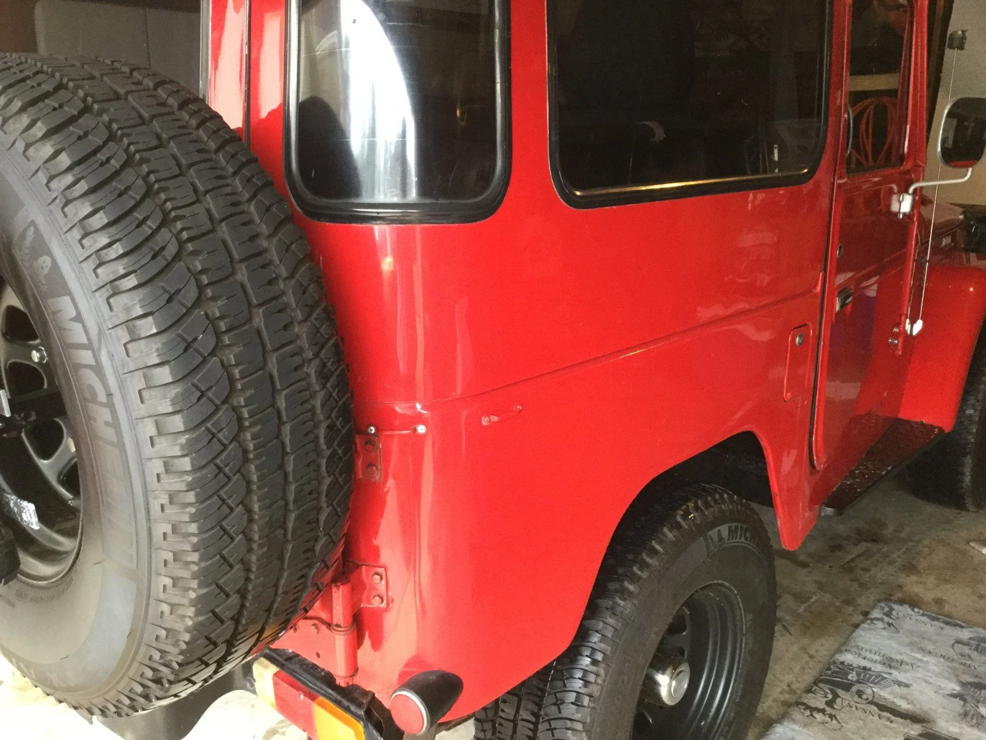

spare tire carrier has an interesting hinge arrangement.....bottom hinge is mounted upside down.
i'd be more inclined to jump on the brakes first.
cant imagine how well it stops with a non power assisted single system....im guessing not well.

Any suggestions on what setup I should do? Would a brake booster bolt to my firewall? The single reservoir only has 3 bolts..
