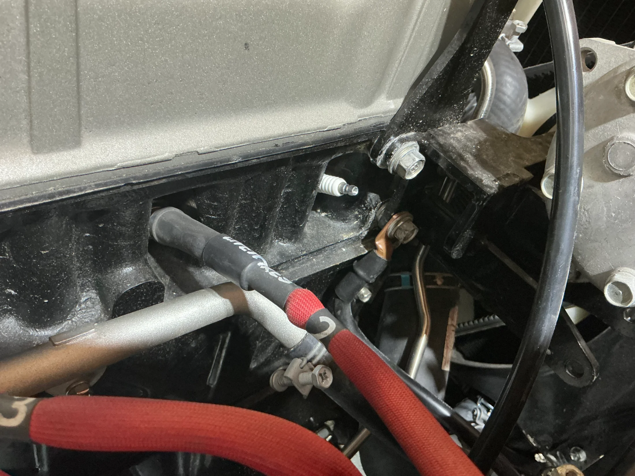

Measuring across the battery while running it only shows 12.5V.
When I measure pos on battery and the Bolt on the block where ground wire is it measured 13.4V.
Just FYI, I moved the cable behind the bracket next to block..
So is that telling my that ground wire from battery to block is not good?/
I just did new copper 2/0 cables. + right to solenoid then - right to engine block, used old #2 to ground from that spot on block to starter mounting bolt. I sprayed all the cleaned connection with battery terminal spray before torquing down the bolts/nuts.
Happy to report we are running like a top!
Fixed the ground cable from battery to block. Scratched the paint off block and re made the end connection. It was a little loose.

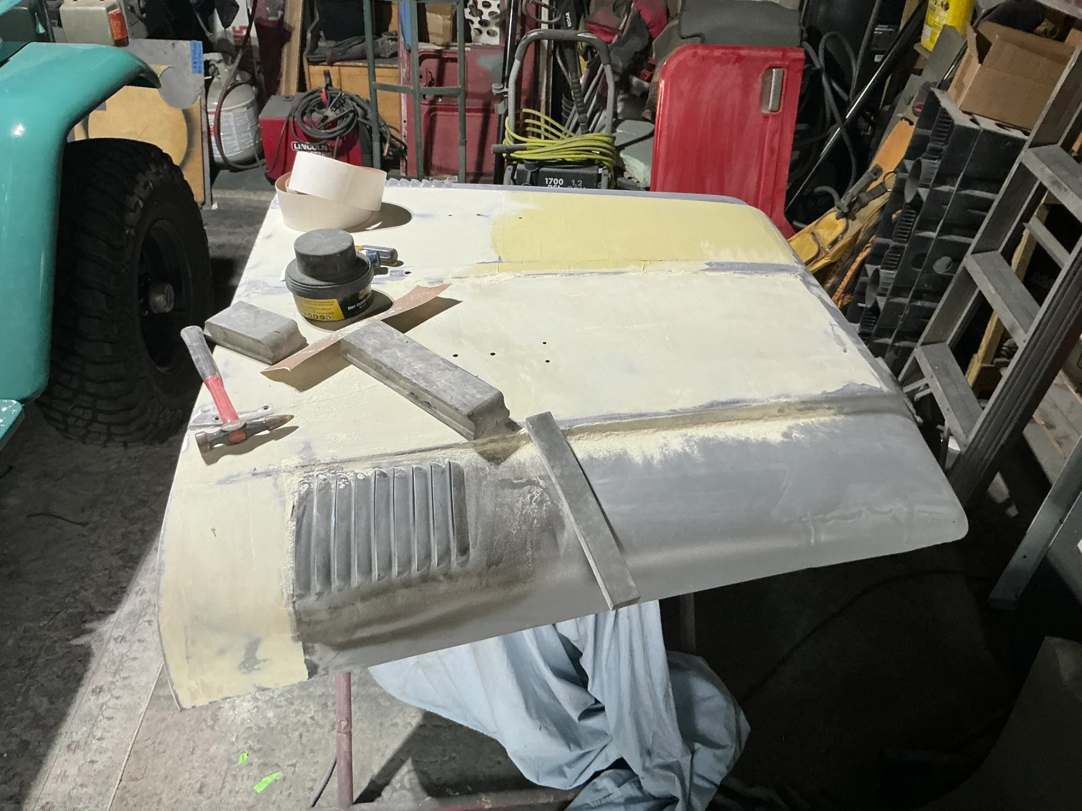

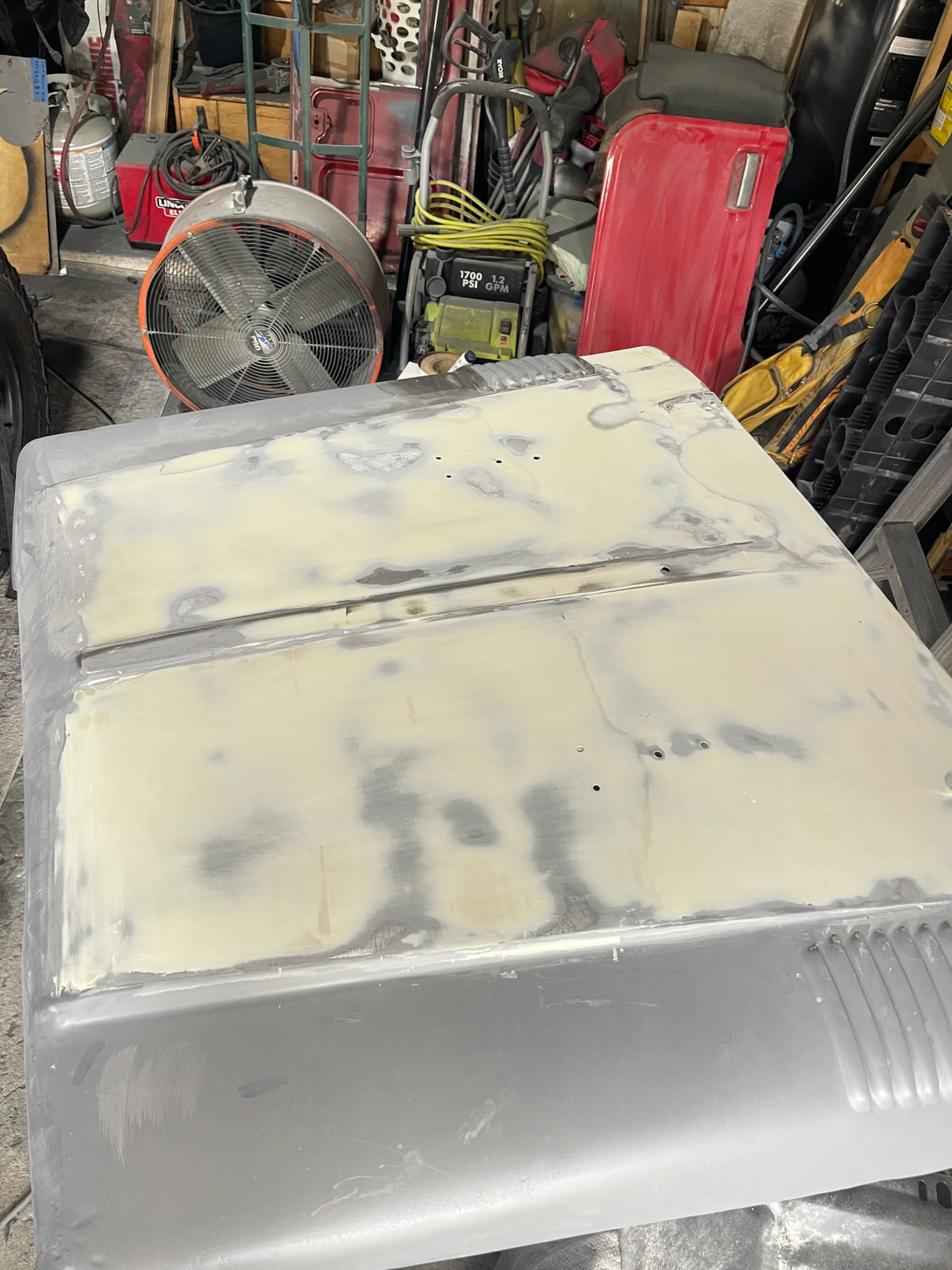

Working on the hood, last big piece of the puzzle.

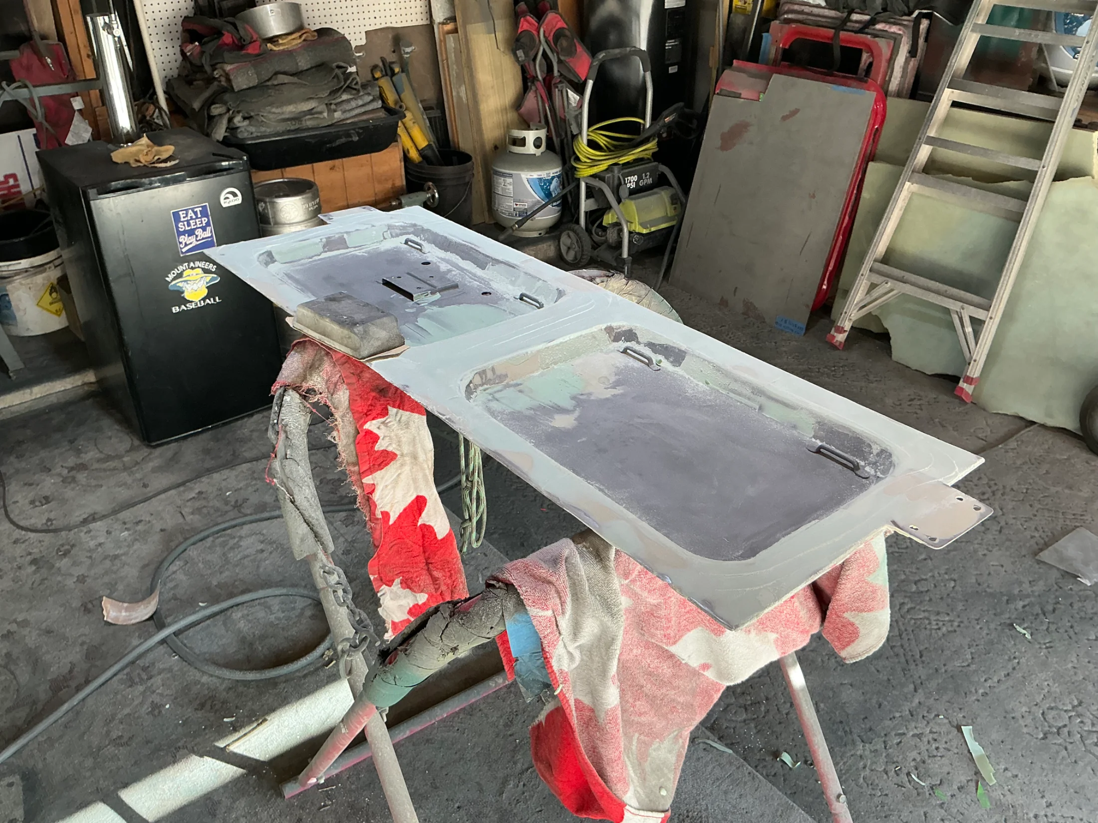

Doors and 1/2 doors are ready to go to paint.

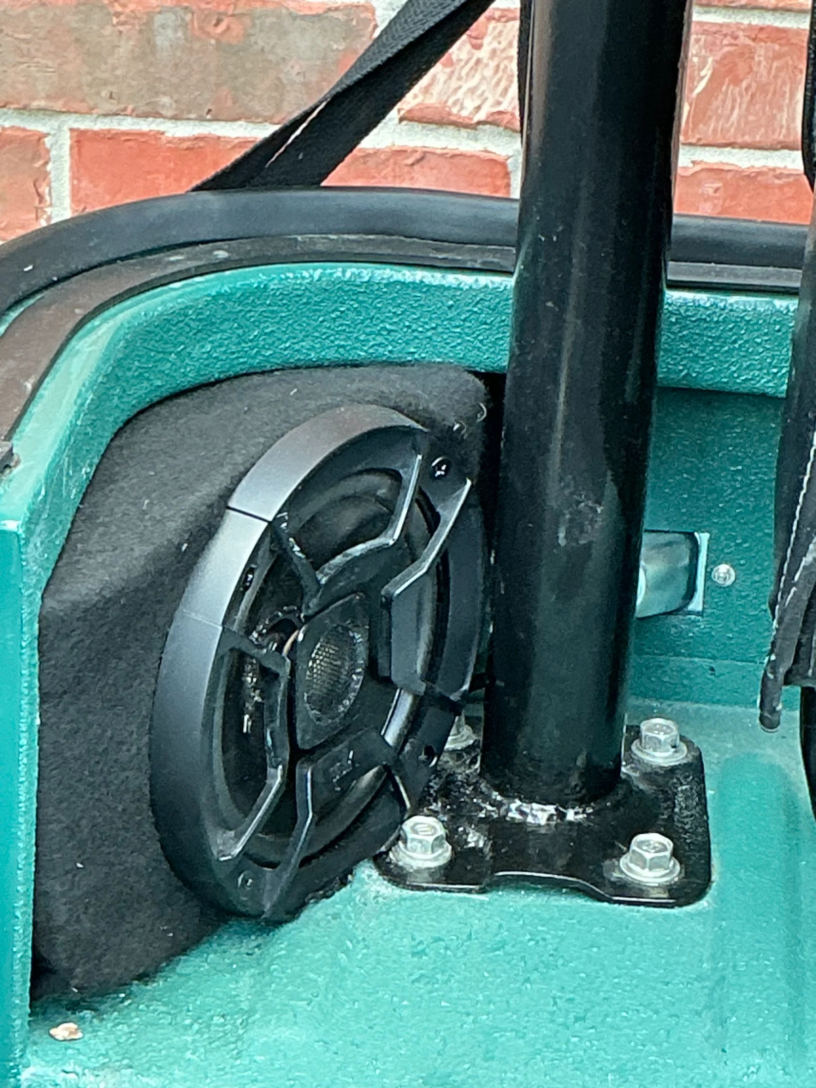

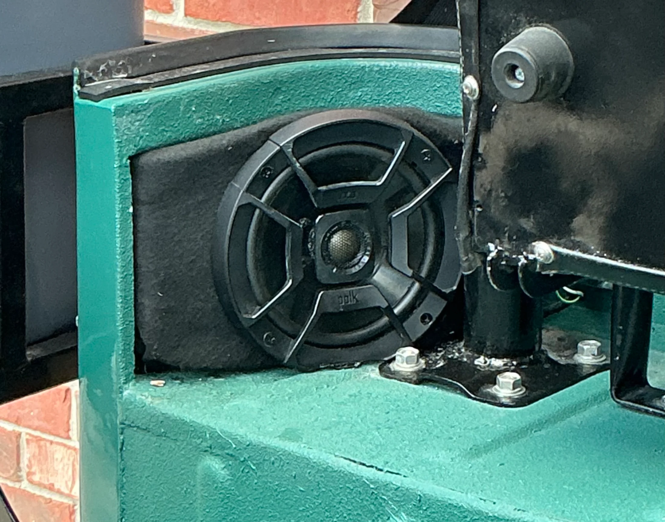

Also made me a couple speaker boxes for the back corner. Made then out of fiberglass and then wrapped them with some felt.

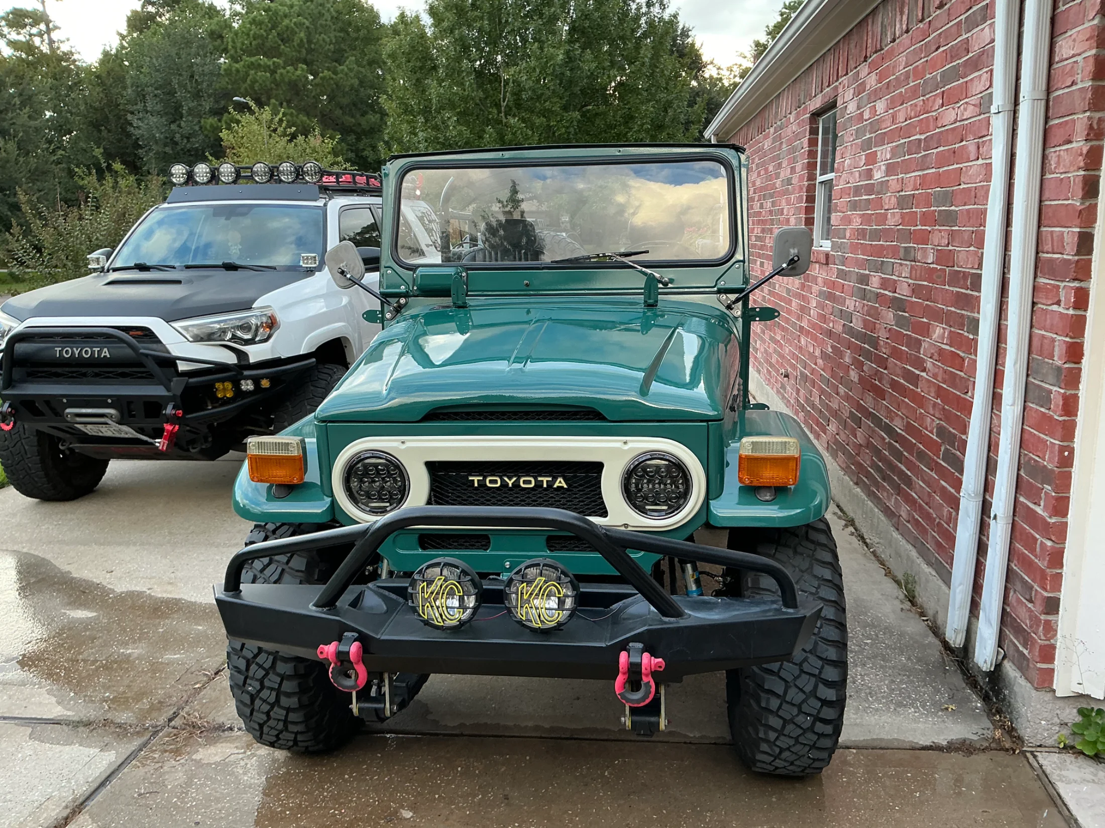

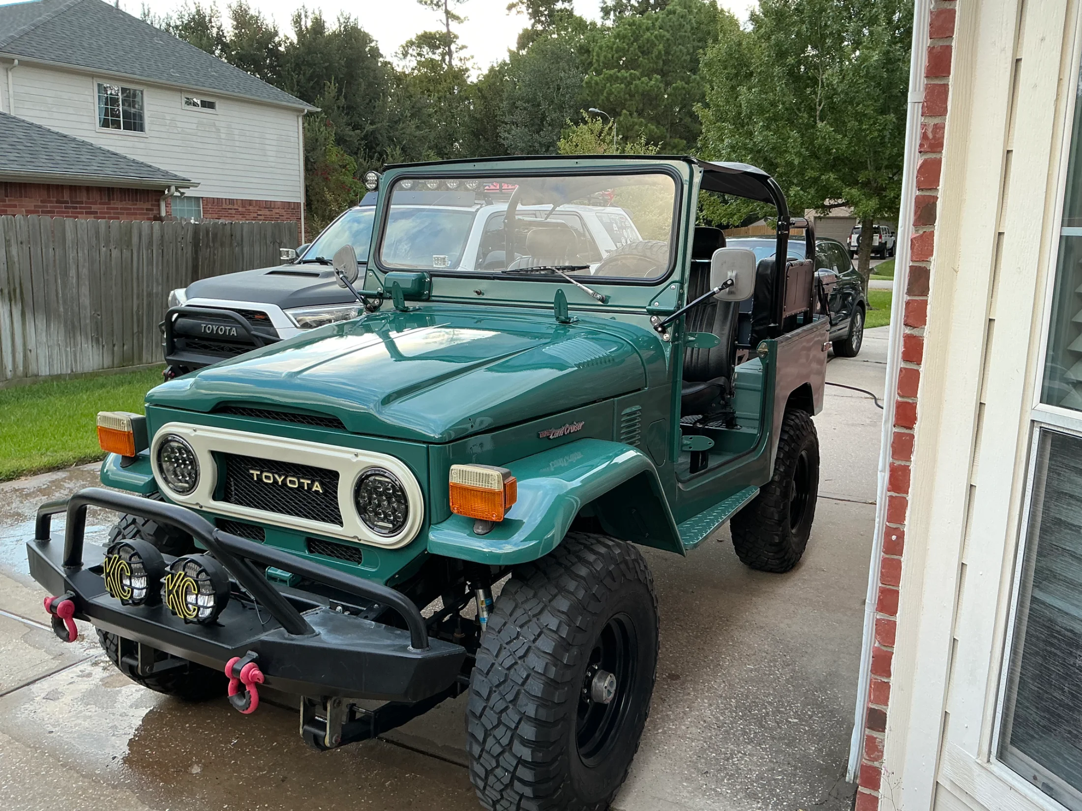

That's a good looking front bumper 👍
