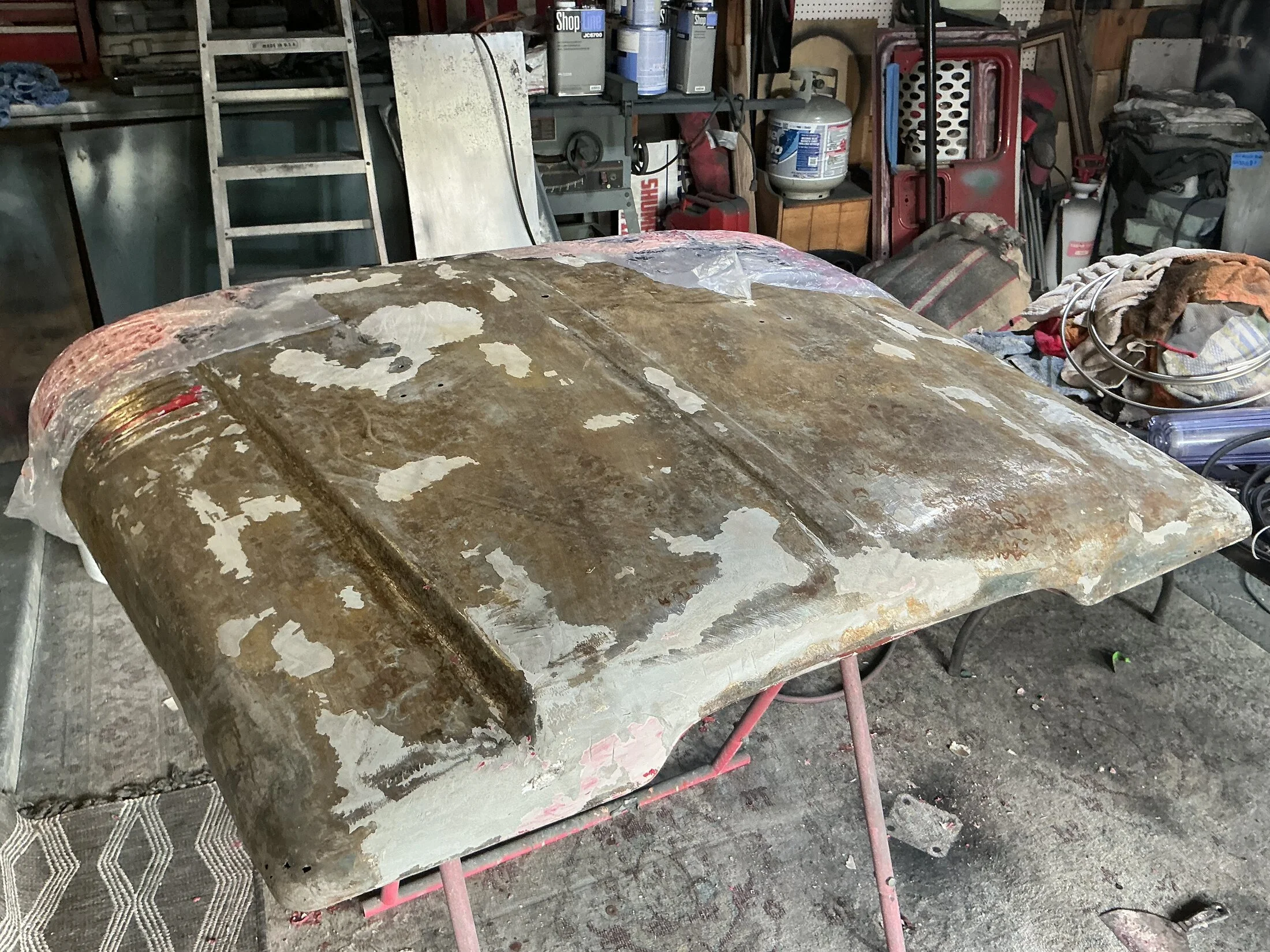

The last piece to get stripped. It’s in much better shape than I thought it was going to be. Few pin holes right at the front. Not sure how I am going to tackle it. 😵‍💫

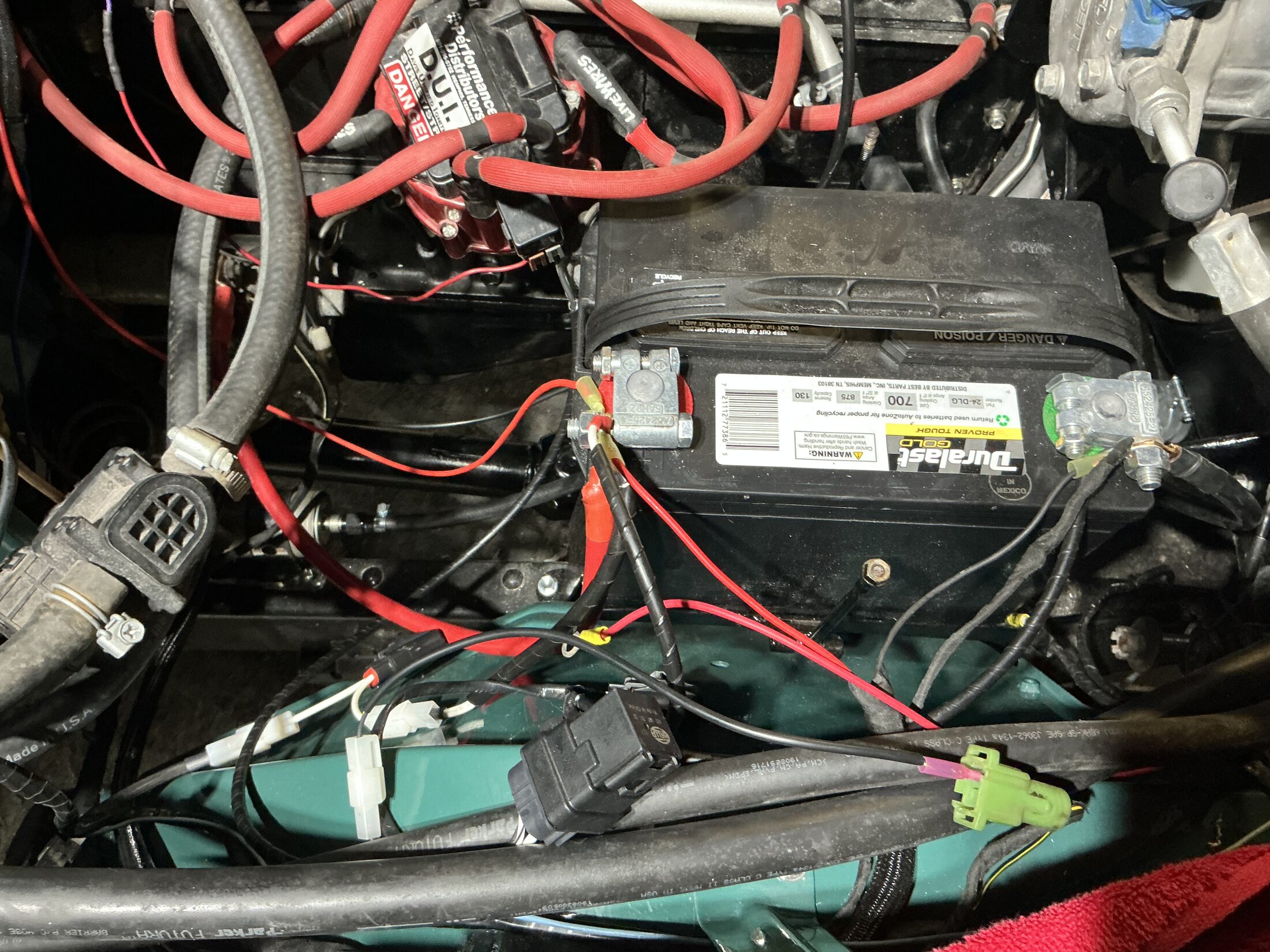

I am not getting any fire to the plugs. I am using coolerman’s HEI wiring harness, and I am getting 12v to the distributor.
No spark. I assume the coil in the HEI is out. Am I right? Would there be anything with the sniper setup that. Would cause this? I am thinking no, but…..

They like to eat modules
🤬 frustrating.. would be my second coil. Few years back it went out.
As far as I'm concerned, they offer nothing that an oe dissy can't also provide.

if the HEI is not working it's not going to run or it would misfire.
Surge is fuel usually. The sniper is probably getting mixed signal somewhere telling it to fuel then stop.
