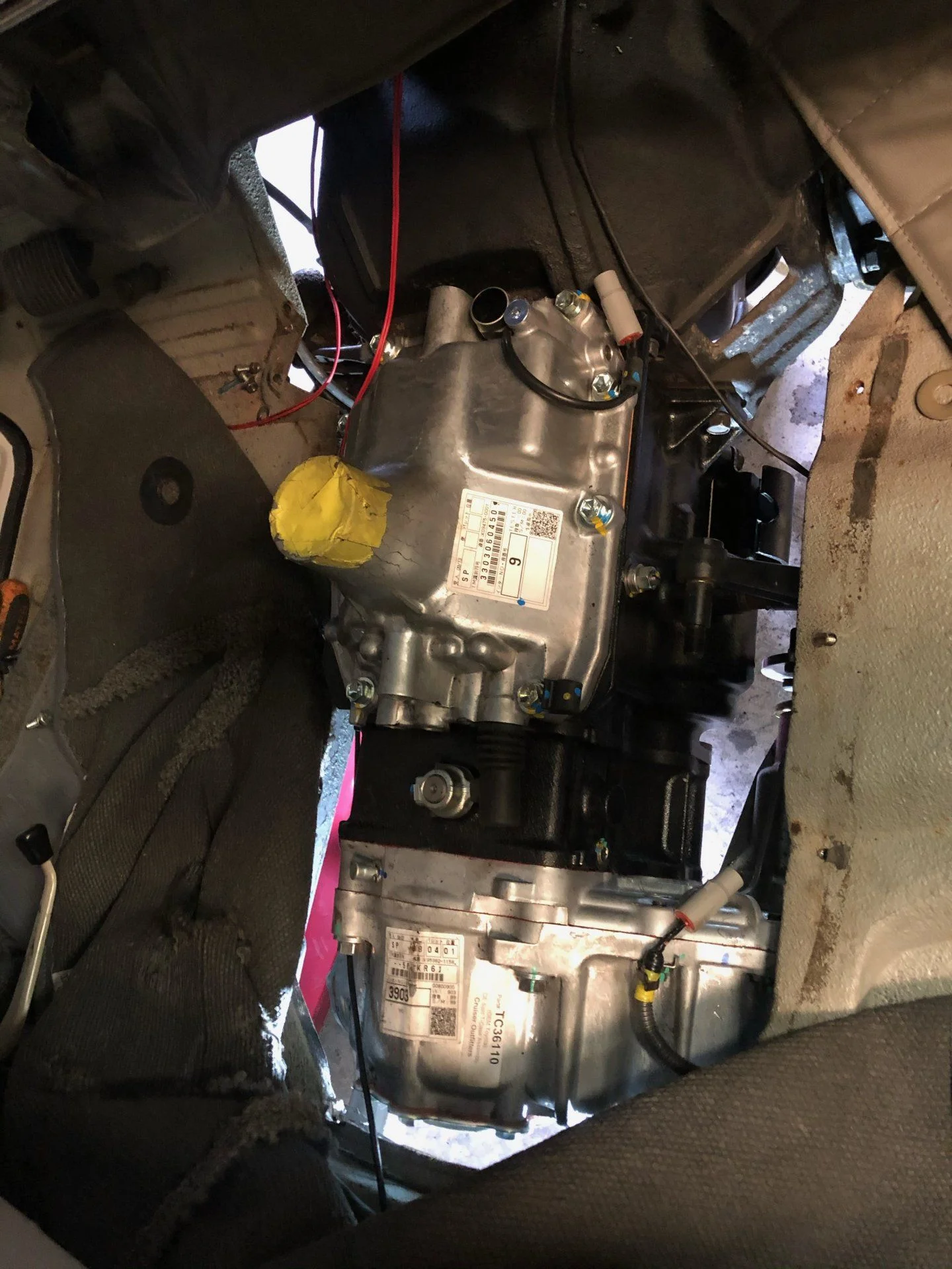

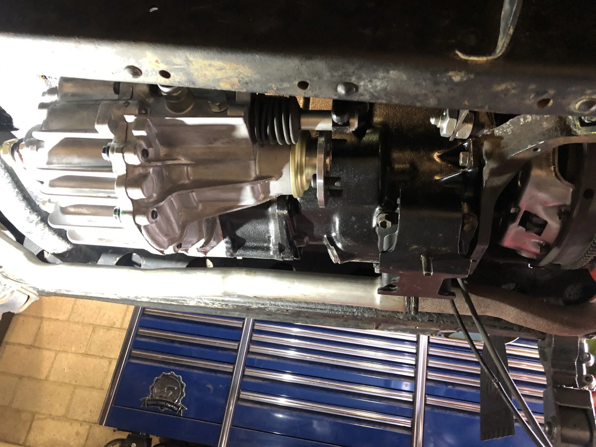

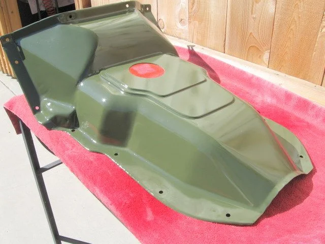

The new H55F is here and we're working on installing it. The trans hump my LV had was already pretty hacked up so I think I'm going to try to find an unmolested one from a column shift truck and try to do a cleaner job of putting in the new holes. I feel dumb asking this but want to be sure - will any early column shift 3sp hump work with the LV floor?
I’m no expert but I think you’re better off hacking the hacked one that you’ve got if it even fits. My SWB cover doesn’t fit with the 4 speed so I got an FJ40 Cover (taller) that still needs a lot of work to fit. Better than cutting up a good unmolested cover and they are hard to find anyway.
I could be wrong with the LV though, they may fit just fine.
Either way good luck!!!
Well my hump was hacked for a 4sp already but done very poorly. The way it lines up it will just get worse with the 5sp. So I’m better off using a new clean hump if I can find one. Won’t be a lot left of the existing one if I cut it up further.
I’m interested to hear what folks think will fit. I couldn’t even find a hacked SWB hump to raise up. The 4 speed hump I got through the classifieds here is tall enough but the rear floor holes don’t line up at all. I could probably measure my hump vs the LV here at my place if you think it would help.
Someone already knows all this....
My mind says our LV trans humps unique to the LV. They are not like anything I have seen in others. If the frame and perimeter is usable, even if rusted, I would start there. Any good fabricator shouldn’t have a problem making it like new and fit.
I’m coming to the same conclusion most of you are. Unless I can find an unmolested early hump on the cheap I’m probably better off just repairing/modifying the one I have. Part of me is curious how swappable these mid 60s ones are though. I’ll be driving by a “cruiser yard” in Manana AZ early next week while I take my kids down to camp at Patagonia lake, so I might see what he’s got for early trans humps though.

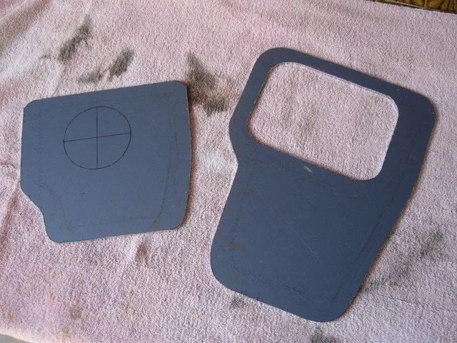

Now the not so good news. You will probably have to do some cutting to the passenger front floor as well to get the TC linkage to clear the floor. Take a look at @c2dfj45 LV build to see his "minimally invasive" approach to the modification of the floor and the tunnel (Link below). I think you will have to do the same thing...elongate the passenger floor hump rearward a few inches. I did something similar on my LV floor. Look at the bright side, compared to project Lara this metal work should be easy.
45PU has a Friend - tunnel mod
Curious how much difference there may be between 4 speed hump and what needed for the h55?
I’m naive to what was exactly done on mine with its 4 speed but understand then H55 sits higher?

This is a great read! That LV turned out really nice. I expect we will have to do some of the same modifications as well - but mine already had a 4sp in it the PO had installed and the floor was already modified slightly. They just didn’t do a very clean job of it. That 4sp is in need of a complete rebuild, that’s why I decided to just bite the bullet and upgrade it to the 5sp rather than sink money into the 4sp rebuild.
