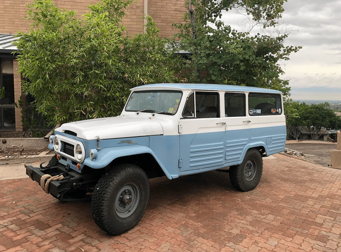

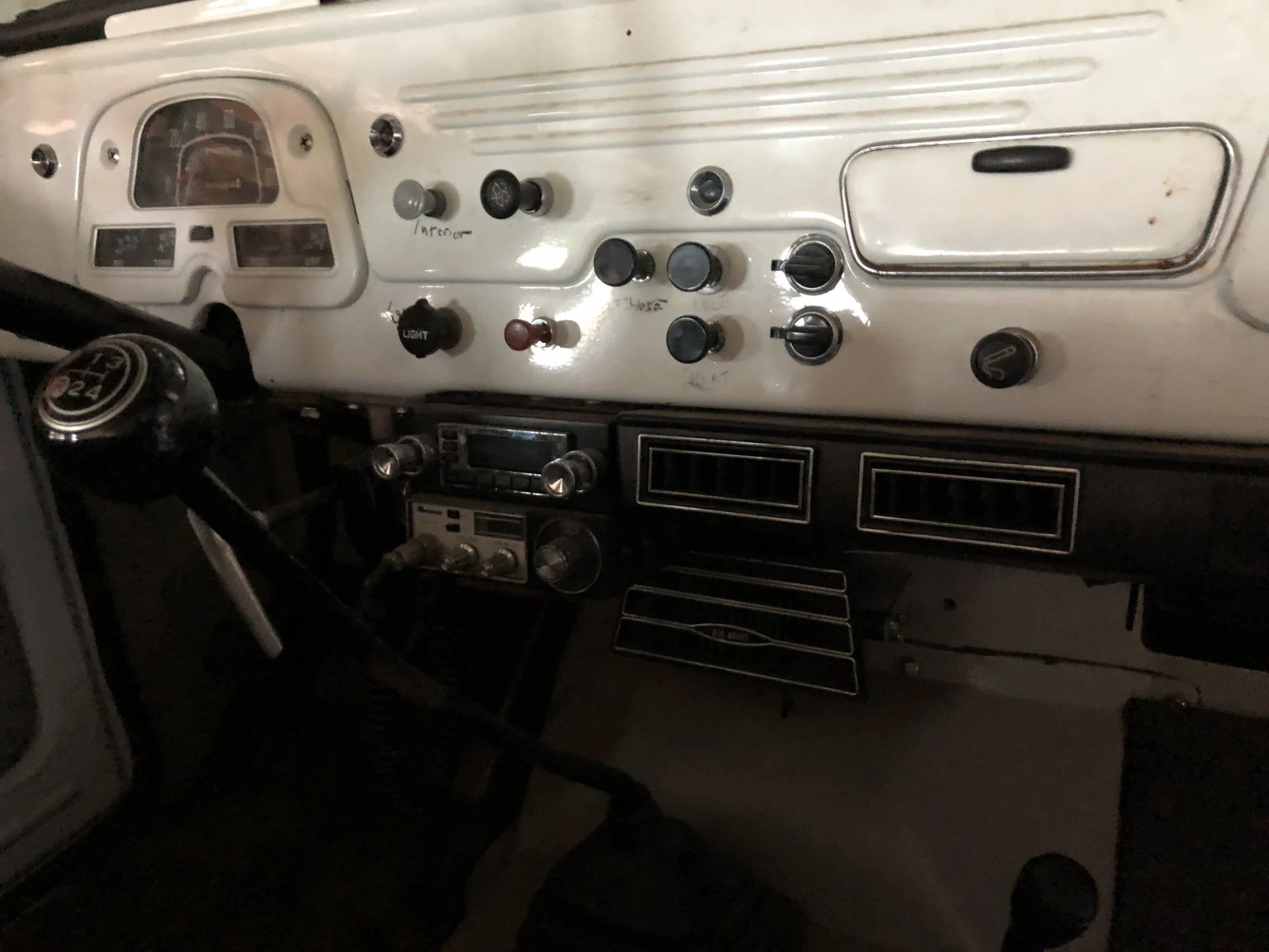

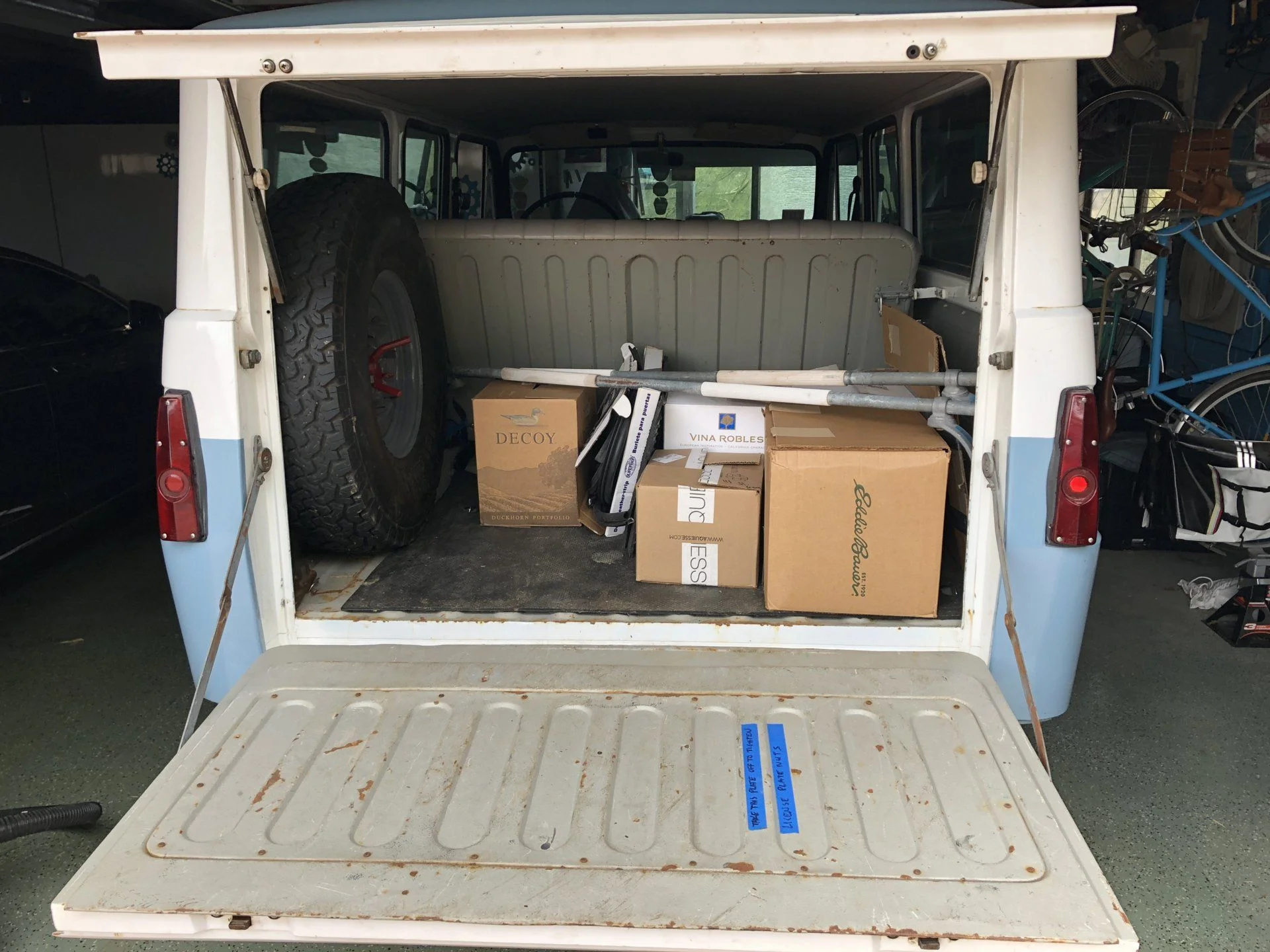

Well she arrived safely this afternoon. I'll dig into it all tonight, will certainly lean on "all those who have gone before me" for help with any missing parts but to me that's a big part of the fun with these old land cruisers, tracking down the parts. Never had an LV before though so obviously this one will be infinitely more challenging and I know a lot of the parts will have to be made! It's been converted to a 4 sp on the floor, otherwise mostly stock. It shows the 8 years near the ocean for sure but its all just surface rust, probably won't worry about addressing any of that anytime soon now that it's in the desert. I'll probably just use 40 pull knobs on the dash so I can at least know what to pull :) I will need to get the nostalgic AC working properly before June (belt slips) when it hits 100 here in Phoenix. Otherwise it's pretty close to stock and we will just enjoy it. Definitely needs a tune for the new elevation though, will tackle that next week. New 16" wheels should be here around christmastime so I will hold off on tires until those arrive. Still debating black vs gray, I guess I'll see how it looks with the black first.
Any other LV owners in Phoenix that have any of those parts that could be used as a template for fabrication?
-Rear Bumper & Mounts
-Rear seat "catch" hardware
-Front passenger door catch (doesn't work quite right and I think one of the little nubs is broken off), or maybe I can just use the one from drivers side
