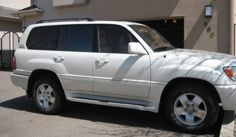

I know this has been discussed before, I am pretty sure that the center caps won't fit, but has anyone run a set of these wheels on their 100?

In that pic you can see they used the Tundra caps on the rear and the LC caps on the front.
Tried a quick search, couldn't find what I was looking for. Thanks!!! I still need to know for sure if they require spacers. I don't want to run spacers. What thread did you get that pic from?
Noticed that, thanks! They kinda look like the LX caps in the Front... Hmm.
No spacers required. You can use your LC caps but there's a slight gap around the cap. I ran the non-trd rims and they worked fine.
Good point that I forgot to mention. If you do run the LC/LX caps on the Tundra wheels you have to take special care to ensure they're fully seated. It's pretty obvious if they aren't, but I wouldn't trust a tire shop to catch it. The gap allows them to insert slightly off center which makes them loose and prone to come off.
