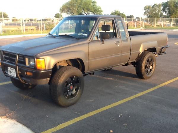

I went with 245/70 17
That is a vey nice looking truck!
Thanks, that is the result of a 6 month long restoration project.
The black Plastidip on those FJ wheels did the trick.
