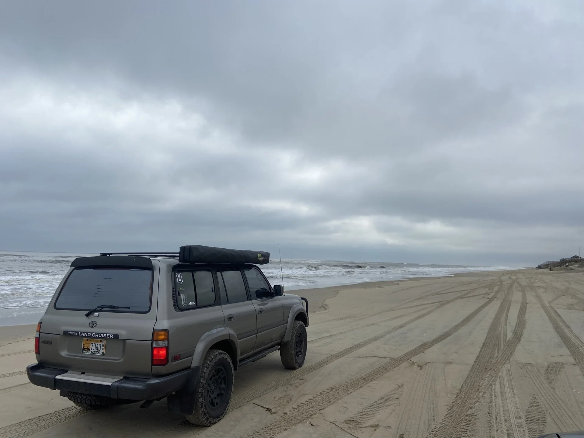

Will need spacers if you want to match the OE 4.5 backspacing. Are you running with or without factory flares? They actually line up pretty good without. Need 1” (or maybe 1.25”) spacers to match stock. I’ve run those and similar wheels since 07 without issue but you will scrub frame rail at full stuff without bump stops. Doesn’t bother me. Rattle can the frame once a year.

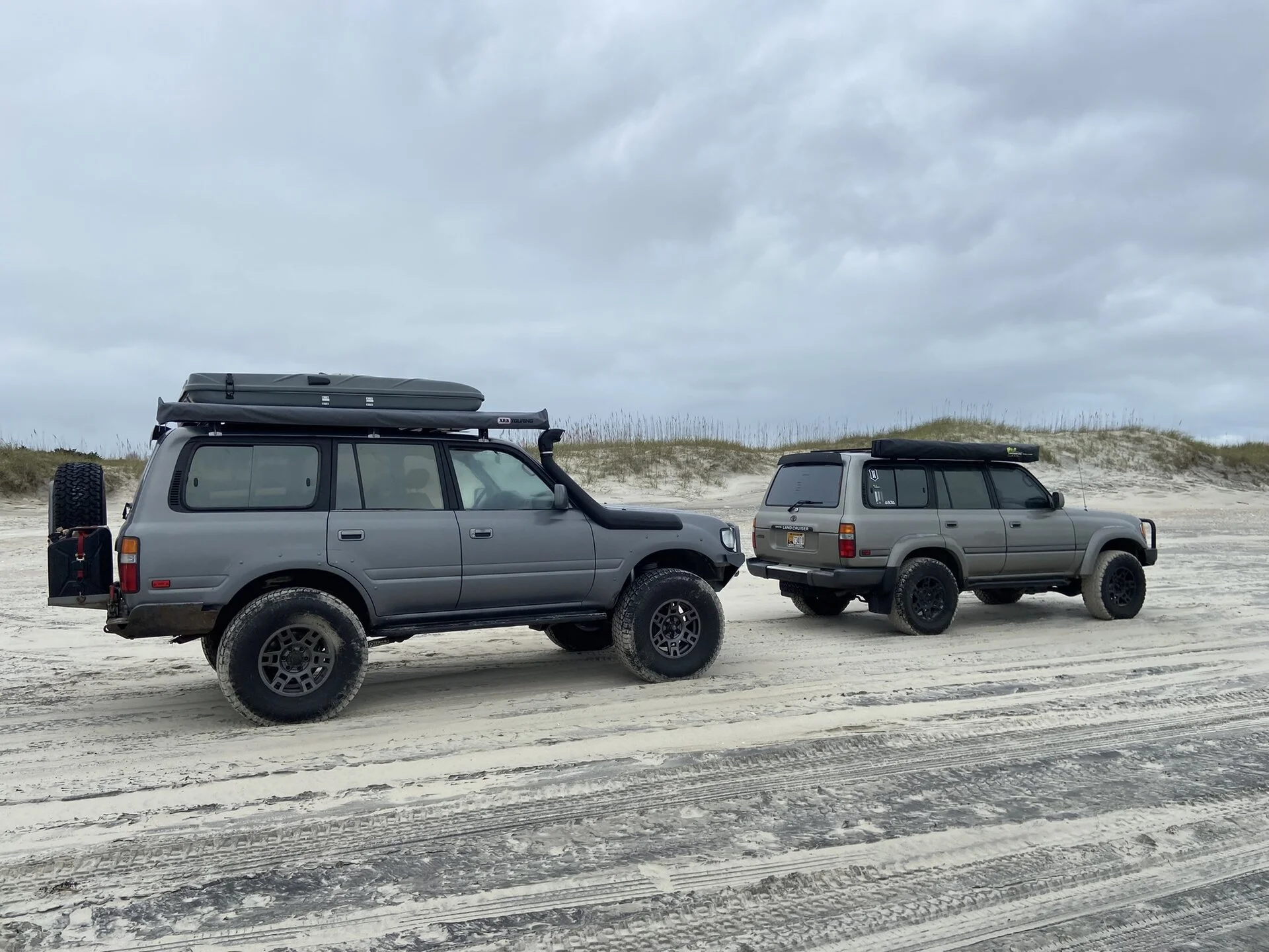

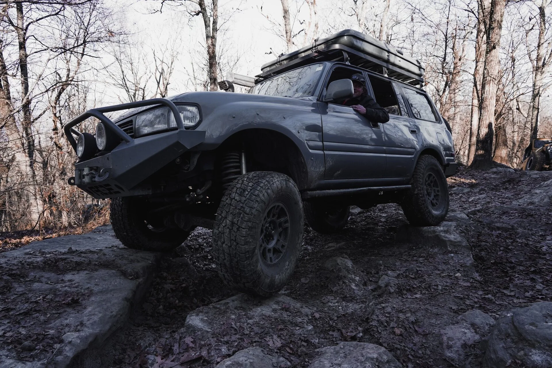

Here they are with no spacers, No flares, and 37s

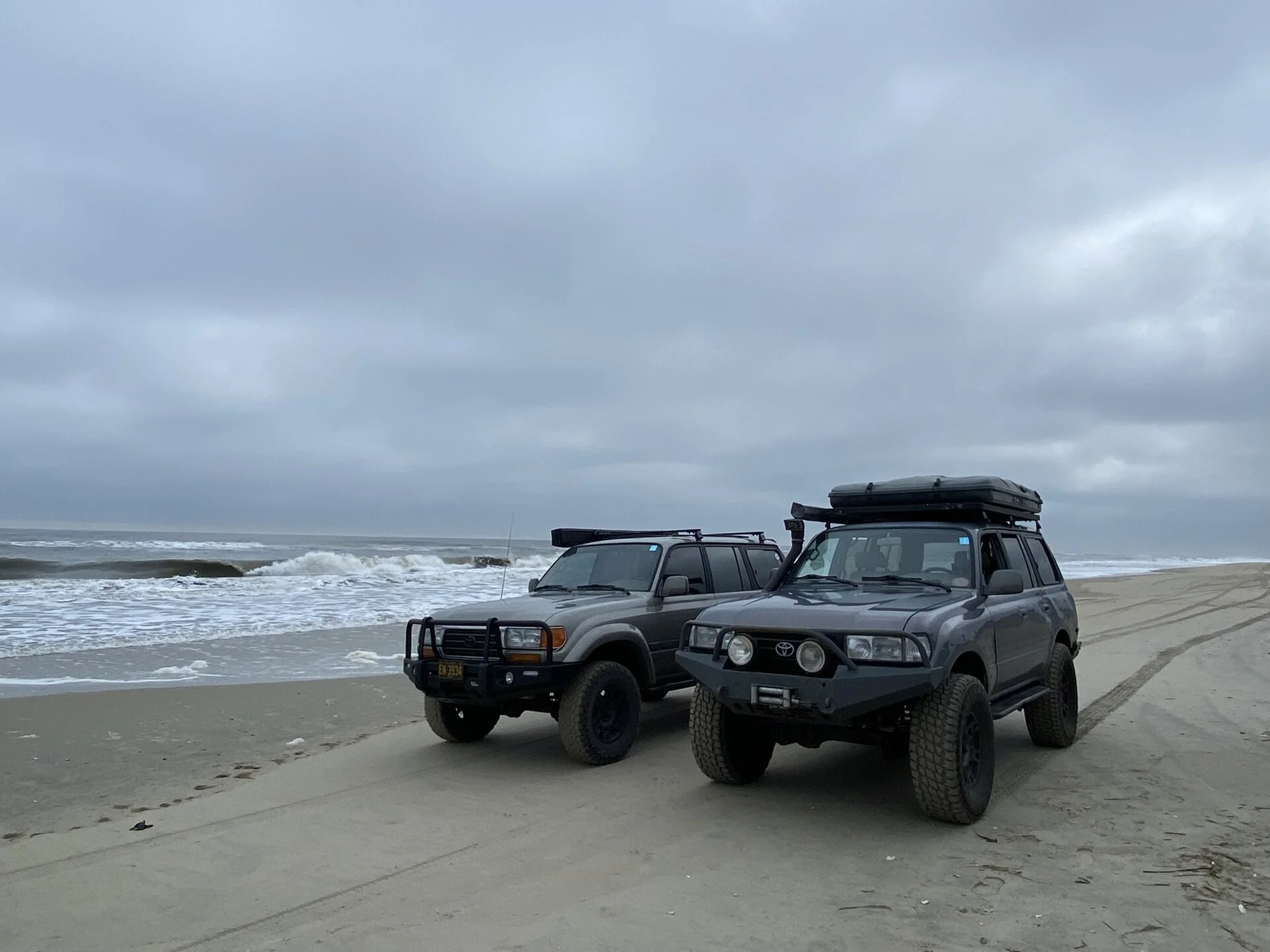

Moonglow 3” lift 37s no flares no spacers
Sage 40th 3” lift 285 flares and 1.5” spacer

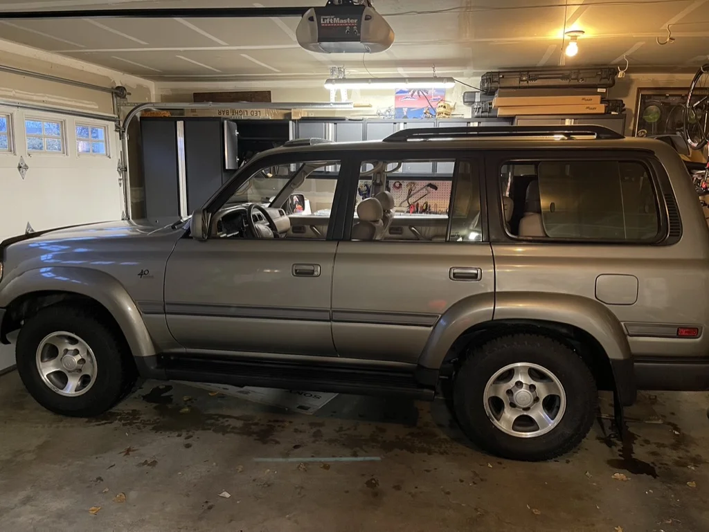

Thanks guys. Appreciate the feedback and the pics. Just picked this one up last week, so the build is just starting. 100% stock, triple locked.
