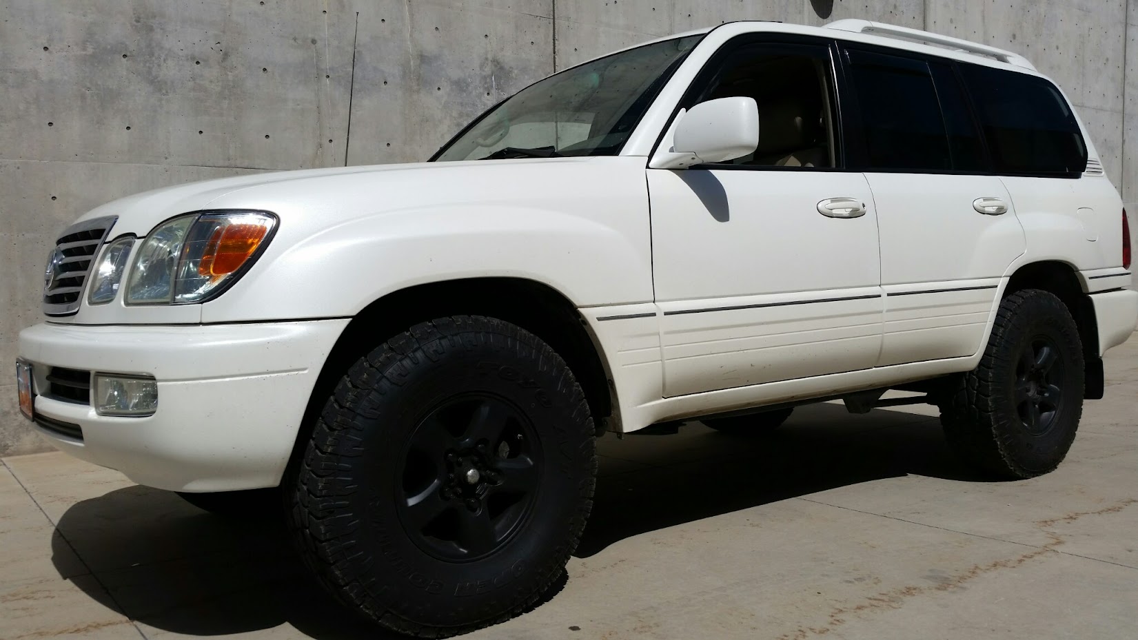

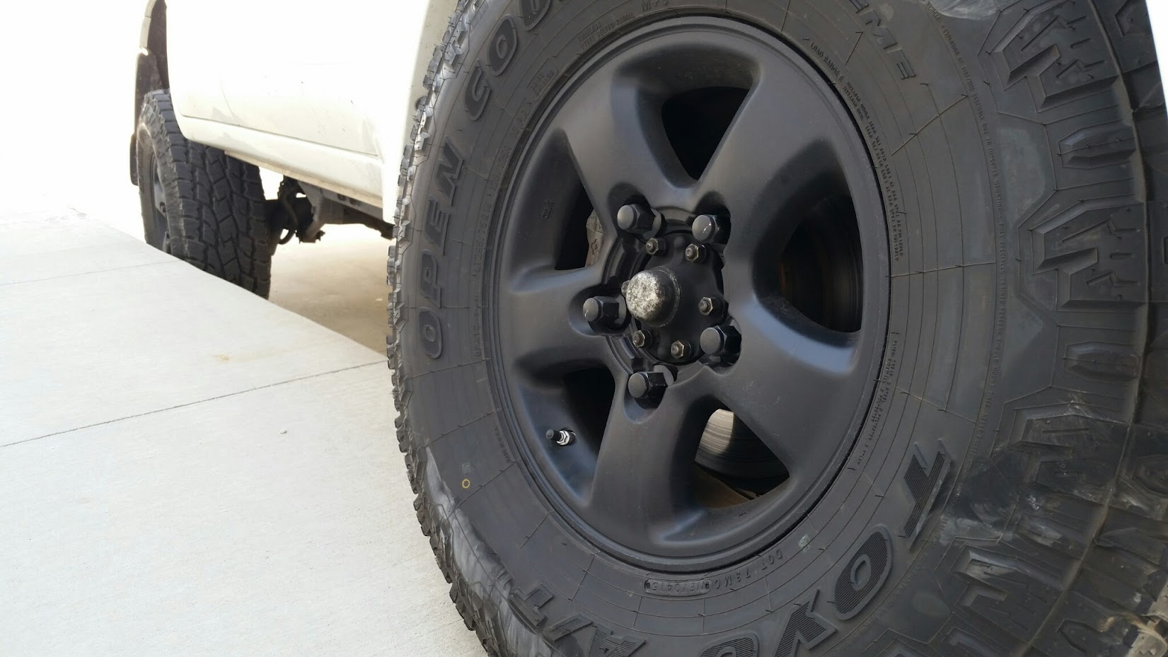

I have powder coated 16" 1999 LC wheels on my '06 LX470, no fitment issues.
Rgcz-yv3riZc7kWW1RrUo2il1bTm0-gVKWsYbds5QkM=w1651-h929-no
eHVEncSTY8D5irOZG19pFs4-_zdy1LlFsqLJ6dEYYY0=w1651-h929-no
Guys... the 16s fit the 2006.
I'm not sure where the bigger brake myth came from. The brake change was the diameter of the pistons in the brake caliper itself and that happened in 2003+
The 17 and subsequent 18 inch wheel offerings were entirely cosmetic.
