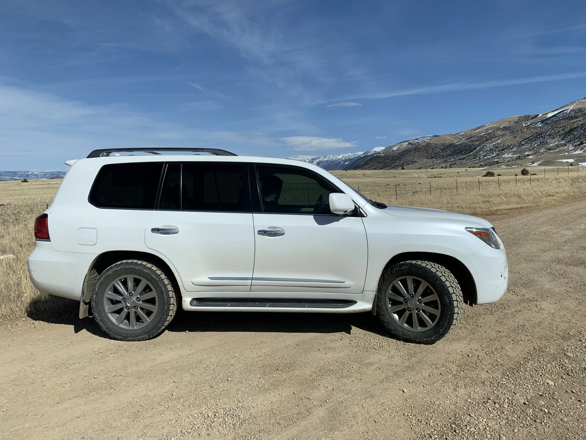

I run the Toyo AT3's in a 285/55/20 and have been very happy with them. Switched out the Michelin Latitudes that were on there. I put them about 3 months and 6k miles ago. Have had them in dry, wet, snow, and dirt and they have not disappointed.

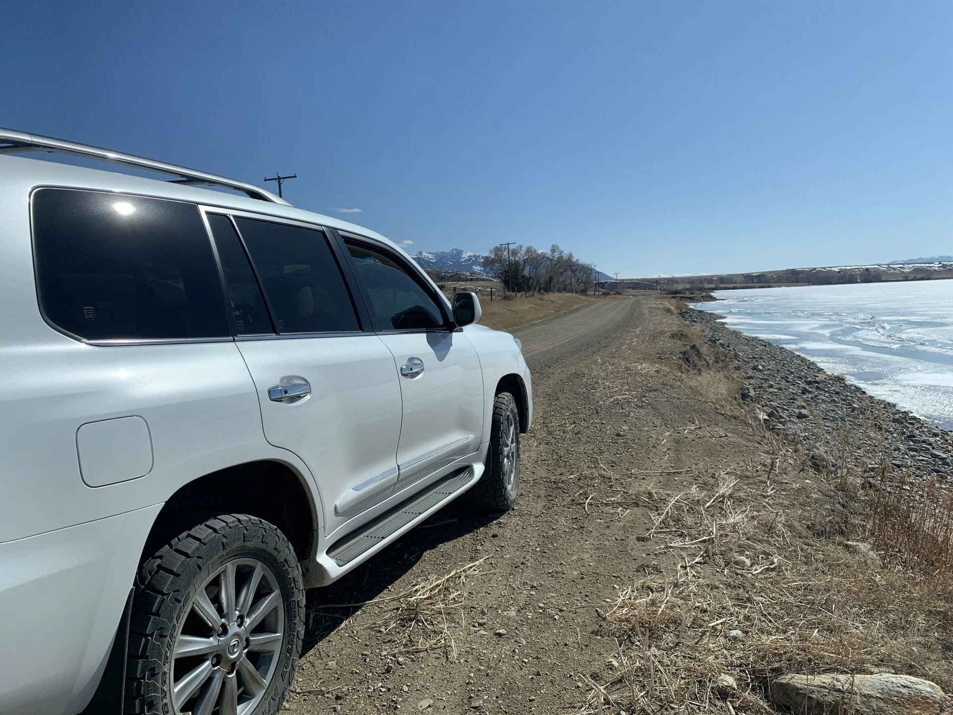

A couple pics of my car with the Toyos:

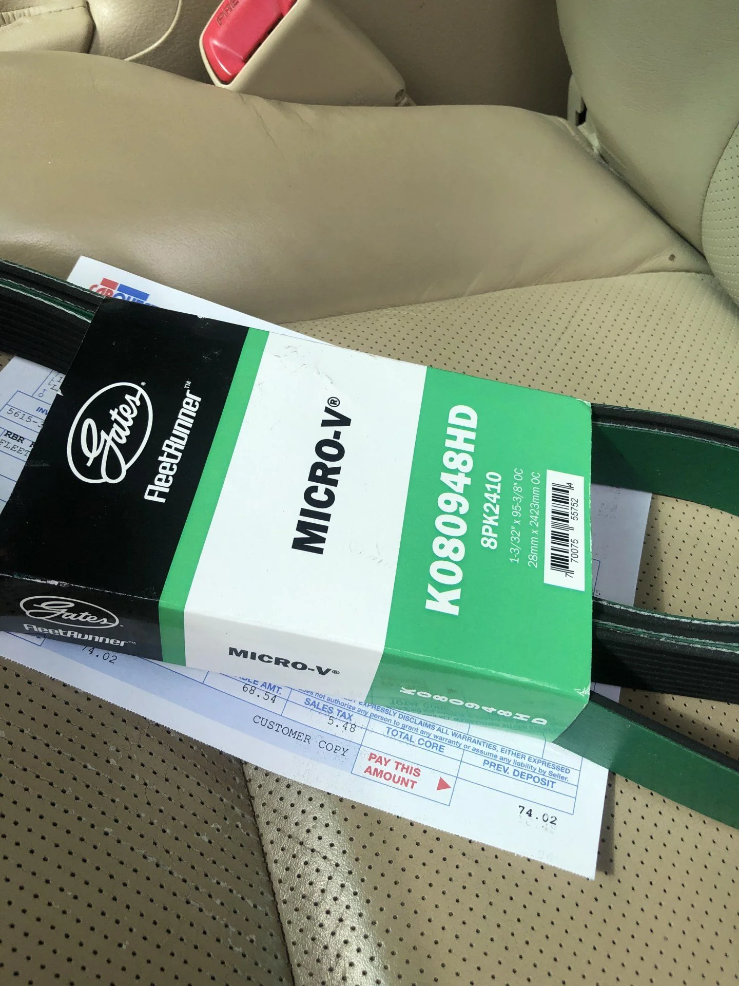

Looks great putting the Toyo at3’s on in the morning changing oil an using trd filter and the gates fleet belt. The belt was pretty exspensive but should last

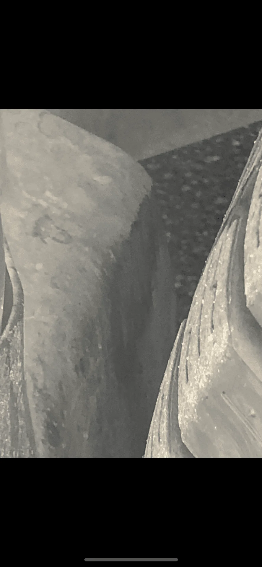

Got them on today slight rub full turn in reverse nothing bad. Rides great

This is the rub full turn doing backwards
