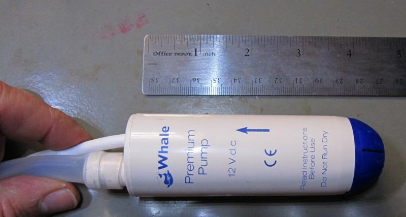

So, what I've ended up using is a Whale pump (GP1352 pump - just google it) that runs about $35-$40. It is a submersible unit and can pump quite a few feet of head. I've spliced in about 20' of flexible silicone insulated cable and 20' of silicone hose. Pump draws about 1.5-3A depending on the head it is working against. The pump nominally will transfer 4 gallons per minute with no head and about 1.5 gallons per minute with a 20' head (pretty impressive little fella).
The hose I use I bought -> 3/8" I.D. x 1/2" O.D. Pure Silicone Tubing by the foot - https://coldandcolder.com/products/silicone-tube-3812 and runs about $30 delivered for 20'. 3/8" ID, 1/2" OD. It is very flexible, but doesn't easily collapse when rolled up or just laying on the ground etc.
This is a picture of the pump with hose:

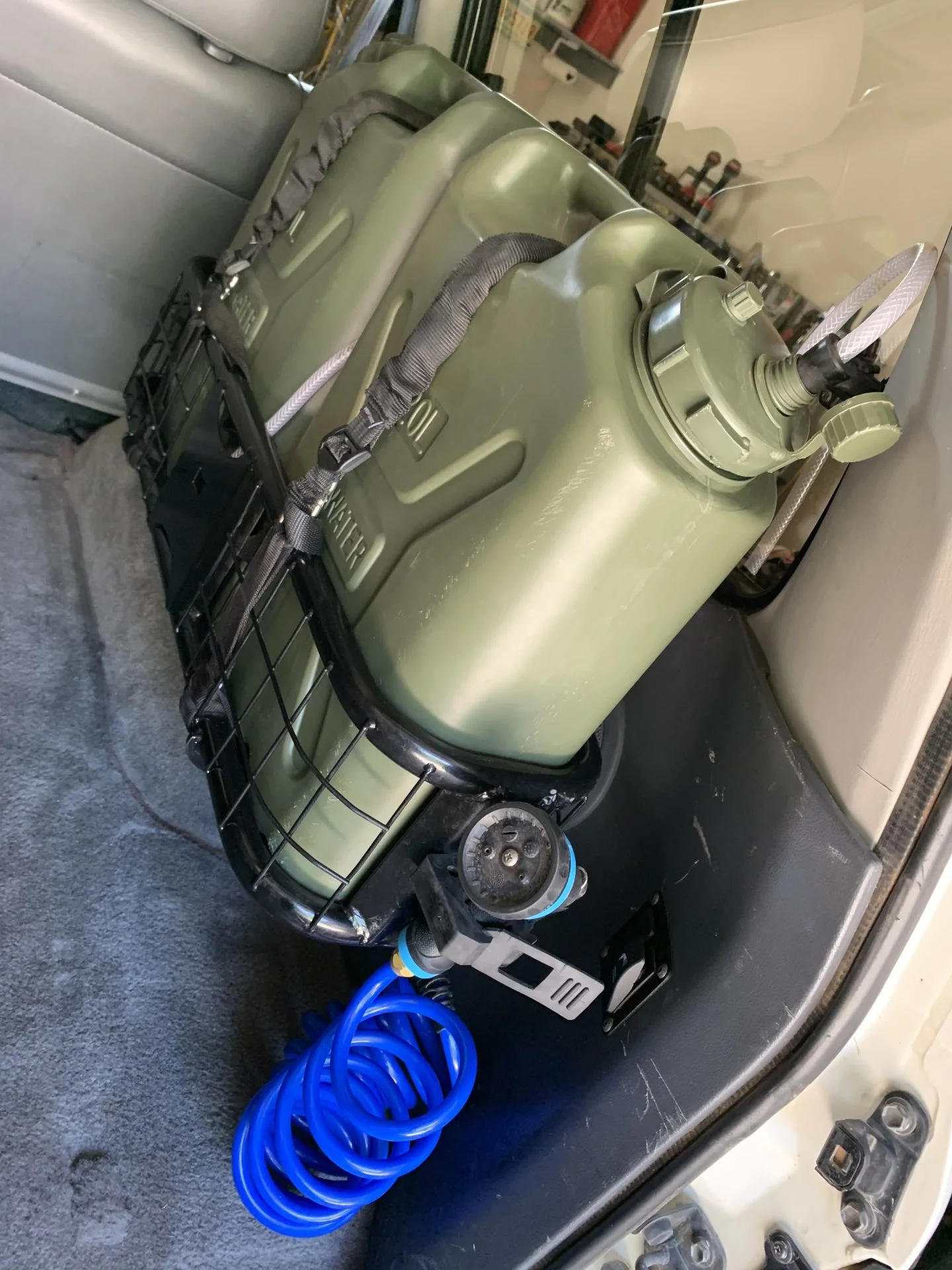

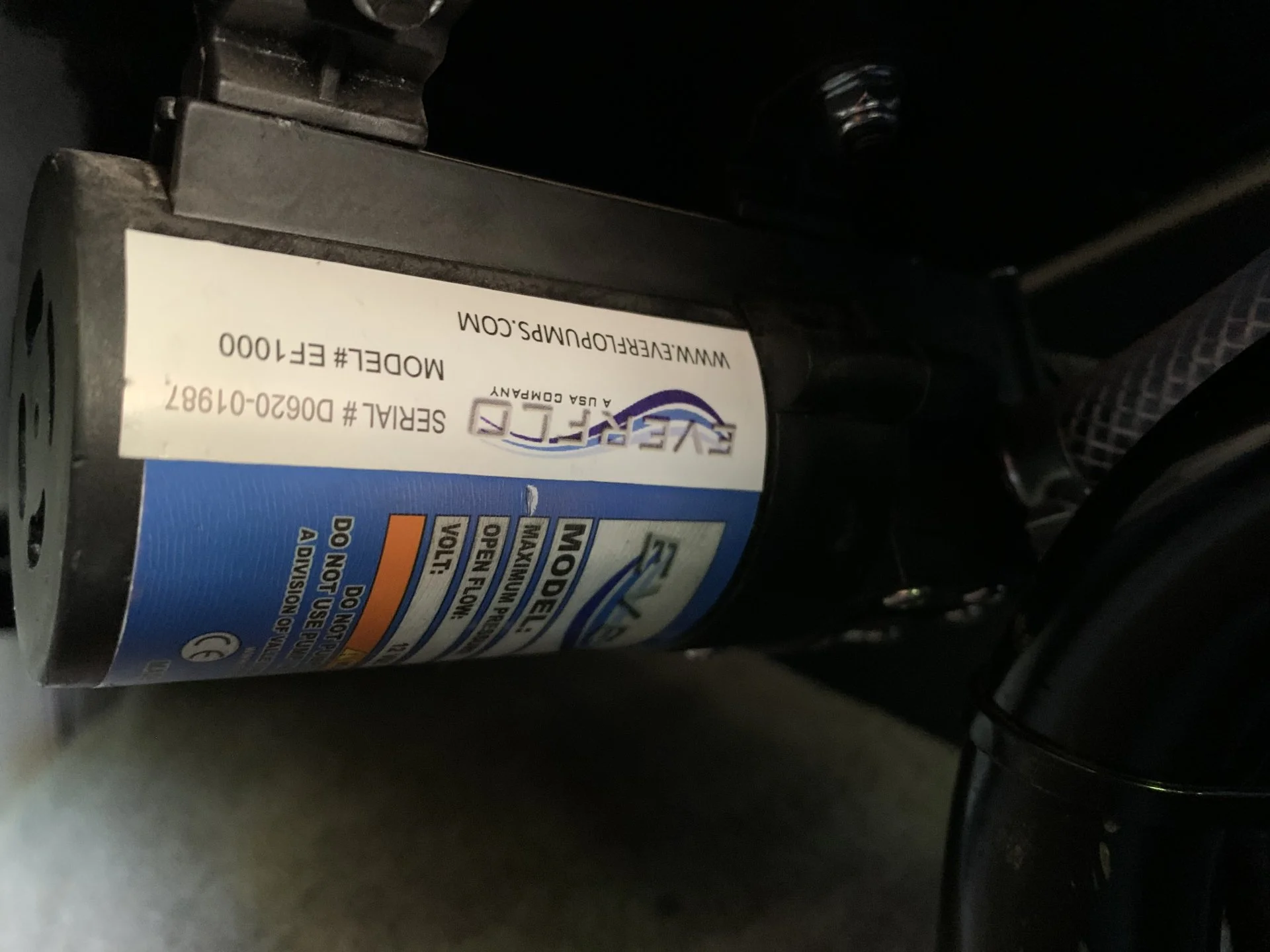

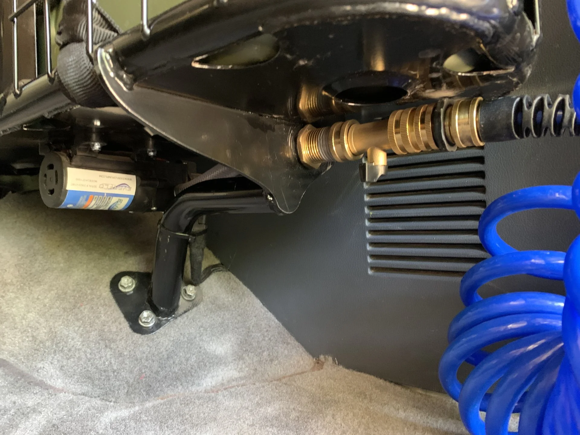

Simple setup I’ve been enjoying for a few years. The pump has a built in pressure switch so it only runs on demand. Refilling via the sliding window without having to remove the tanks is handy.

Do you ever wish you had more than 1GPM? I was originally looking at the 2.2GPM. My use would be mostly kitchen and misc. (already have a separate system for shower)
Love this setup. Was looking to do something similar.
Great question and I had wondered the same. The “jet” setting ranges over 10 yards. I haven’t found a reason why you’d need it. The “center” setting conserves water but provides more than enough concentrated pressure to wash the gunk from dishes. I use it the most. The “shower” setting is great for exactly that. Anything more and it just wastes water. Drinking water aside, you’ll use about 2ga/day for dishes and a thorough shower. That’s without being miserly.
Great feedback. Sounds like plenty for me, and 2lbs v. 5lbs along with size for where I'm placing it is a big difference (removable platform).
